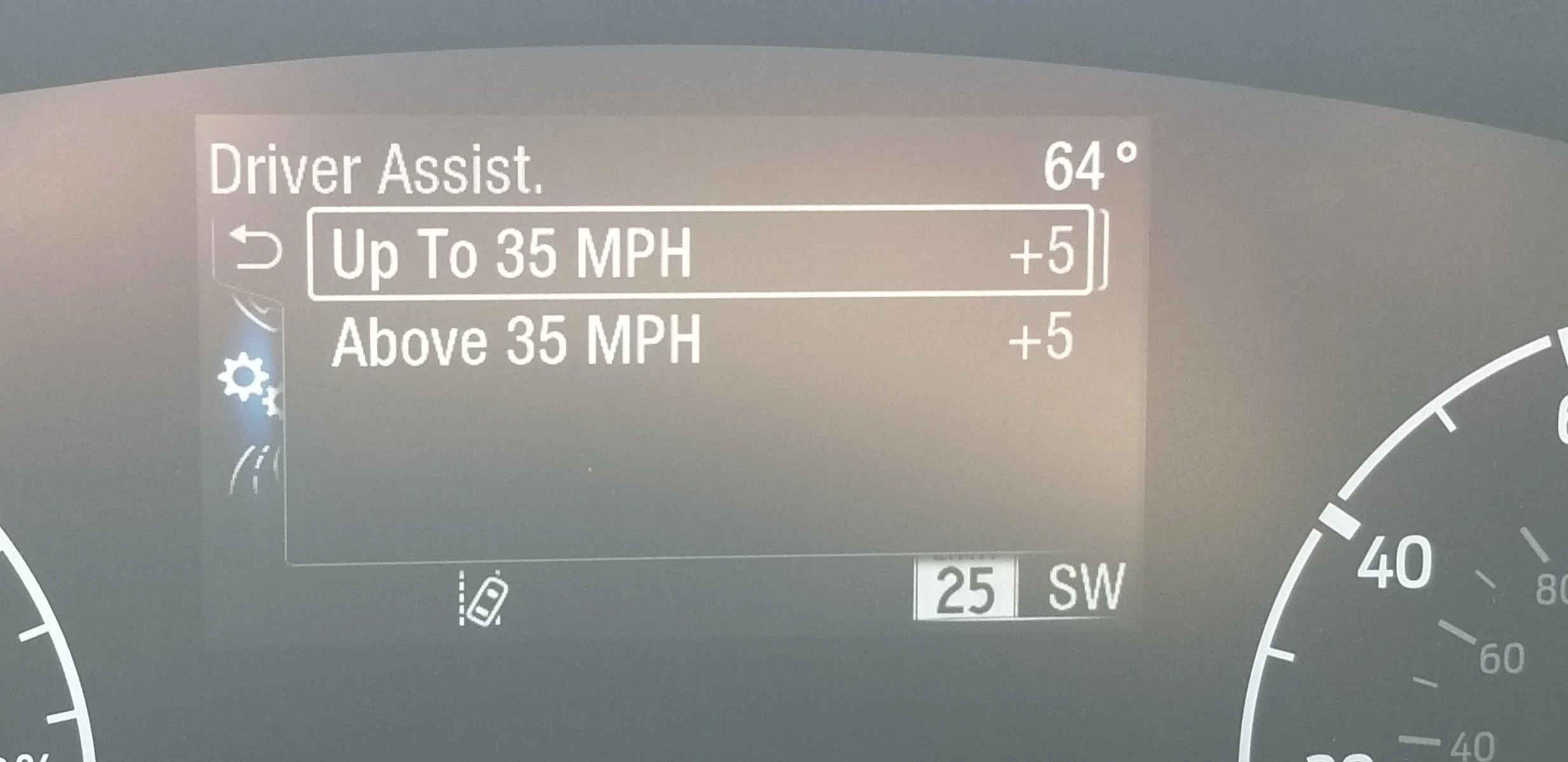

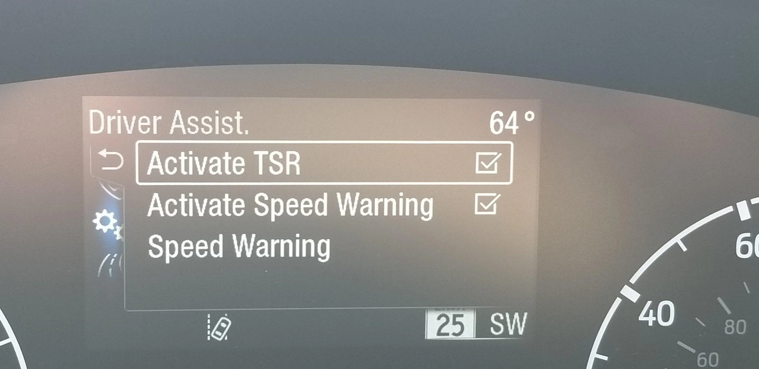

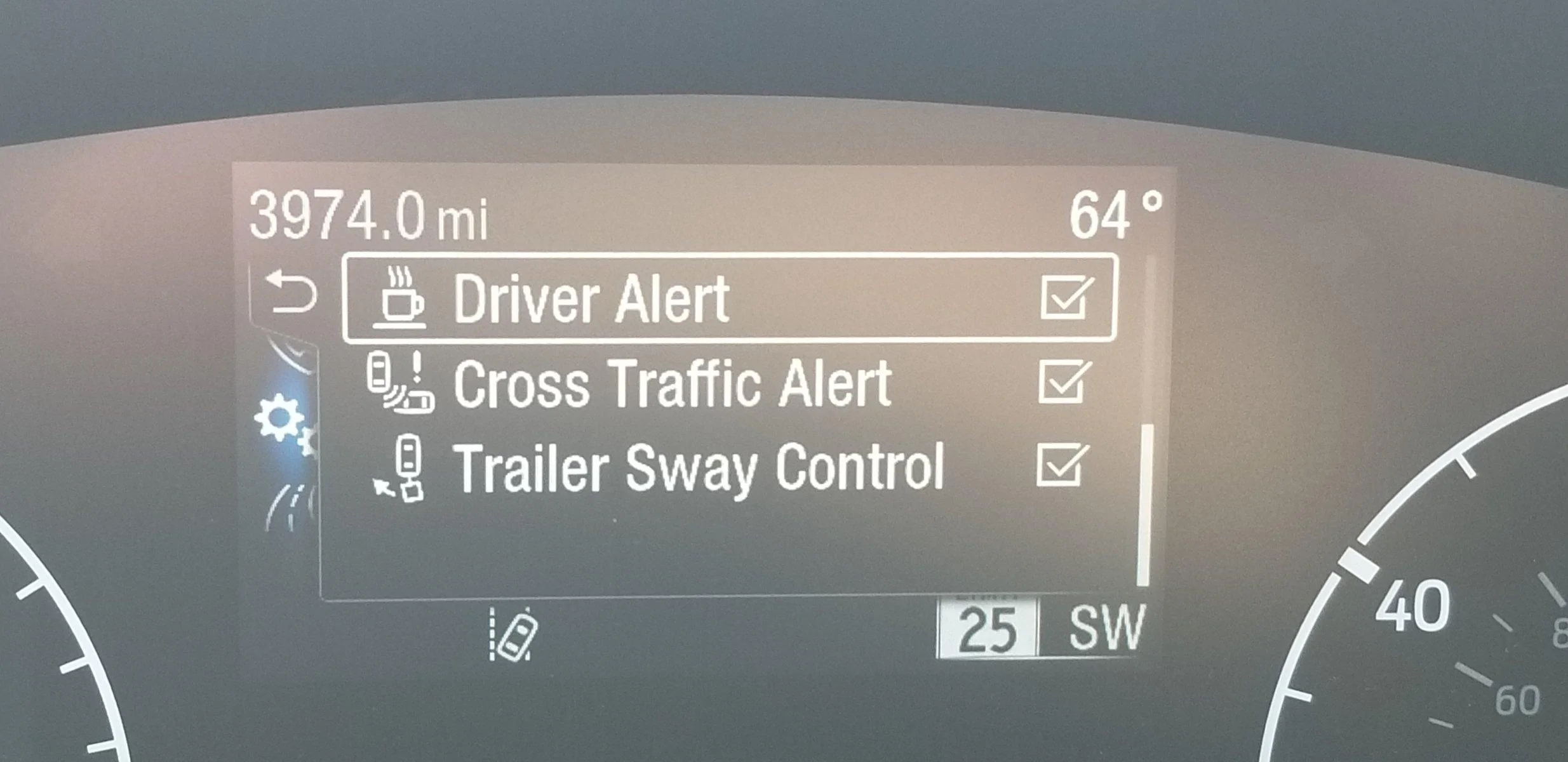

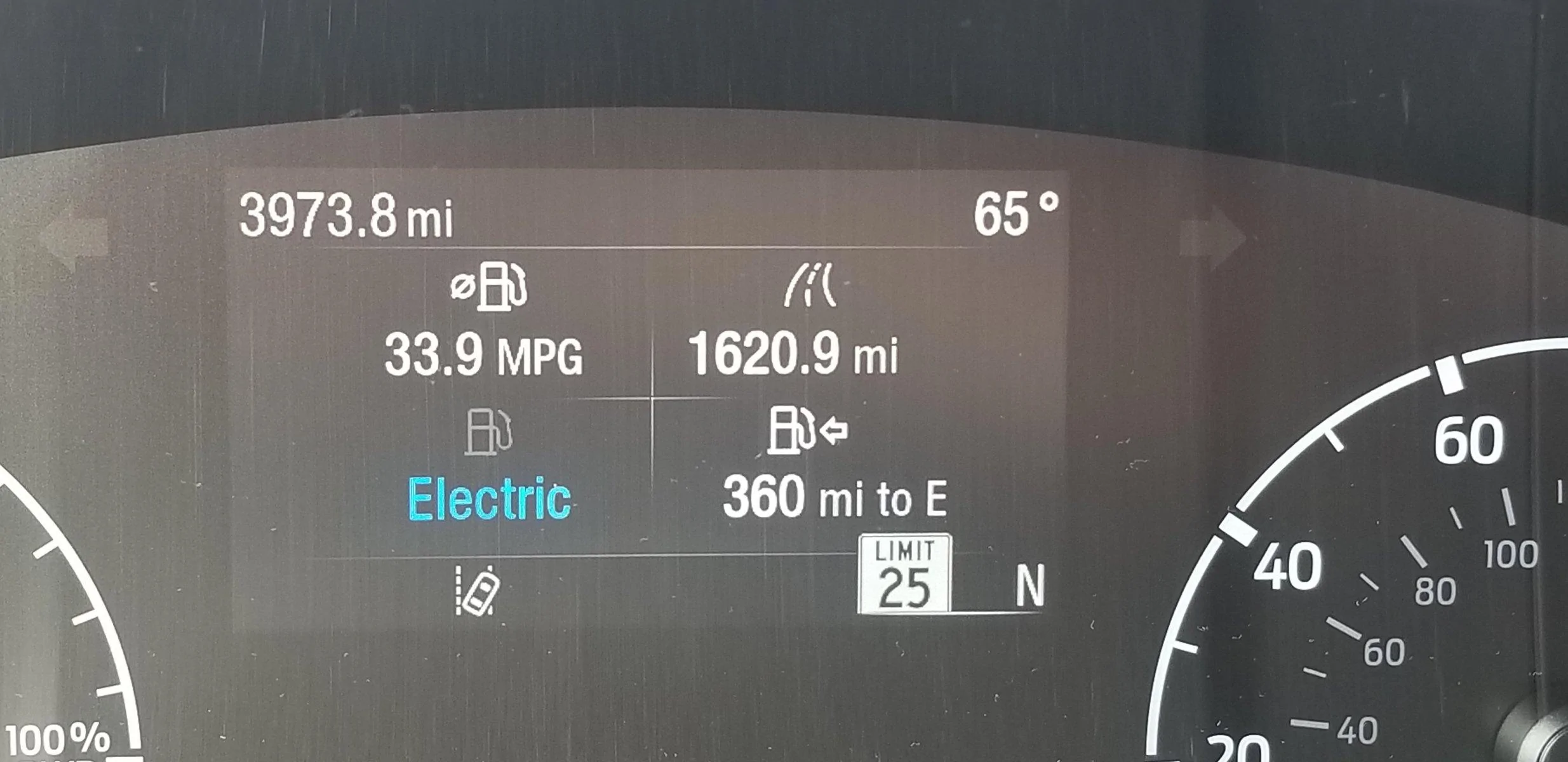

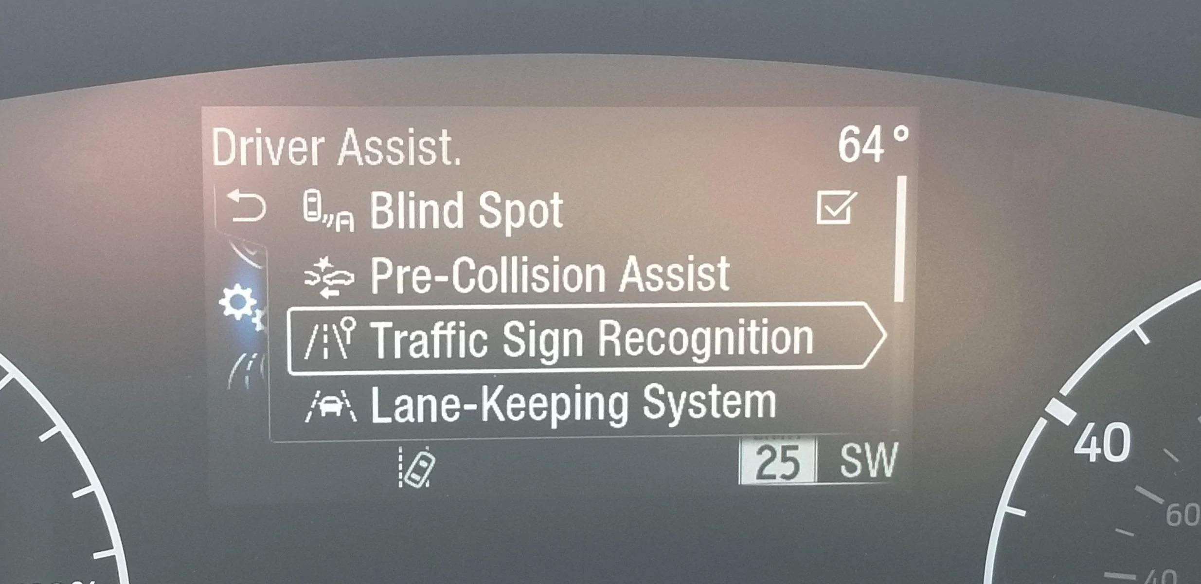

Thanks to everyone for your research. I was able to get TSR working in my 2022 XLT Hybrid (4" Display-CP360-Trailer Hitch) I used the following entries:
IPMA 706-01-01 xxxx xxD3 xxxx (was xxC9)
IPC 720-03-02 xxCx xxxx xxxx (was xx4x)
IPC 720-09-01 xxxx xxxx 8xxx (was 1 xxx)
I could not change the Speed Warning from 5MPH. When you exceed the speed limit by 5 MPH, the speed limit sign flashes on the display. All the CP360 functions seem to work fine although I do not have a trailer to test the Trailer Sway Control.
At first, FORScan did not see my IPMA module, so I deleted the Profile and had FORScan create a new Profile. Then the program did find my IPMA module and I was able to make the changes.
