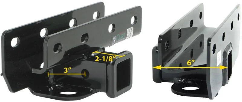

Mount right to existing crash bar.https://www.etrailer.com/Trailer-Hi...U7WALZpQtqwdTCHWxmviZdZ9-Bf-mPpBoC2pUQAvD_BwE
Curt's chart shows it will not work on maverick. Looked under my lariat FE and only have 5/8" between spare and crash bar and 3/8" between spare and points of teeth on spare tire crash ripper. Looks also like 4 holes would have to be drilled through crash bar = biggie no no!
On my Maverick XLT Hybrid with the Full Size Spare Tire I have 1 3/8" from the back of the Crash Bar to the Spare Tire so clearance looks good.Looked under my lariat FE and only have 5/8" between spare and crash bar and 3/8" between spare and points of teeth on spare tire crash ripper.
Why?Looks also like 4 holes would have to be drilled through crash bar = biggie no no!

And why would the distance between spare and points of teeth on spare tire crash ripper have any bearing whatsoever in mounting the hitch on the Crash Bar?
Why?
Are you saying that those who bought the hitch for the Jeep Wrangler and used those four holes are unsafe?
I would like to know why you state it is a big no no?
The problem I see with this hitch is that the Maverick Crash Bar is 2" thick and this hitch seems like the opening is 3 1/2" so there would be a 1 1/2" gap between the front and back holes.
I am going to ask it a hitch similar to this one can be make for the Maverick.
Was more of an example. This one may not fit the Maverick. But I believe there are some that would.For those who are wondering what the link in for it is a:
Curt Trailer Hitch Receiver - Custom Fit - Class III - 2"
for a Jeep Wrangler for $88.25
When selecting: 2022 Ford Maverick it does state "NOT CONFIRMED TO FIT 2022 Ford Maverick"
