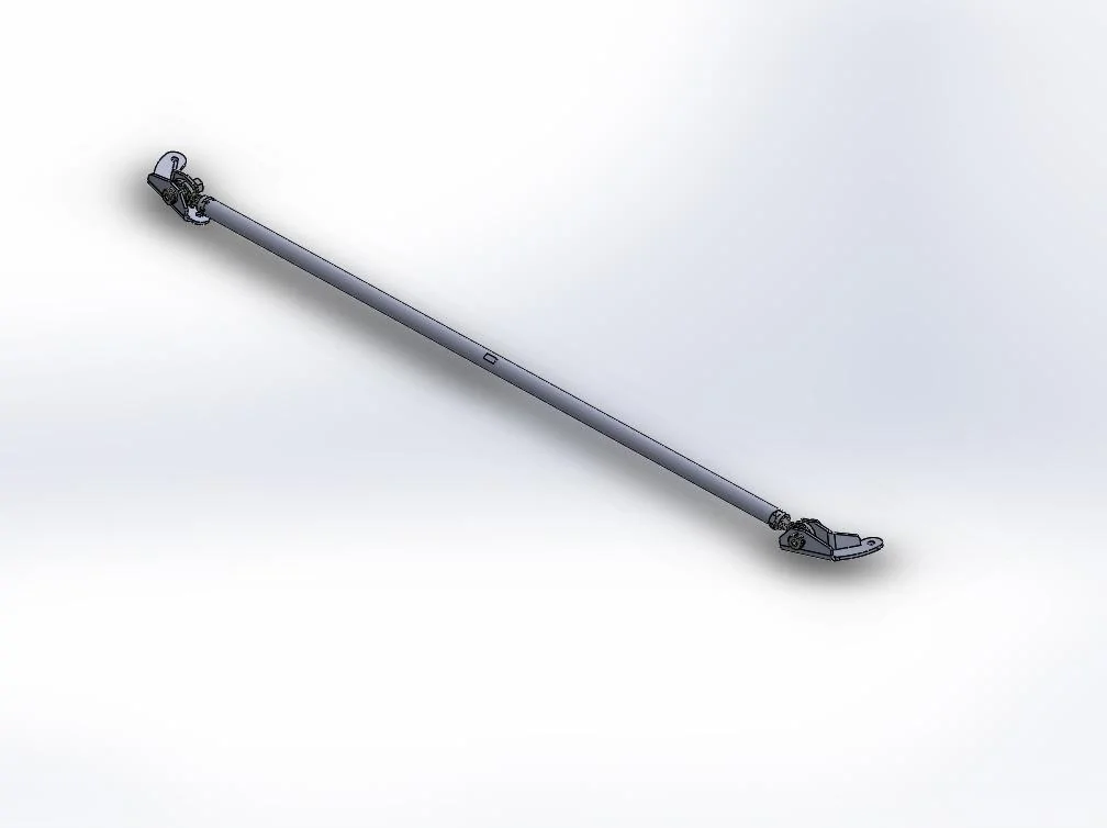

Steeda bar leaves a lot to be desired IMHO. No preload, single coupling point with a M8 bolt in the shear plane. Part is mostly for looks. Will hopefully be fabricating on up soon.
im waiting on someone to make it like that or full strut tower base. to buy it i hear the fast maverick ivan its making one so im waiting.
