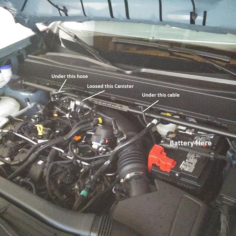

It came in yesterday but I wasn't feeling well. I purchased a Steeda Strut Tower Brace. It came professionally wrapped,, as it is powder coated. It took about 30 minutes to install with 2 bolts, 2 spacers and 2 washers. Had to relocate a wiring harness.

I am interested in this and contacted Steeda Canada to find out if it will work on a Hybrid as their website says that it will not. They got back to me with the following reply "I just heard back from Steeda USA and they are saying there is a clearance issue for a canister on the hybrids. You could probably make it work but it would require some relocating." Did you have to modifiy this in any way. Can you send some photos of your final installation? That would be appreciated.

The only mod I made was to relocate a wiring harness.

There was no evidence of cheaping out. This thing weighs about 10 lbs. After final torqueing
What was involved in that?
Popping one clip.

Had to pass it under a hose and cable and loosen up a small "Canister"?
Ford Maverick Steeda Strut Tower Brace installed on Hybrid Maverick -- results & review Steeda Install details
Kit did come with a pair of metal/aluminum spacers for the Hybrid.
There is a pdf on the item's page on Steeda.
https://www.steeda.com/steeda-555-5736-escape-strut-tower-brace
You mention torquing but the Steeda instructions don't provide an amount. What value did you torque the bolts to?

The Steeda video for this product recommended 30 ft pounds.
