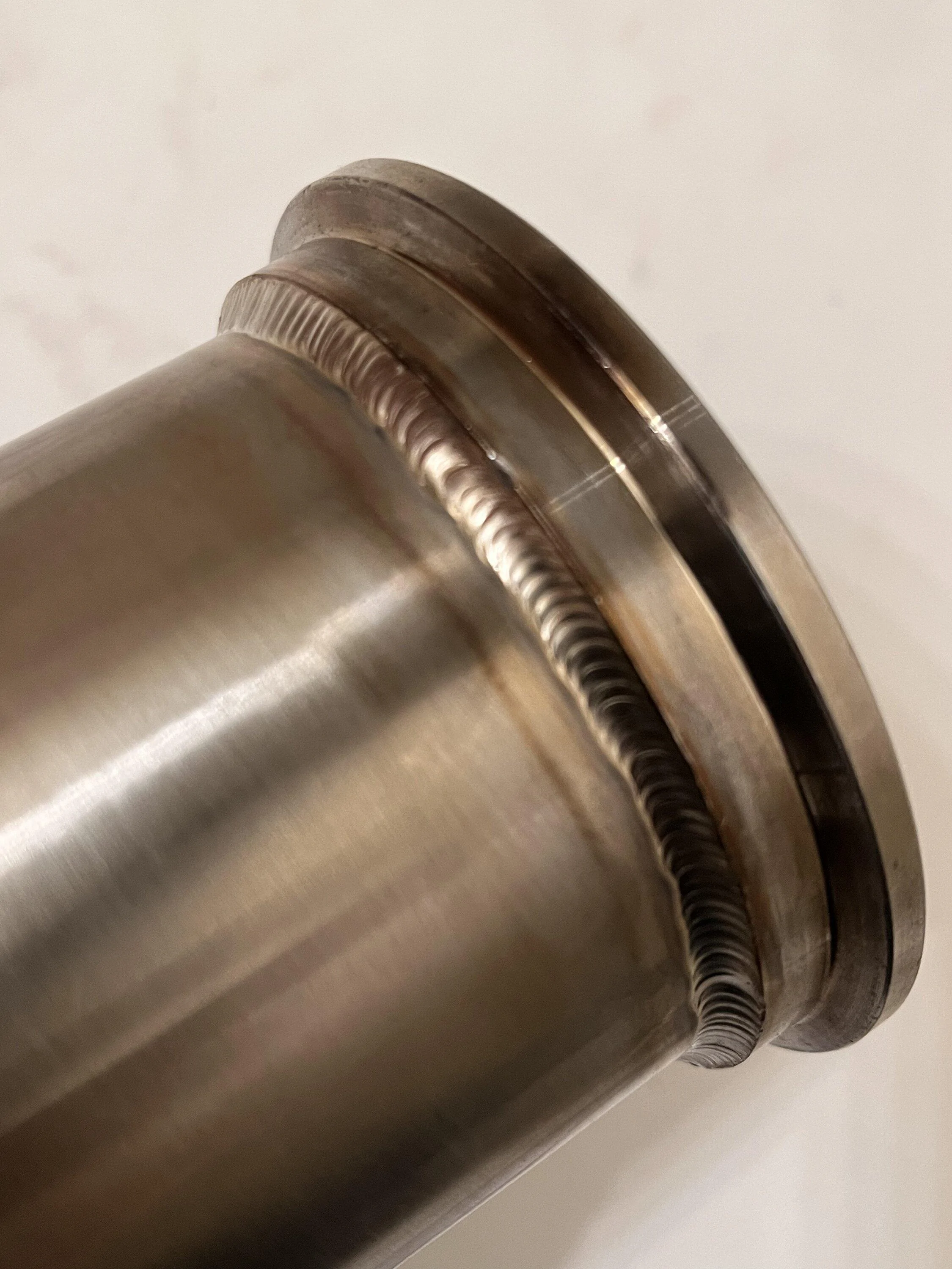

Looks good keep us up to dateTurboback from Stainless Works showed up today. I’m hoping to set a day aside in the next 2-3 weeks to get it installed. Quality looks great. If I can take a video that replicates what it sounds like in person, I will post it up.

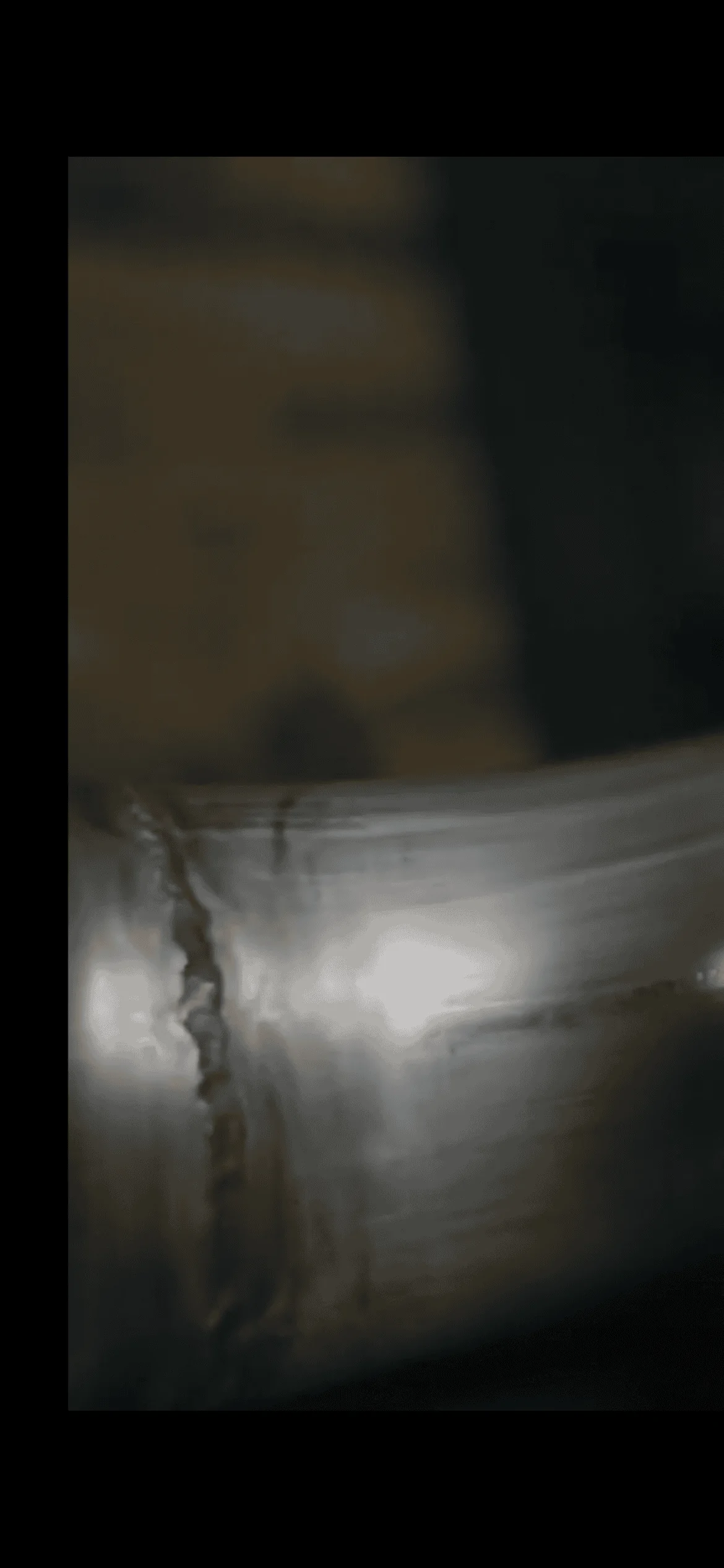

Narrowing down the "drone" may be a work in progress. I did begin a "stage 2" e-tune which did help some of the drone at lower loads. The tuner still has some revision to be made, but the truck feels much more responsive. I've also since noticed the band clamps still allow the exhaust to move/turn even while fully clamped down. One connection is actually allowing the carbon through the slip joint. Somewhere down the line I will be removing all the clamps and using copper gasket maker before I tighten everything back up.Finally installed it over the weekend. I still have some driving around to do to but it sounds good from the outside. Inside the cab (with windows up) might be a little too much for me. Definitely have some drone around 2200-2500 rpm while accelerating. Cruising is fine at all speeds so far. I've tried to take a video that sounds similar to in person, but the phone videos don't capture the sound right.
“Tolerate” itFinally got around to trying some fixes. I'm not of fan of slip joints on exhausts, so I had them welded. I also ended up having a vibrant ultra quiet resonator welded on right after the down pipe. There is still some drone at about 2200 rpm, but I can tolerate it. Drone without the resonator was a bit too much for my taste. I'll try and get some good sound clips over the weekend.
