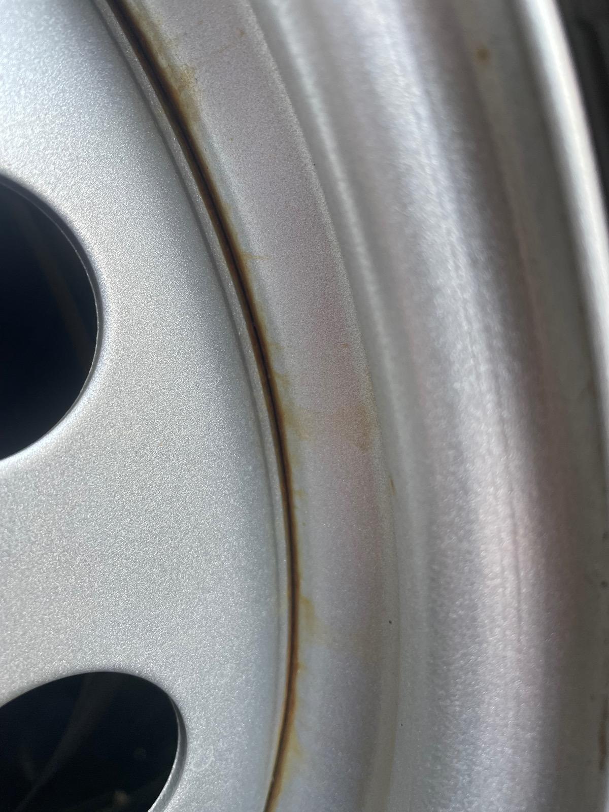

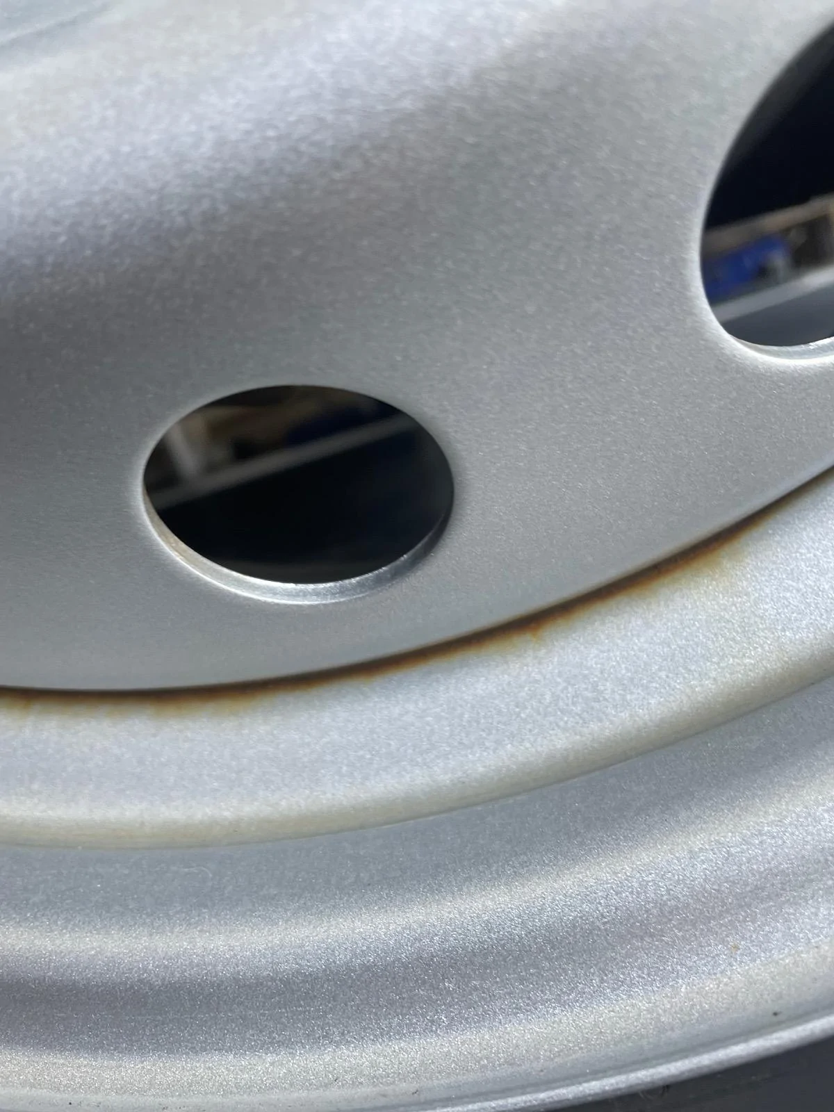

MAXMAV - DO YOU TAKE THE WHEELS OFF AND LAY THEM FLAT WHEN YOU APPLY THE WAXOYL?
I have the wheel upright when I spray them because it is easier that way but them lay it flat in the hot sun so the waxoyl seeps into the gap
