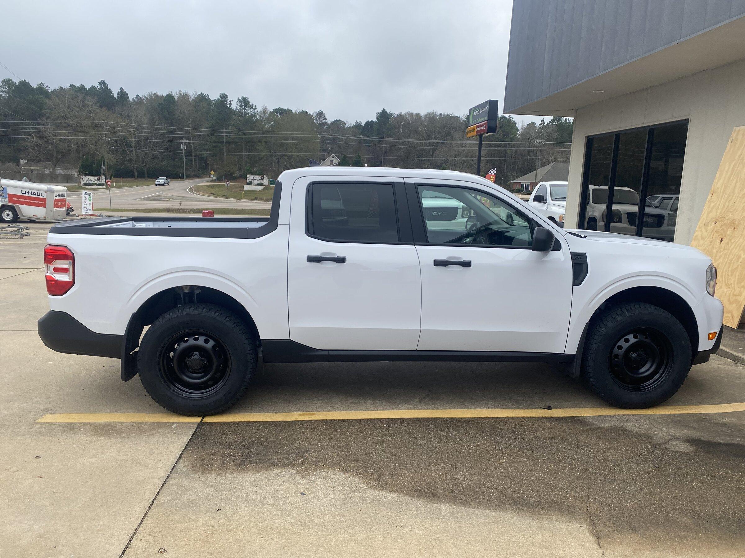

Installed it on mine. It’s a fwd 2.0 eco XL. No issues on install and no rub on 245/70R17. My shop is a rough country dealer and installer. After going over the dimensions and install instructions I knew I was going to install one for my personal truck.
I was hoping the leveling kit would fit fwd models. Thanks for the info.
Looks great! Thanks for the info. That is the two inch kit you installed correct?
1 inch kit for the front. Rear springs are different from fwd to awd
Did you have to do a realignment after install?

Absolutely do an alignment
