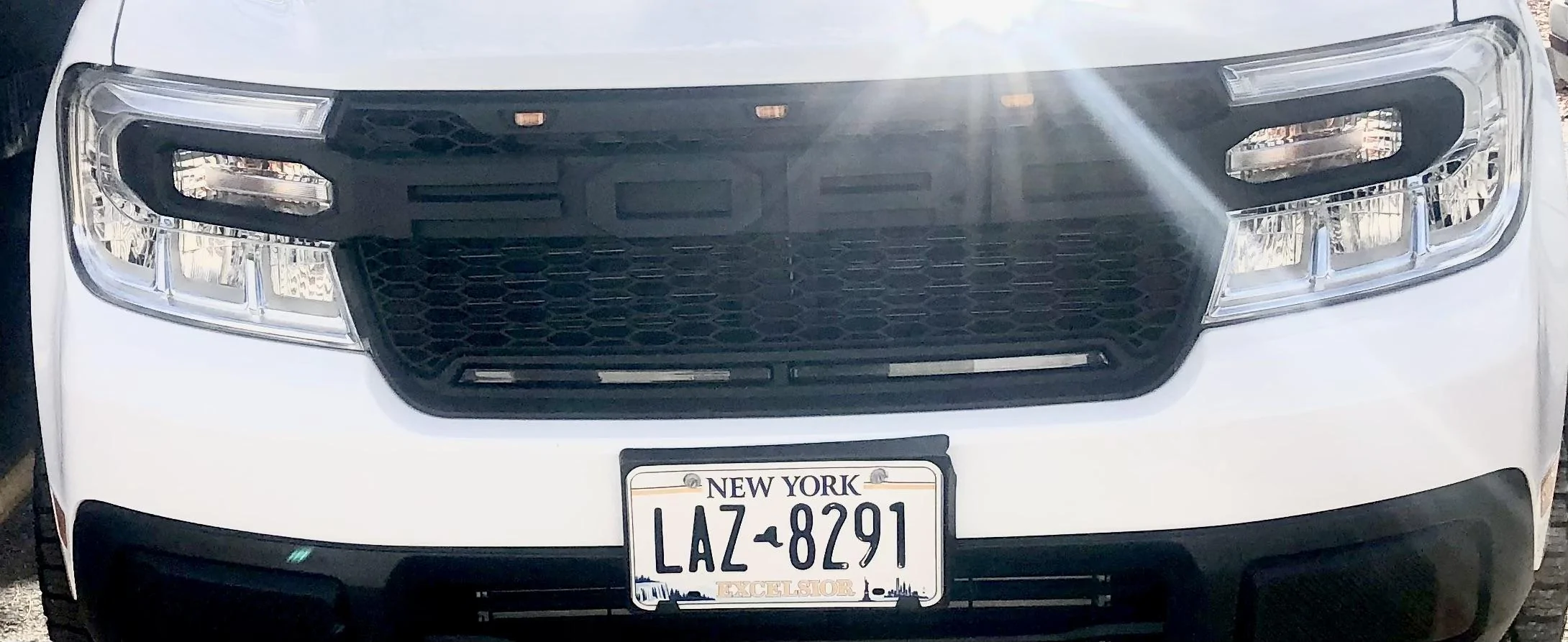

Got this from “goodmatchup” for 265 free shipping. It’s pretty much like the others I’ve seen except it has the turn signals in addition to the 3 amber “raptor” lights
it’s 4 wires to connect. Power from headlights, ground, and power for each side turn signal. I’m all about heat shrink and being crazy but on this one I just used 3 T-taps and some zip ties. The power wire has an inline fuse.
I didn’t realize the turn signals are sequential.
I haven’t seen many others with the signals but maybe people just don’t wire them?

I wired the lights to come on with headlights as these are also daytime running lights. This Chineseum grill comes with no instructions of any kind so I'm not sure if they are meant to come on with the amber Park lamps. ... but then they would only be on at night. It would be extremely easy to swap the feed but I'm gonna assume I have it right as the wires for the 3 ambers is signigicantly larger than the turn signal wires in the grill harness... seems like it was meant to be spliced with a larger wire. I had no interest in a separate switch... I'm the guy who'd forget to turn it off or on lol
for the price, it's pretty impressive. the 3 ambers, the lower lights which have white and amber- they all connect together with weatherpack connectors and some thought went into it because you can't connect them wrong aside from the final splicing into the vehicle.
