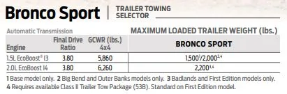

Towing info for the Bronco Sport which id think would be the same...
https://www.ford.com/cmslibs/conten...df/guides/21Towing_Ford_Bronco_Sport_Dec3.pdf

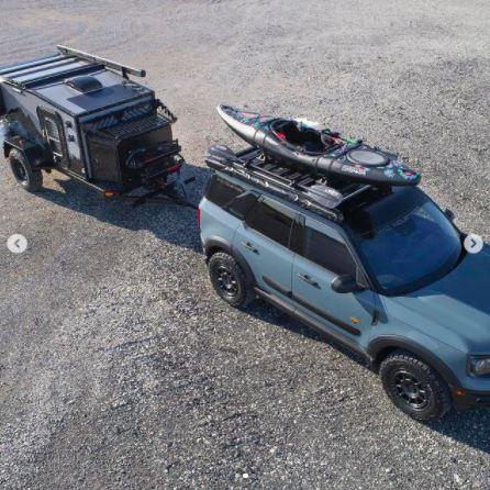

The SEMA build from MAD Industries was pulling a Boreas Camper AT that has a 2200 dry weight.

Yes, thanx for posting this! The Bronco Sport actually has a lower towing capacity than an AWD Escape? Yikes!
I owned a 2014 Escape AWD (same platform) and it had a 3,500 lb. towing capacity.
That low a towing capacity would be a deal-breaker for me. 😑
