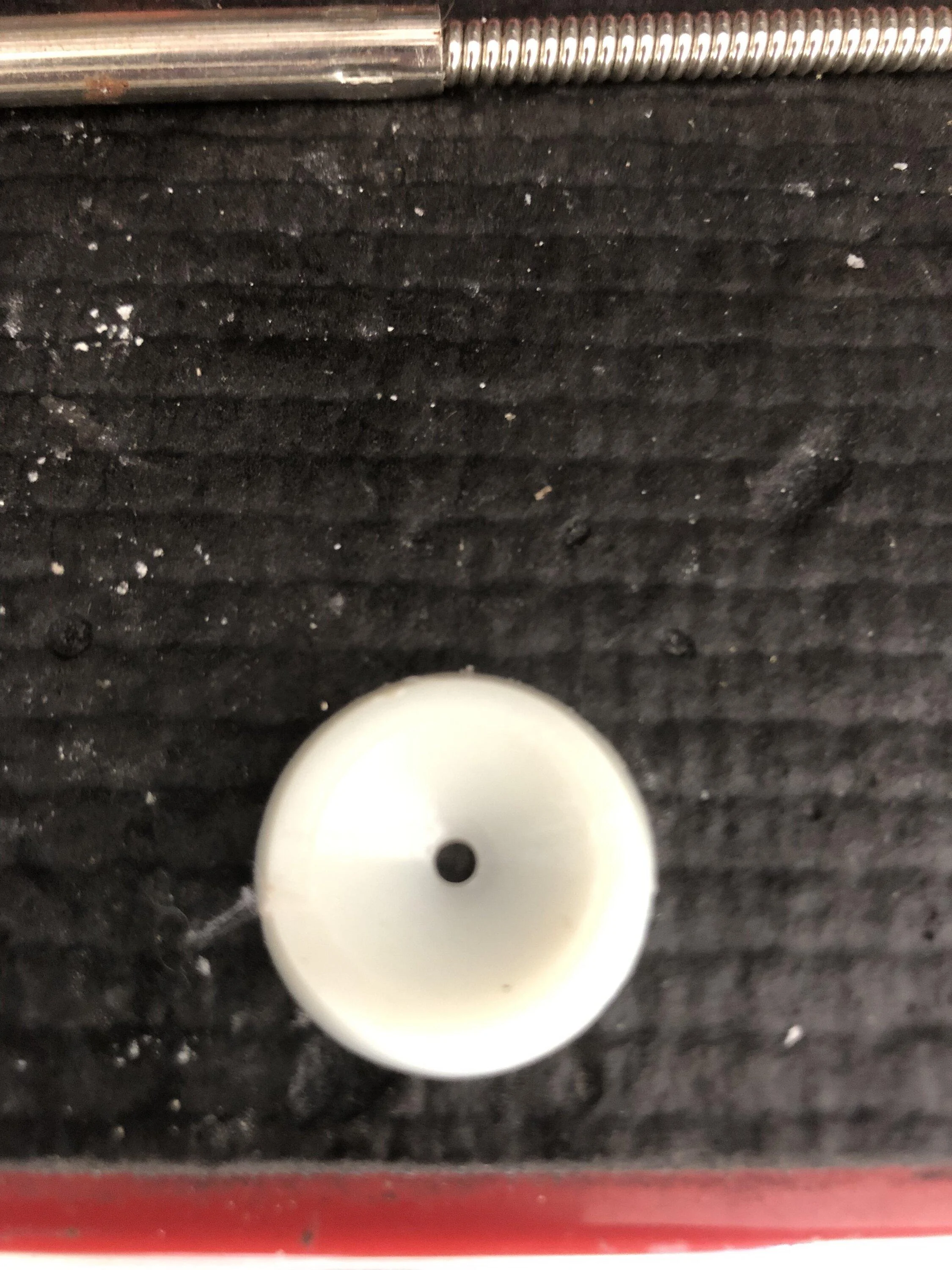

I had some Motorcraft ULV transmission fluid left in the garage cabinet from a previous vehicle so decided to do a dump and fill on the Maverick transmission while I was under anyway changing oil. Obviously way early to be needed but I like to keep at least a portion of the total capacity freshened up regularly.
Ive done countless 6f and 8f dum and fills in the past but much to my surprise when I went to fill the fluid through the vent tube as usual it acted as if it was blocked off and made a mess/over flowed. Took the whole vent tube off with spring clamp and found a little white plastic plug/disk wedged up inside. I'm pretty sure thats not supposed to be there, probably something leftover from assembly. But it crated quite a mess and some thorough cleanup. Not fun.
Just hope this helps someone else....take a look and make sure before you go to add fluid. Just as a general reference I got about 4.25 quarts out after letting it drizzle and drip for an hour or so and according to the level check procedure it was pretty much right on the money after adding back in that same amount.

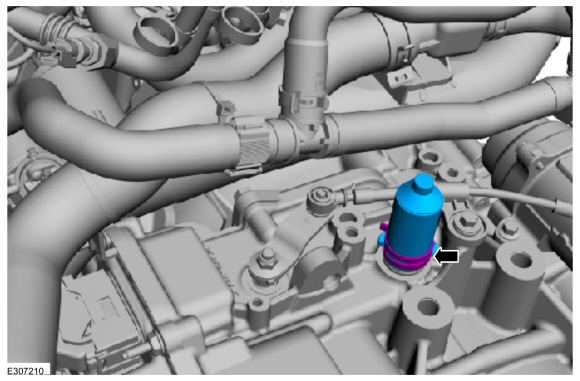

  1. Release the clamp and remove the transmission vent.
Ford Maverick PSA for those doing a transmission fluid dump and fill 71330247762__99237494-901A-477C-9C81-DC058FB59C68

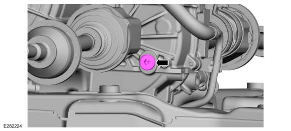

  1. With the engine running in PARK, remove the transmission fluid leveling plug and check if transmission fluid seeps out of the transmission fluid leveling plug hole.
this is the proper method

Correct. Ive just never encountered that little plug on any other similar vehicles before. In my experience the removal of the vent tube was unnecessary and you could simply remove the vent cap and put a skinny funnel in to fill. Spring clamps in tight areas are a pain if you don't have to.

hope you put it back in,it's a baffle for the vent so it won't purge when hot all over top of trans.
I did not. Ive never seen that in the countless other similar Ford transmissions Ive serviced with a similar design such as the 6F and 8F in edges, escapes, etc. If it pukes out some fluid then we shall see but I don't see it as being a necessary component since so many other similar designs have not incorporated it in.
