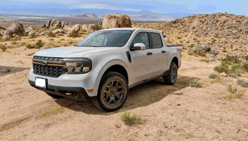

I'm looking to add off road protection to my tremor to do some light off-roading. I live in a very rocky/sandy environment and this vehicle is perfect for accessing rock climbing/camping/dirt biking areas in BLM. Has anyone found full underbody skid plates and rock sliders yet? I found a few websites that list similar products (links below), but have no idea if they fit. Any recommendations would be appreciated. Here's a picture of my bone stock tremor out in the wild.

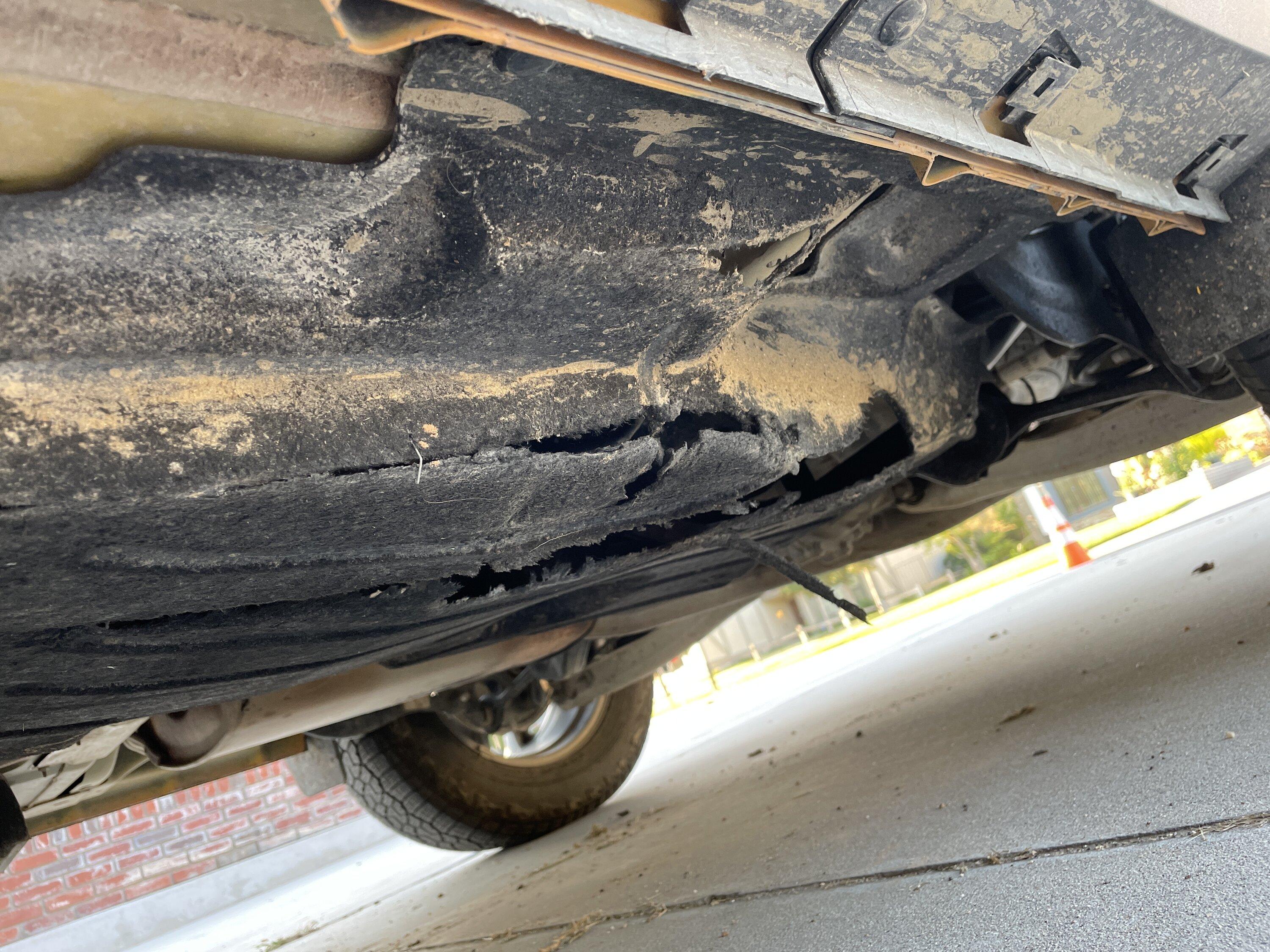

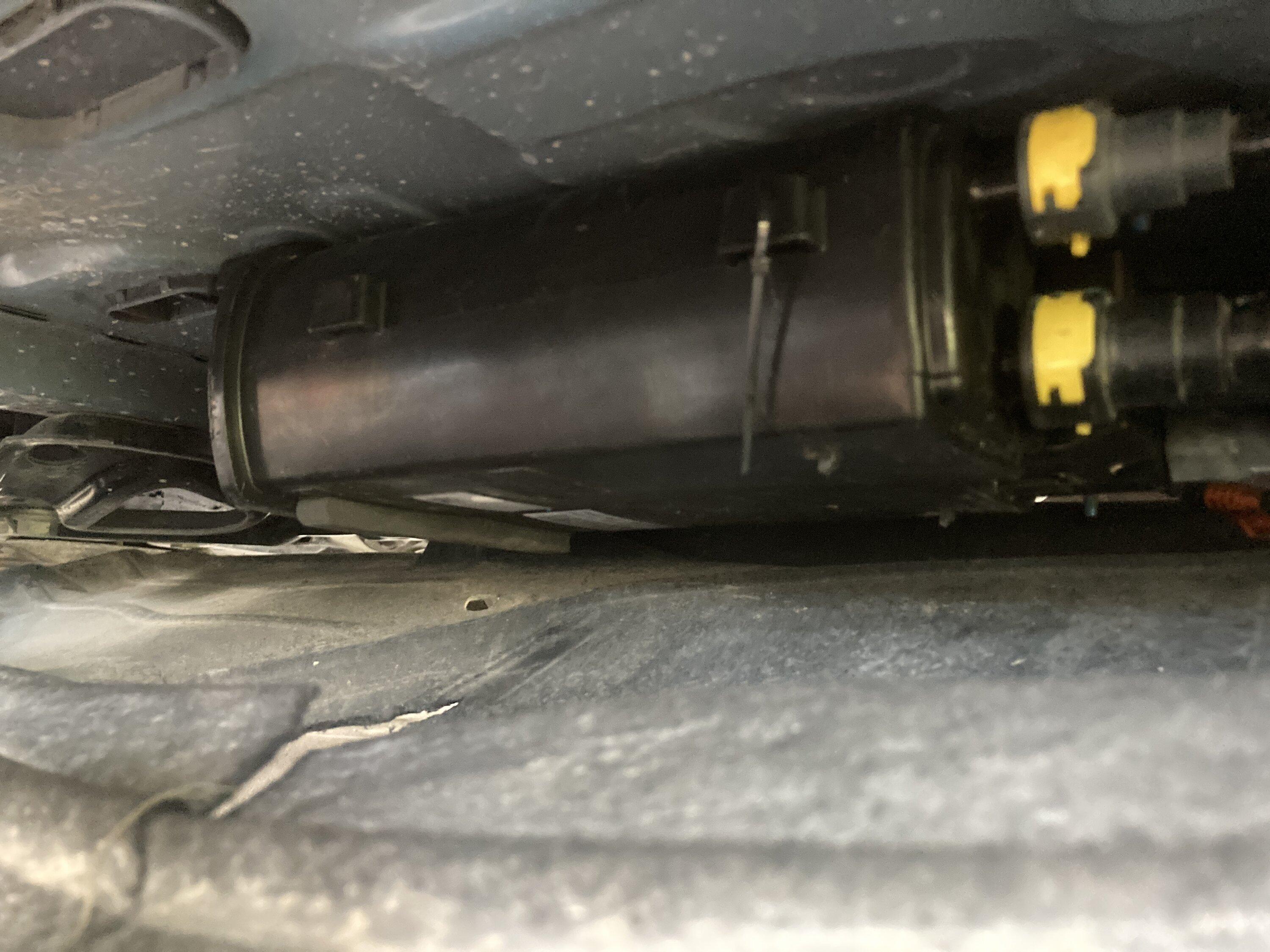

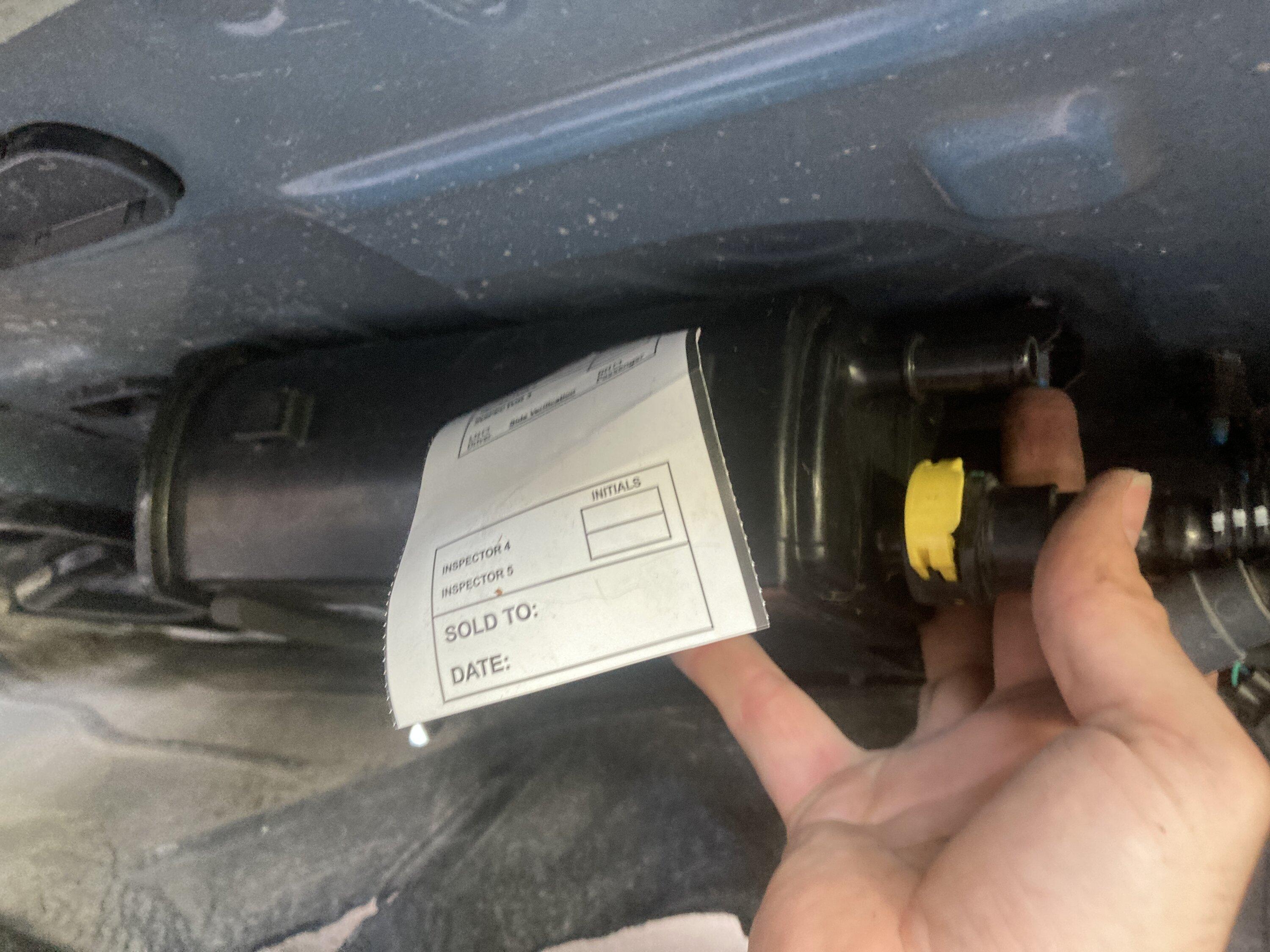

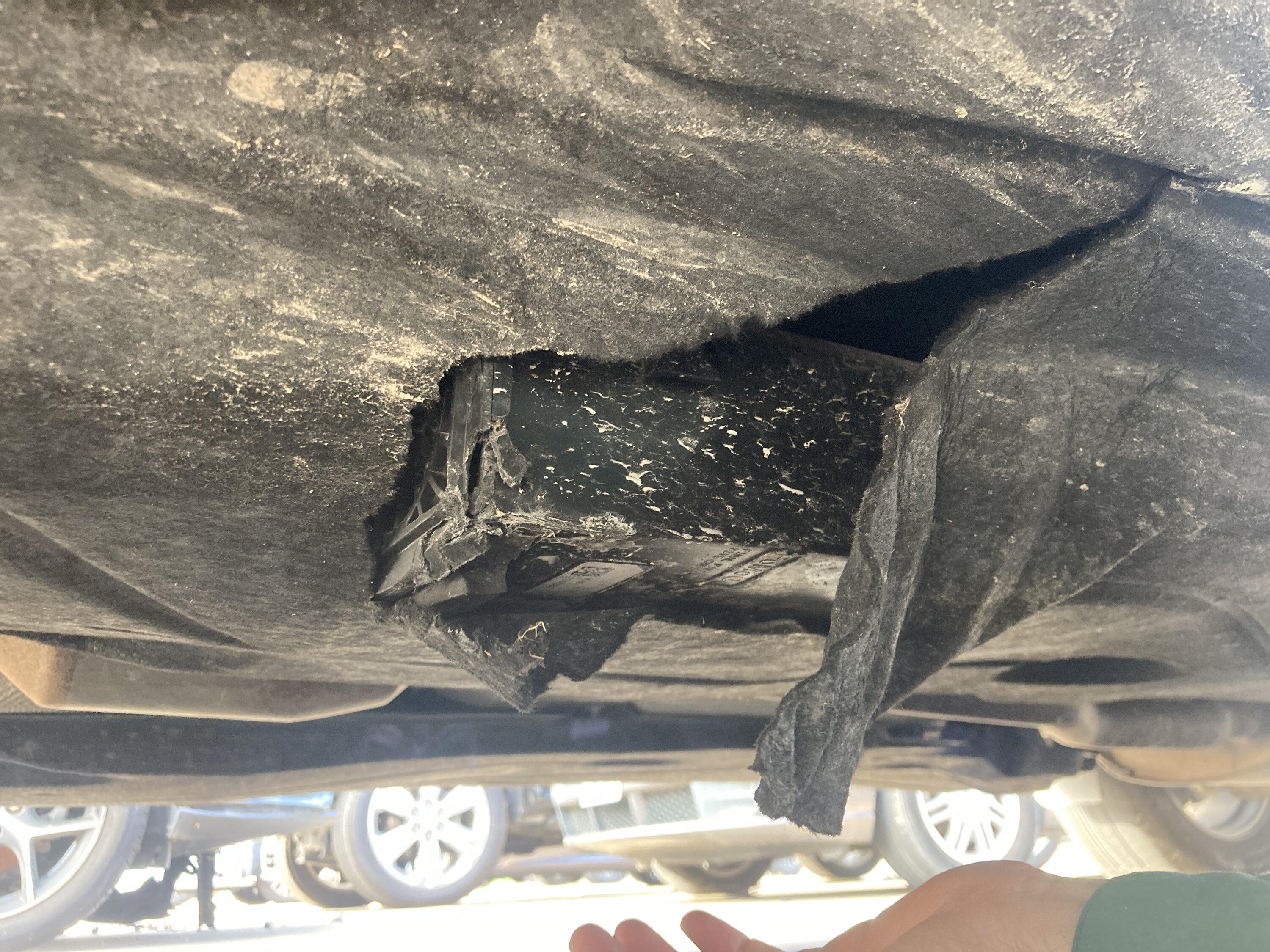

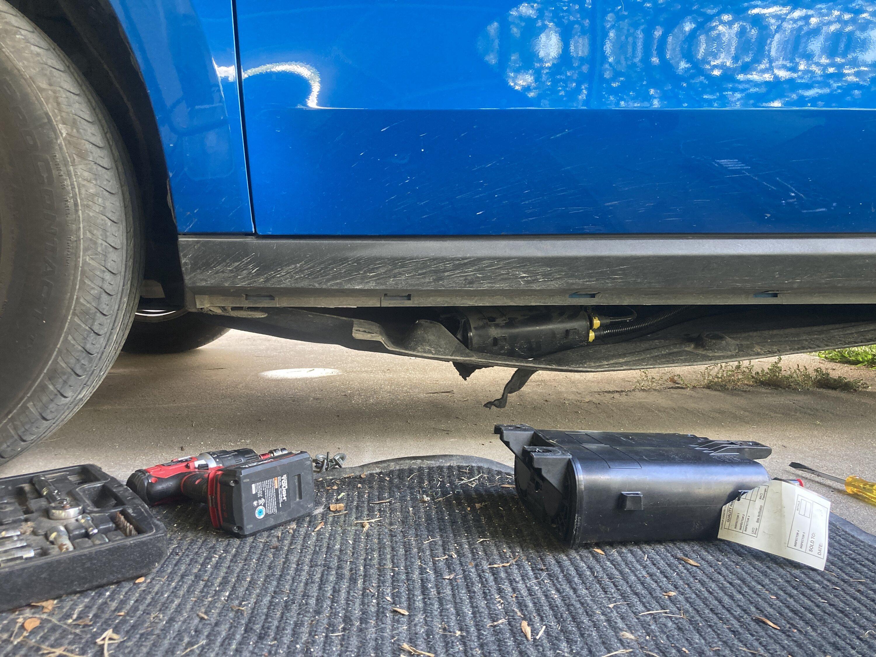

Anybody know what this box is? I broke it loose bottoming out while hopping a curb 😣
I’m doing my part to generate demand for underbody armor…
Rolmav
Mar 13, 2023
91
94
Kansas City
I'm pretty sure that's the EVAP canister.

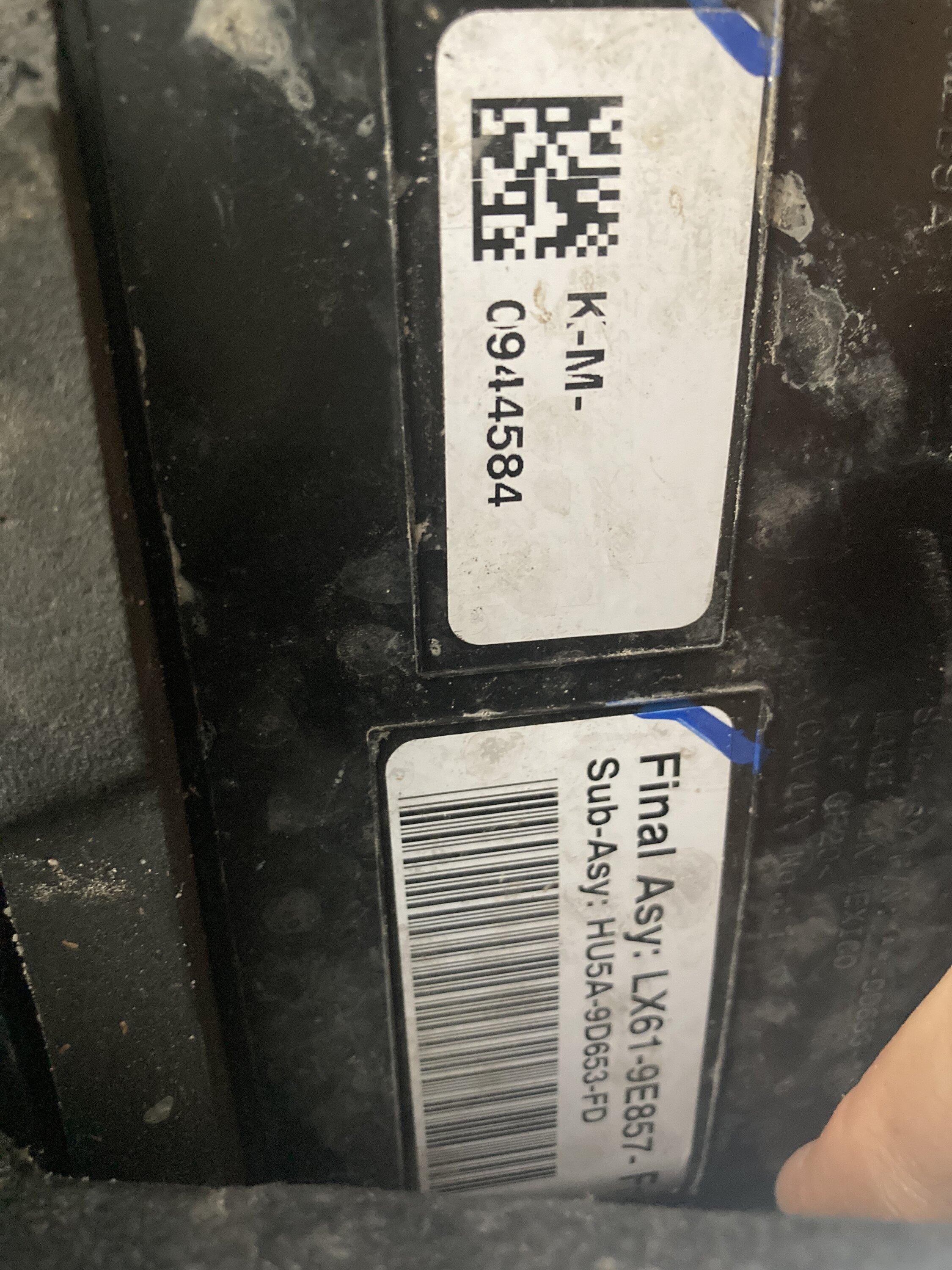

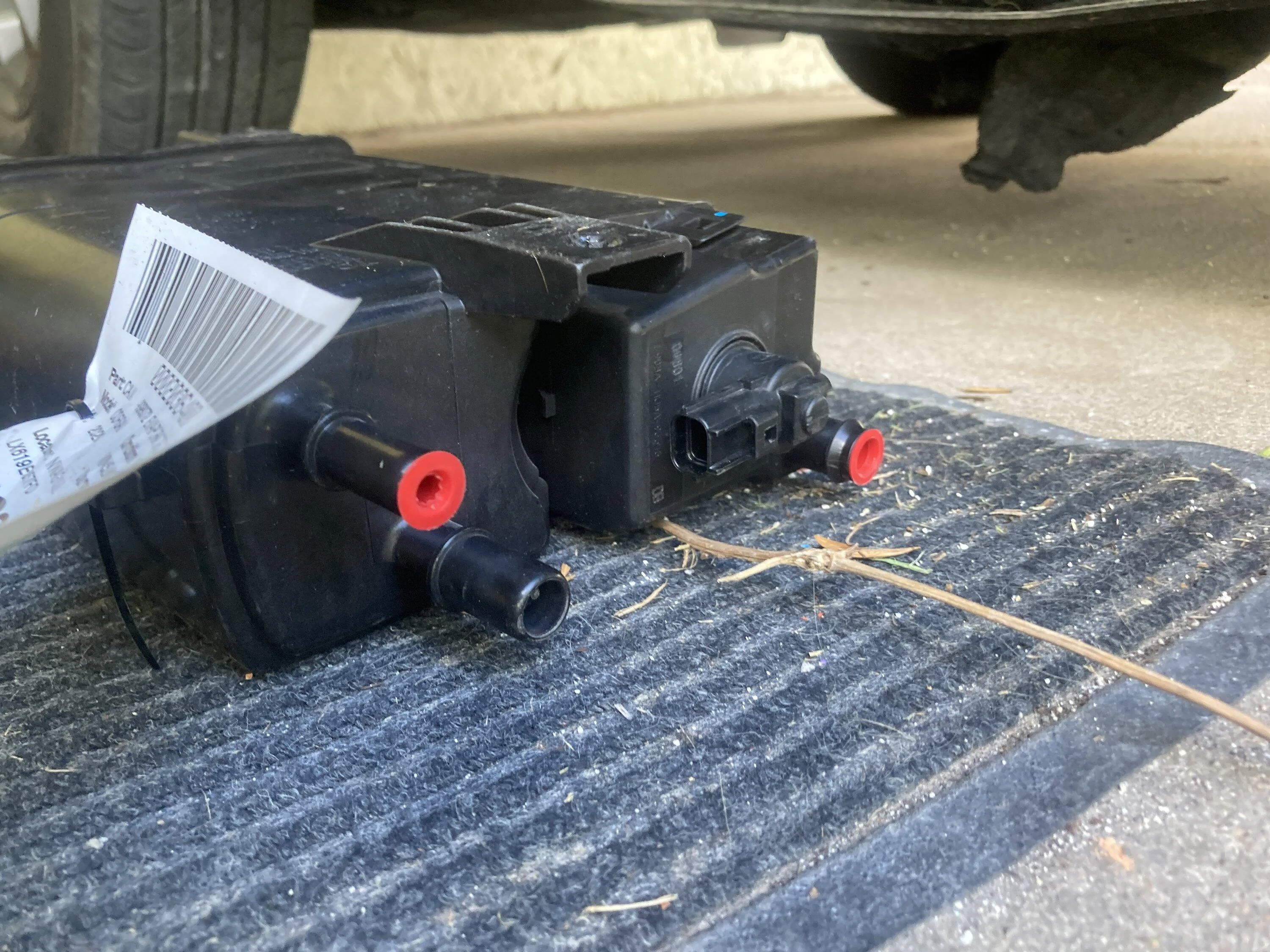

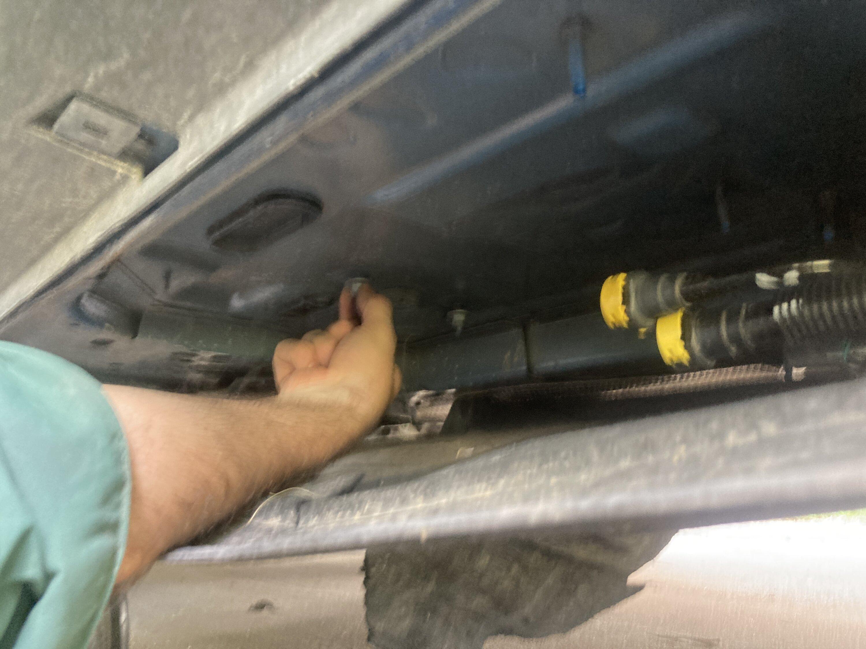

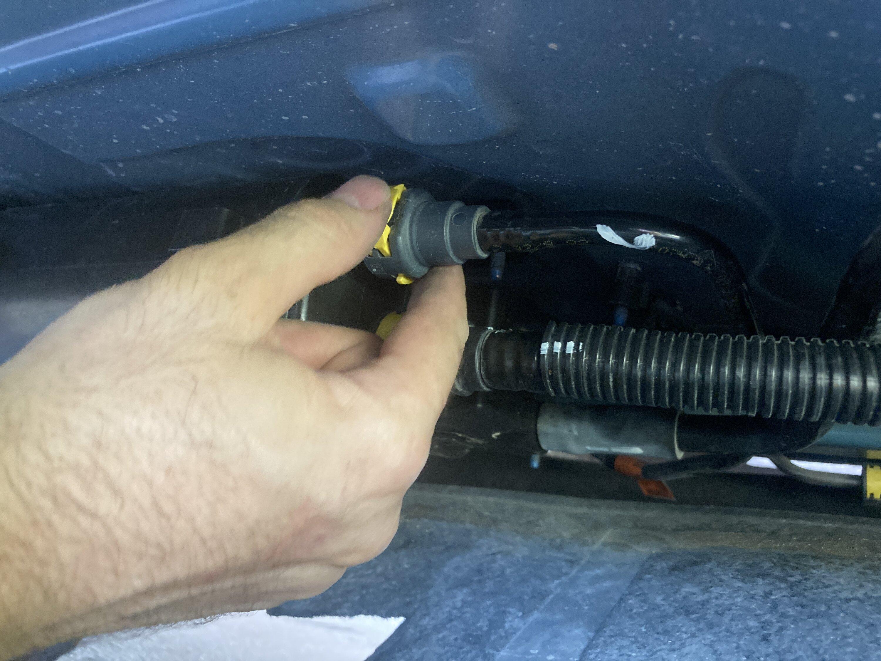

Save $600 on replacement Charcoal Evap Canisters.

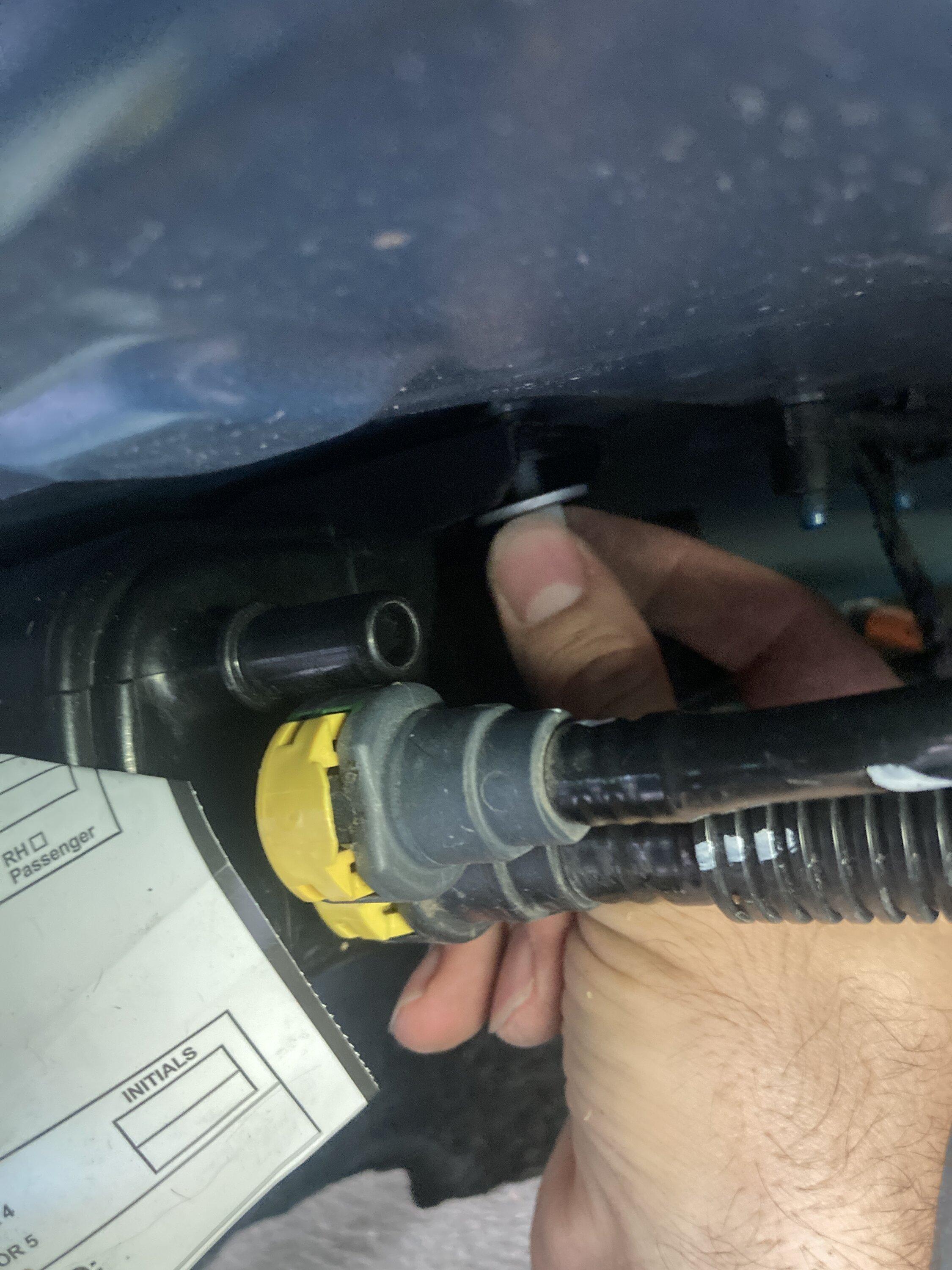

So it turns out the Maverick shares an Evap Canister (part number LX6Z9D653F $459) with a couple other Ford/Lincoln cars/SUV's. You can save a couple hundred $ buying a used one off eBay. I got mine for $224, and it came out of a Lincoln Corsair.

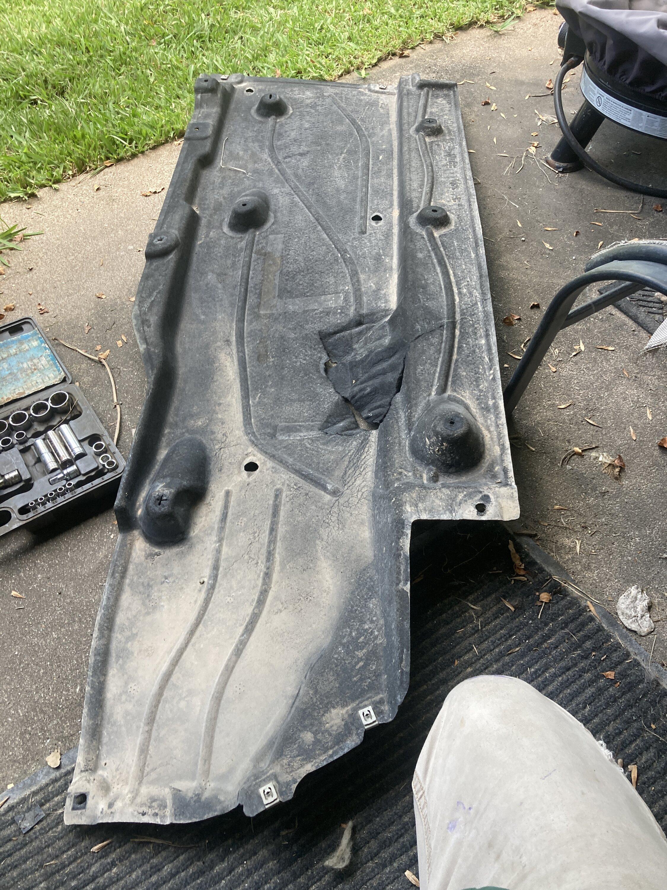

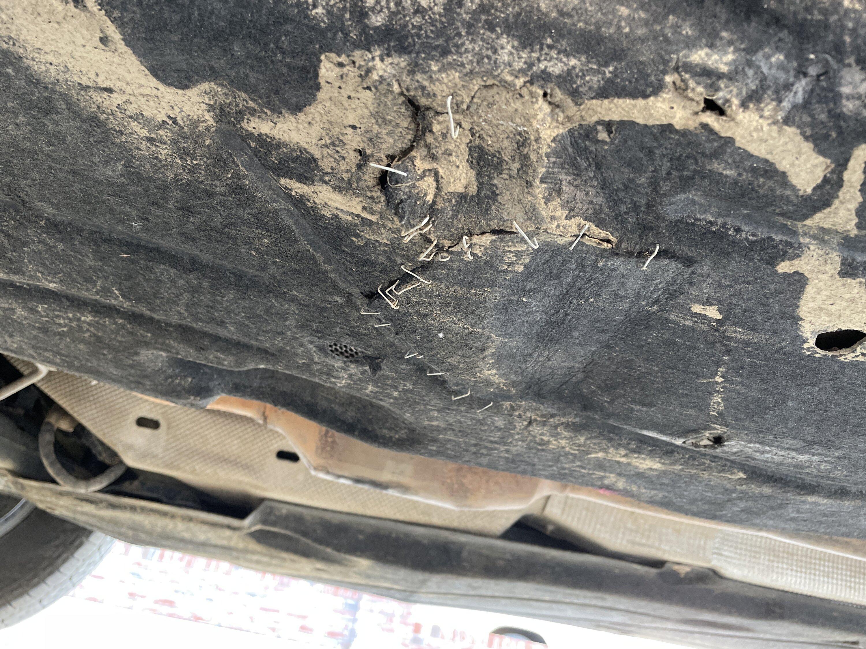

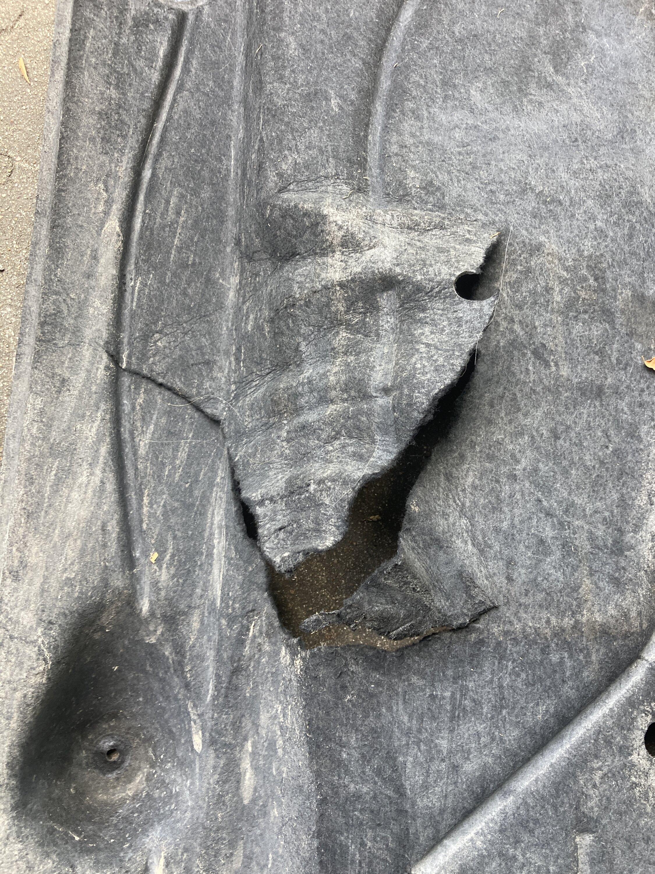

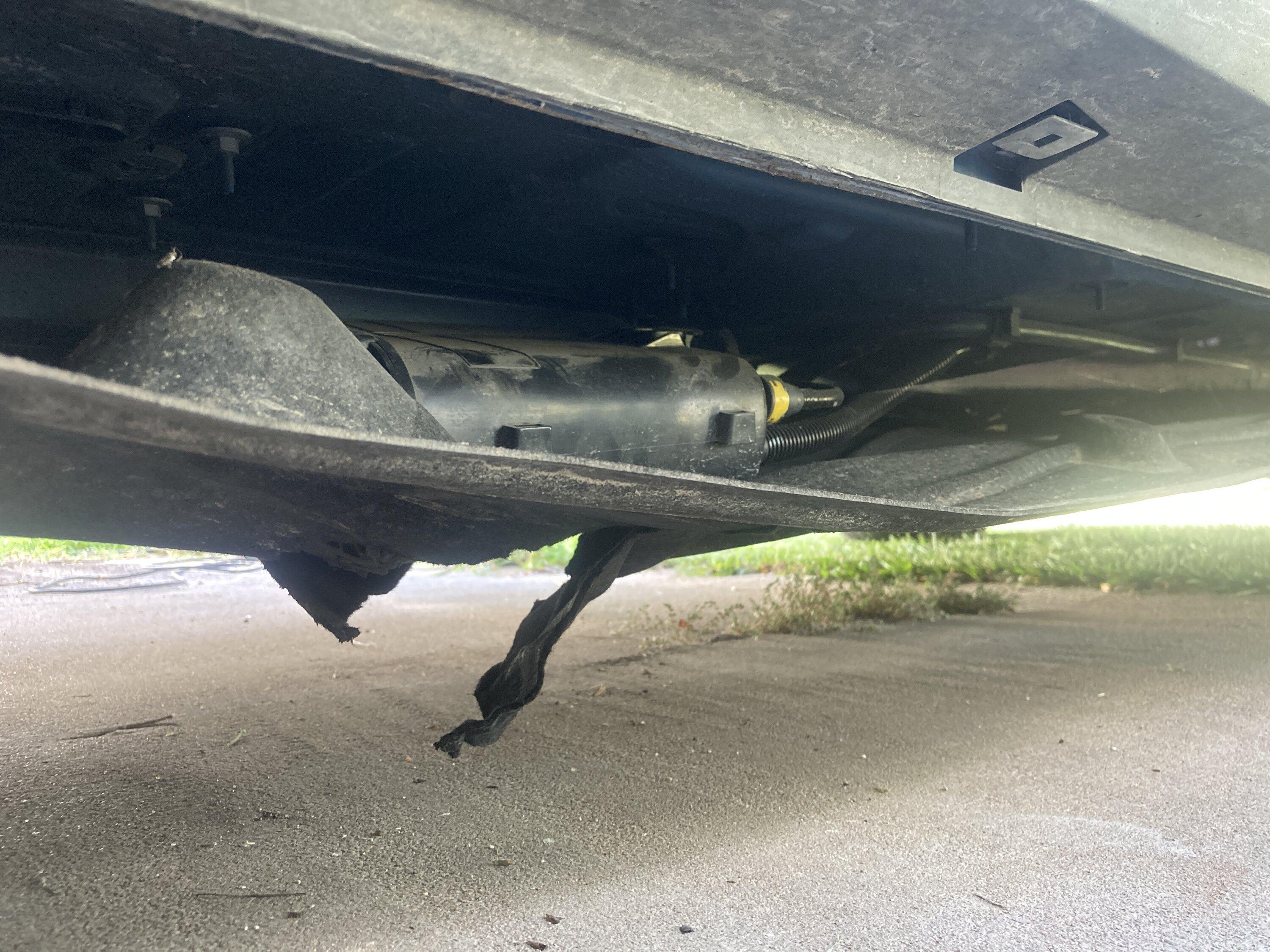

I also tore the felt under shield deflector and Ford wants $97.17 for a new one (part number LX6Z6775R).
AutoNation Ford quoted $725 to replace the Evap Canister and $200 to replace the under shield protector.
This job aint hard enough to pay $100+/hr labor to do for me, and it's not warrantied. I'll save my $600 and put it towards some real skid plates and rock sliders when some manufacturer gets around to selling some armor for the Maverick.

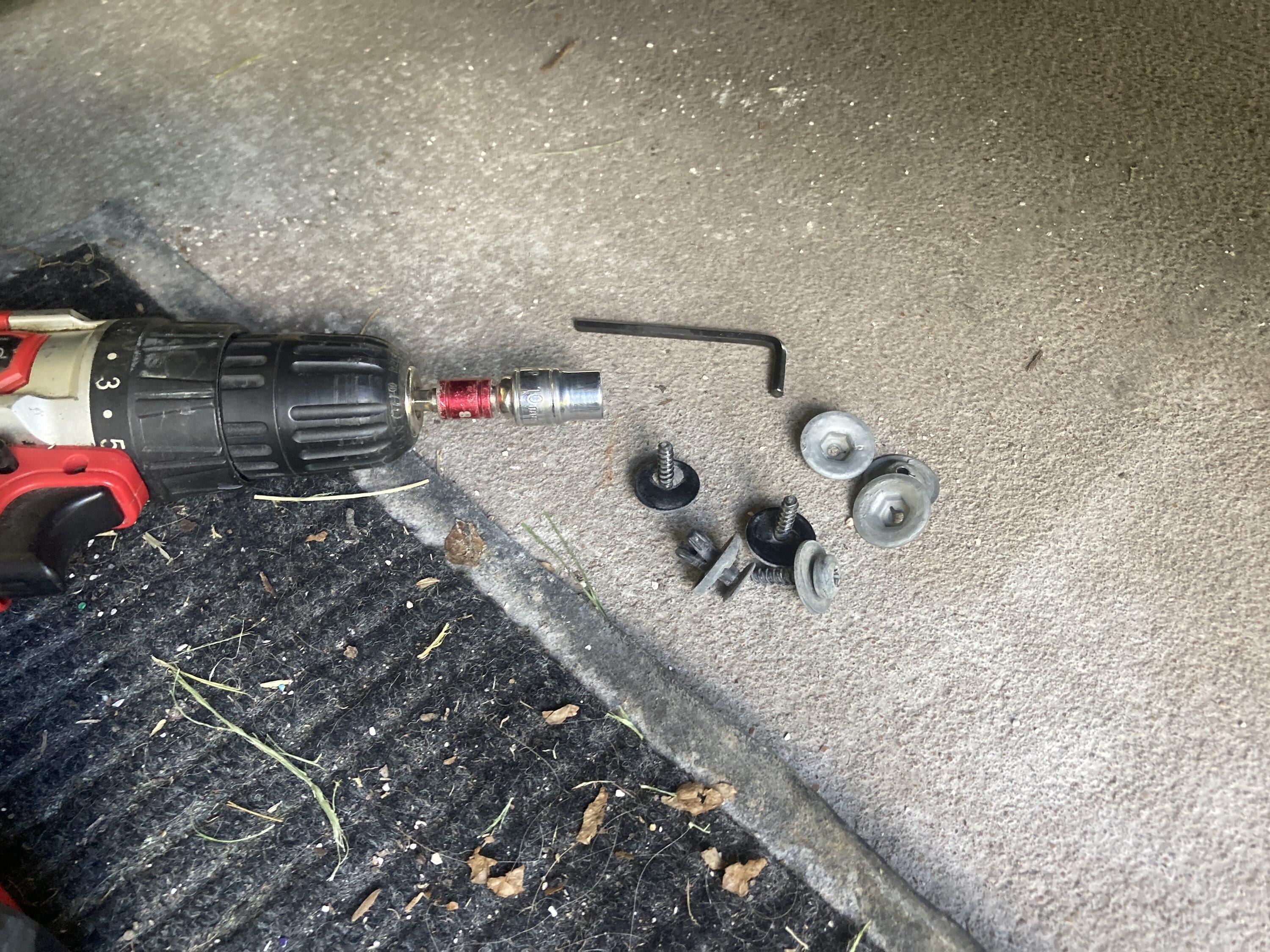

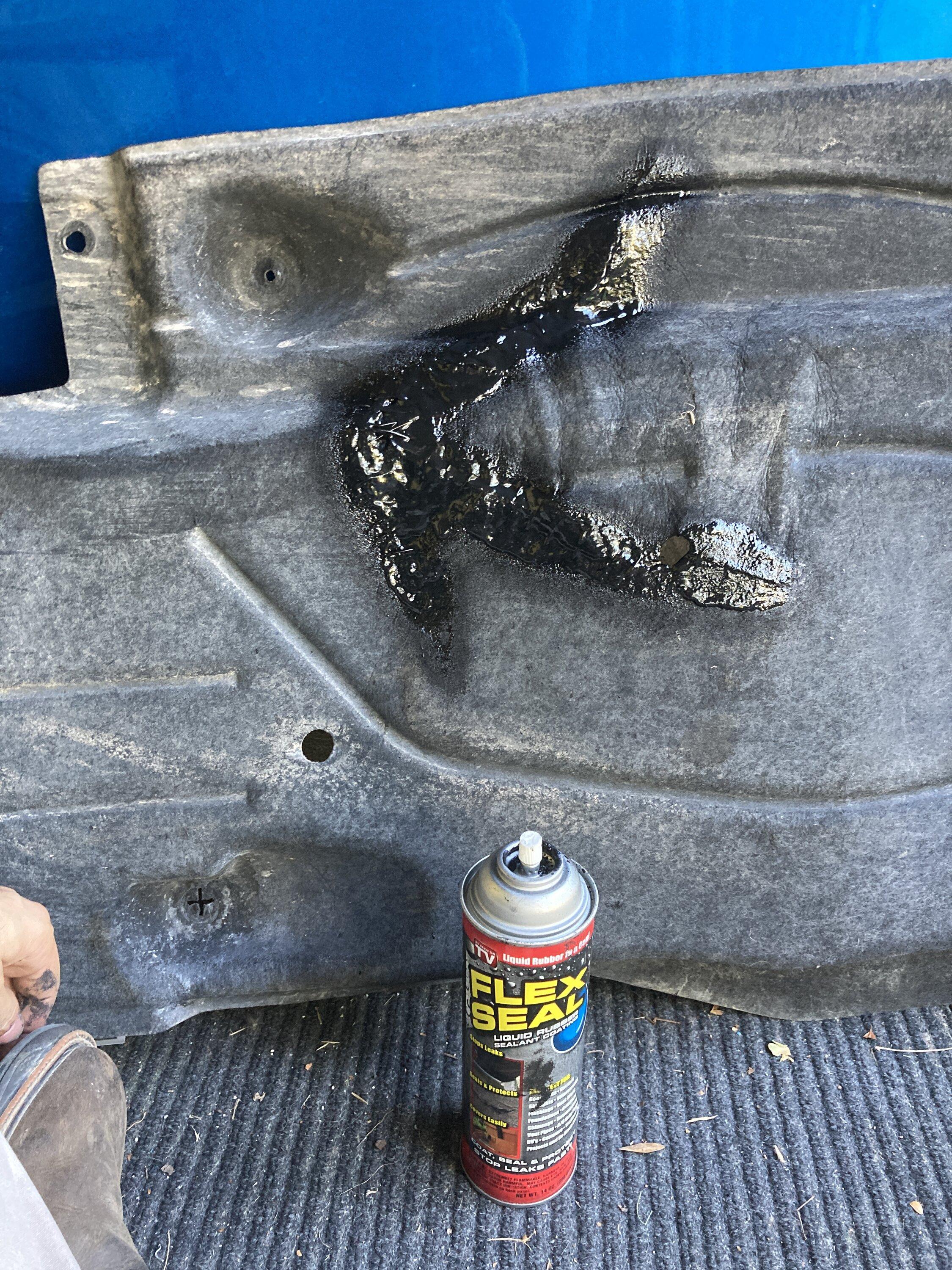

In the meantime, I patched my under shield deflector up with some stainless bailing wire and sprayed flex seal over it. Initially I was stabbing the tip of the bailng wire through the felt, but it turned out to be easier to just drill tiny pilot holes and sew it back together like Frankestien stitches. So far it's held up on the highway. I'll update if the wind catches it and tears it open again.

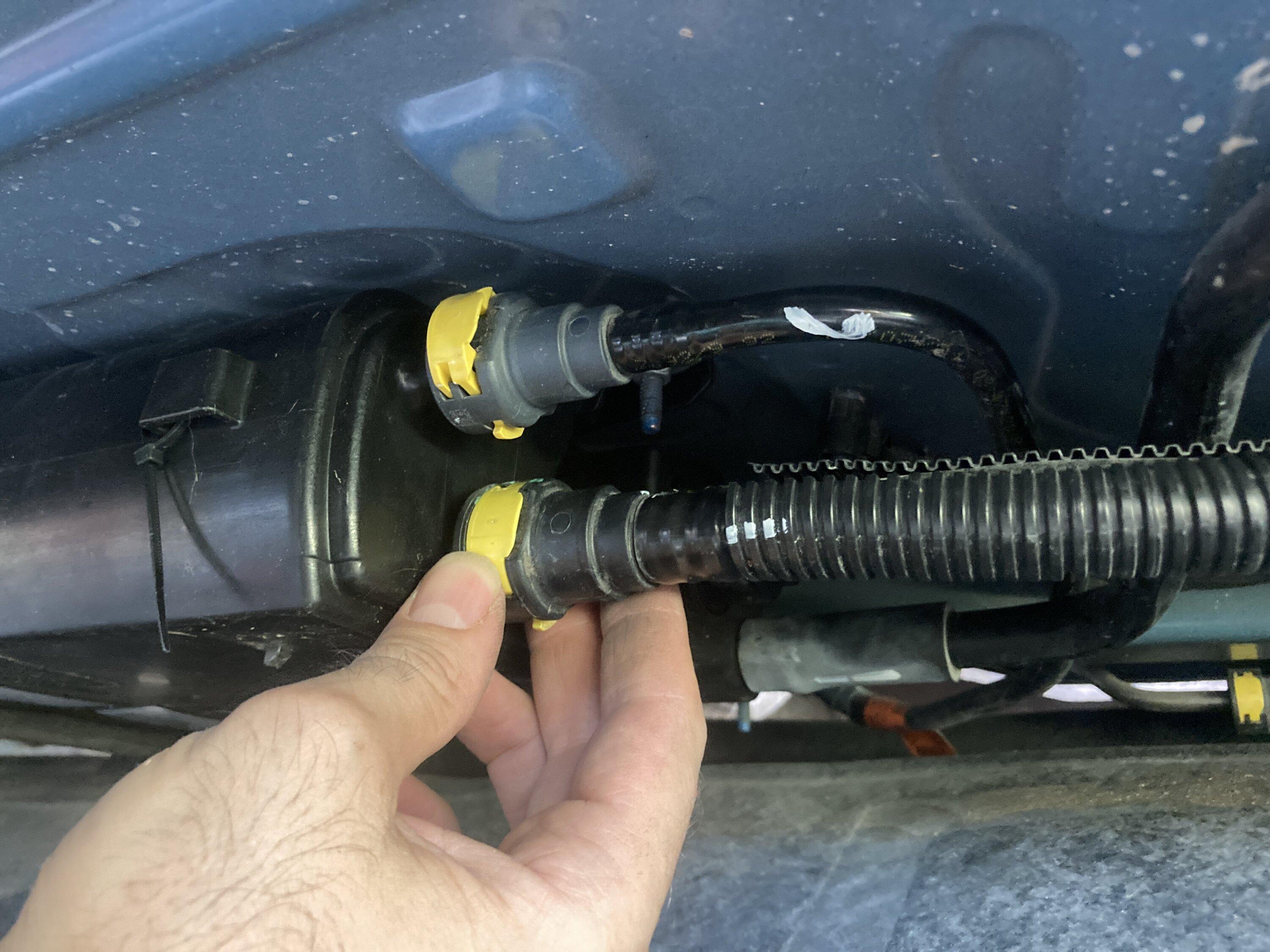

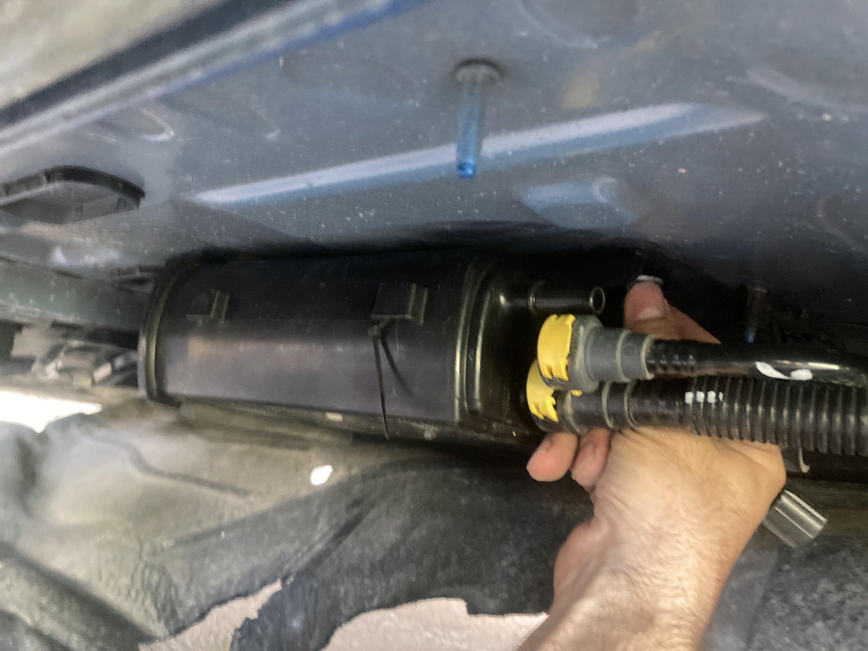

As for swapping out the Evap Canister, it's definitely DIY-able. I didn't even jack the truck up, did the whole thing on my driveway. Didn't have a torx T30, but a set of allen wrenches worked too. The hardest part was getting the wiring harness to let go of the original evap canister. The hoses are easy to get off, just wedge a blade screwdriver under the yellow tab and pop them outward a couple clicks; then the hose slides off the end easily.
One piece of advice I would give is, to bolt it back in place before plugging in the hoses closest to you, it will give you room to install the aft nut.
