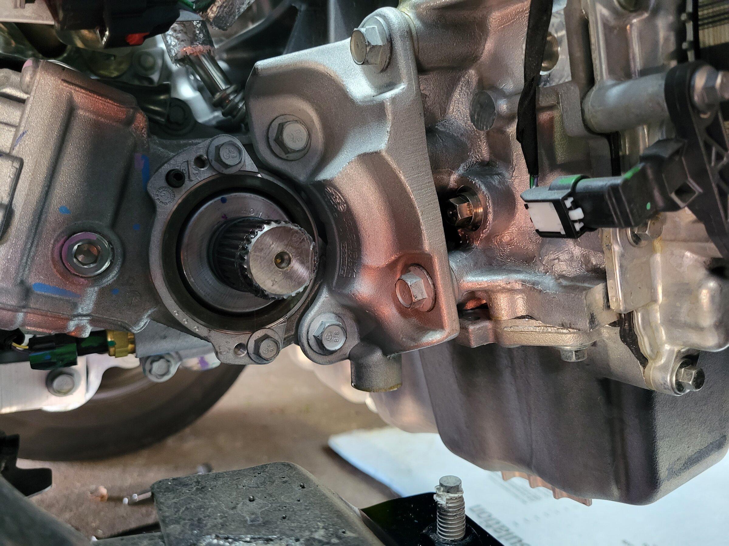

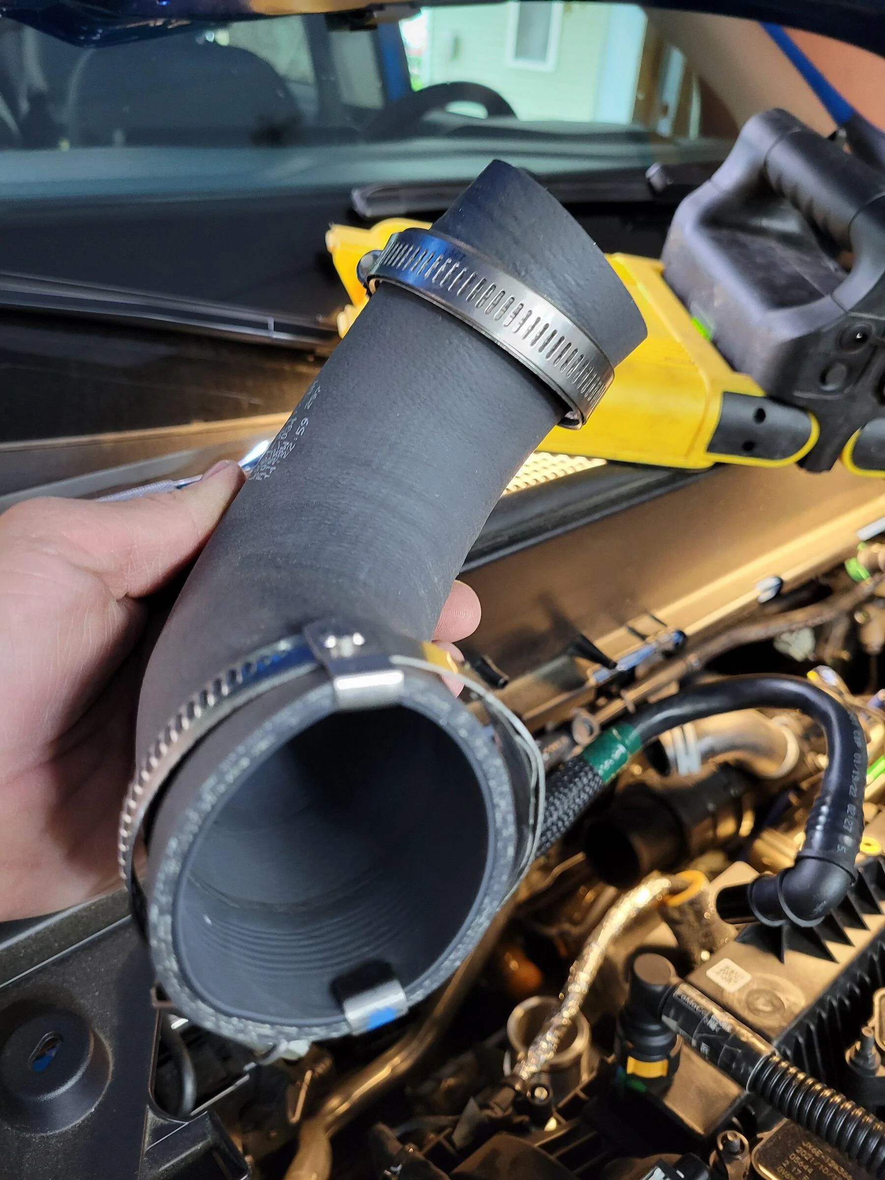

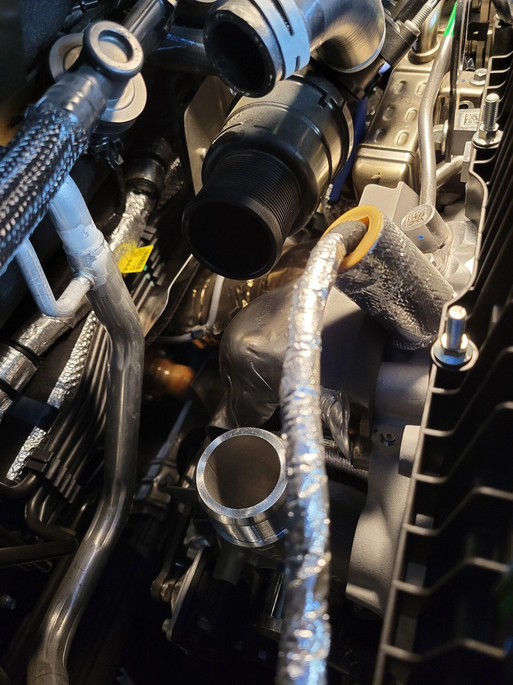

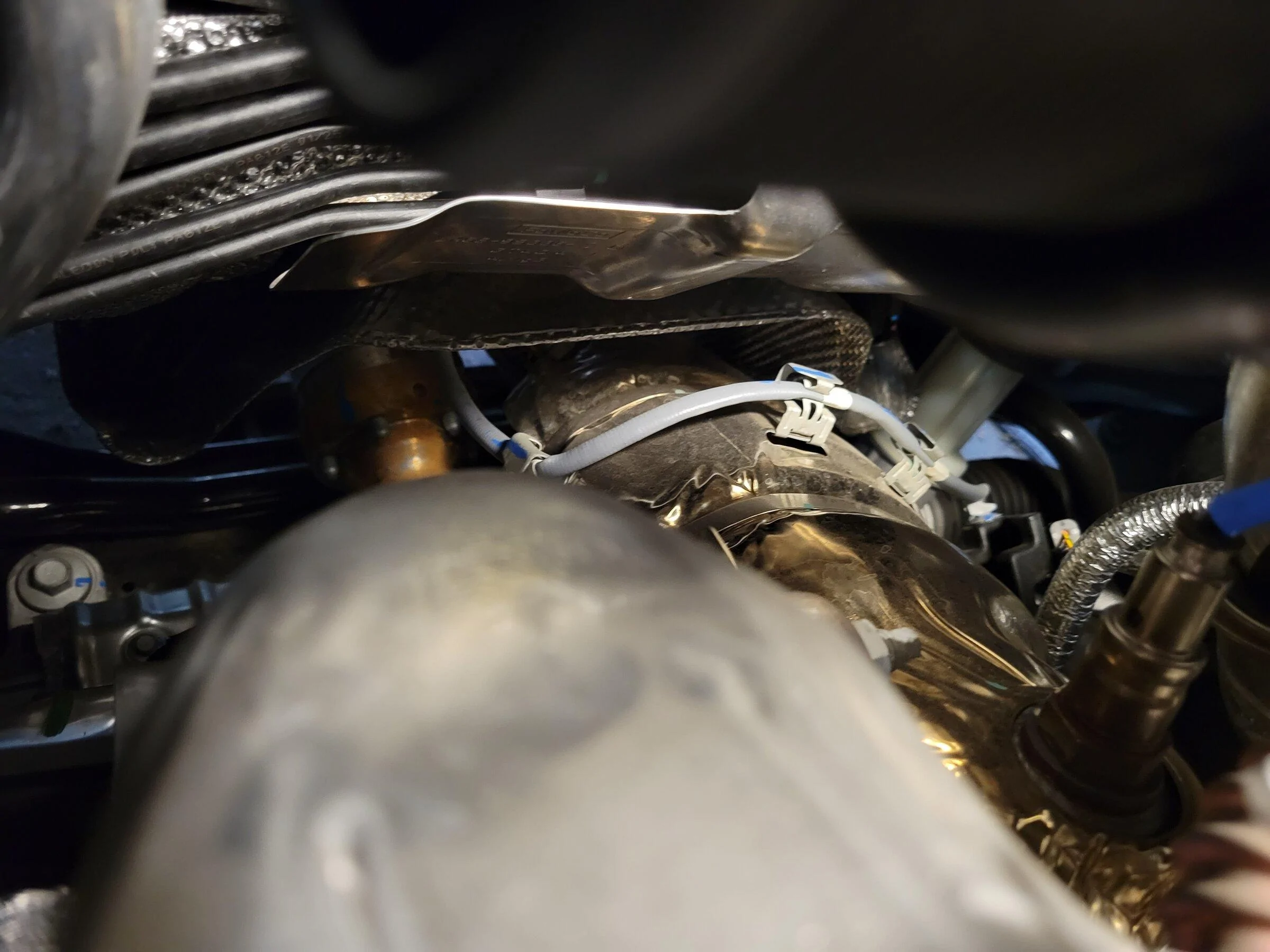

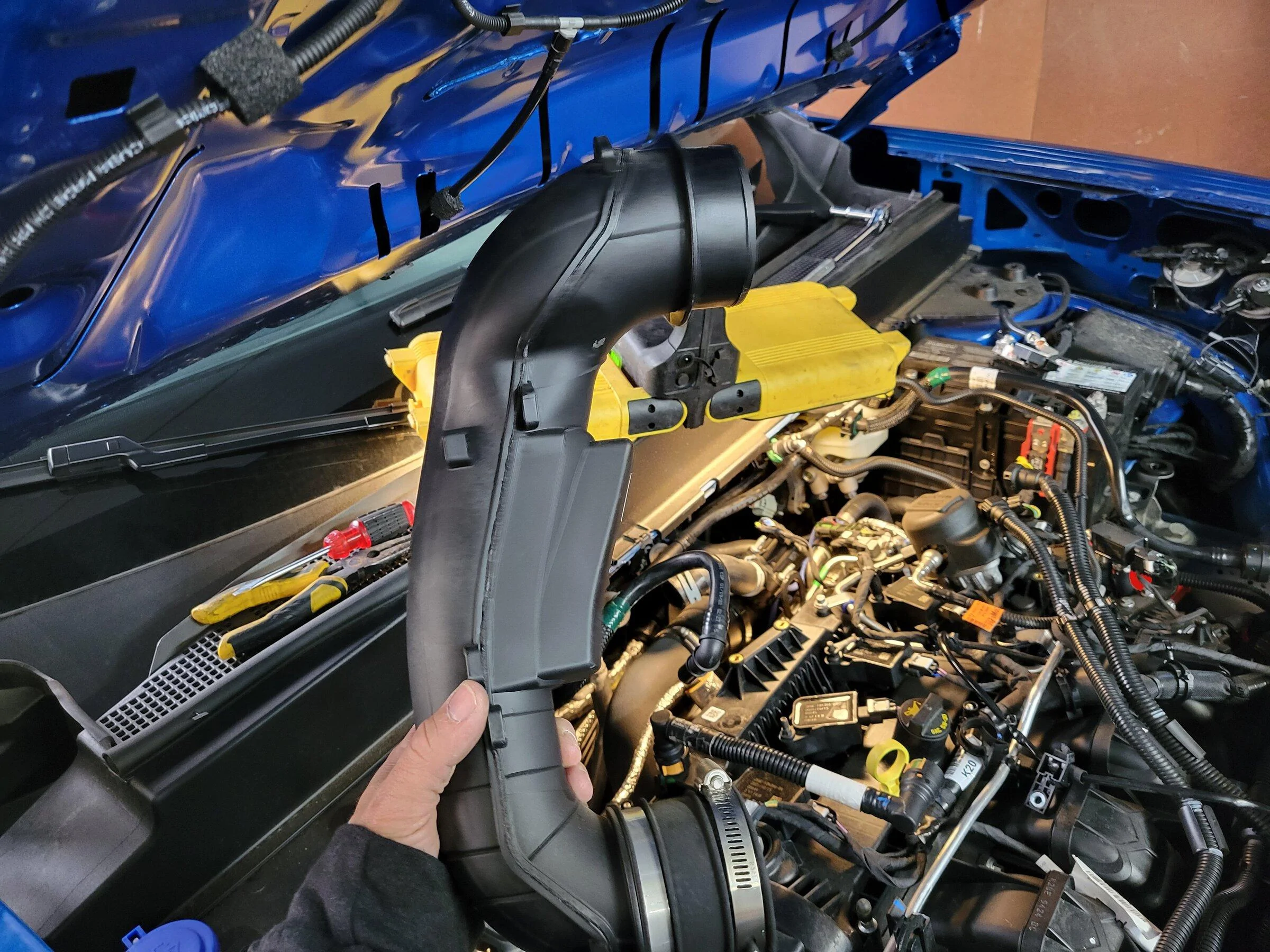

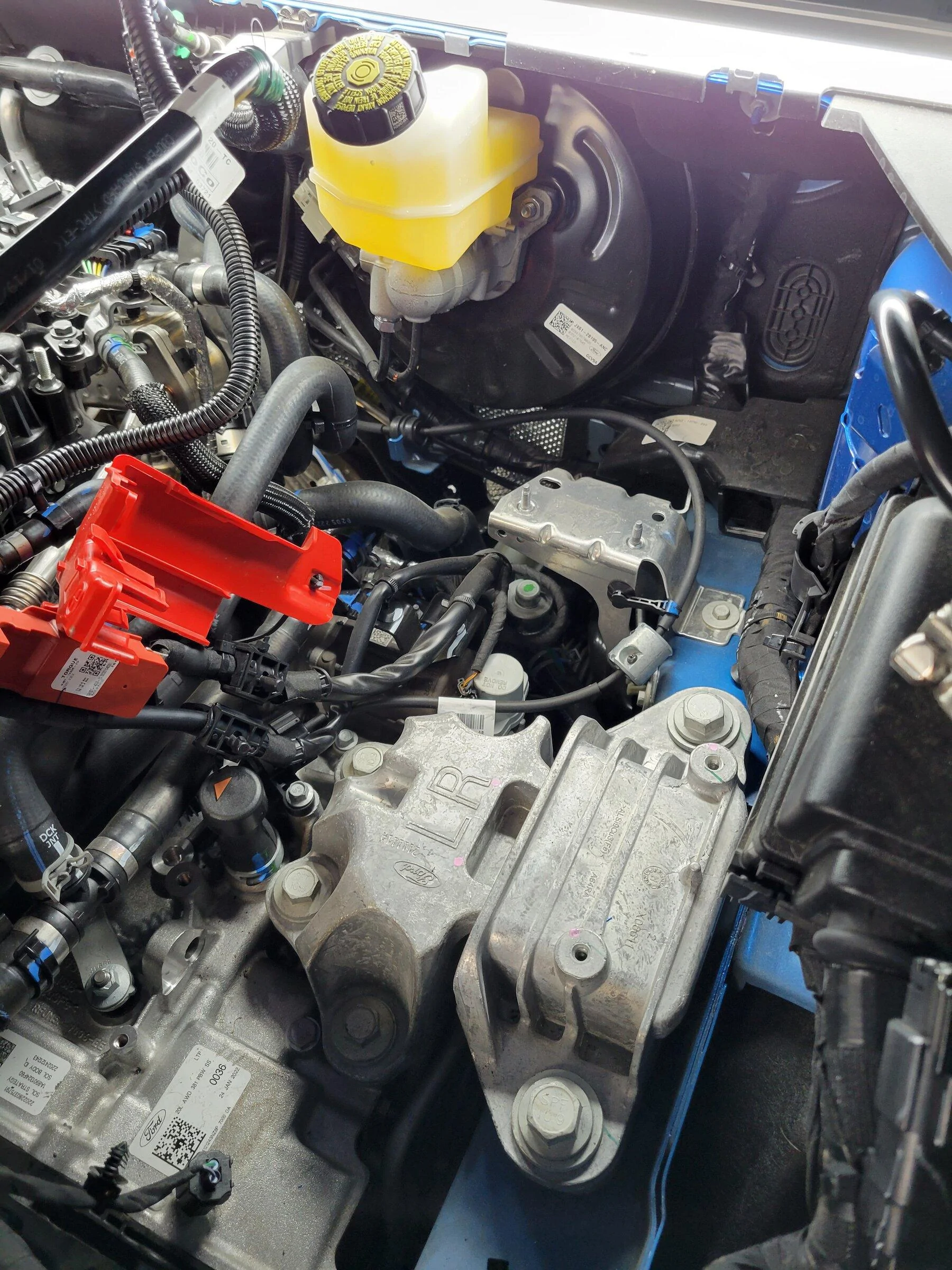

Ok, another update! Had a few free hours tonight, so I started tearing into the Mav. Holy Crap is there a ton of stuff packaged in this engine bay! It looks really open up top, but behind the engine is all sorts of packed!
I started removing most stuff on top and in the back to get to the turbo, so I removed the intake tubes, battery, and removed a bunch on random connectors and such. Getting the bolts loose that hold things like the oil return and feed lines,are absolutely a nightmare to get off! I'm not even sure how I'm going to get them back in! That's a problem for future me though....
So, on to the good news. It looks like using factory oil lines from the ranger should work, and the coolant lines might be able to stay Mav lines.
Next, the downpipe looks like it does have the space to shift up without having to add to the piping.
And the best news, is that the electronic wastegate actuator connector has all sorts of length to it, so it will reach the rangers location without issue!

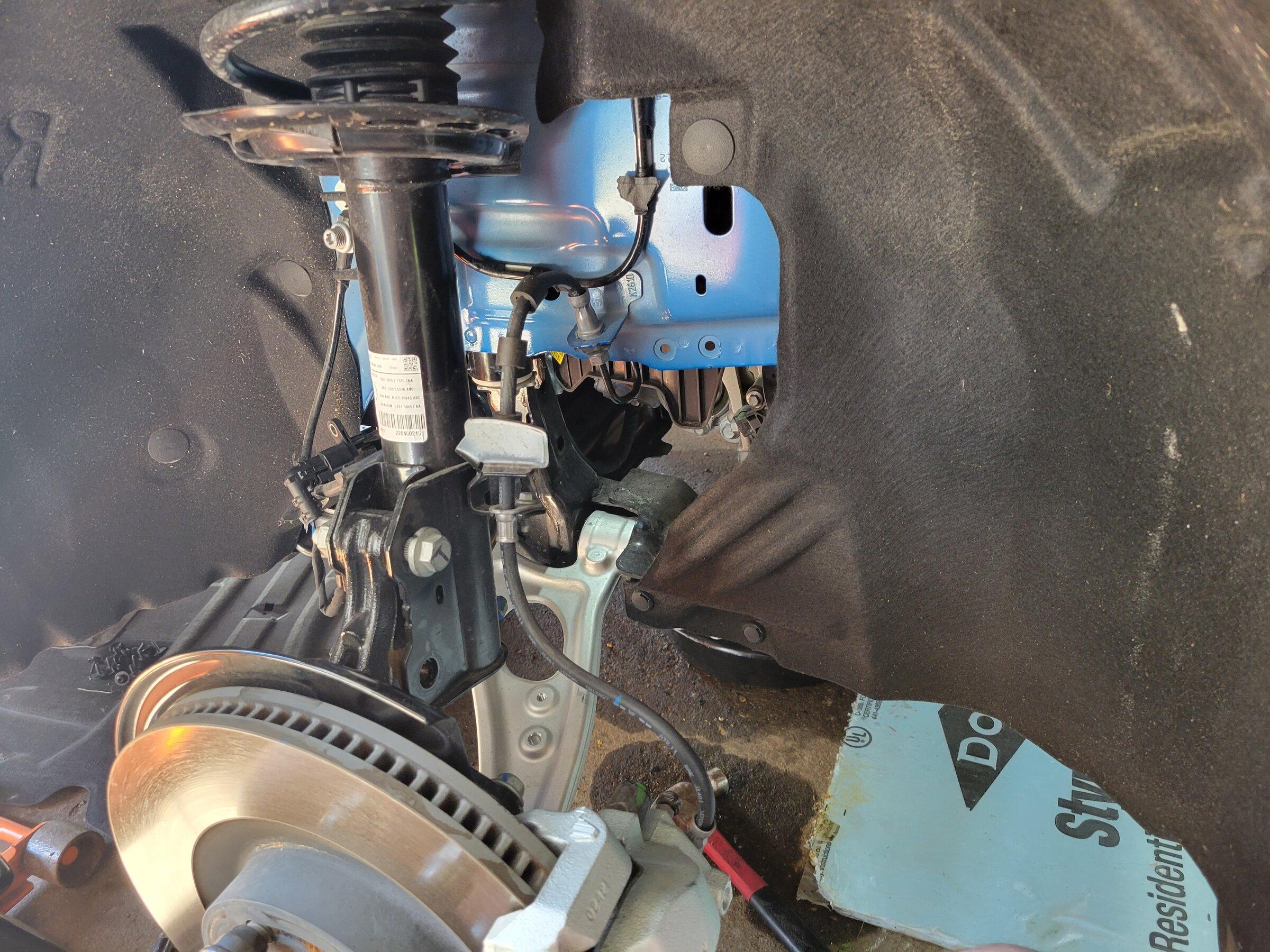

Another small update. Spent another couple hours disconnecting the downpipe and trying to remove the turbo, but there was a second bolt holding the oil return on. This one is basically impossible for me to get to. I think I'm going to have to remove the transfer case to get to it. I probably should have removed it from the get go, instead of spending hours on bolts that would have take minutes form the bottom side. They definitely didn't care about turbo removal when it came to this packaging! I won't have time today, but another day I will get to removing the driveshaft, passenger CV axle, and transfer case, to get to that one stingy bolt! Also, it looks like I may not have been able to remove the turbo itself from the topside. It would be really close.
No new pics, just lots of blood and cuts and a feeling of defeat!!!
