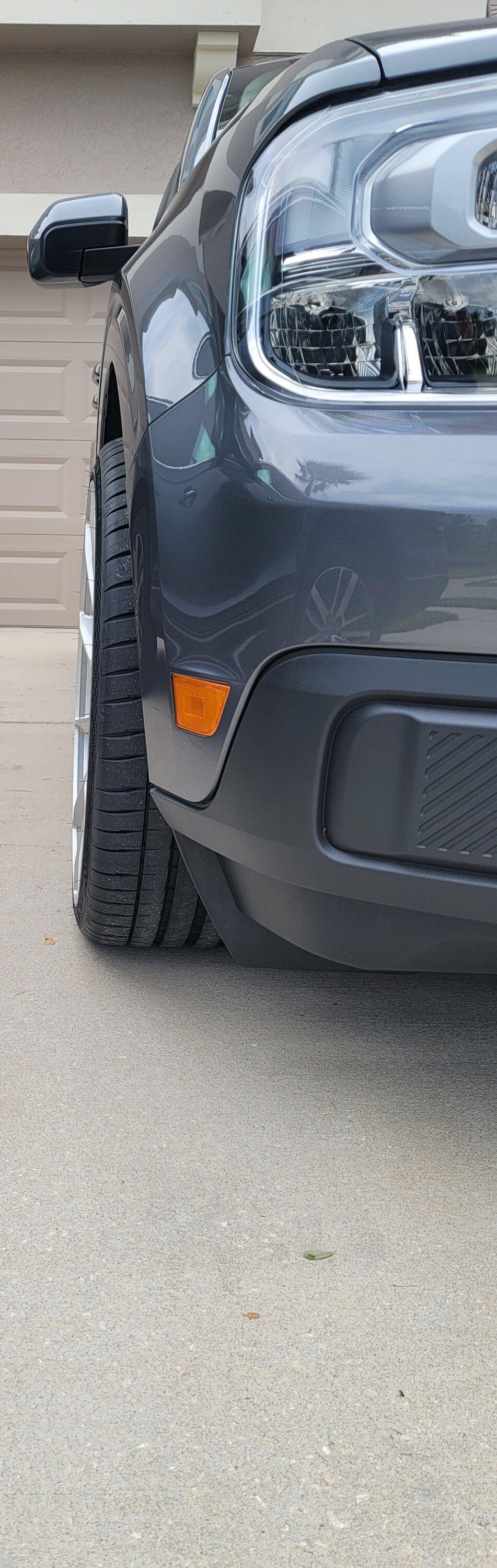

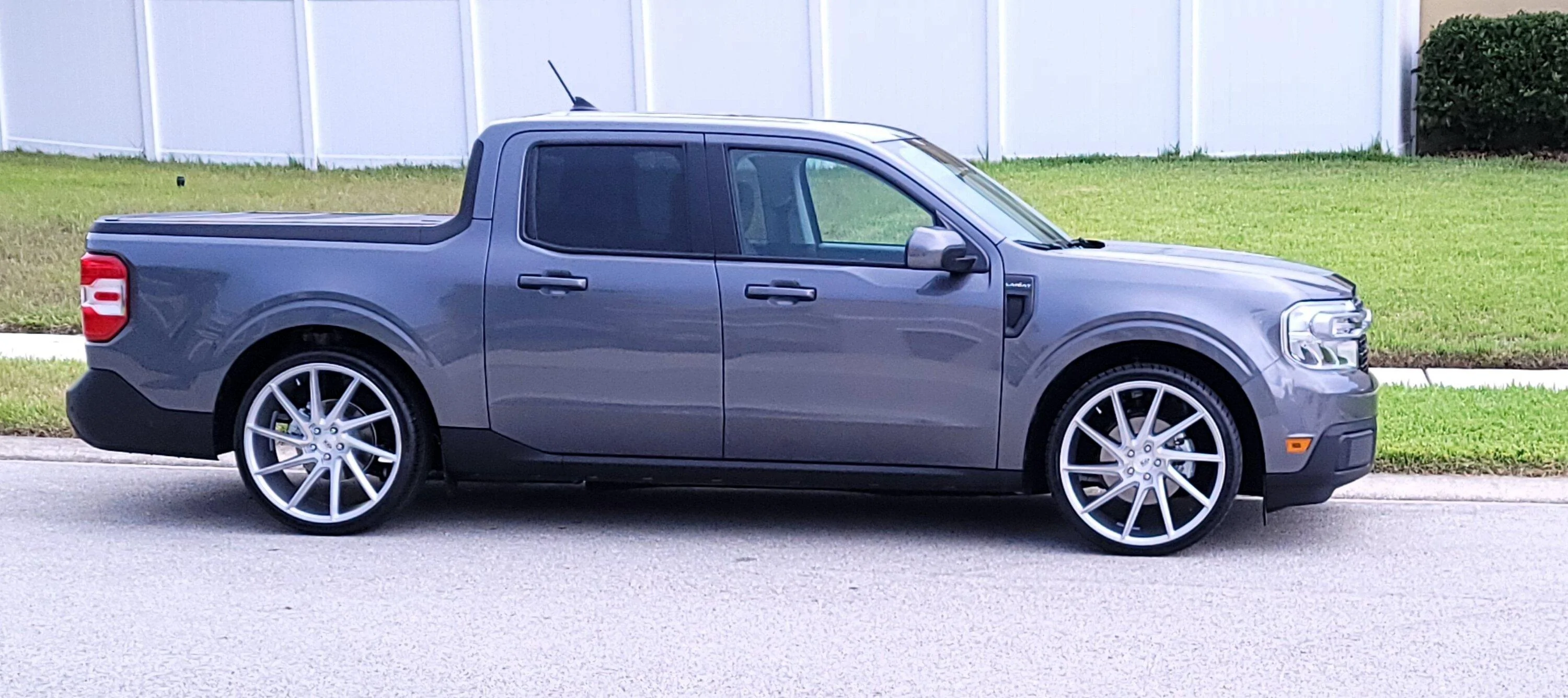

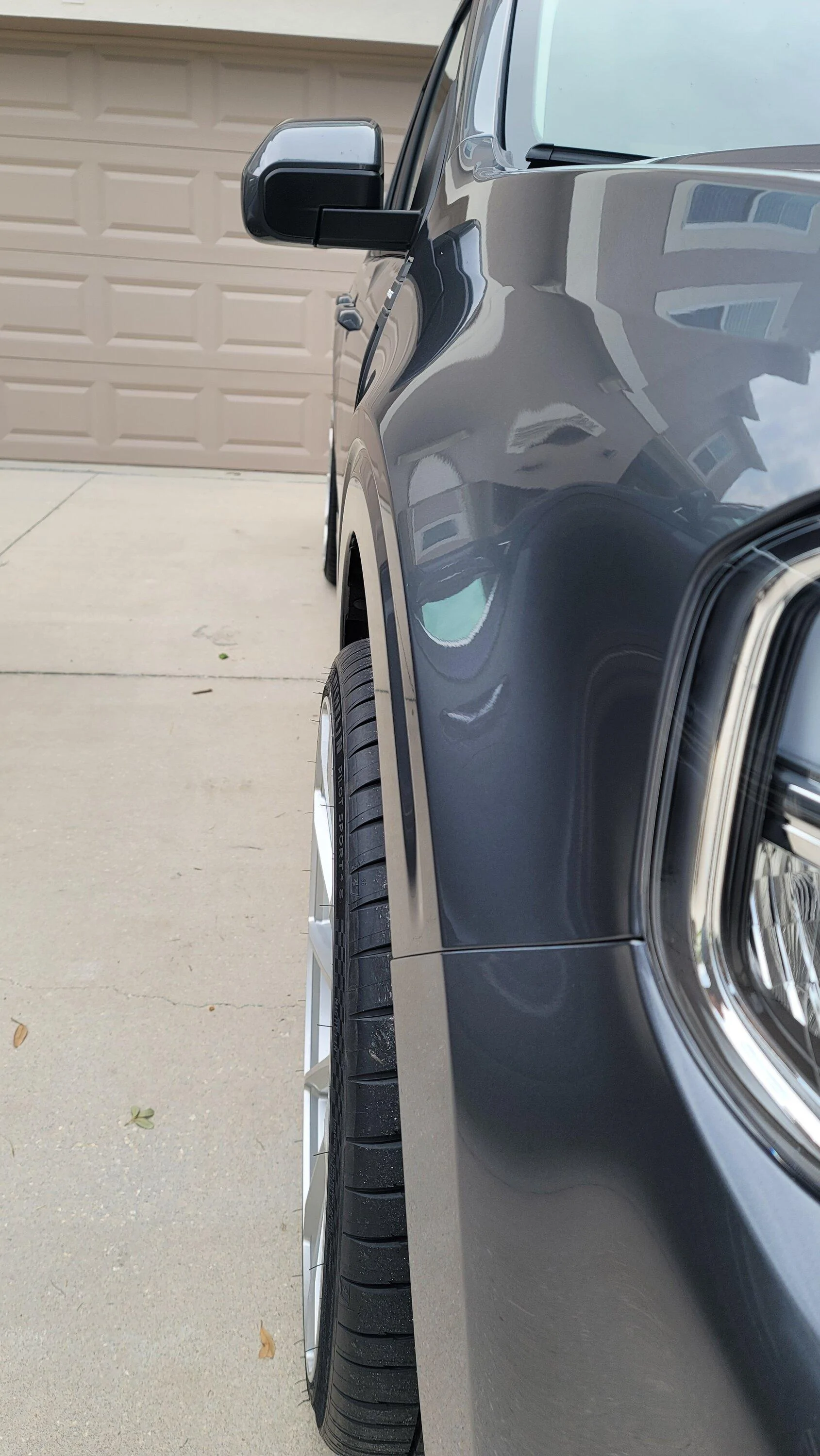

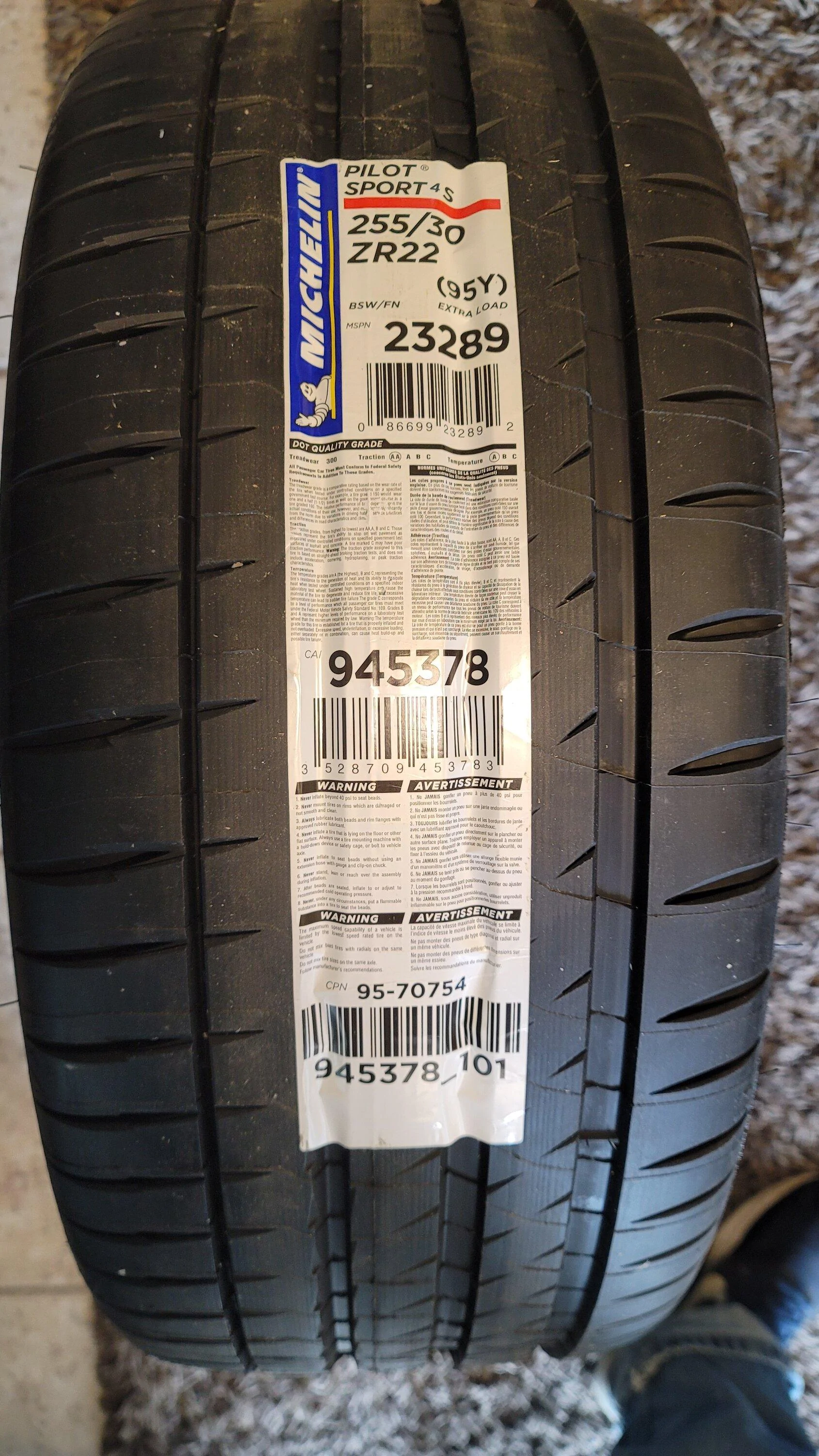

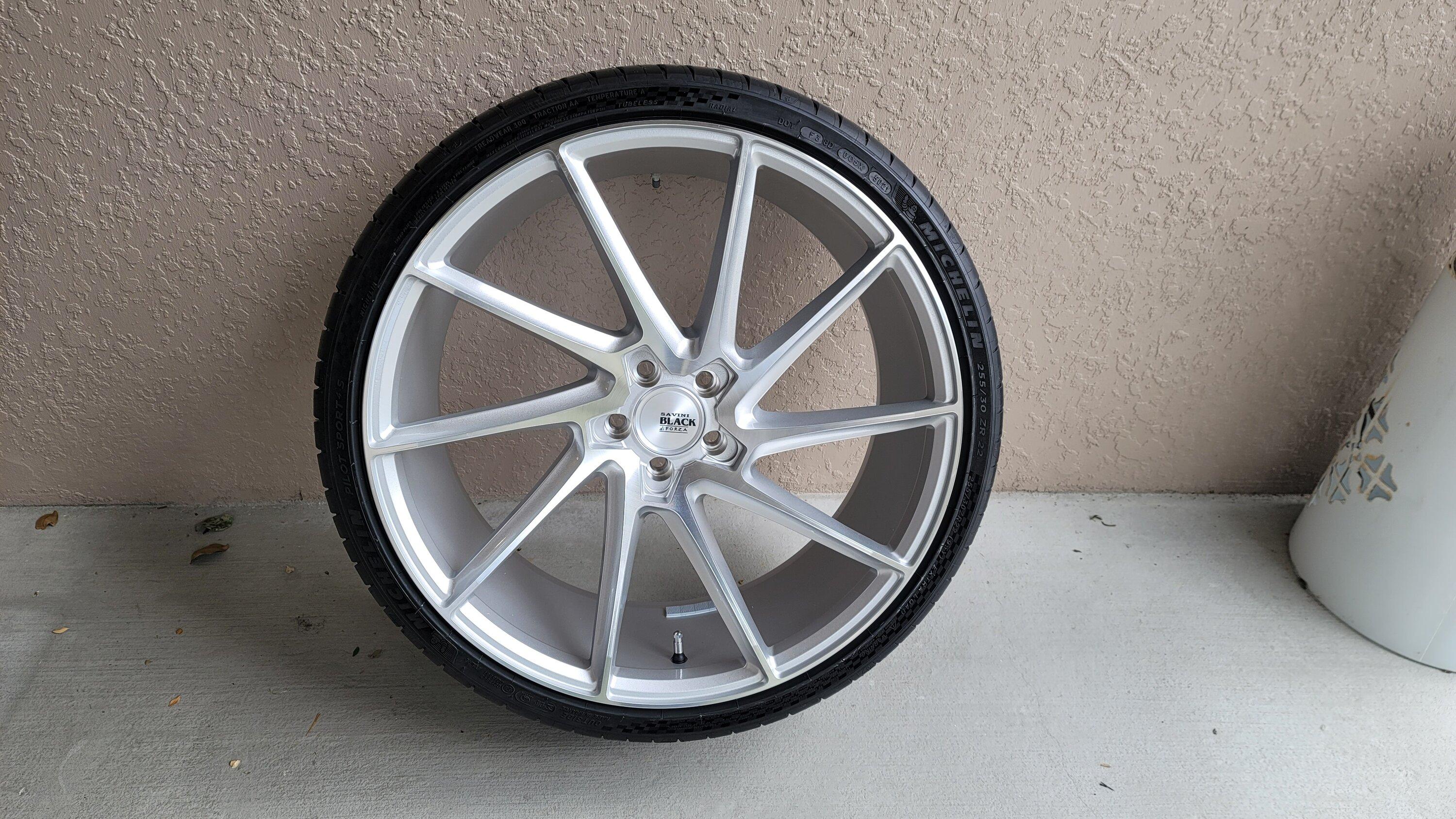

I love the look of the new wheels... could have even gone slightly wider on the tires. 255/30/22 but could clear a 265 series 22" tire

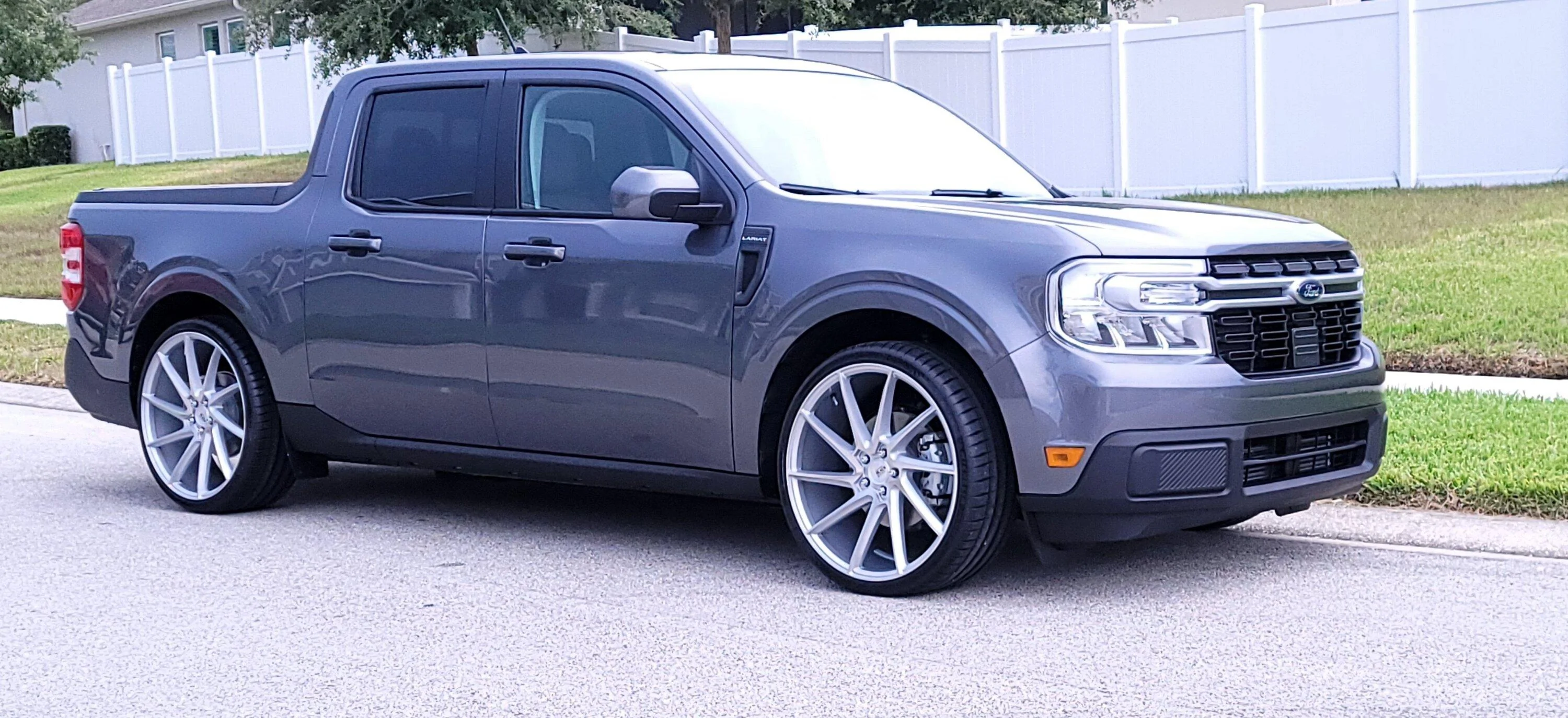

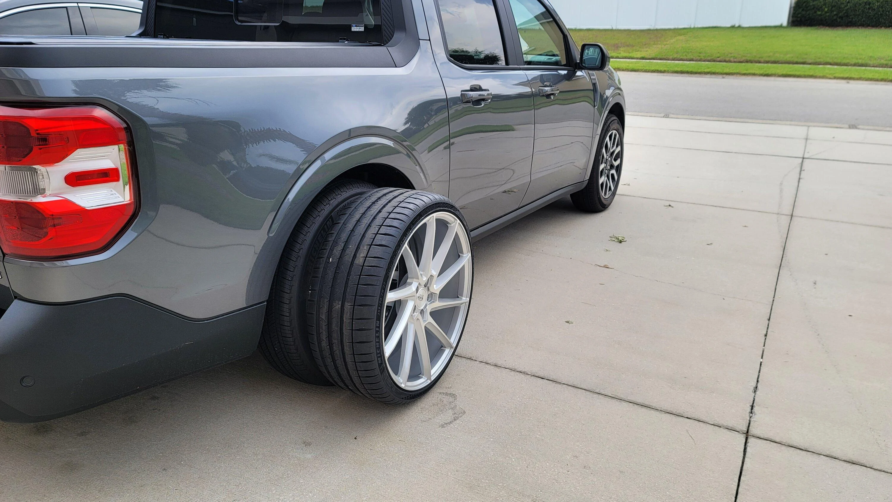

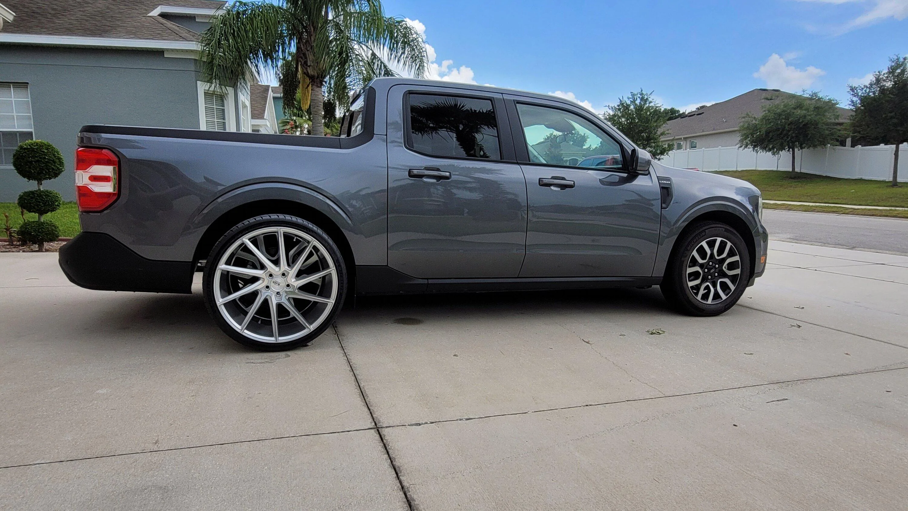

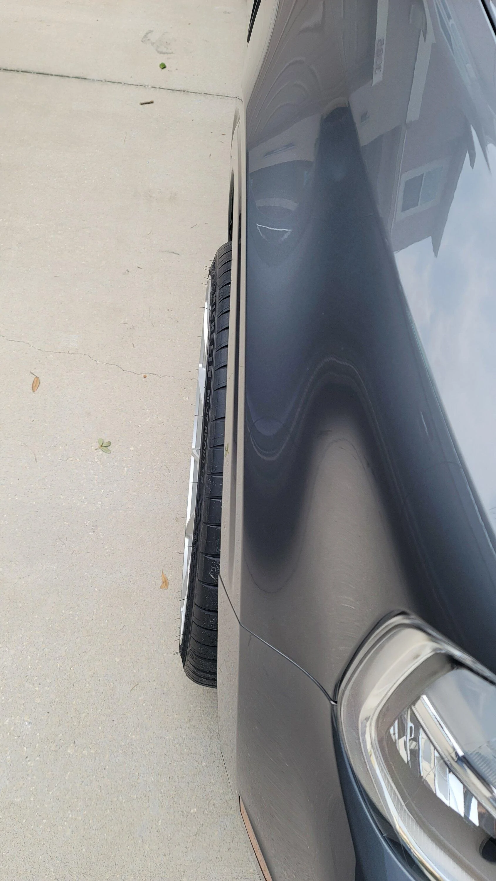

Wheels are 22x9 +40et....and fit perfectly, nearly flush with the fenders. The custom coilovers are about 30 days out but they will replace the H&R Escape AWD springs and allow me to dial that fender to tire gap down both front n rear. Next will be a BIG brake upgrade kit. Still thinking what color to powdercoat the calipers.
