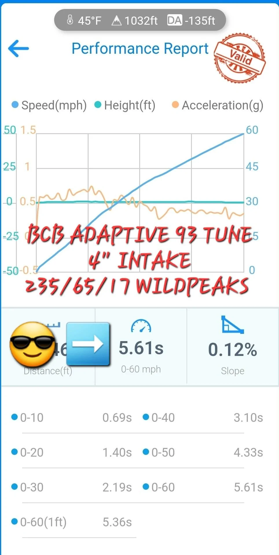

Got a great DA this morning. I didn't run the 1/4 mile, but it would be around a 13.88-13.92 with that 0-60.
Thanks.....I think?It has a stamp. Must be valid! Just kidding. Nice work!
