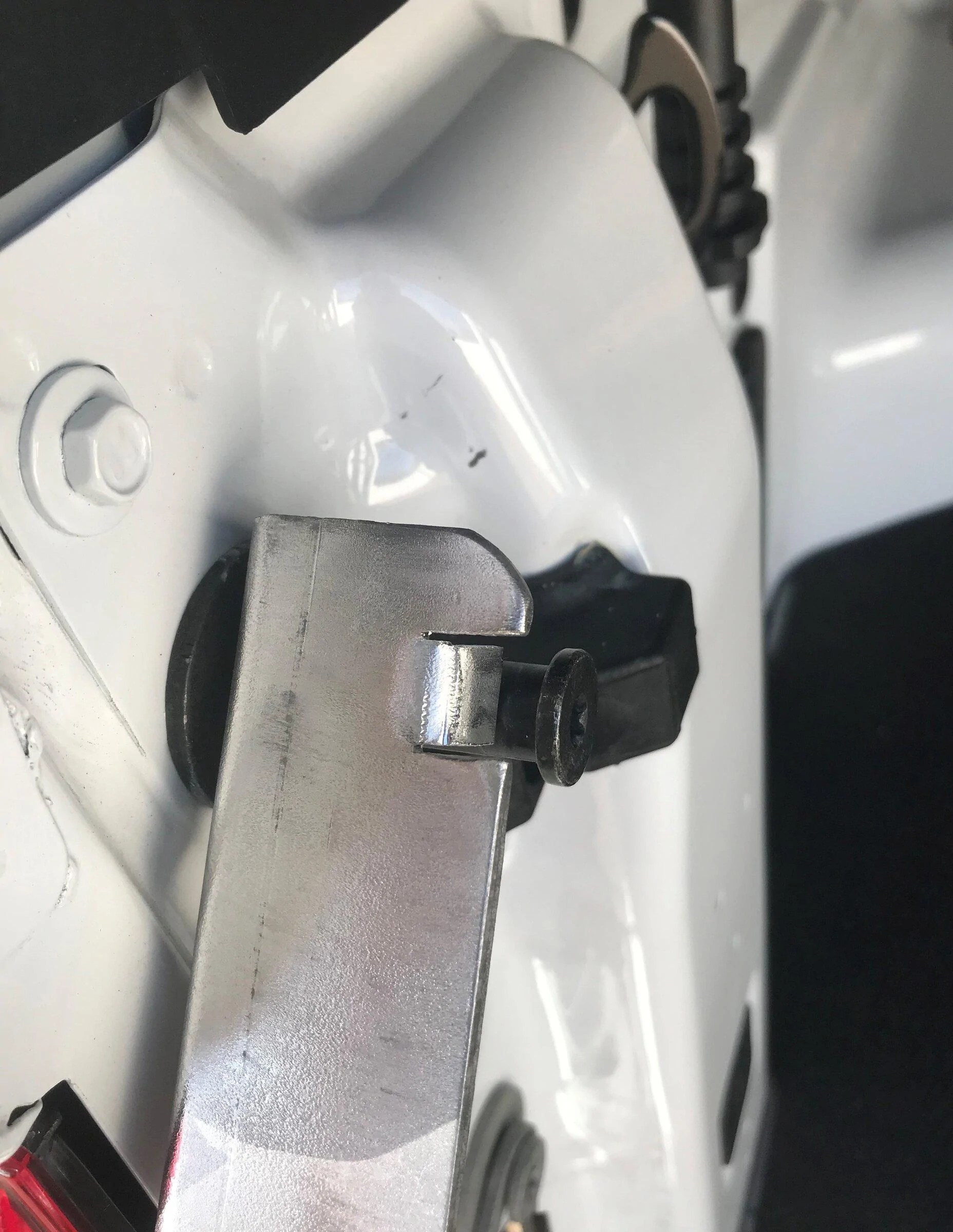

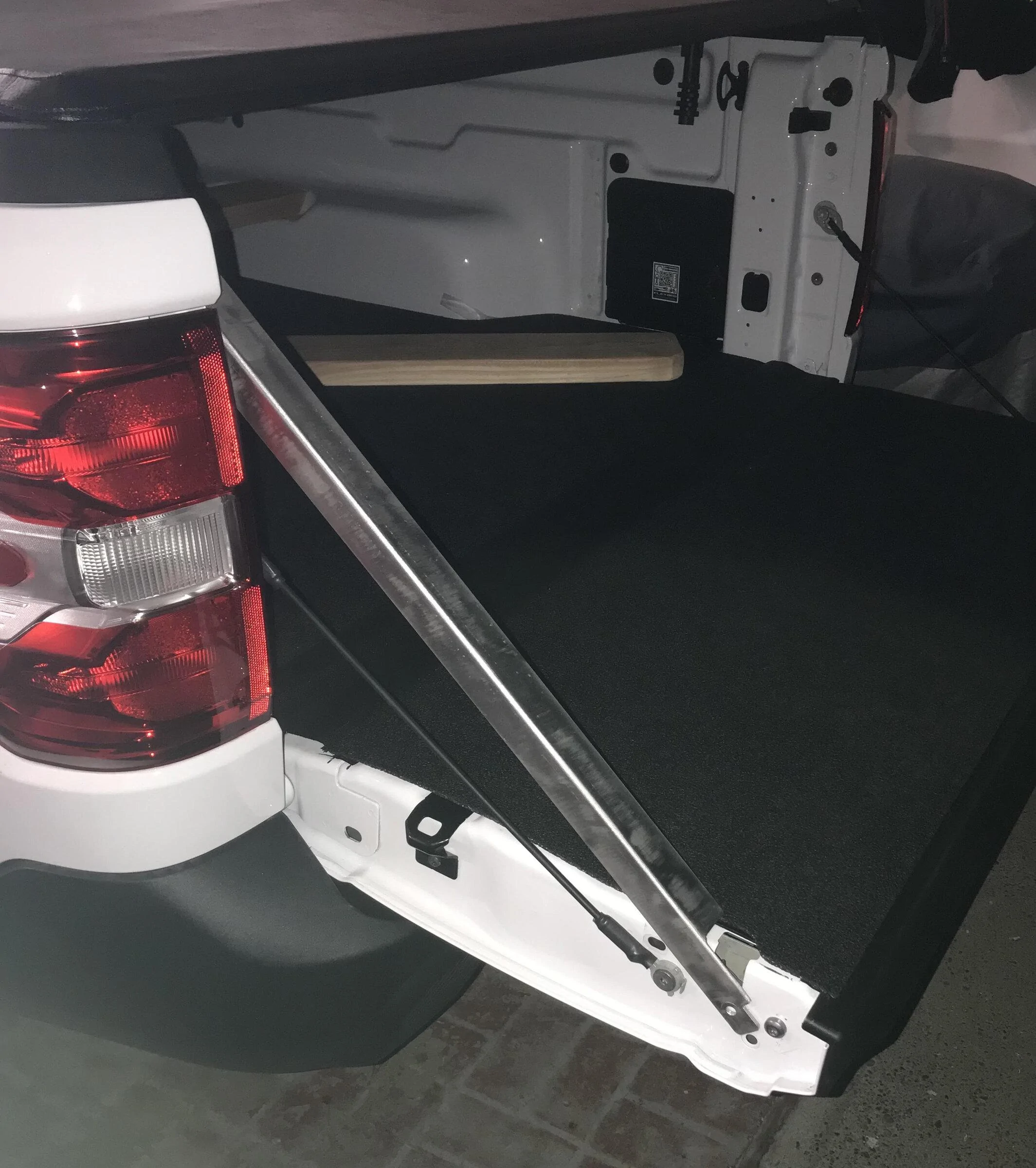

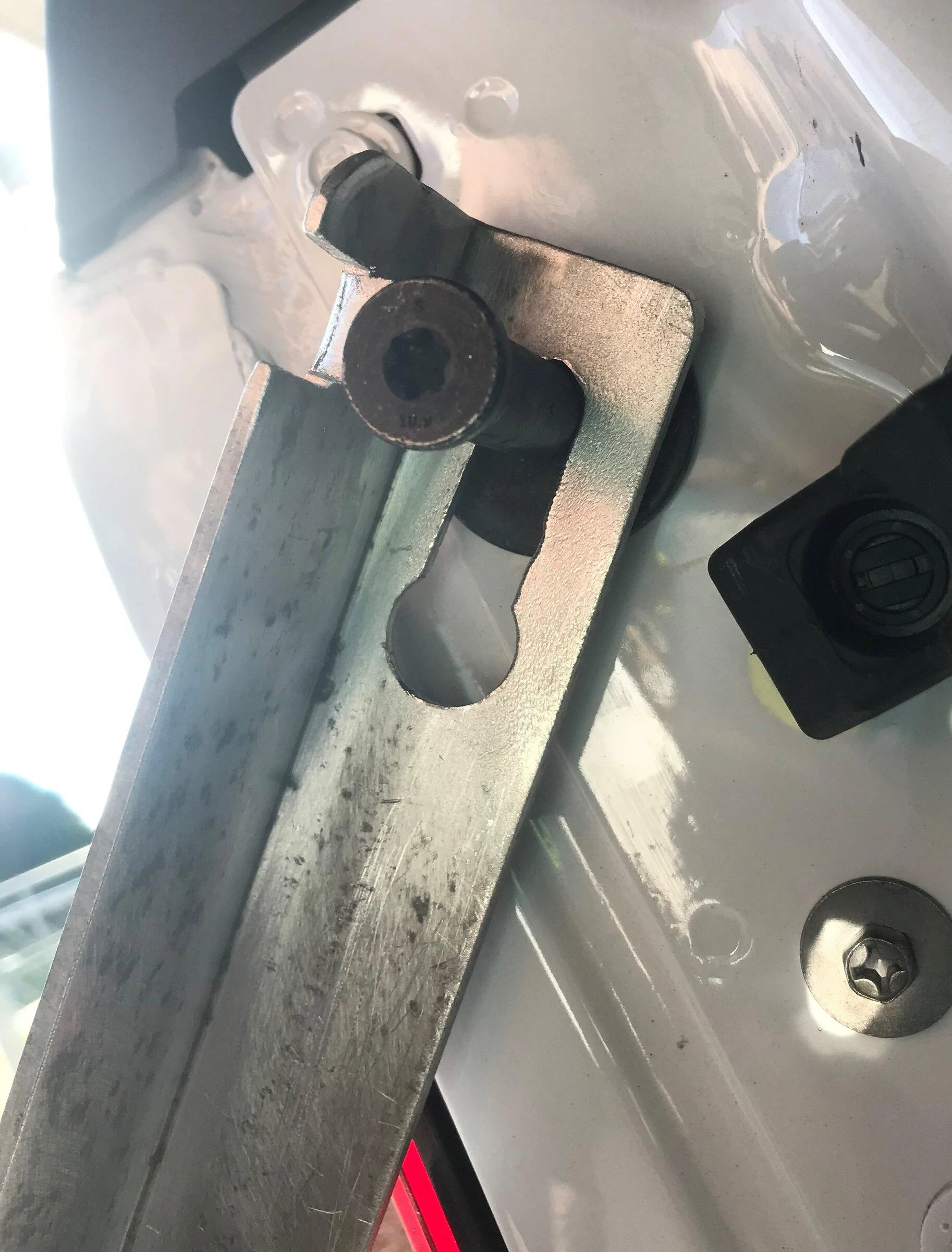

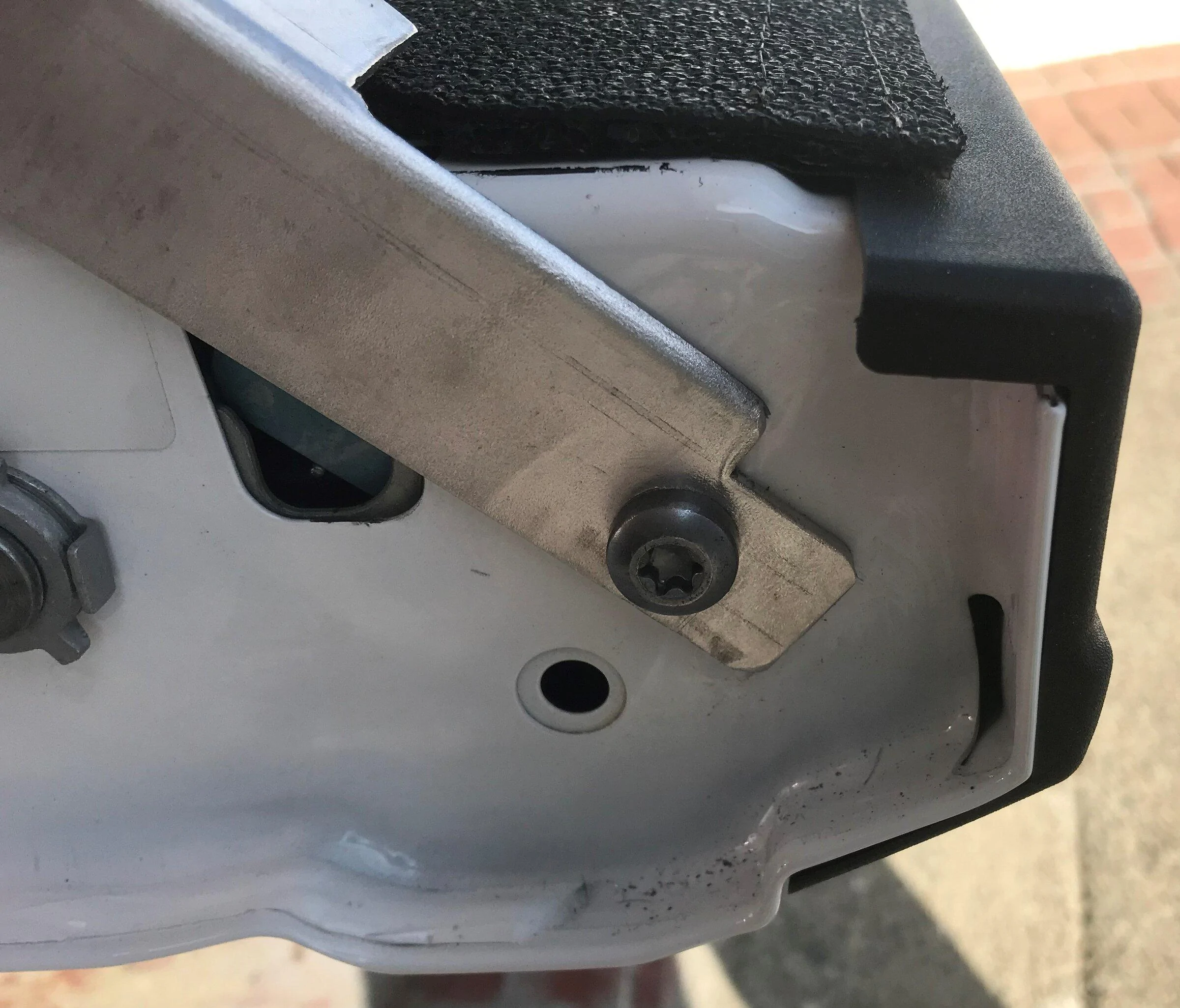

I had made a set for my Sport Trac because the short bed required my motorcycles to rest the bike's rear tire on the tailgate. These supports firmed that up and removed the weight on the cables. Commercial ones are available for some trucks but cost typically 99.00 a pair.
Today I build a set for my Maverick which I have not hauled a bike in yet but plan to do that soon. I will post a picture once I have a bike loaded.
I started with the same scrap 1/8-inch thick aluminum angle pieces from an Army Surplus store south of town that I had used before. I needed more so found more and paid 2.00 for each length of aluminum. I used 2 in this project.
Picture of support with bottom not attached gives you an idea that the tailgate will have to come up some for the bolt to line up. Once the bolt is out it is easy to align the holes. Yes, I made them so the tailgate will be level when in use. The factory straps will not be supporting any weight but still attached for safety.
Ford Maverick My real truck can haul my motorcycles w/ help of custom metal tailgate support and level struts brace-
These pictures show how I made the top attachment. They slide on then down prior to bolting the bottom in place. The bent over tang keeps the top part from moving toward the large end.
Ford Maverick My real truck can haul my motorcycles w/ help of custom metal tailgate support and level struts img_7699-
Ford Maverick My real truck can haul my motorcycles w/ help of custom metal tailgate support and level struts img_7698-
The bottom end has the top cut to clear the bed and duct tape on the inside to protect the paint when bolted in place by the one of the tailgate bolts that holds the tailgate latch in place. At star Allen head tool is required to remove the bolt and tighten it back down. The material was already narrowed at this end by the bolt but should still be plenty strong.
Ford Maverick My real truck can haul my motorcycles w/ help of custom metal tailgate support and level struts img_7697-

VERY smart bracing it with those cross bars. Only thing I would keep an eye on is if the tailgate skin that is it sitting on at the rear tire, begins to concave due to the weight and any vertical weight when going over speed bumps, exiting driveways, etc. (Tacoma experience with a heavy bike experience) Nice job!
BILLNOROVILLE
Sep 8, 2021
524
1,041
NorCal
prius, Hybrid XLT, Honda 1100Rebel, 2) Hawk 650NT
Thanks.
I have thought about the load on the Sheetmetal itself. Our cheap truck's skin seems strong but thin. The tailgate is rated at 400 pounds, I think. It's got quite a bit of indents forming ridges that ad strength also.
Lucky my bikes are light. 400 pounds for one and 500 for the other. So, weight per tire is roughly half with a little added force by the tie downs. I could put a support plate in that area to spread the weight over a larger area. Something like maybe 1/4 by 12 by 16 plate steel. Another solution is that I have another loading ramp that is steel, and I could put that under both wheels in the bed which would spread the weight evenly over a long narrow area of the bed and over the tailgate too. I don't haul bikes very often (about 4 times a year and less than 300 miles)so that might help too.

What is the point of this? Are the cables not rated to take that load? If so, why would you go to a rigid mount instead of just replacing the cables? I can only imagine you are doing this for loading and unloading purposes, since that's the only time the tailgate would see any amount of weight from you or the motorcycle. I have never seen this before, so I am curious is all.
BILLNOROVILLE
Sep 8, 2021
524
1,041
NorCal
If you do a search on Amazon for "Tailgate Support Bar". Many are advertised and list reasons for their usage. Mine only cost me 4.00 and some time not 99.00.
I don't know of any replacement cables available for the Maverick and if I were going to replace them, I would at least get a pair that holds the tailgate level with the bed as being a notable defect mentioned on the forum. My supports make the tailgate LEVEL with the bed, and I like that.
I think the factory supports would be strong enough and have no concerns there. The ability of the tailgate to pivot upward when hitting unseen potholes is not possible with my supports.
Apparently, you did not see the motorcycles resting on the tailgate loaded int the bed of the truck. My supports are not for loading or unloading but for a more solid support of the motorcycle. The tailgate sees the weight until the bike is unloaded.
