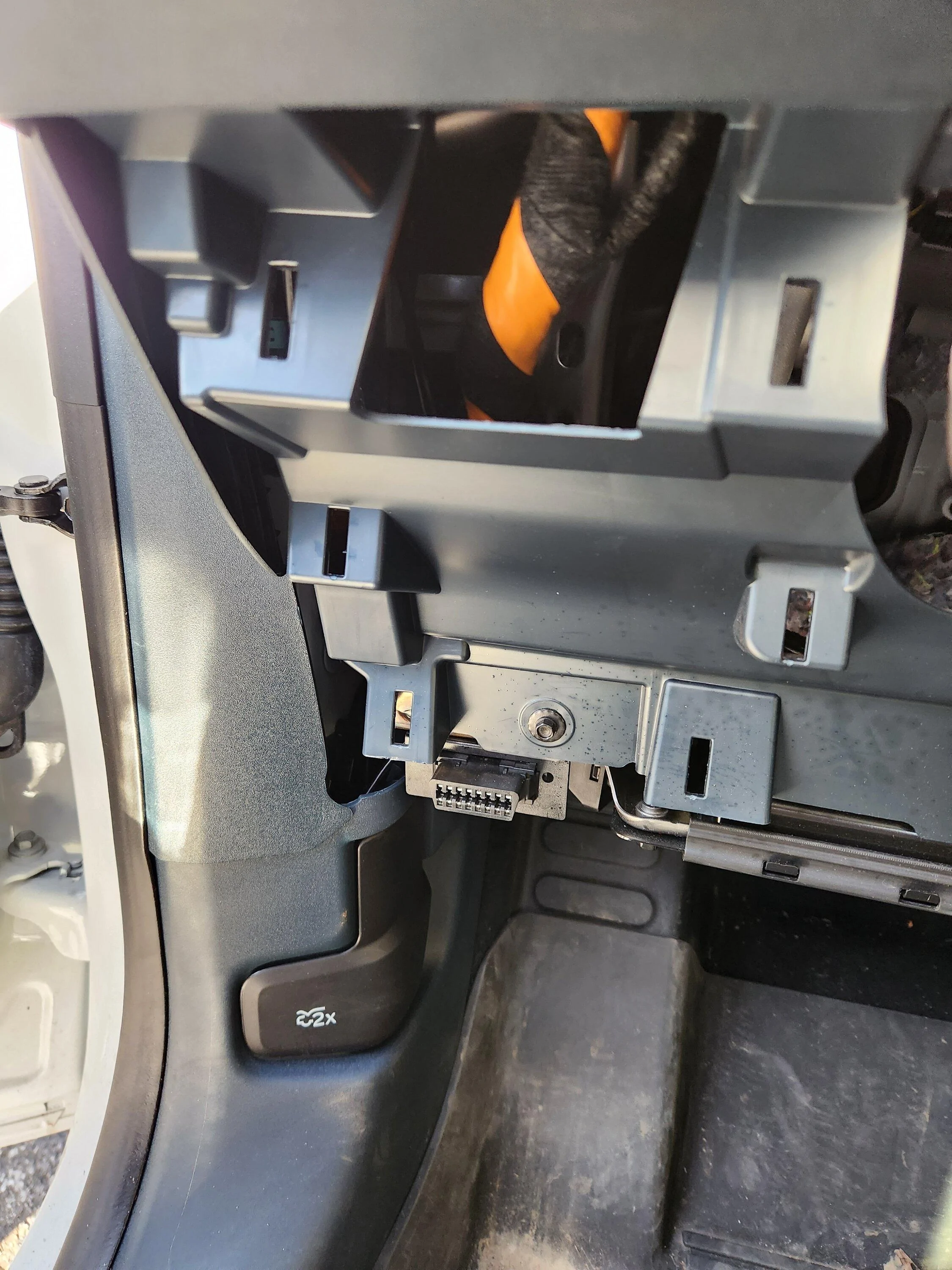

I recently installed this and the bracket that came with the obd adapter is way smaller then the stock one. Was yours the same size and if not how did you mount it
That actually was a pain. I used the adapter and screwed it underneath. unfortunately it still was behind the panel so Im either going to have to cut the plastic panel or make a spacer so it comes down further. Im OK until the OBD port is needed lol. I just slapped on the cover for the photo - it needs a bit of cleanerI recently installed this and the bracket that came with the obd adapter is way smaller then the stock one. Was yours the same size and if not how did you mount it
Thanks ! really the only issue is the OBD placementGreat video. I bought this set up to install in the f350 tremor. Sold that truck and just realized I still have the camera. Same part numbers so maybe I put in the mav.
