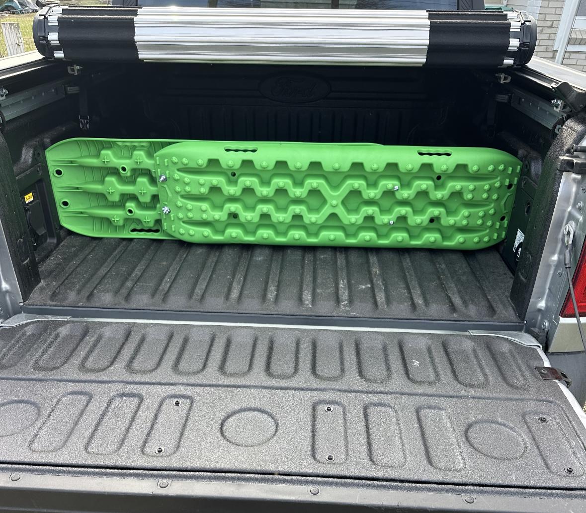

I was thinking about how to store my recovery tracks in the bed without them sliding around. This is what I came up with. (4) 4” 1/4 20 bolts, washers and wing-nuts. Drill 4 holes to fit the flex-bed slots while extended. Good multi-use idea for anyone looking to keep tracks in the Mav.
