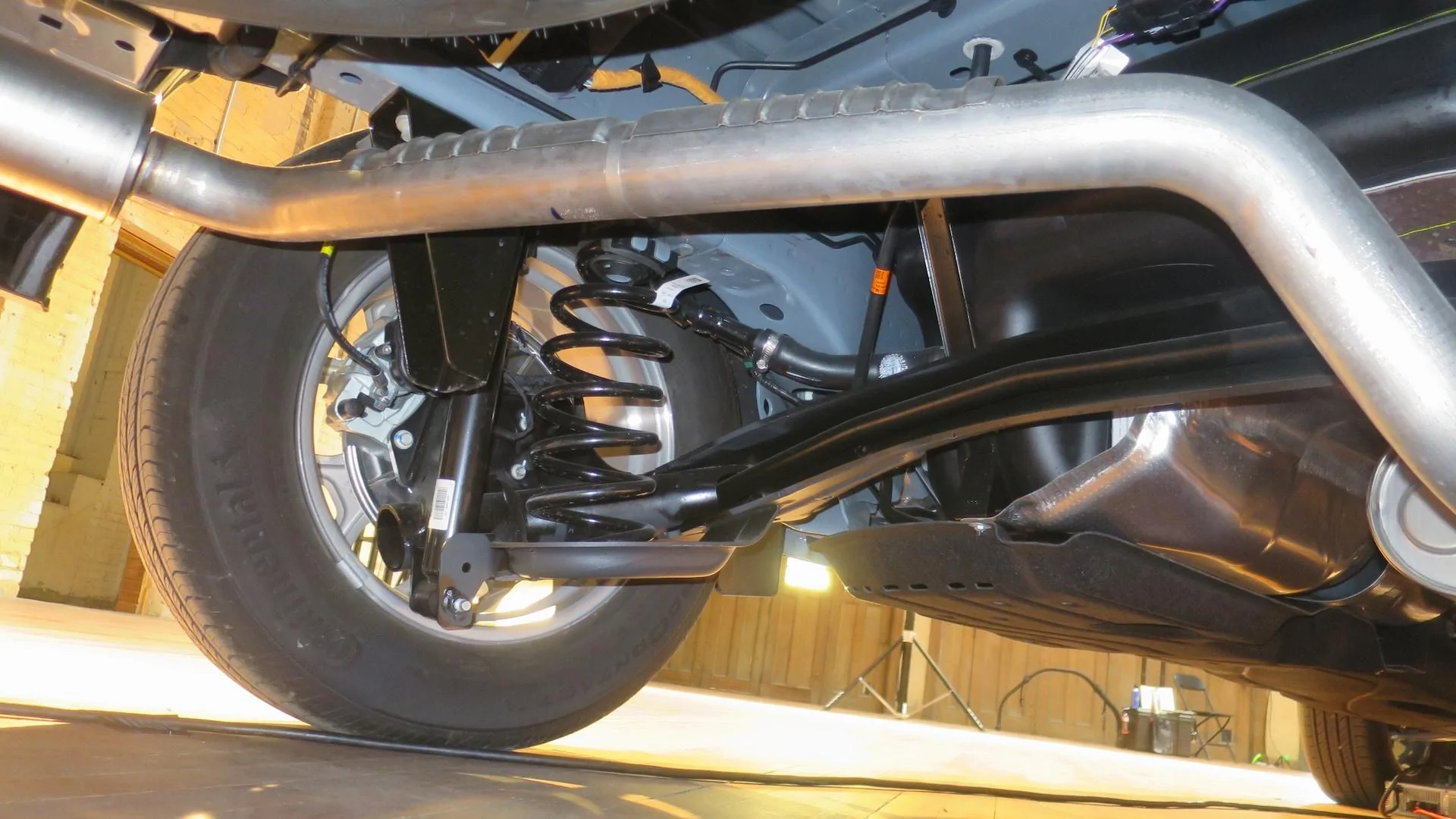

Why is the hybrid suspension inferior. Is it simply due to the fact that it is tuned more closely to an SUV?
AWD Mavs have a totally different suspension design, its part of the reason the AWD upgrade is so much more expensive than on other vehicles.
FWD Mavs get a twist beam aka torsion beam rear suspension, which is less expensive and nice and compact, but over certain rougher terrain is more easily upset.
AWD vehicles get a multilink suspension which has the disadvantage of taking up more space and being more expensive, but can control the rear better.
For casual driving on smooth streets, you wouldn't notice a difference between the two, but overall the multilink independent rear that AWD Mavs including the FX4 have is considered more advanced and fancy.

The opposite, the torsion beam is the rougher ride, all else equal. That's why I was saying if the reviewer wasn't just flat wrong (wouldn't be the first time) it could be a matter of tire selection, as that can play a huge role especially if you compare a dedicated street tire to an offroad tire. Basically, if you take away nothing else just remember "torsion beam is inferior but cheap, multilink is superior but expensive". I guess I didn't explain myself well, so here's Car's Guide:
Multi-link
Multi-link and dual wishbone systems are the holy grail of suspension designs, allowing engineers to achieve agile handling without compromising ride quality.
Both multi-link and dual-wishbone setups offer true independence and unparalleled control, with the multi-link system edging ahead of the double-wishbone choice by offering greater adjustability.
Of course, nothing comes for free. Multi-link and double-wishbone independent setups are the most expensive and complex, as well as taking up more space than the simpler and slighter torsion beam.
Finding dual wishbone or multi-link suspension in your prospective new car usually means heading to the more premium end of the hatchback, wagon and sedan markets. It also means being pretty selective in the SUV and light commercial segments.
Torsion beam
So, that brings us, at last, to the torsion bar, also known as the twist beam, torsion beam, or any other variation on that theme. And it really is as simple, and ingenious, as that; a bar connecting both wheels that twists ever so slightly under duress, in order to give a degree of independence to each wheel's movements.
Under lateral (side-to-side) force, however, the torsion beam remains rigid, to resist body roll, which lets you corner with confidence. Simple, solid, sorted.
Torsion bars take up less vertical space than MacPherson strut setups and less horizontal space than double wishbone and multi-link systems, netting more room for humans in the cabin and their stuff in the boot.
Torsion-beam setups are relatively cheap and easy to manufacture, install and maintain, but they don't offer the engineer anywhere near the same amount of freedom to balance comfort, agility and stability as independent systems do.
Because torsion bars offer less isolation than independent systems, they can also allow more noise, vibration and harshness to filter into the cabin.

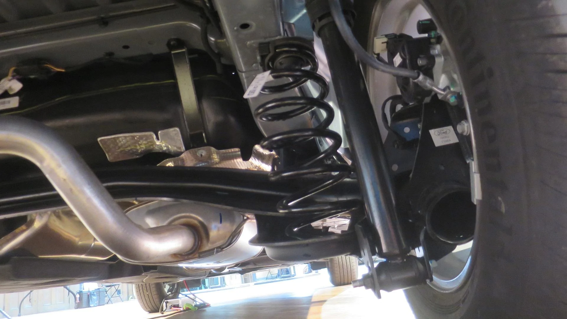

Don't forget the spring setup is unique for the Hybrid rear suspension, Motor Trend has an article about just that. Apparently it is the same setup used in the 2019 Fiesta ST (Europe).
2022 Ford Maverick’s Force-Vectoring Springs Come From a Sensational Hot Hatch
The FWD model’s patented coil springs draw from the vaunted Fiesta ST.
A multilink rear suspension is the gold standard for ride and handling; a solid beam axle is the ticket for max payload and trailering. The front-drive hybrid version of the 2022 Ford Maverick uses neither, but its rear suspension design threads a needle between these concepts with a trailing twist beam that leverages Ford's patented "Force Vectoring Spring" design that first appeared on the very excellent Euro-market 2019 Ford Fiesta ST.
Ford Maverick Motor Trend Maverick Hybrid First Test Review: Thrifty, Awesome Fun 2022-Ford-Maverick-Force-Vectoring-Springs
What Is A "Force Vectoring Spring"?
This special riff on the coil spring uses cold-formed steel that's directionally wound (the right and left rear springs are not interchangeable) with the pitch and diameter of the coils varying throughout the springs' length. The critical difference you'll note in the photo is that the top and bottom coil look angled when the springs are uncompressed. Once installed with body weight on them, they look like normal springs, though the lower spring perches angle slightly up and inward on each side to accommodate the design.
Ford Maverick Motor Trend Maverick Hybrid First Test Review: Thrifty, Awesome Fun 2022-Ford-Maverick-Force-Vectoring-Spring-1
What Does Force Vectoring Do For Handling?
As the 2022 Ford Maverick bends into a turn, compressing the outside rear wheel, those sharp angles allow the spring to directly absorb some of the lateral cornering force. In effect, the springs themselves vector some cornering forces laterally into the frame. This adds a degree of roll control without stiffening the bushings, the springs themselves, or the torsion bar in the trailing twist beam—any of which would have a negative effect on ride quality.
Are There Other Benefits?
Another common way to bolster lateral stiffness is by using a Watt's linkage. In the case of the Fiesta ST, that solution would have added 22 pounds. Scaling everything up for truck duty, you can rest assured the weight penalty would have been even greater on the Maverick. The trailing twist beam itself features a rear-facing open C-channel section into which a torsion bar gets welded, which allows Ford to easily vary the roll control for different models and packages by simply varying the diameter of that bar. The low-mounted beam helps enable the low cargo box floor height, even while kicking up to permit the exhaust to run underneath, but it cannot accommodate AWD.
Ford Maverick Motor Trend Maverick Hybrid First Test Review: Thrifty, Awesome Fun 2022-Ford-Maverick-Force-Vectoring-Spring-2
Where Else Are Force Vectoring Springs Used?
Drivers of Ford's workaday Transit Connect also enjoy the ride/handling benefits of these "Force Vectoring Springs." From hot hatches to delivery vans, to pickup trucks—that's a pretty broad portfolio for this clever concept.
