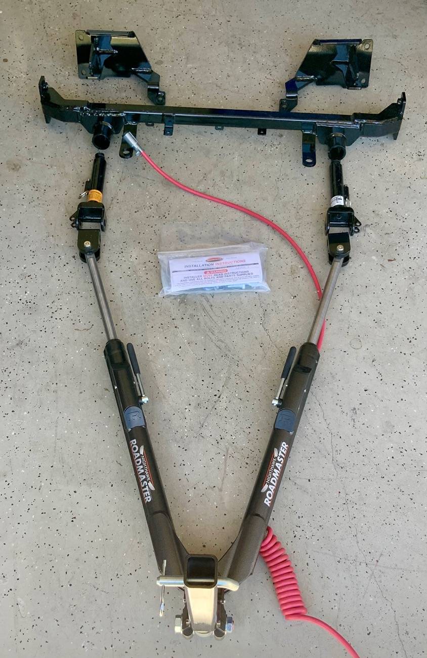

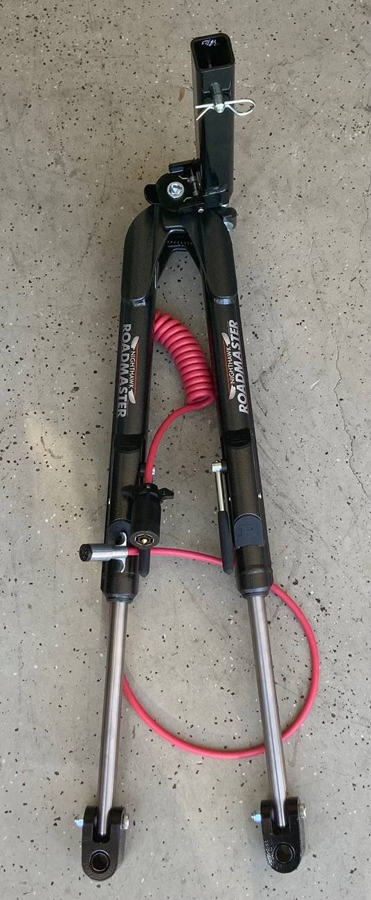

I purchased the RoadMaster Baseplate and Components along with a Nighthawk Tow Bar for my 2025 Maverick Lariat AWD Hybrid installation scheduled for 5/21 but I have not decided on a brake system yet so I’ll watch this post to get recommendations - thanks
Ford Maverick MAVERICK TOAD OR DINGY IMG_5049
Ford Maverick MAVERICK TOAD OR DINGY IMG_5046

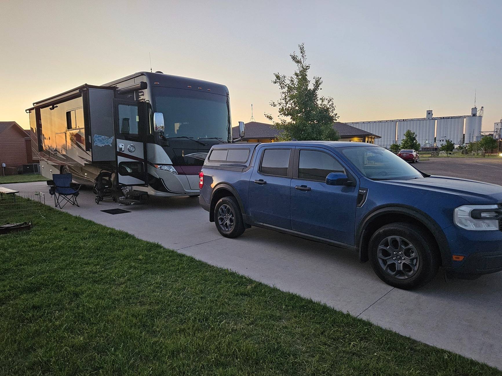

2023 XLT Hybrid with Road Master base plate, Road Master All Terrain tow bar, and RVI2 supplemental brake. Also had some operator error problems with neutral tow mode at first, but I printed the procedure out of the owner's manual, laminated it and keep it in the console for reference. Following the neutral tow mode procedure exactly has eliminated errors. Now have a bit over 15k miles towing the Maverick and very happy.

Ford Maverick MAVERICK TOAD OR DINGY Maverick hooked up 01
