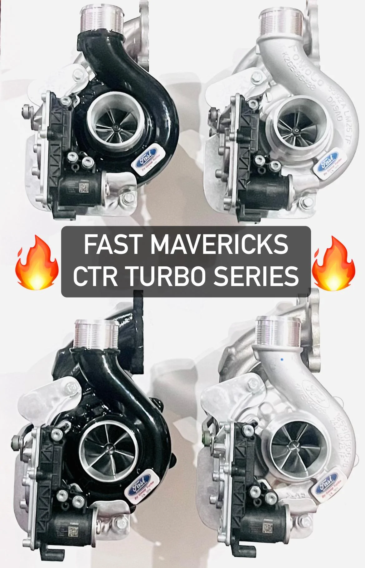

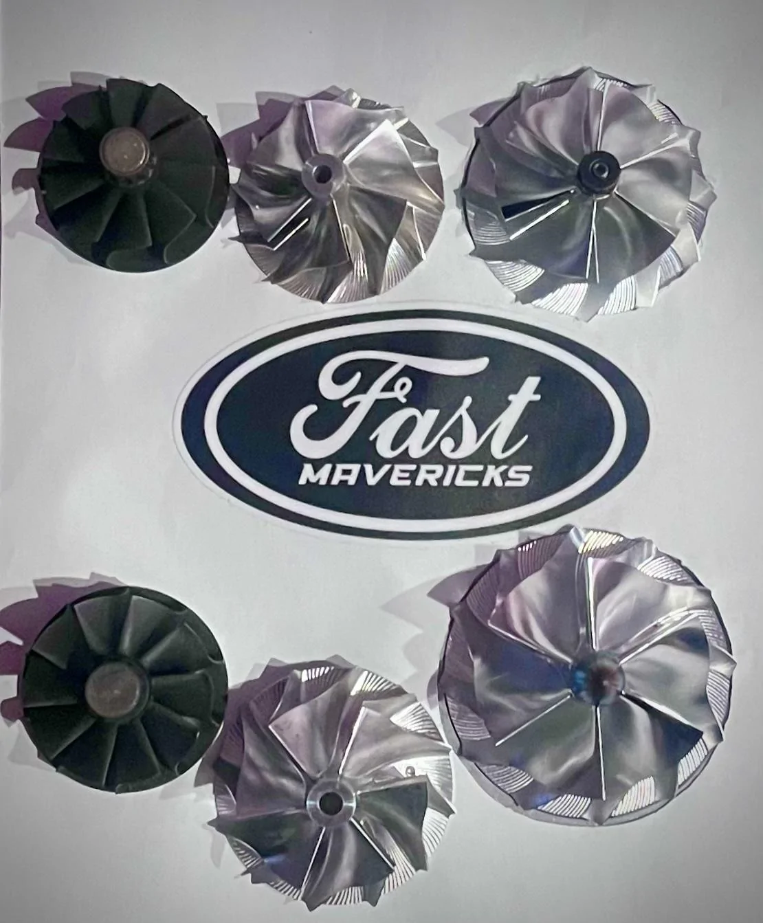

Here’s a comparison for reference
Top is stock 2.0 turbo bottom is 2.3 Corsair or Ranger turbo.
From left to right
Stock exhaust wheel, stock compressor wheel, and Billet CTR50 wheel
Stock exhaust wheel, stock compressor wheel, and Billet CTR57 wheel

Top is 2.0 CTR50 Black and Silver
Bottom is 2.3 Corsair Black and Silver. These are all 100% bolt on except the Corsair requires a 5 minute trimming of the coolant and oil line tabs.
Ford Maverick Maverick Stock 2.0 Turbo vs. 2.3 Corsair/Ranger Turbo FDB1FC92-4D65-4D7F-B784-C7CD7FB4B1AF

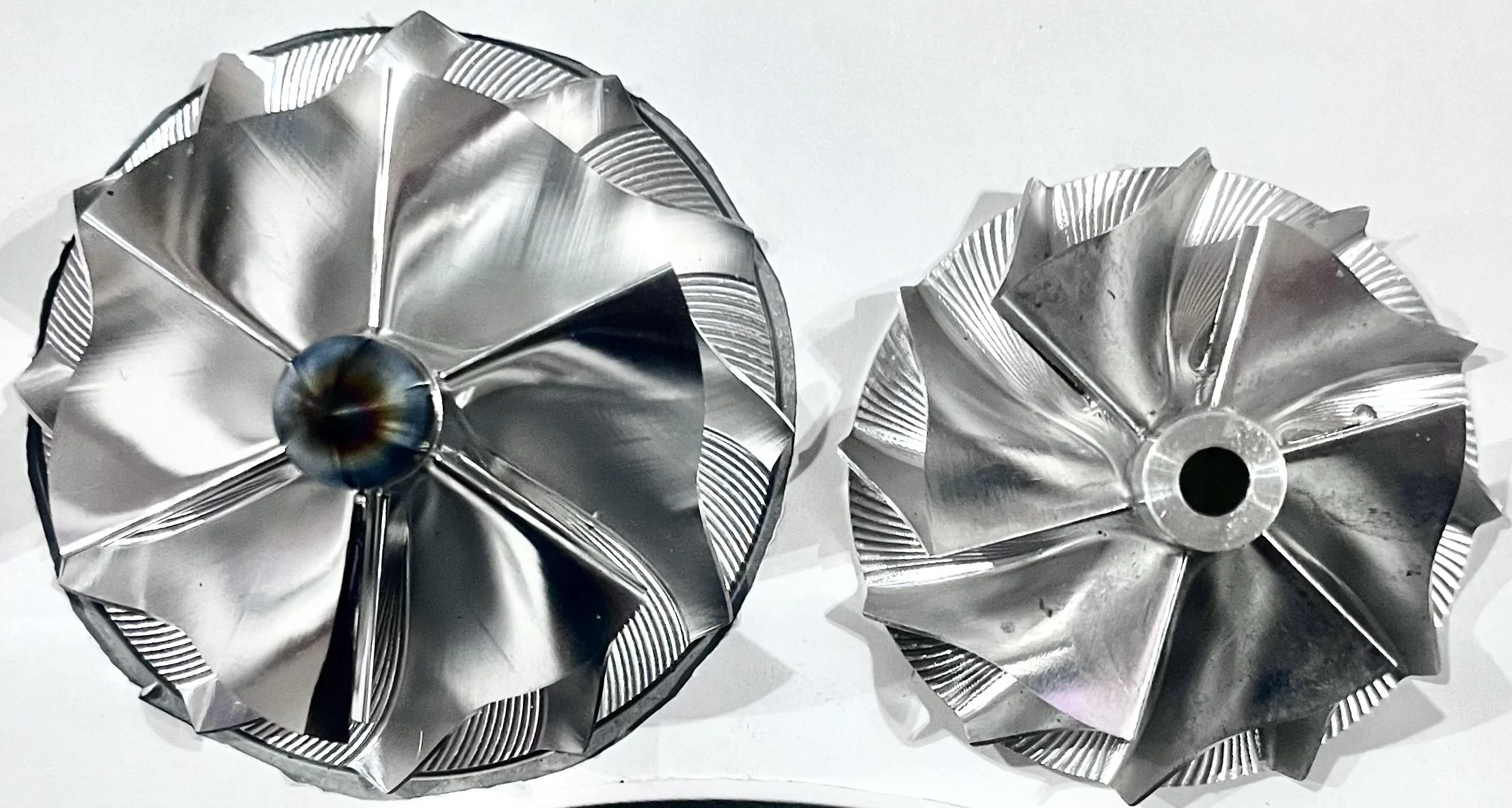

The difference between the stock and 57mm wheel.
Ford Maverick Maverick Stock 2.0 Turbo vs. 2.3 Corsair/Ranger Turbo 8B396CA9-2768-45B2-BD3C-8BC2811F50E9

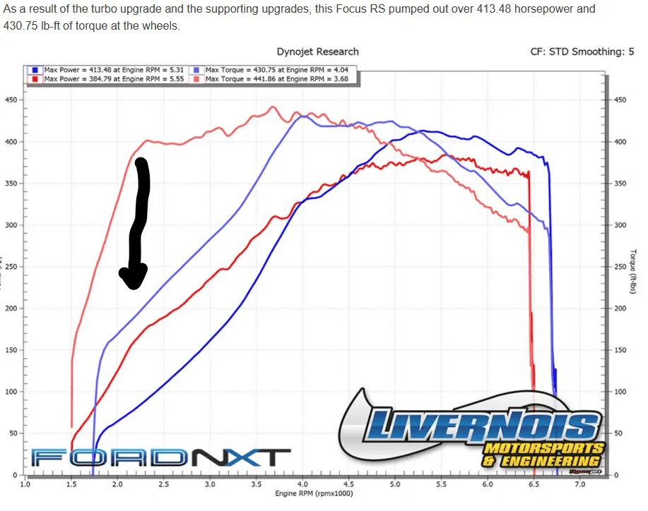

thanks for sharing that. do you feel that it was a worthwhile upgrade? I would be pretty concerned about the loss of low-end torque, especially for a Maverick that still gets used to tow/haul, but honestly even on your Focus RS I don't like that huge gap 2k to 3.5k. I marked it up with a black arrow. It looks like 200lbft loss at 2k rpm and 150ish at 3k rpm.
