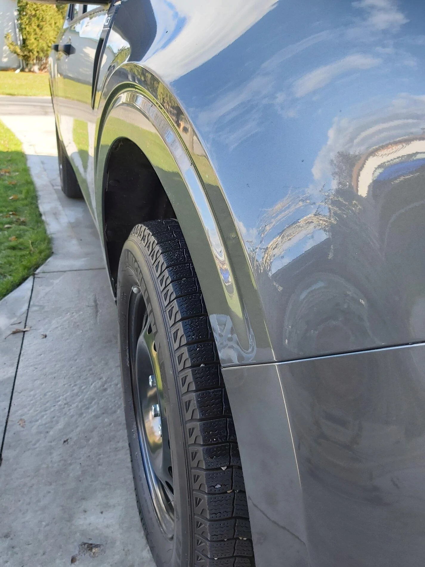

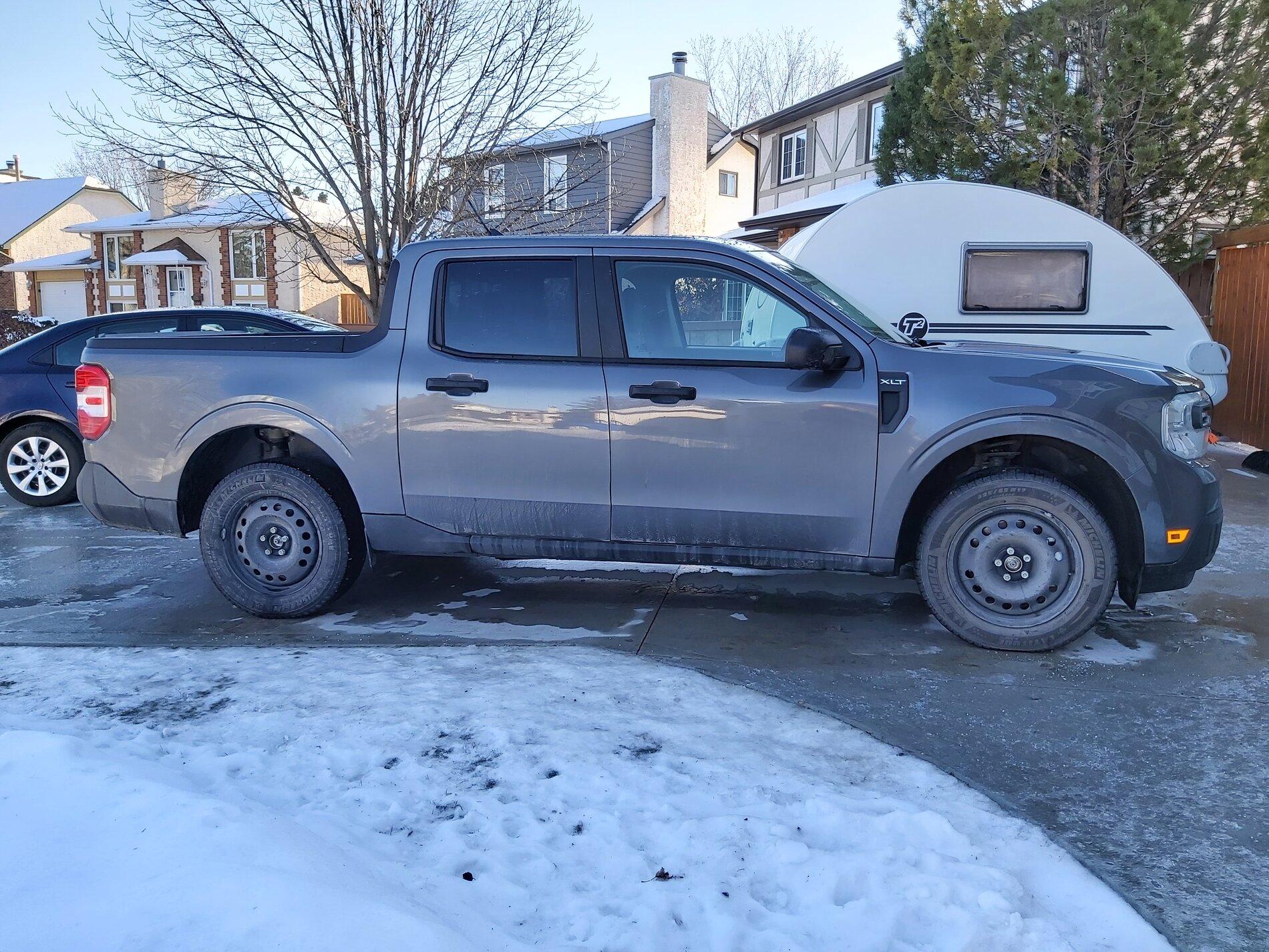

Oooh! What do these look like with a straight on facing shot?Should work OK. These cheap steel wheels that I bought for snow tires are supposedly for an Escape. Bought them at a wheel specialty shop.
Do you mean straight on from the side? I think the snow tires on steelies looks fugly, but they work. We had freezing rain yesterday - bad. The roads were horrible, and had to go pick up the wife from work. Those Michelin X-ice are about as good as it gets in those conditions, helluva test. Nice to have the AWD, stability control and nanny electronics at times like that.Oooh! What do these look like with a straight on facing shot?
THANKS for posting!Do you mean straight on from the side? I think the snow tires on steelies looks fugly, but they work. We had freezing rain yesterday - bad. The roads were horrible, and had to go pick up the wife from work. Those Michelin X-ice are about as good as it gets in those conditions, helluva test. Nice to have the AWD, stability control and nanny electronics at times like that.
I spoke with a parts guy at a different Ford dealership, and he offered that the Escape has same hub/wheel bolt pattern & 17 x 7. Lots of sources for aftermarket Escape steel wheels... and I bought a set of new aftermarket steelies locally, had snow tires mounted, just need to buy some lug nuts. Hope they fit - they should, offset, center bore etc. supposedly match.
I'm still amazed the parts guy at the first dealership (that I bought the truck from) told me he couldn't get steel wheels for it!
DThis is with Michelin X-Ice Latitude tires on Escape compatible aftermarket cheap steel wheels.
The Michelin X-ice snowtires on steelies are working out well, the Maverick performing well in the snow.
