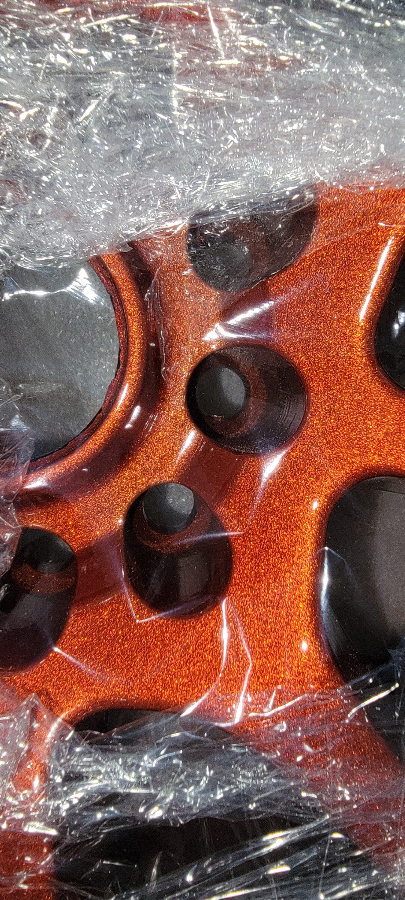

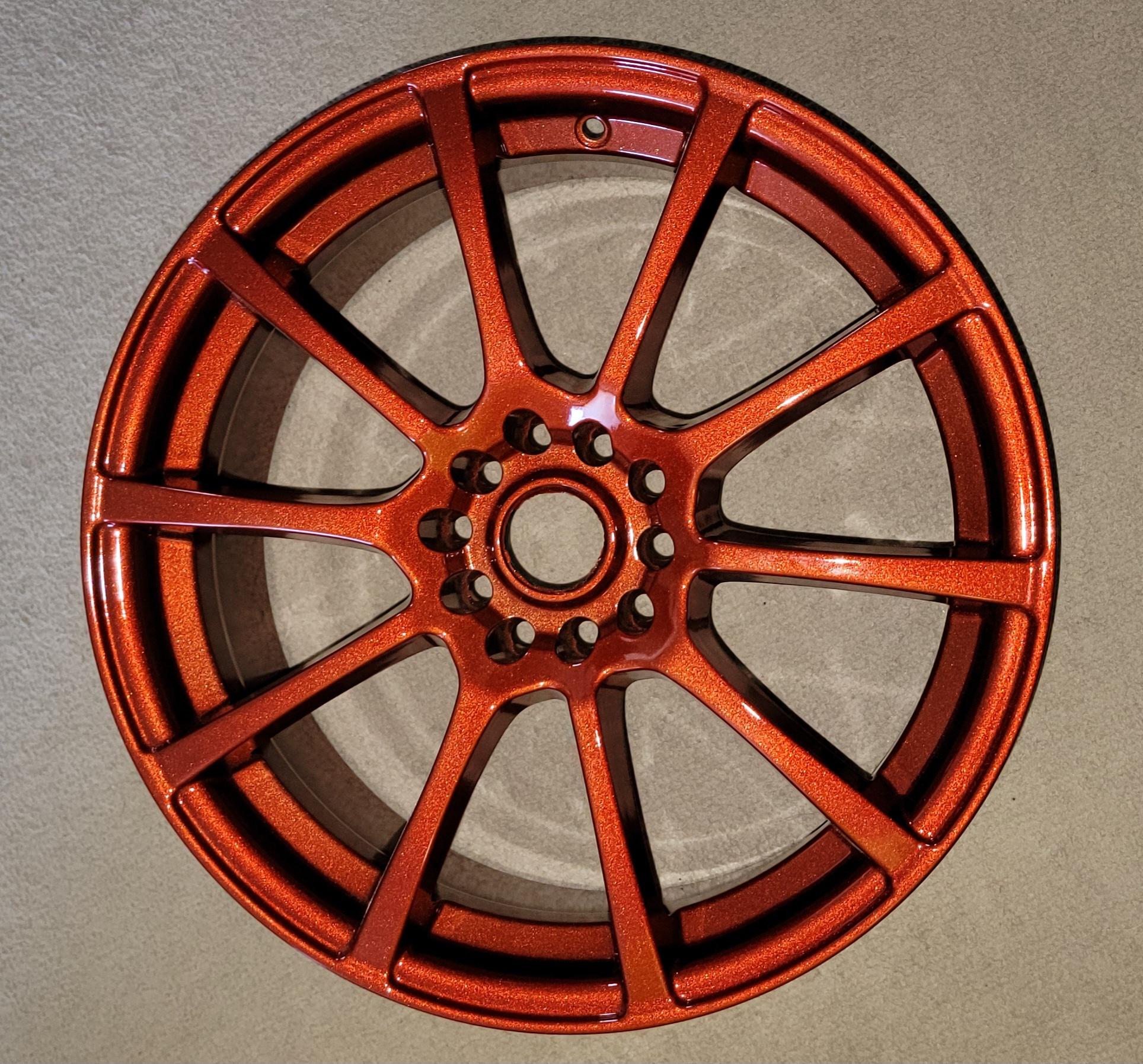

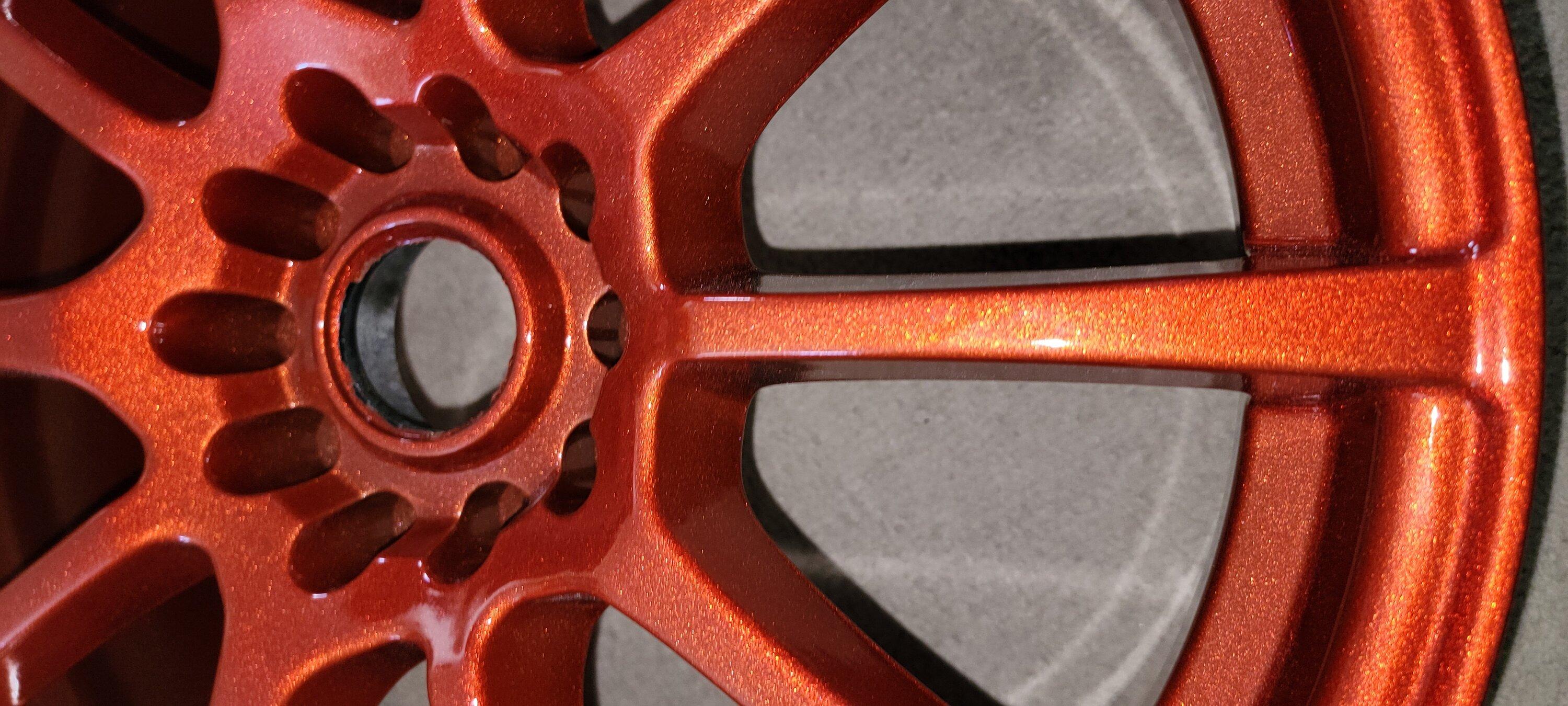

I purchased the wheels prior to having my Maverick and probably shouldn't have. They are 18x8 and +40. After test fitting them front and rear i loved the style. I knew I was going to have them powdercoated but hadn't chosen a color. After months of indecision I finally made a choice on color, copper burst dormant. The part I messed up on was not verifying that the 14x1.50 tuner style lugs would fit. I had them powdercoated, had tires mounted and then went to install them. Everything went great until the lugnuts lol, they do not fit. The manufacturer and the place I bought them swear the lugnuts fit, they are nowhere close to fitting. So my options are wheel spacers to get a smaller stud which 12x1.50 or 1/2-20 lugnuts do fit or swapping out the factory wheel studs. Spacers would work if I wanted the wheels to poke which I dont so it looks like I'm going to get intimate with the wheel assemblies on this thing. I will be pulling a stud tomorrow to measure things so I can get the right parts. Anyway don't forget to check that whatever wheels you choose will work with the 14x1.50 lugs. 30 years of turning wrenches professionally and I skipped over the simplest of things. Don't be like me lol.
