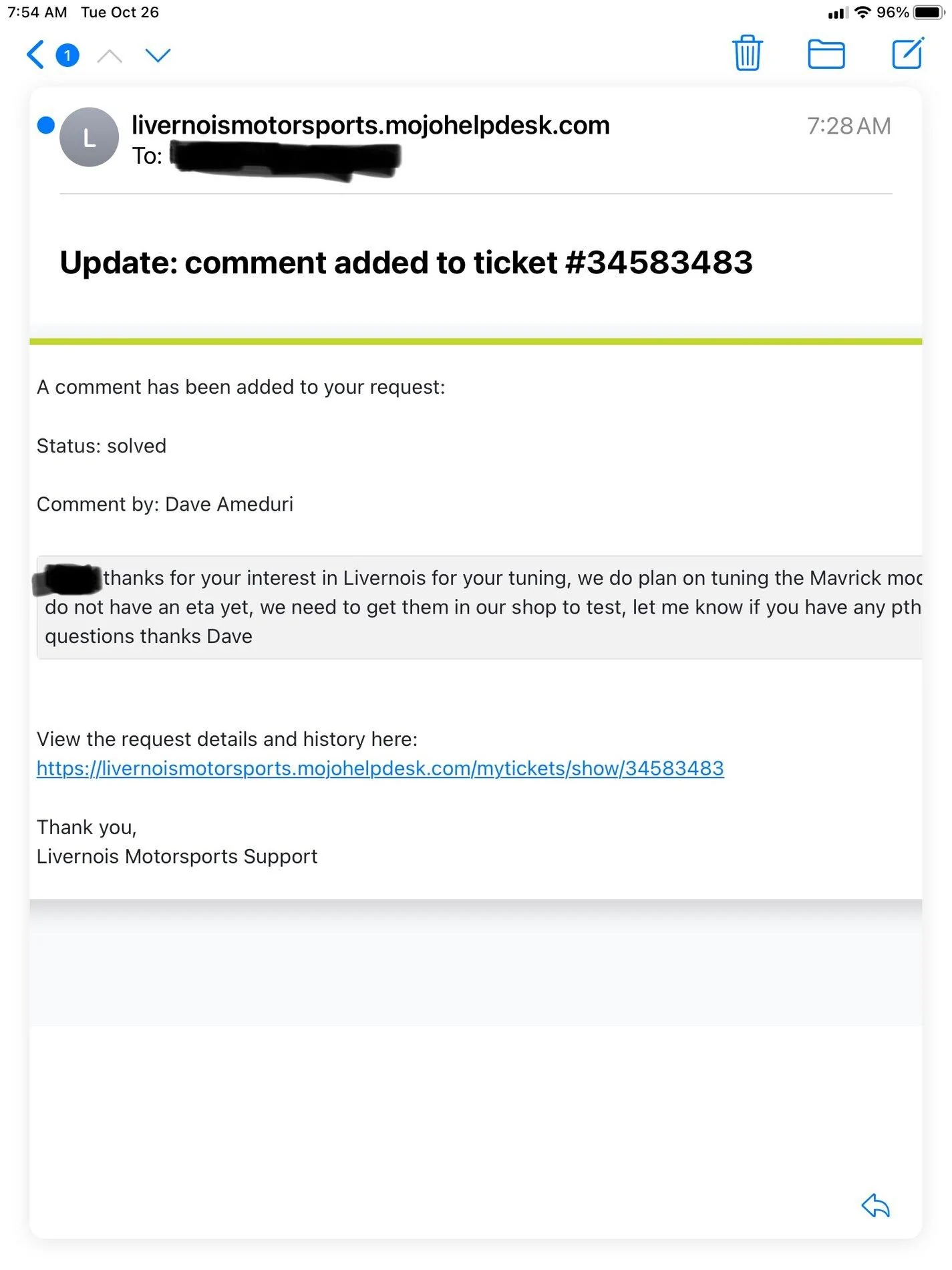

Reached out to Livernois Motorsports about tuning because I know they have tuned the Ford 2.0 ecoboost in other platforms.
