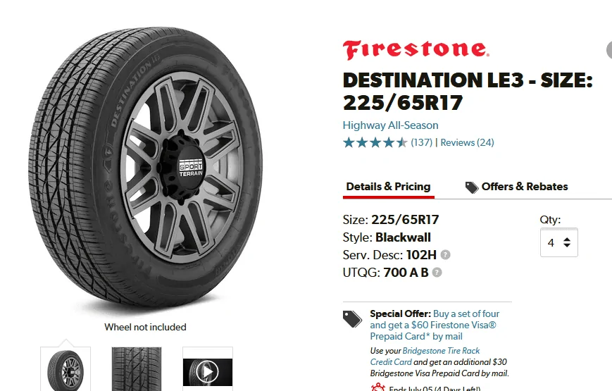

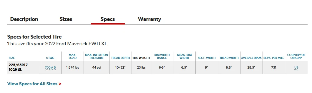

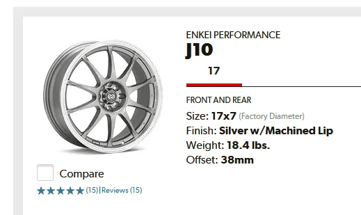

I went with this package which was about the lightest setup I could find. 18.4# per wheel and 23# per tire.I'm looking tires for my hybrid Mav that are lighter in weight than the included tires but still have the capability of those tires. My understanding is that the included tires are about 25 pounds. Has anyone come across tires that would meet these conditions?

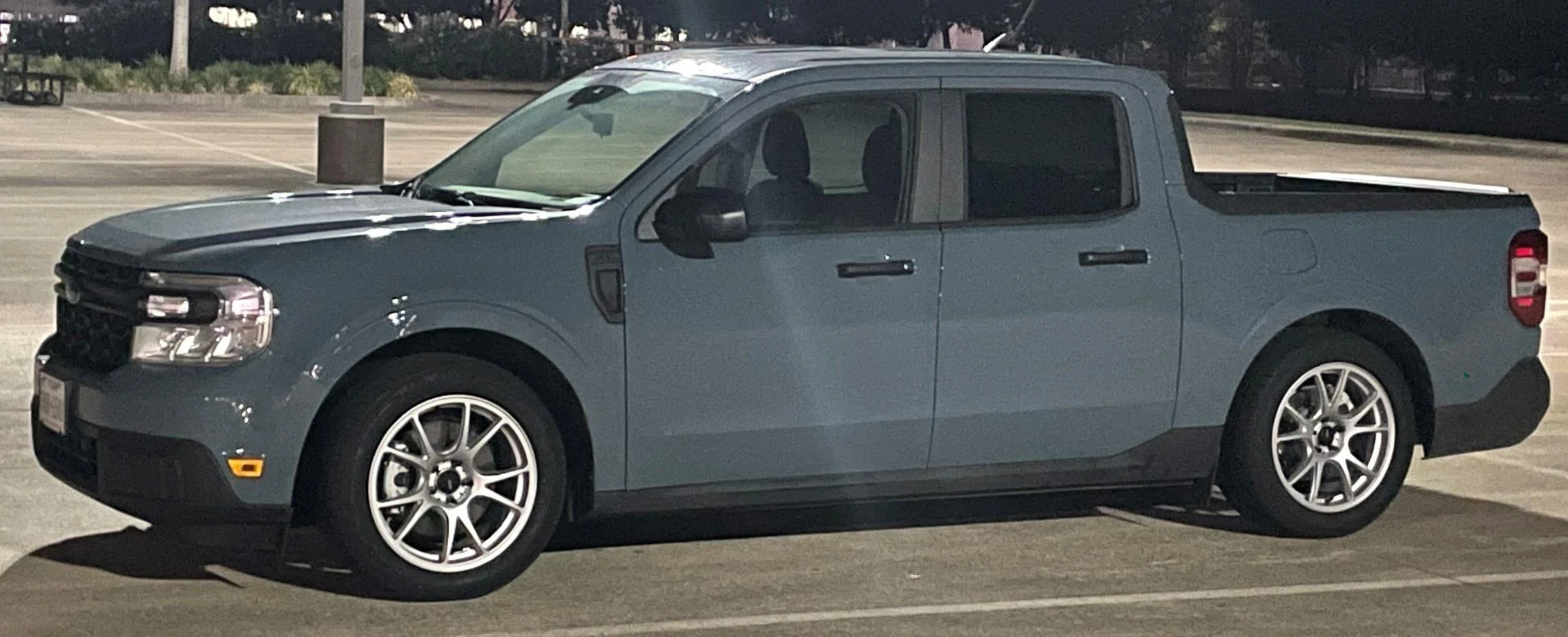

i chose rims for mine sorting by lightest weight first (and then by $$) and found these 18" konig freeforms to be just over 18#. the tire i selected is wider than stock (and 29#) but i am still indicating 30.5 MPG daily commuting my turbo. 7K miles and only left the city limits once.Thank you, lighter rims it is then. My Mav is oxford white what do you think of white rims?
