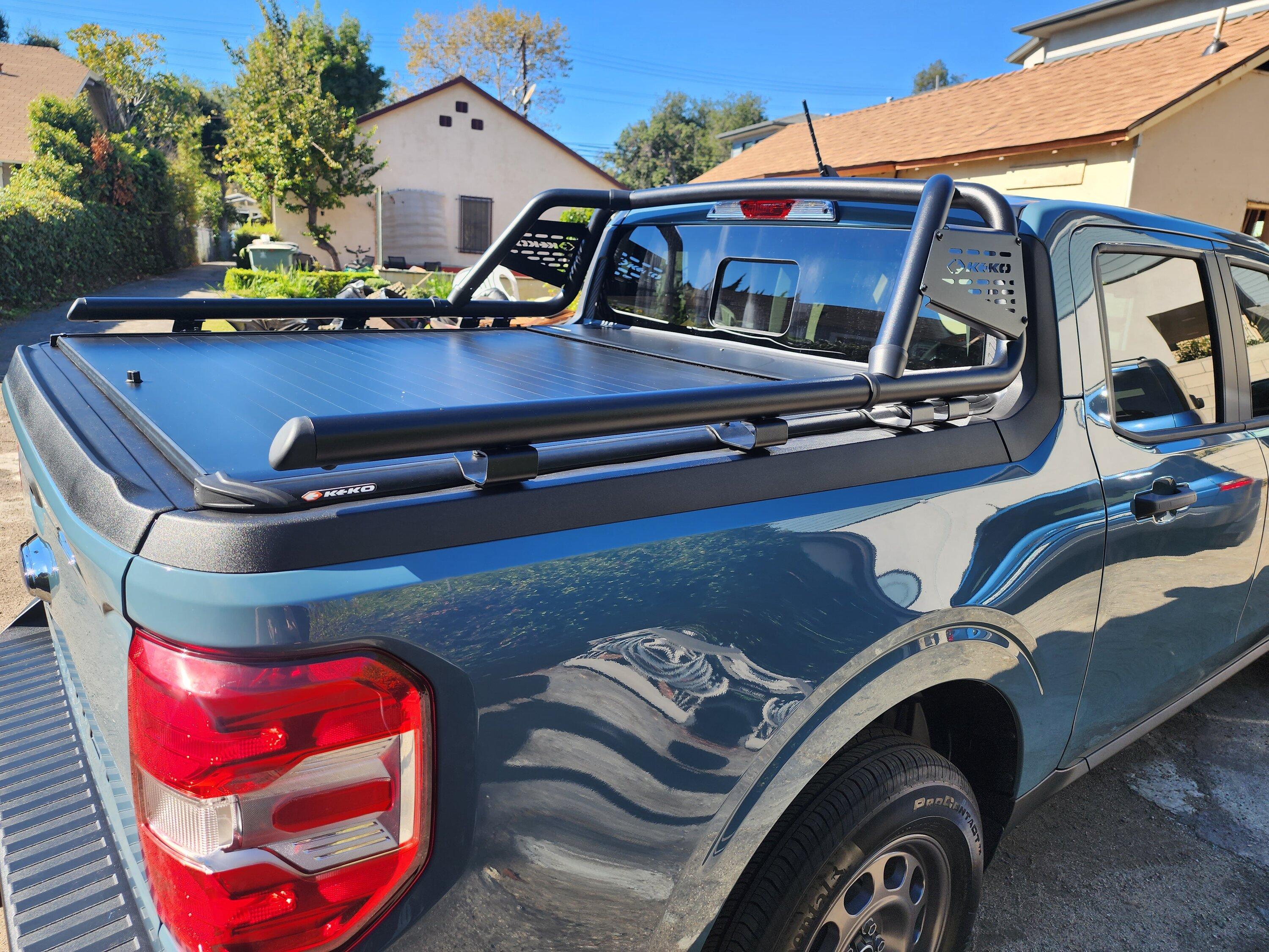

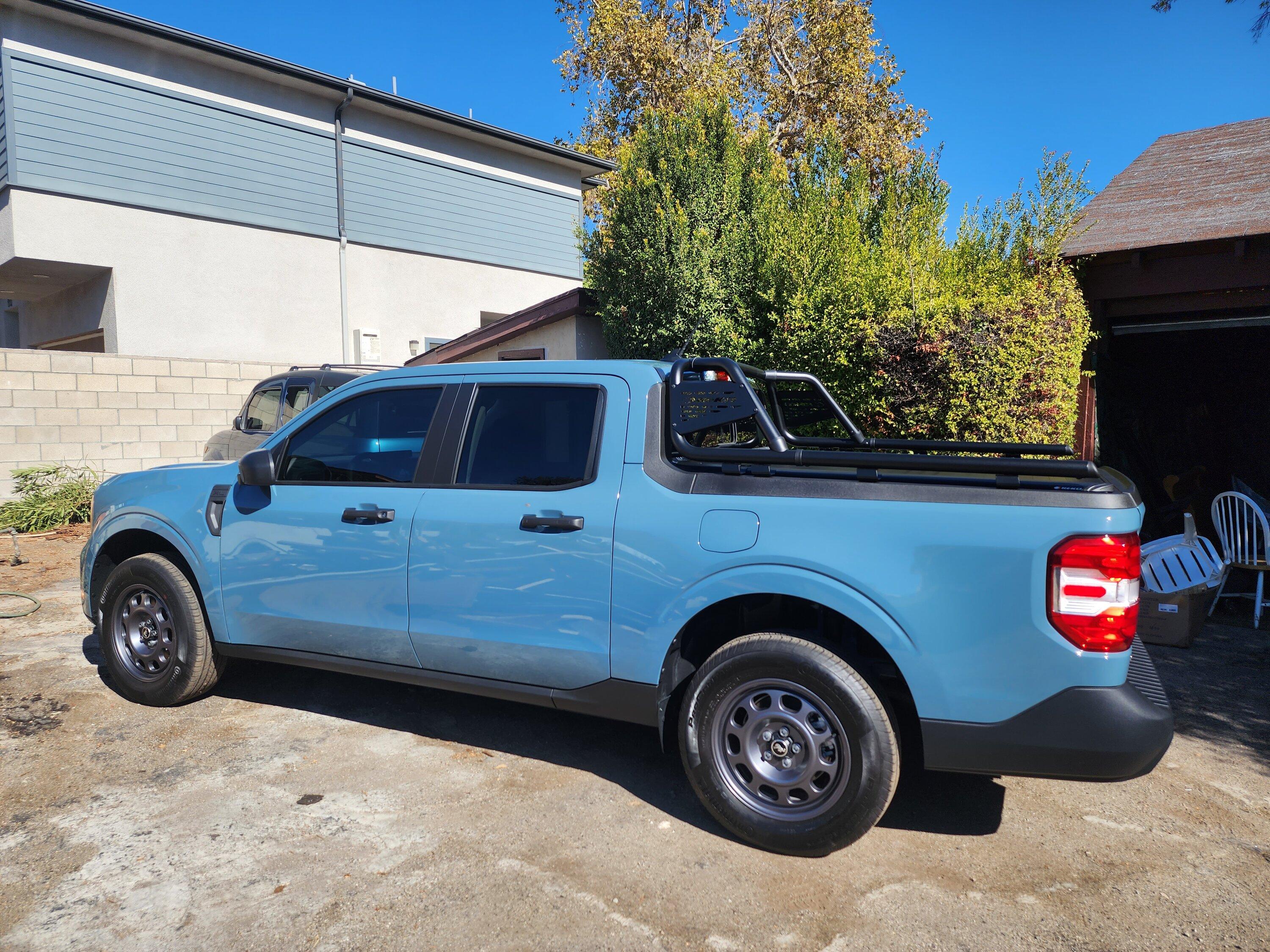

Just finished installing the Keko Sport Bar and wanted to confirm that the BAKFlip MX4 Tonneau cover fits ...mostly. Got it torqued to spec and feels just as secure as it was before.
I installed the MX4 bed rail over the Keko brackets and seems to be alright. The MX4 lines up and clicks secure into place when folding it down. It lifts the MX4 about 1/4 inch all around, but overall seems very secure. I've got a weather strip on order to fill the gap. Also, the sports bar does not allow the MX4 to fold all the way to the glass, but I am ok with this as I rarely ever fold it like that.
