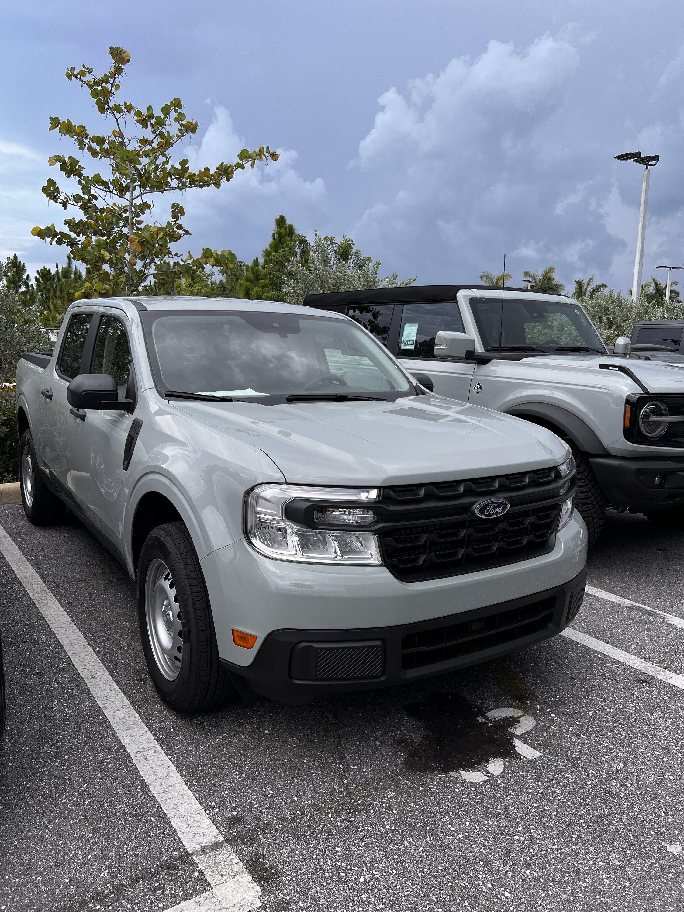

Got the truck!!!!

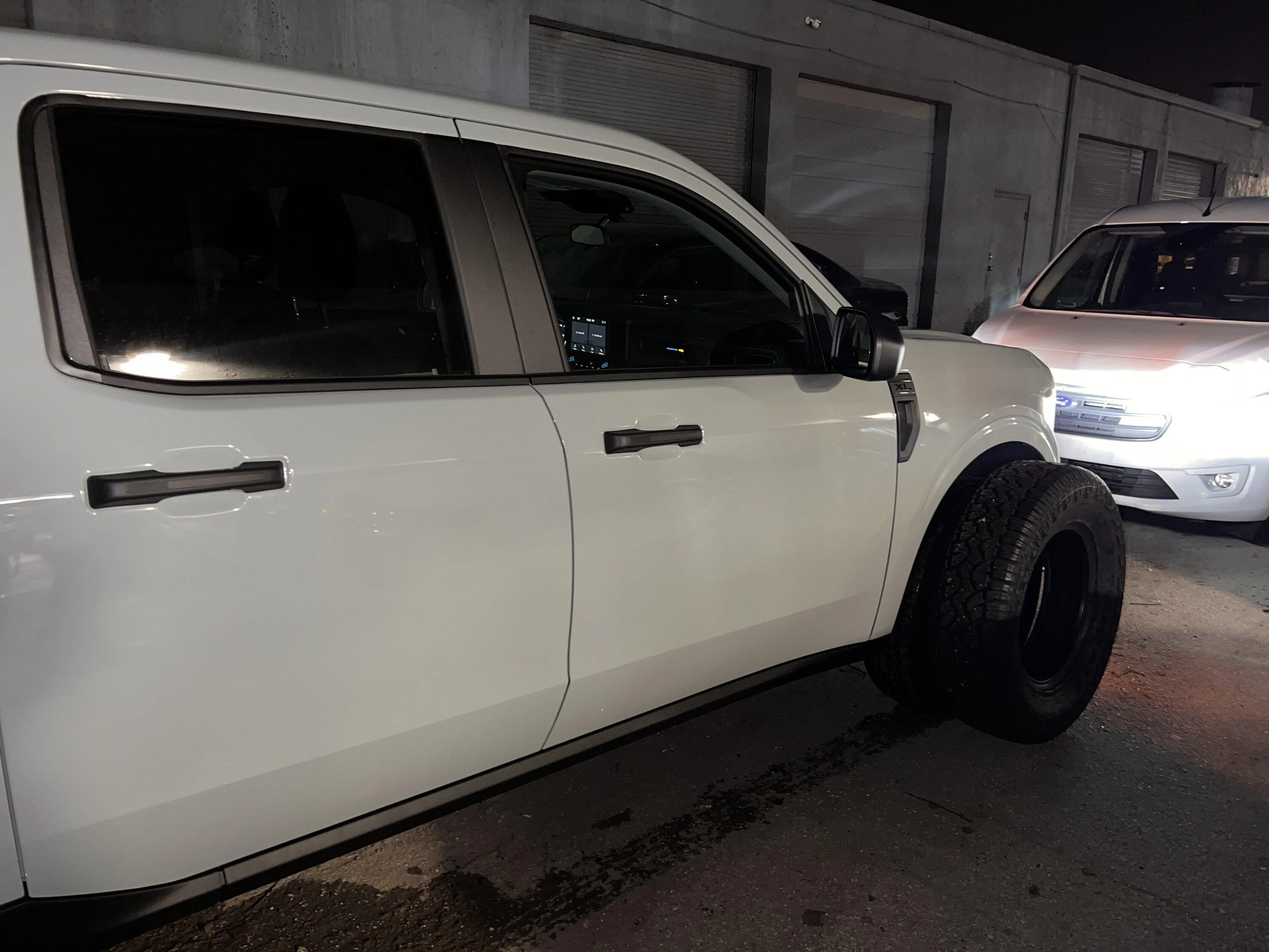

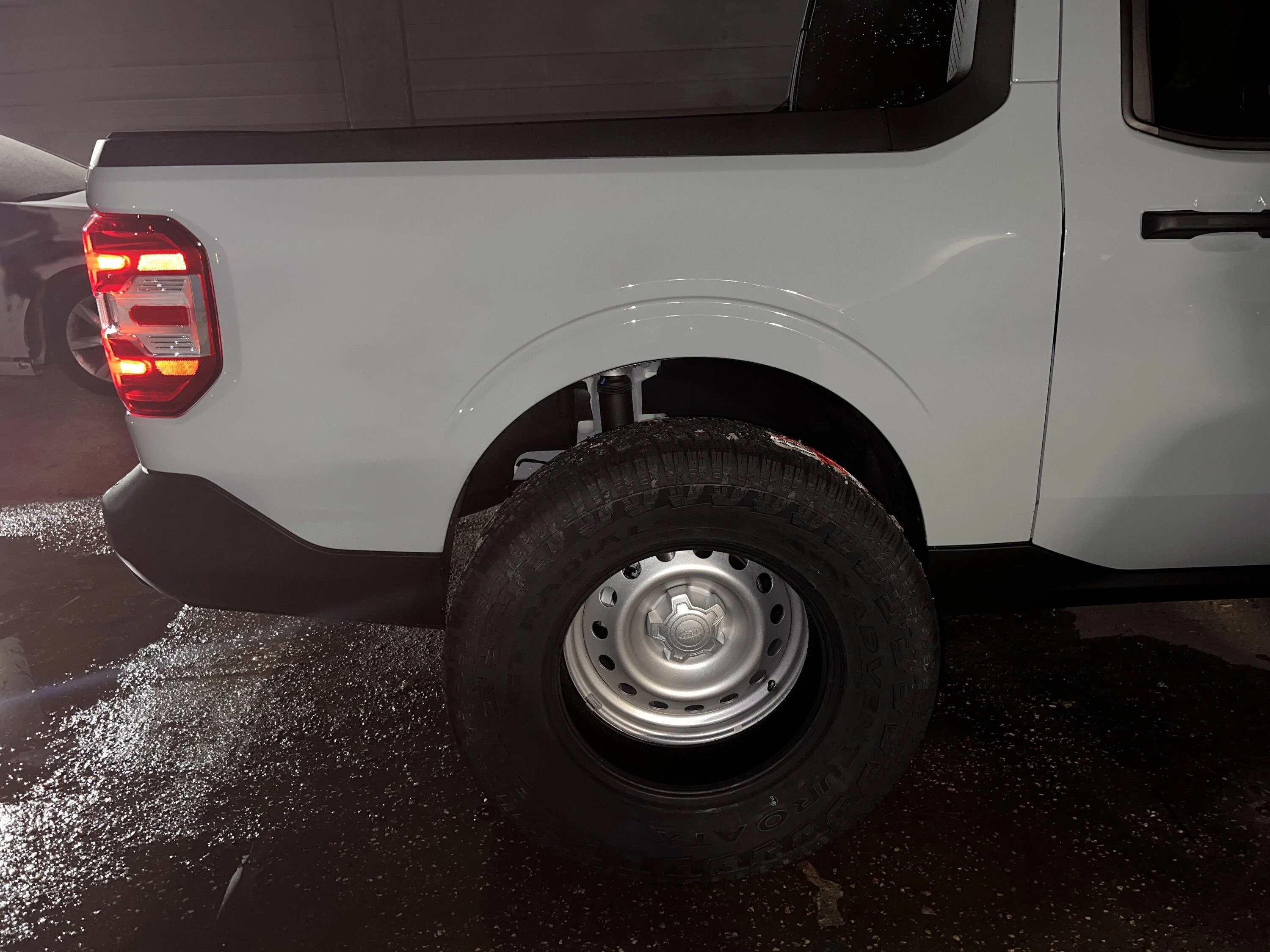

GT radial 265/70/17
lift kit should be installed by sunday 6/25/23
I’ll take videos of the process and what i have to trim.
so far I LOVE the truck.

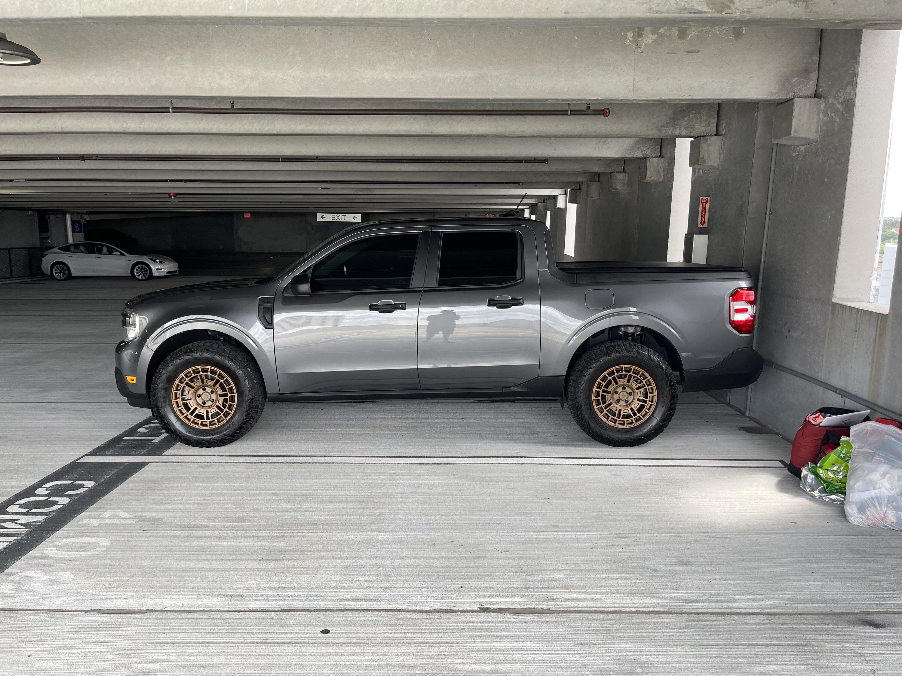

265/70/17 thunderer Ranger tires on mine. I did cut the pinch weld but never actually broke the weld itself.
How's full lock turning? Any lift kit?
No lift. I lost some turning radius but not that much. Stop some rubbing on inner fenders, but it’s been working good. There is more road noise and vibration in the wheel (highway speeds 75+)
