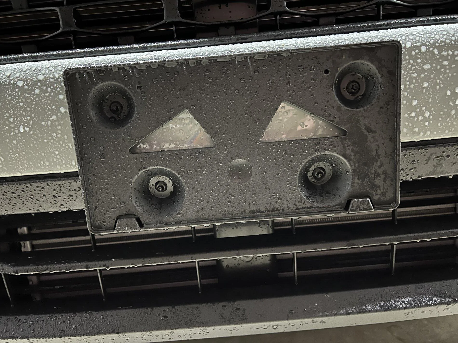

Thanks, I completely forgot about asking them not to drill the holes unfortunatelyThose are plastic rivets. You can push the center pin out using an awl or a nail, etc. then pull out the body of the rivet by sliding a knife or thin screwdriver under the head.
You're going to have 4 holes there....too bad it was ever installed if you didn't want or need it. You might find some plastic plugs to push into the holes, but it still won't be very pretty.
Hopefully your post will help future buyers remember to tell their dealer to not install the front license plate bracket (unless state required).Thanks, I completely forgot about asking them not to drill the holes unfortunately
I emailed them and I guess they are making a special batch for Maverick/Bronco owners.If you are really particular about your vehicle you can purchase these bumper plugs that come in body colors so the holes will be un-noticeable.
bumperplugs.com
I tried this, couldn't get them to budge.Those are plastic rivets. You can push the center pin out using an awl or a nail, etc. then pull out the body of the rivet by sliding a knife or thin screwdriver under the head.
If you can't get the pins out of the center using an awl with a hammer you will need to drill the pins out.I tried this, couldn't get them to budge.
