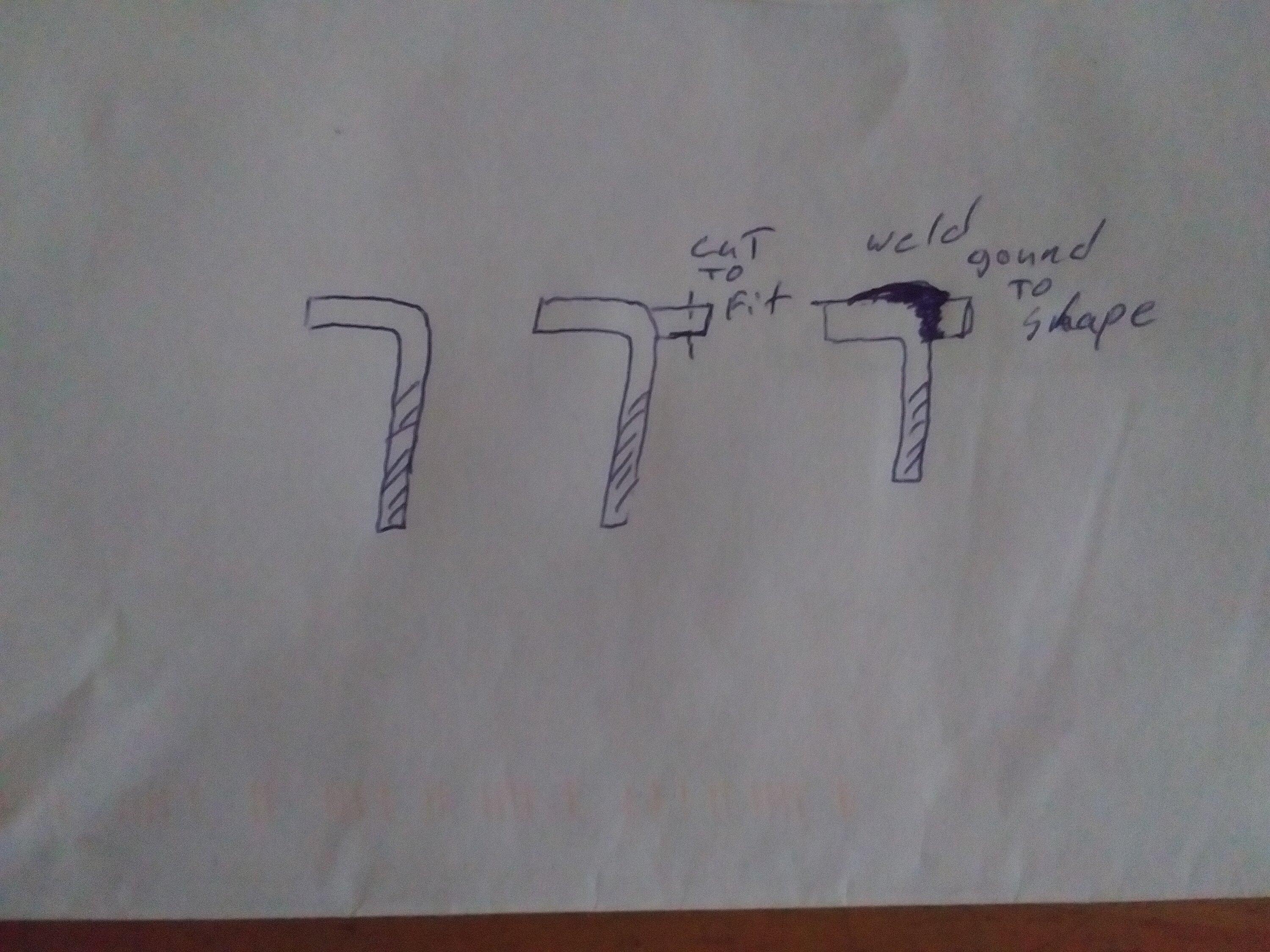

If you're having problems installing s bolts on your passenger side center bracket. You can cut the 2 bolts to an L shape take the leftover pieces and weld onto the other side to make a T shape. Build weld on top. Grind and cut down to slide in slot. Turn 90deg. Posting rough picture
