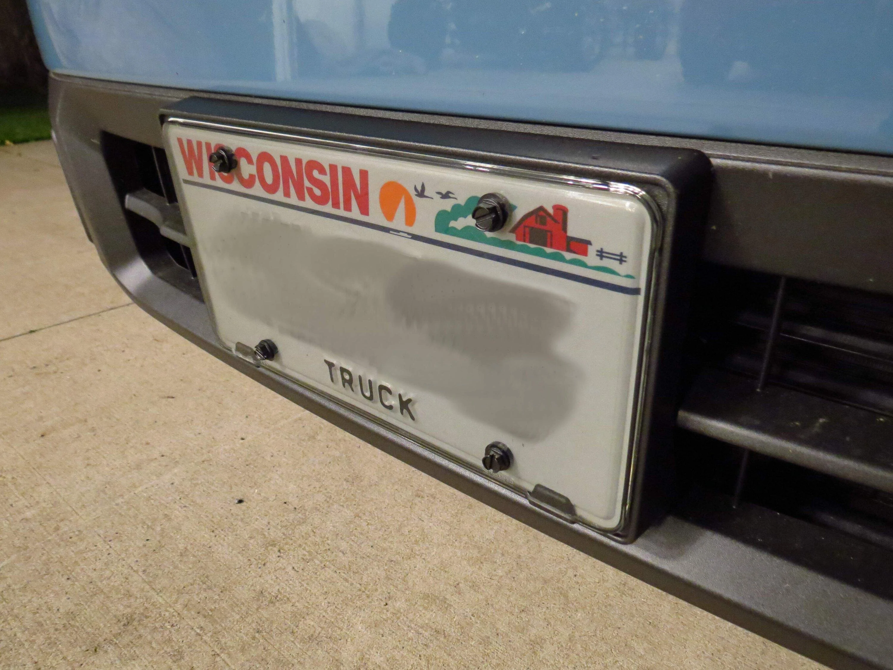

Mine has the plate holder installed in the lower black part of the bumper cover using #14 x 1-1/2" long sheet metal screws.
Ford Maverick Has anyone installed the front license plate bracket without the plastic rivets? hillman-sheet-metal-screws-4449-64_300_
I know the exact size because I just had to buy a couple more of them. Thse screws are sizable enough that they look like lag bolts. With the proper size pilot hole drilled in the bumper plastic, these screws hold solidly - without the need for a nut on the backside.
The plate bracket itself has holes in it other than the holes where the metal license plate attaches to it. But these screws go through the plate holes and secure both the plate and plastic bracket to the bumper. Removal is quick and easy, and the pilot holes in the black plastic of the bumper are minimally visible.
Ford Maverick Has anyone installed the front license plate bracket without the plastic rivets? Img_0777
I added the bottom screws just to hold down the bottom of the plexi plate cover - they only screw into the plate bracket itself and not the bumper.

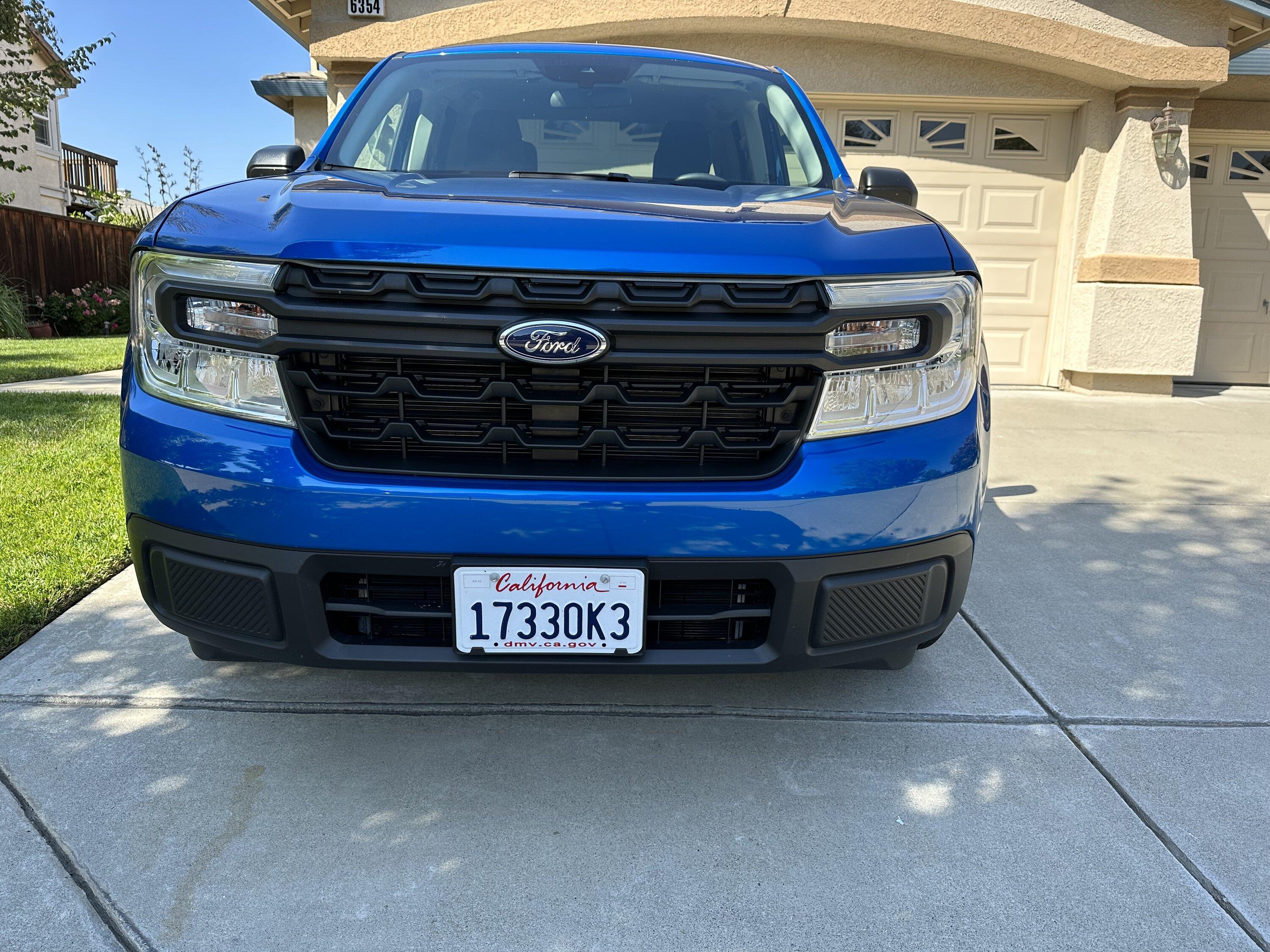

My dealer used screws on only one of the Fords that I bought from them recently. I'm very certain that it was something elase on/behind the bumper for each screws. I think they only used two screws not three and the screws seemed to be heavily coated for rust proofing. I often use 3M tape at the edge of the bracket to help preventing scratches from the bracket. I applied several coats of many kinds of wax before I reinstalled the bracket because I was not planning to pull the bracket out just to clean the area behind it.
