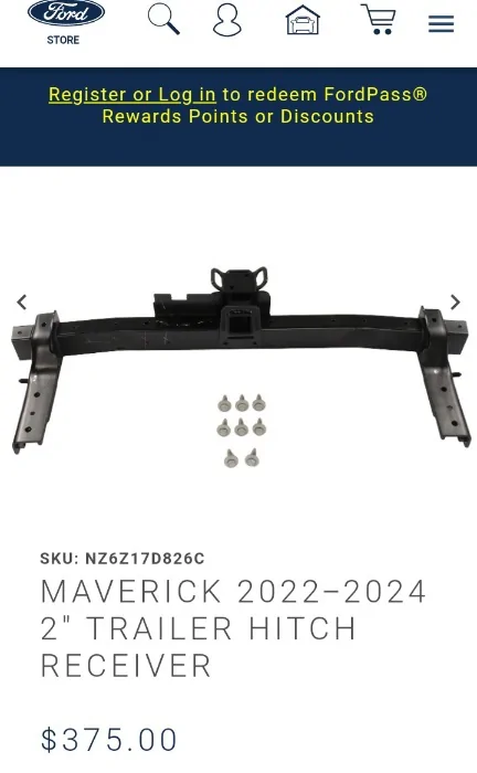

🤔There are two types of hitches you can choose from one is installed INTO the bed frame rails(factory style) and the other is attached to the frame rails.(add-on)

Glen is right though. You have two options.
I’d probably go with the OEM all in one crash bar and hitch but for your purposes the a Curt or Lock Tite will do just fine.
if you do the OEM one you’ll be removing taillights and your rear bumper cover.

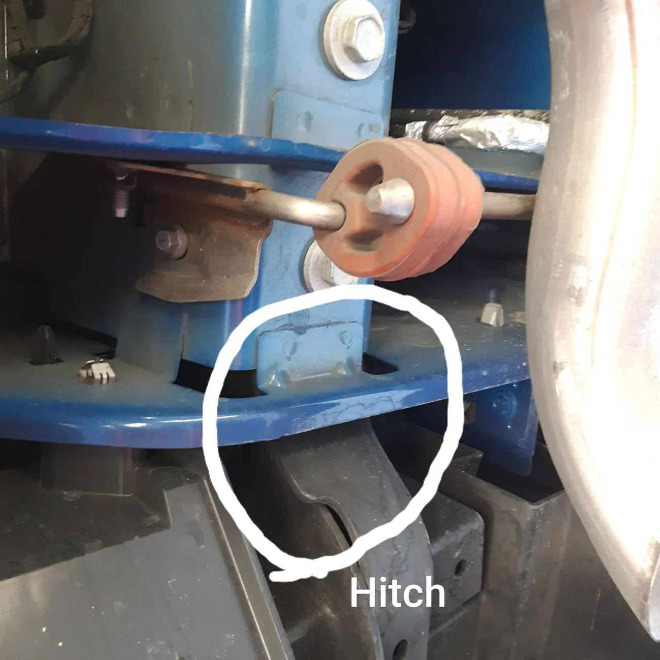

I bought the aftermarket one for the frame easy to install just a few bolts and I think it’s stronger than the factory ones
Then I bought the harness aftermarket that plugs in and it was really easy For the lights
Just out of curiosity.
What leads you to believe the bolt on is stronger than one that is designed to fit within the frame structure of the truck?

I purchased the OEM hitch and installed by myself. The job took about 3 hours. Straight forward following utube video. One tip would be to remember where each screw attaches the plastic bumper. There are like 3 different sizes.
