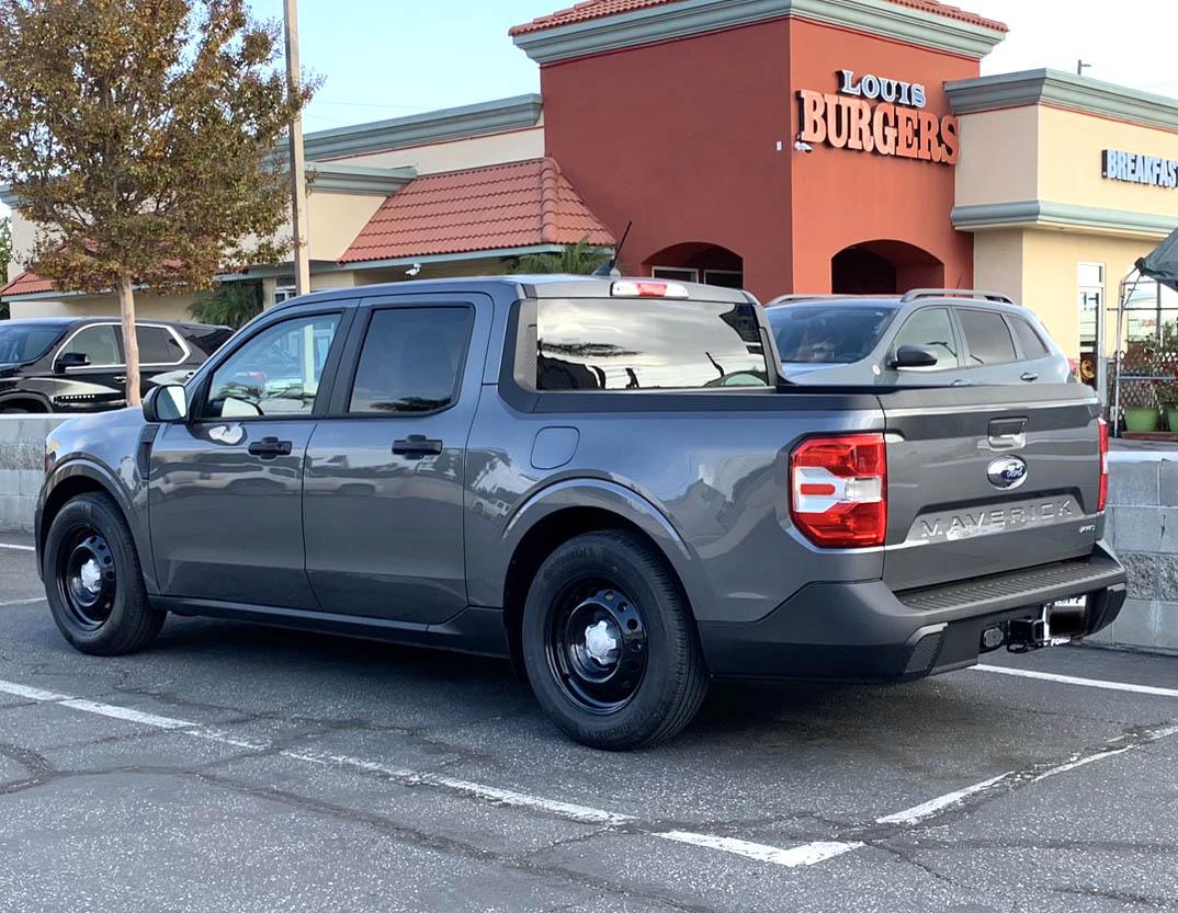

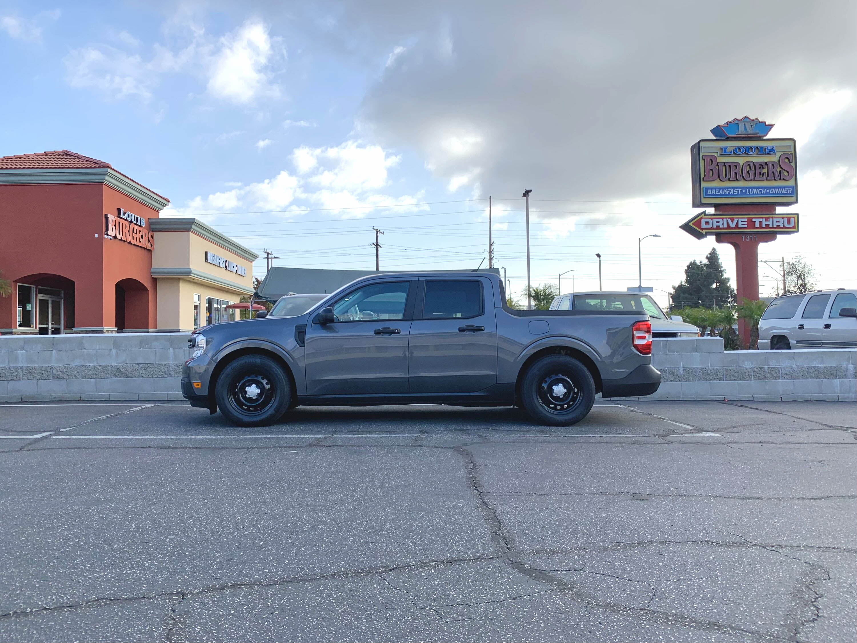

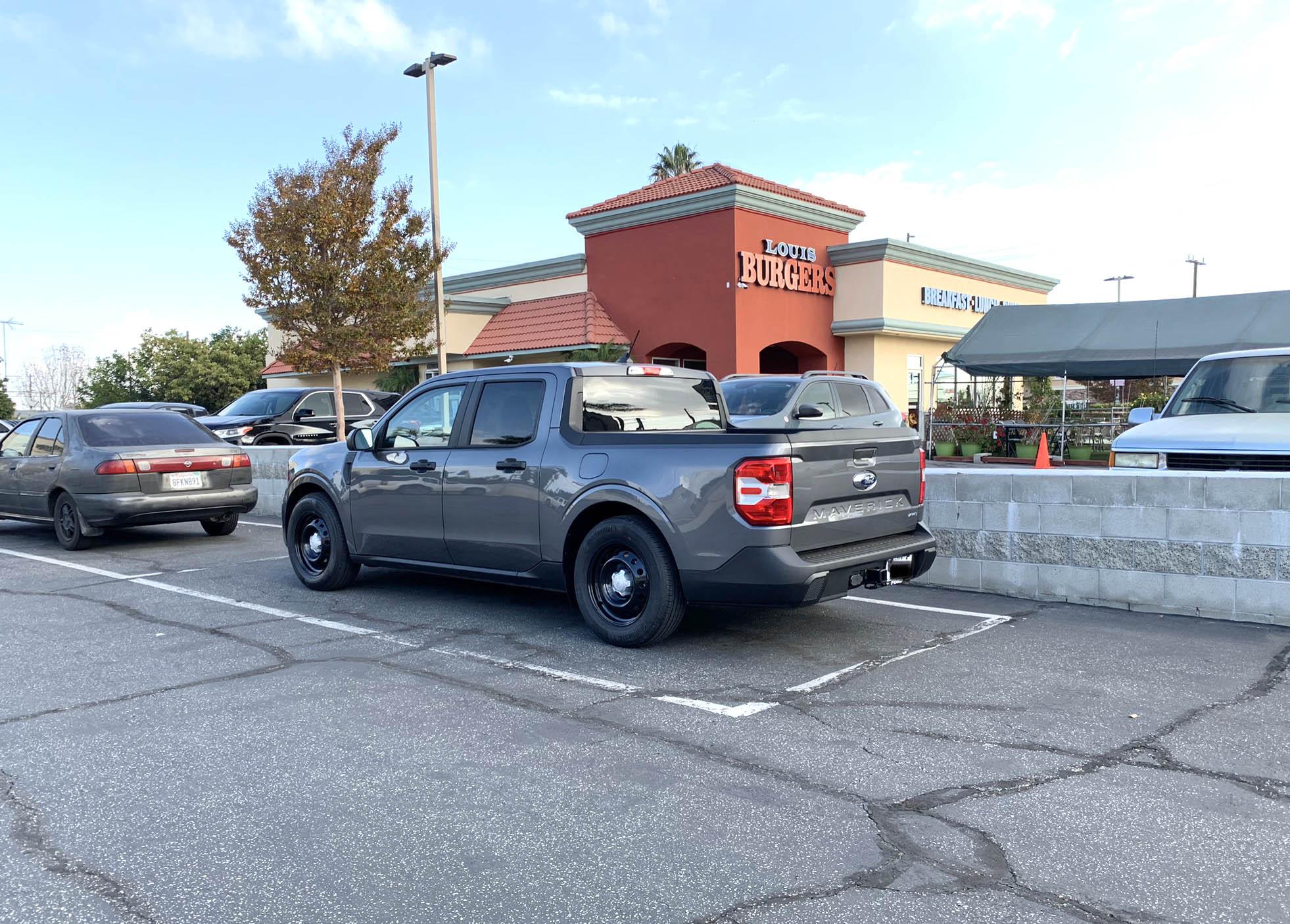

Just installed H&R super sport lowering springs on my Maverick XL Ecoboost AWD.
Install was fairly simple. As of this post I’ve only driven about 10 miles with the springs so they may settle a bit more. The ride is noticeably stiffer, but it’s not uncomfortable.
There is visible camber on front and rear, so an alignment is definitely needed. Wheels are stock steelies painted gloss black.

the center caps are the stock ones that come on the steel wheels. I just left them silver. Front is just your basic strut, used spring compressors to get the stock springs off, don’t need them when installing the H&r springs. H&r tells you to cut 20mm off the top of the bump stop, but the top of the bump stop is larger diameter and it snaps into the dust boot. So I cut about 15mm out of the center of the bump stop and glued the 2 ends together.
The rear was more of a challenge, ended up removing the outer bolt on the rear lower control arm, the sway bar link, and lower shock bolt. This allowed the lower control arm to drop and I was able to remove the stock spring without spring compressors. Just make sure you have a floor jack under the rear arm when doing this so you can control the downward movement of the arm, as it will still be under spring tension.
