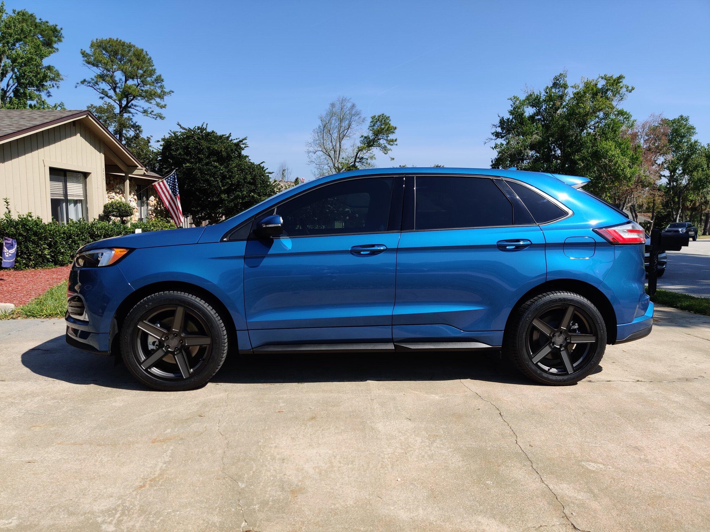

Yeah can you post the part numbers of all the items used to do this. I just sent my paperwork in to order my CG XLT maverick and I plan on using my existing wheels on my Edge ST for my maverick. 20x8.5 40 offset TSW Ascents seen in the picture I attached. And this lowering would just make it look perfect with my wheels.
