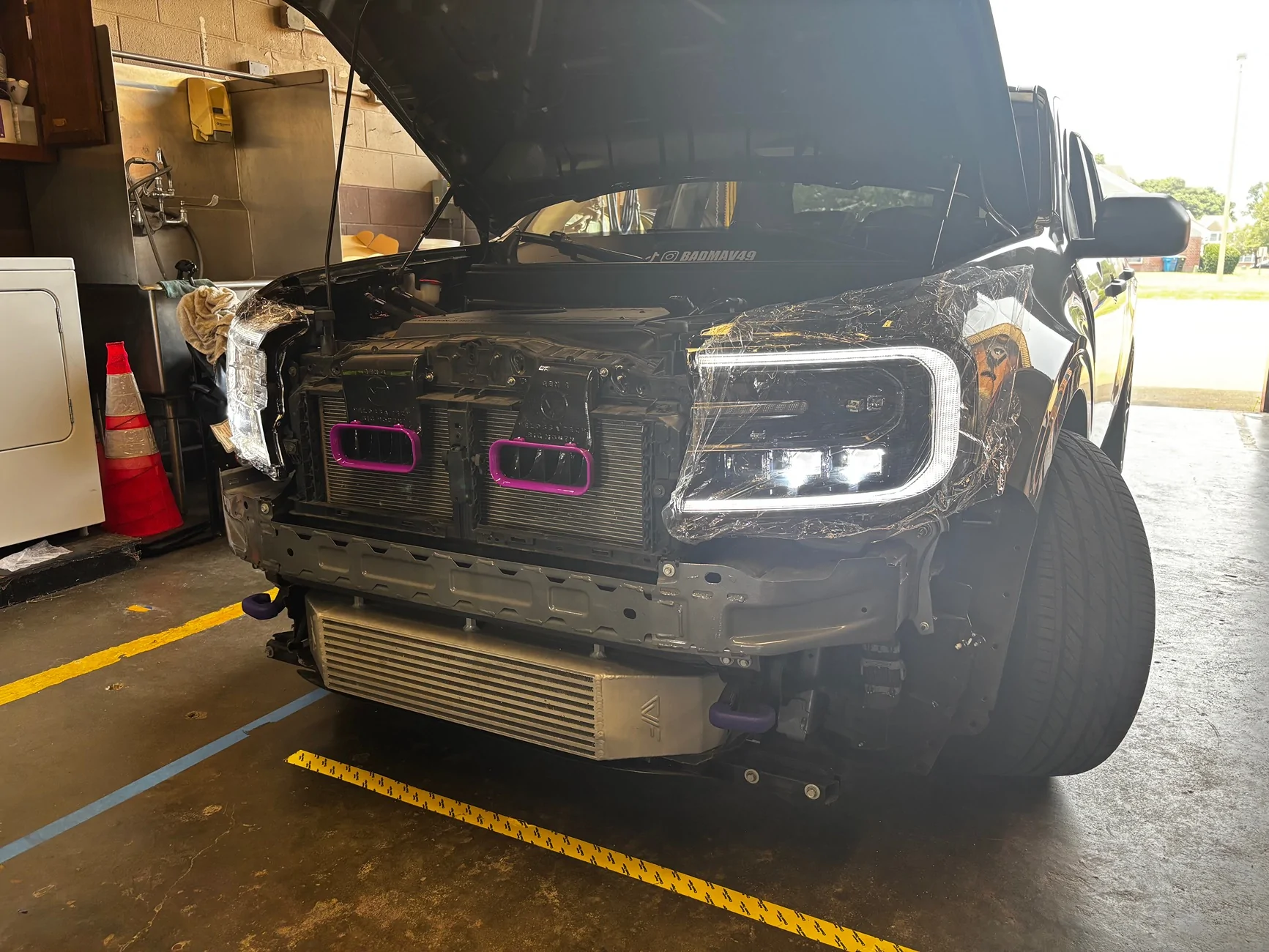

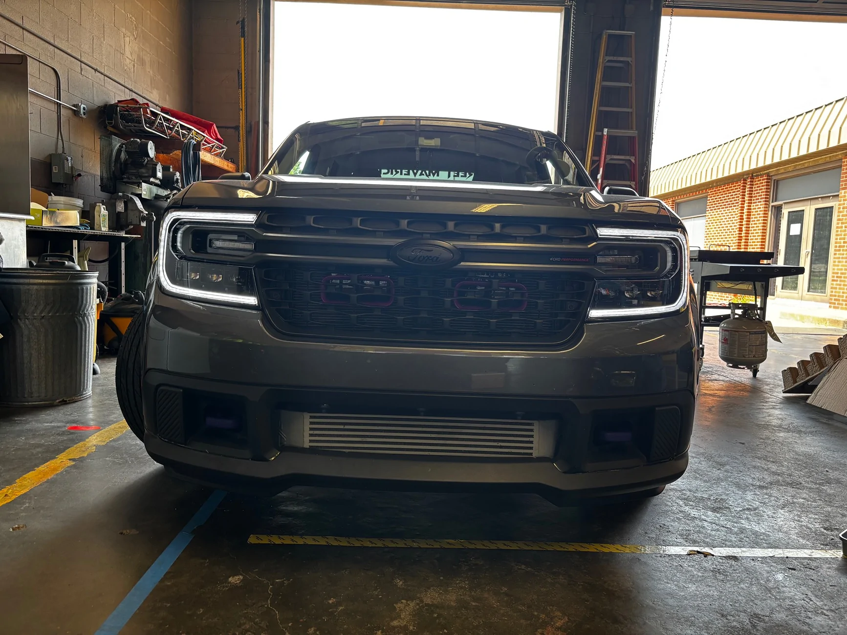

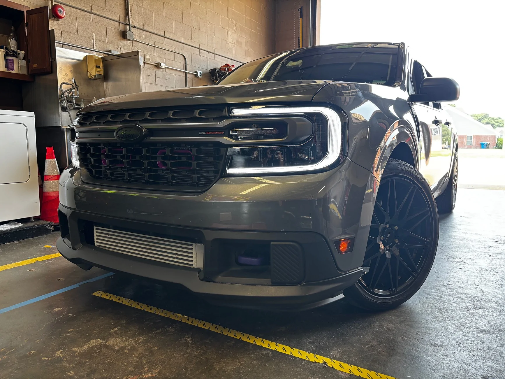

Finally got around to doing my form headlights. First off these look amazing! Install was easy. By far best lights on the market!
Looking sexy man!
What wheels are those?

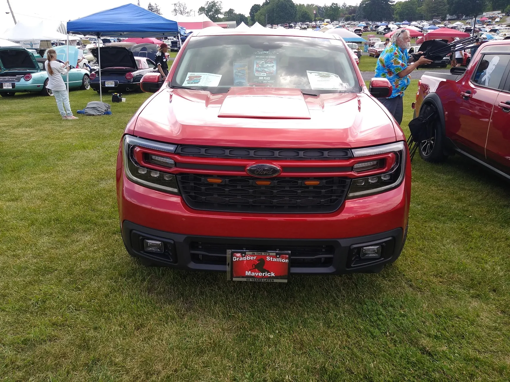

I installed mine in June before the Ford Carlisle Nationals. Did you connect your DRL wire to the fuse panel? Mine worked with the factory plug. Also do your turn signals only function as turn signals? I thought they were parking lights untill you switch on the hazzards or the turn signal. I believe the DLR accent is now our parking lights. Is that your take on these lights? Thanks for sharing your photos. Here is mine at Carlisle. I won second place.

I have not done the DRL Harness yet. The halo is on when lights are on or when parking lights are on. Turns are only turns now. I prefer this feature over the turns being the parking lights

So you did not plug into your underhood fuse panel? You just connected the main headlight plug? I see your DRLs are lit in your photos. There is a plug right where the turn signals are at. I tried connecting it to a 12 volt supply and it did not light up. I called Form lighting and I was told to hook up the wire to my underhood fuse panel for the DRL function. I told him mine worked by just connecting the factory harness. He also told me the signals are turns and 4 ways not parking lights. He kept insisting I had to wire it like they instructed in the video. I told him everything works without the fuse tap wire being connected. I did not connect the little purple plug or the other little plug. My turn signals flash sequintial. I don't care about the start up sequence because you can't see it from inside the vehicle anyhow.

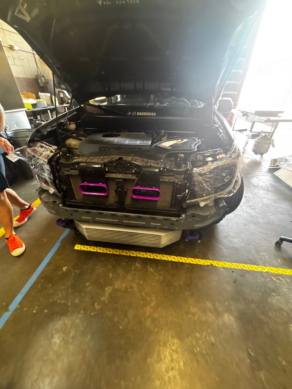

If I remote start, or turn parking lights on the DRL halo lights up. I did not install harness to fuse box yet. So the DRL is not on UNLESS your headlights are on. Also no startup sequence until harness is installed
