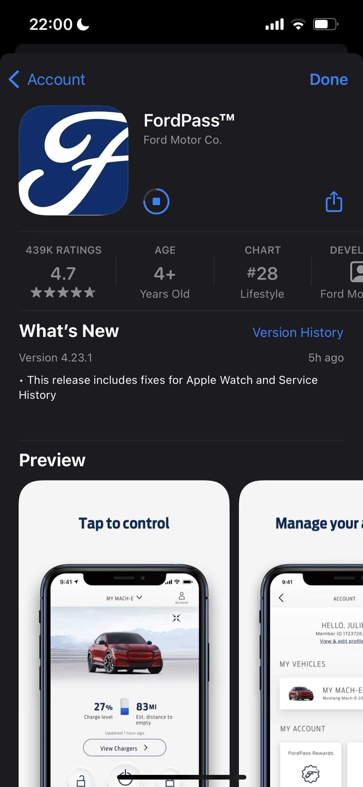

jsus
Dec 20, 2021
2,840
3,753
2022 Ford Escape Hybrid AWD
I just updated my apple devices (MacBook, iPhone 13 & apple watch series 4) and I was able to remote start my Maverick using my apple watch. Looks like the iOS update fixed the "Something Not Right..." error.
5 hours ago, an update was released - FordPass v. 4.23.1. The release notes indicate that it addresses issues with the Apple Watch app, and with the service history within the iPhone app.
Once this update was installed, the Apple Watch app is functioning as expected. The vehicle render appears on the display and commands are successfully sent to the vehicle.
To anyone with an Apple Watch, be sure to check for this update. You can force the update by going to App Store, tapping the circular icon in the top right (that's your Apple ID profile pic), then scrolling down to the updates section. If there's an UPDATE button next to FordPass, tap that. Once it finishes installing, give the Apple Watch app another try. Should be good to go.
