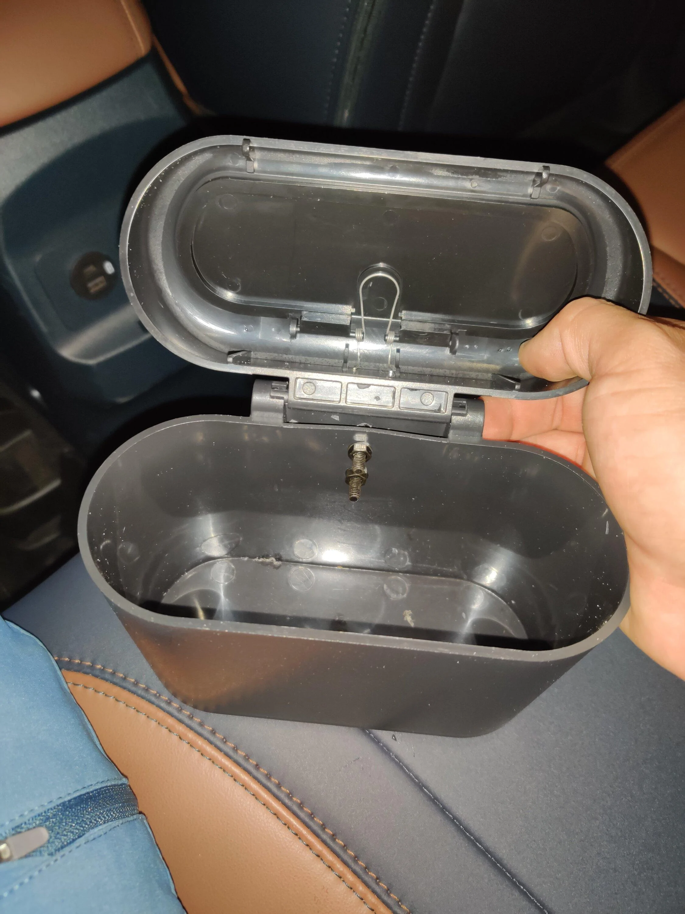

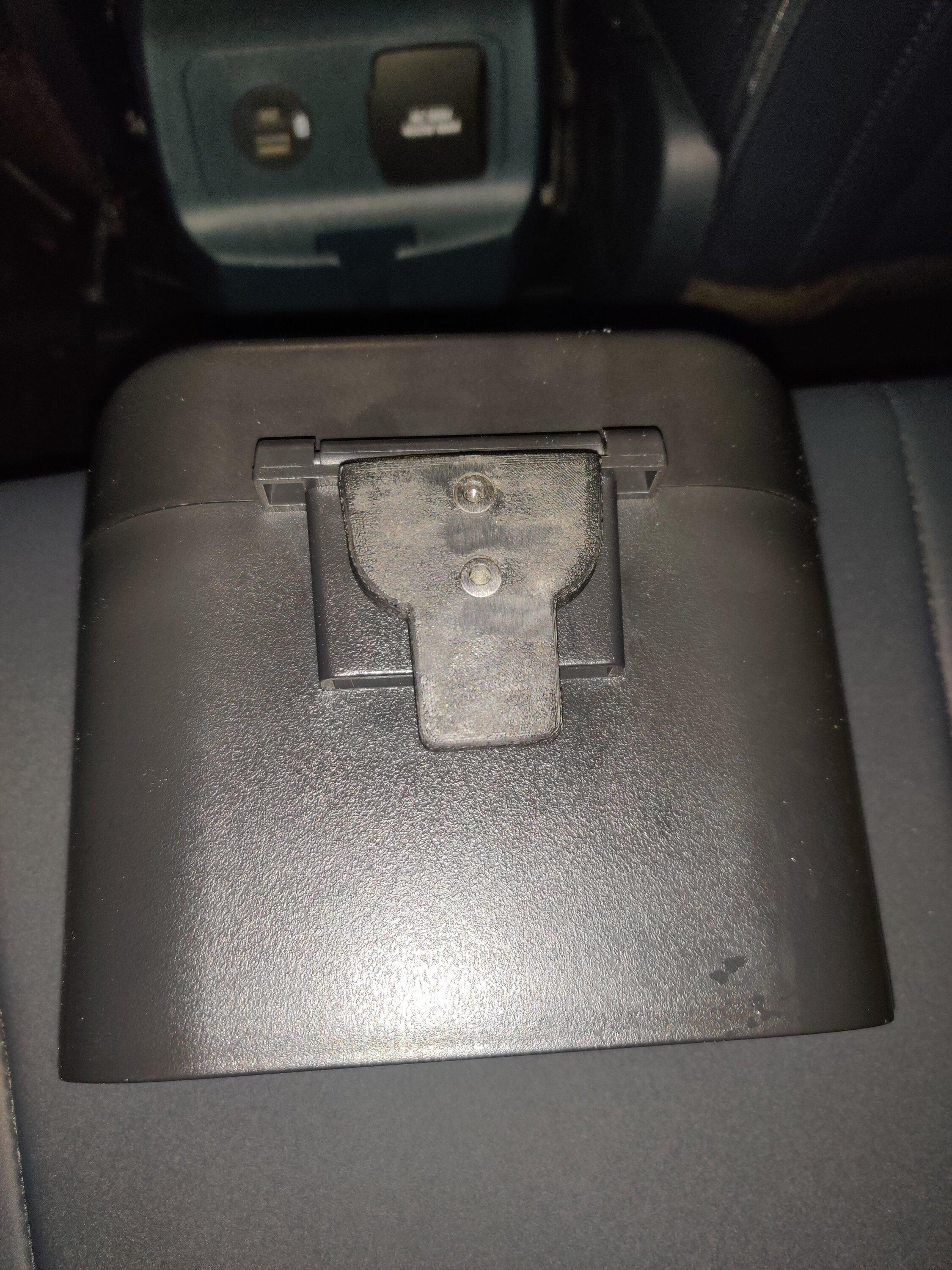

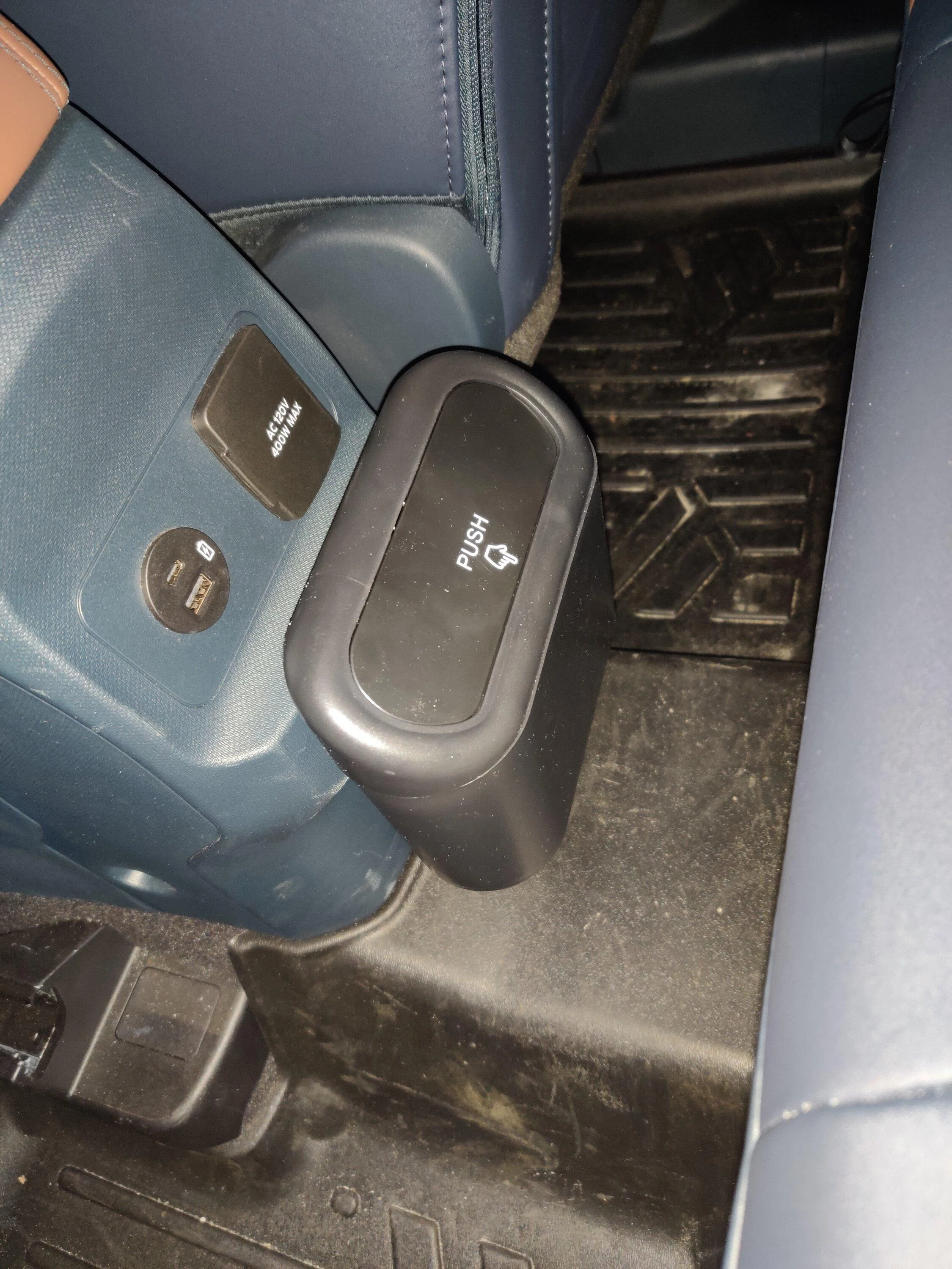

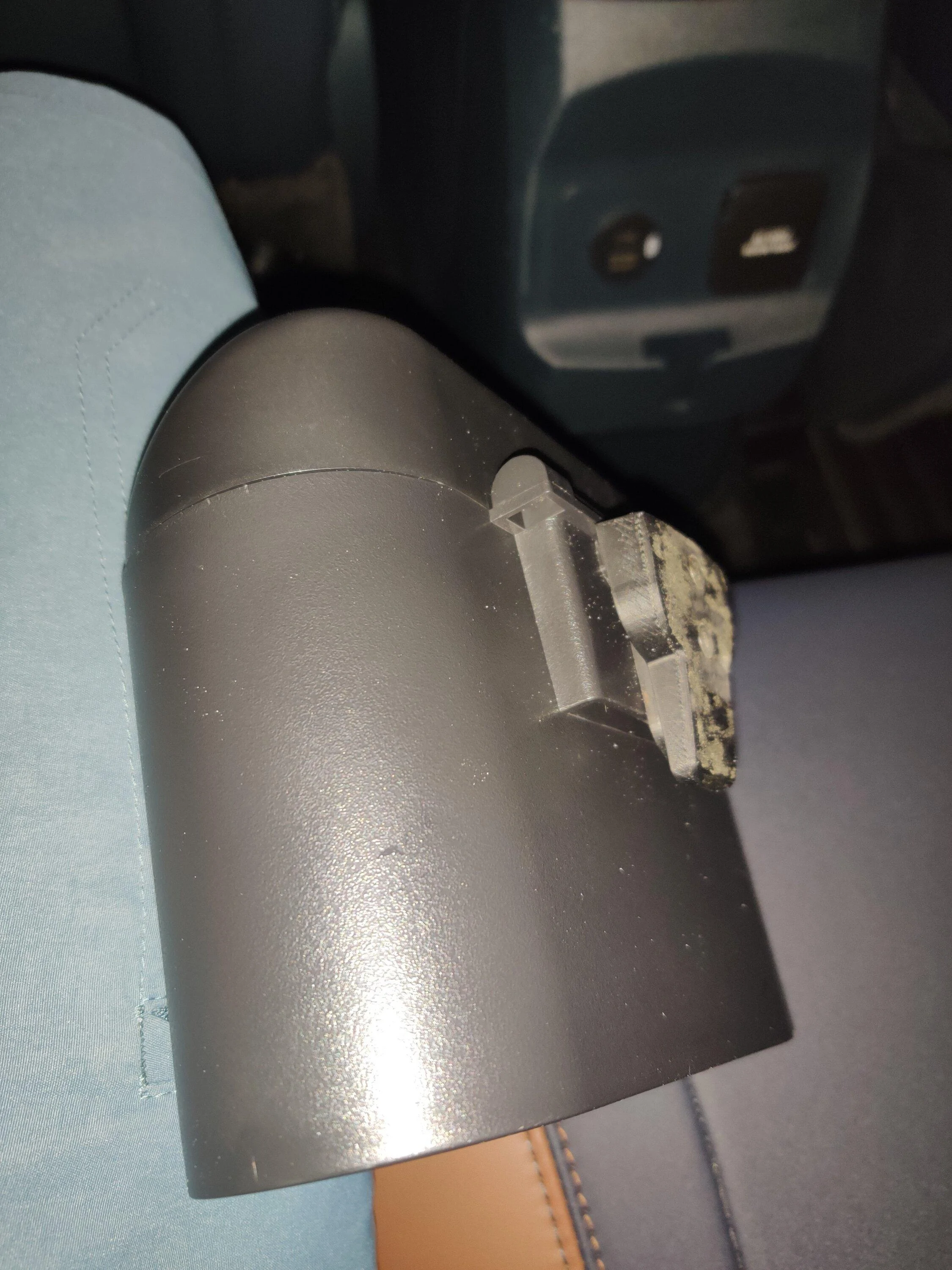

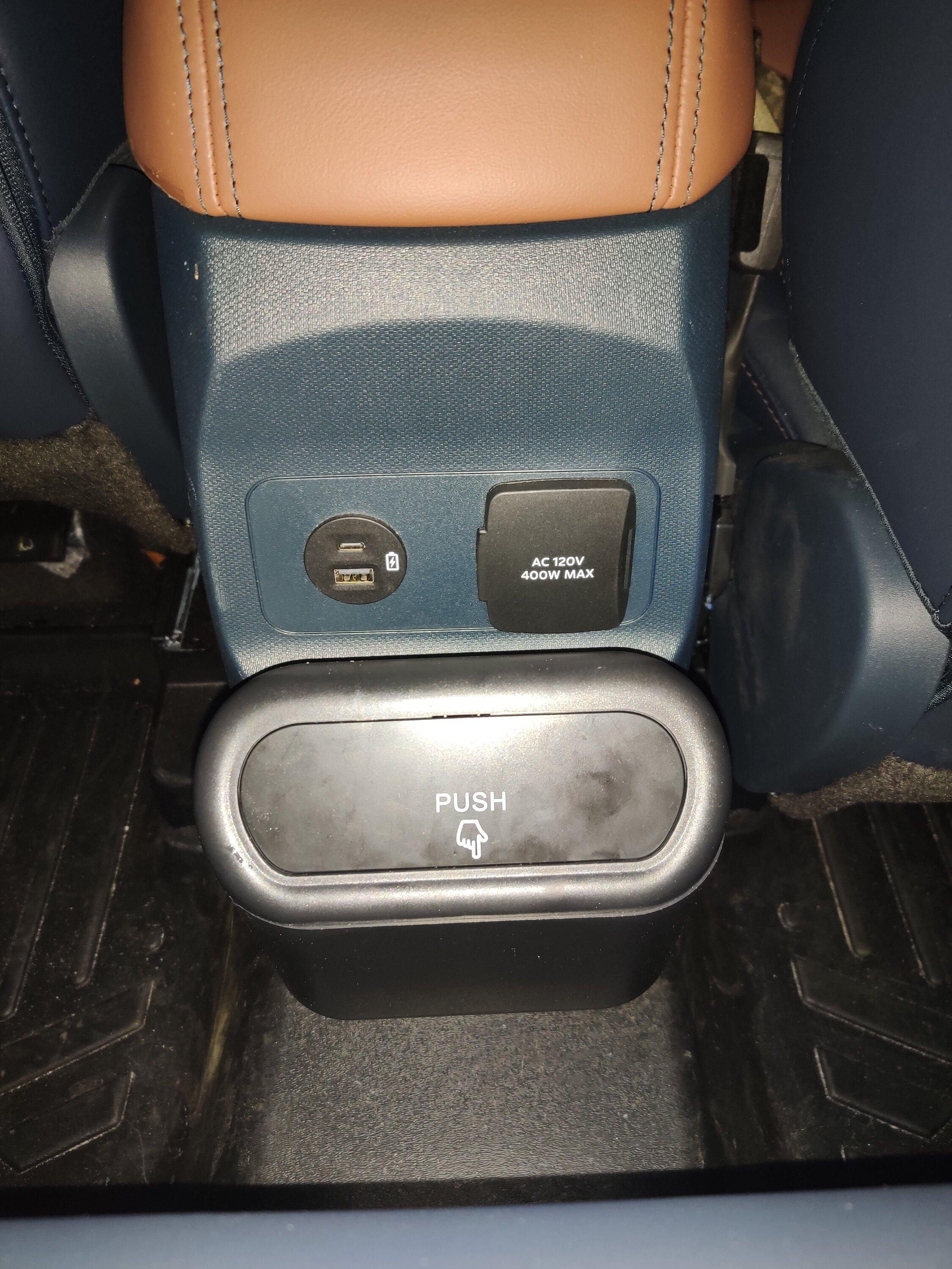

Ive seen other members post about trash cans they modified to fit the ford fits but Im Putting this up with pictures and links
Amazon trash can link
https://a.co/d/bge1RaJ
For those 3d prints check out links below
Ford fits
https://www.thingiverse.com/thing:5112826
My modified version for metric machined screws to sit flush
https://www.tinkercad.com/things/45TwQUCyrYg
I plan on cutting back the bolts to be flush with the nuts but it was late and I was done for the day as I had also completed other projects to the Maverick in this Brutal heat.
