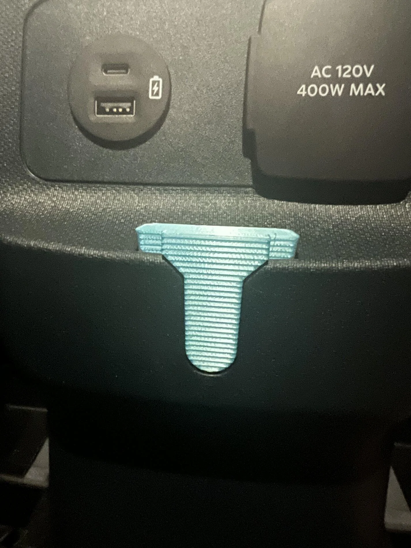

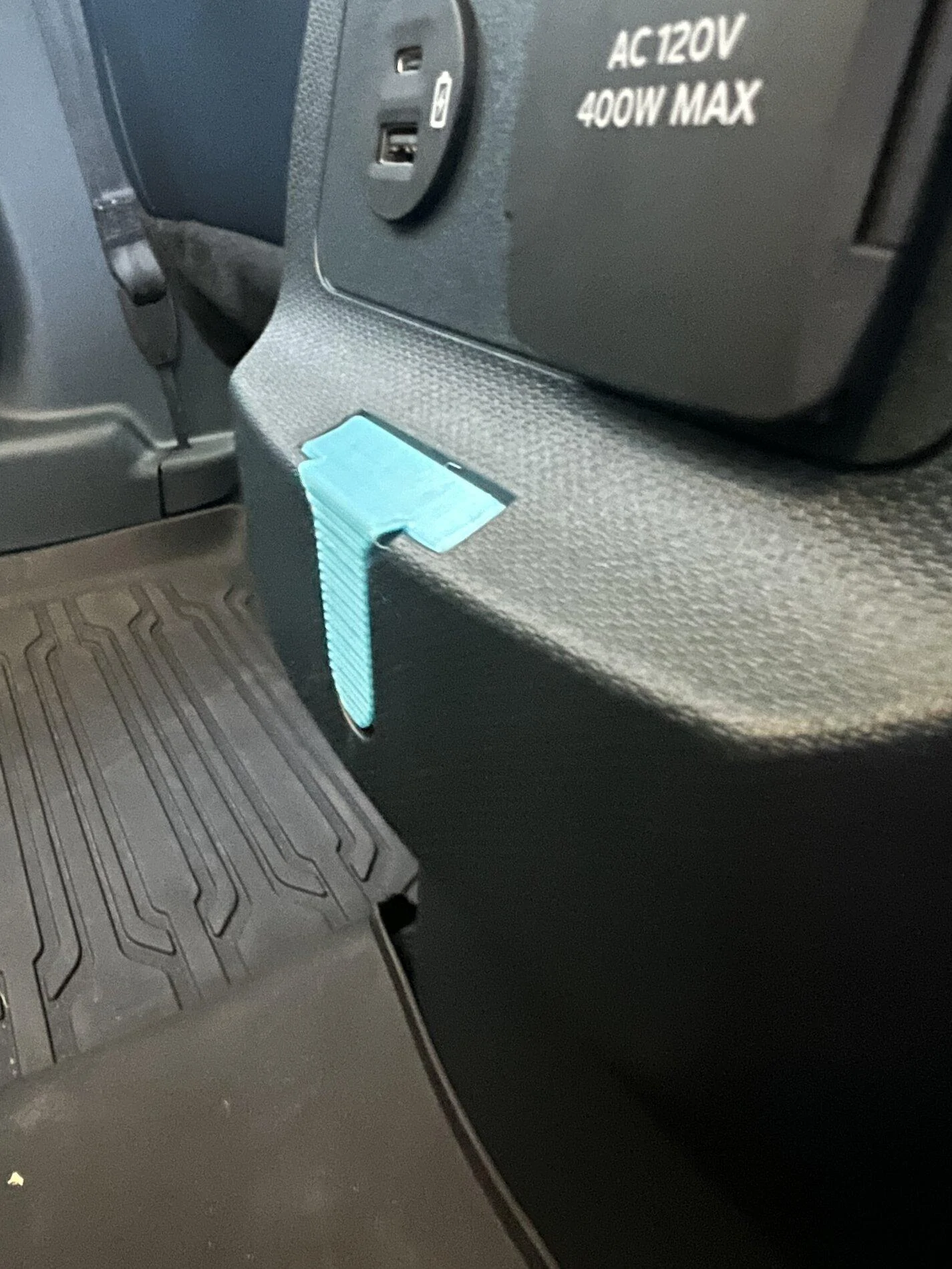

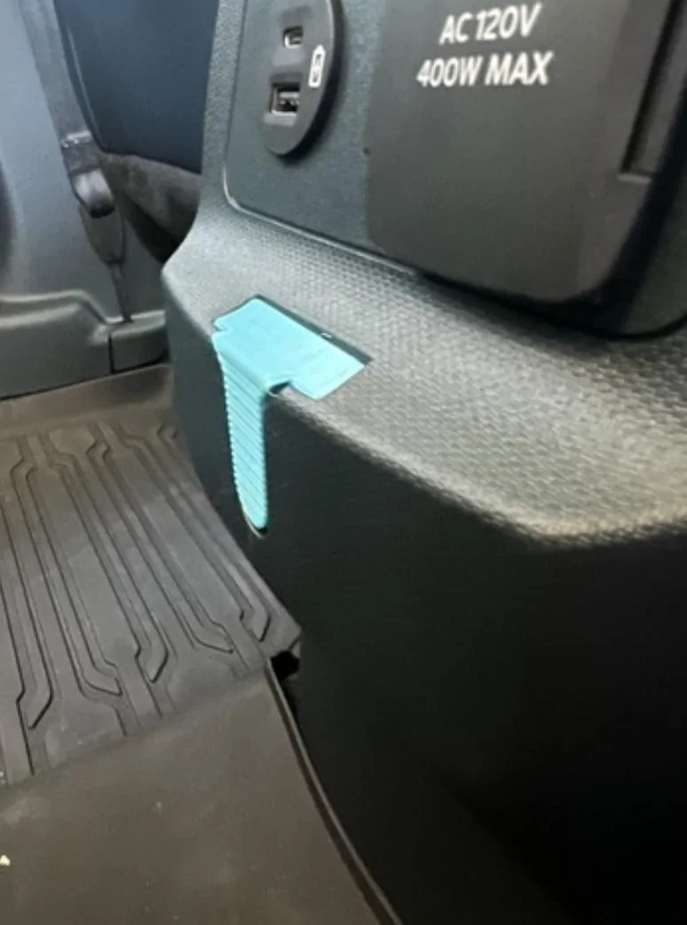

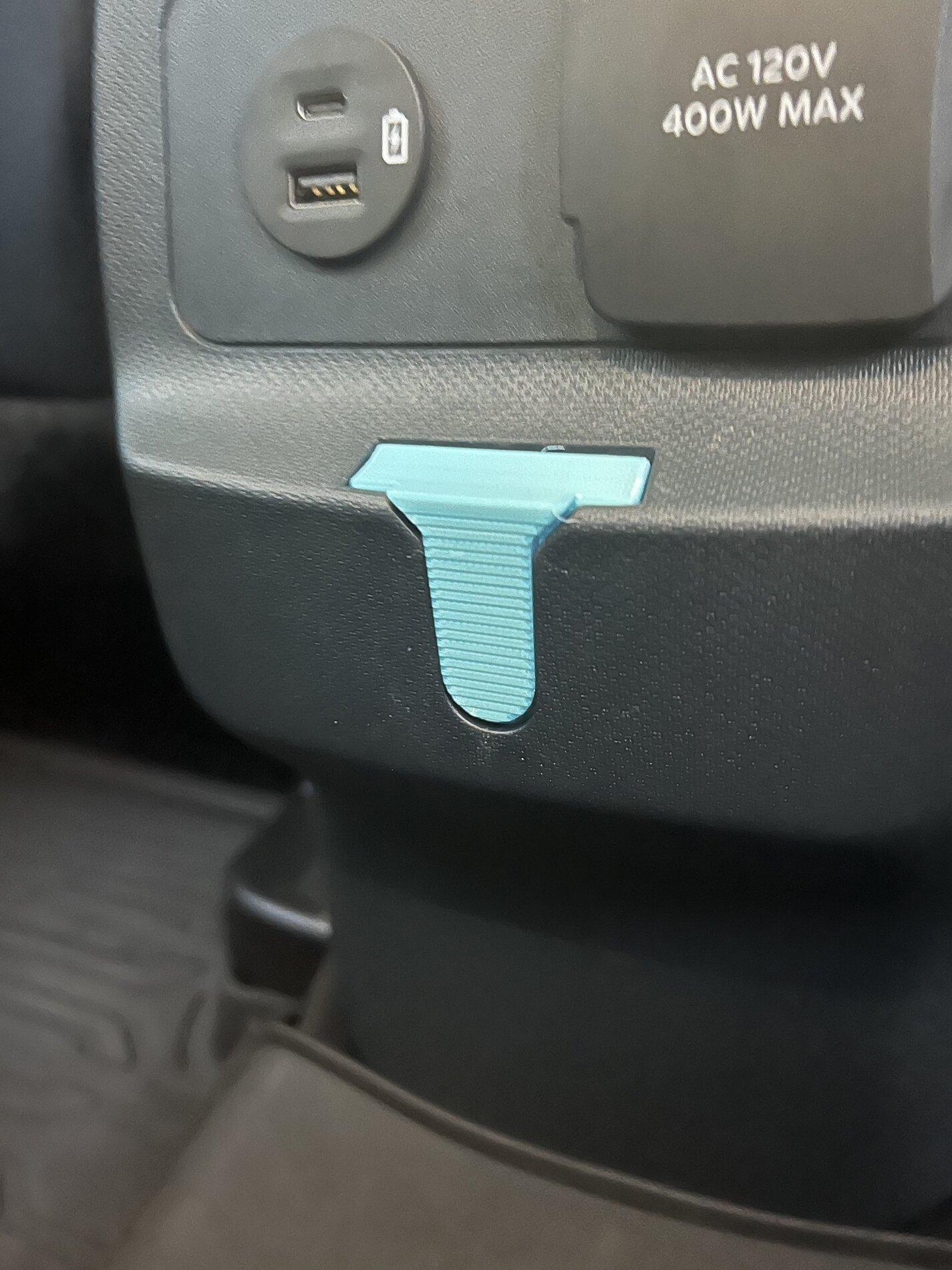

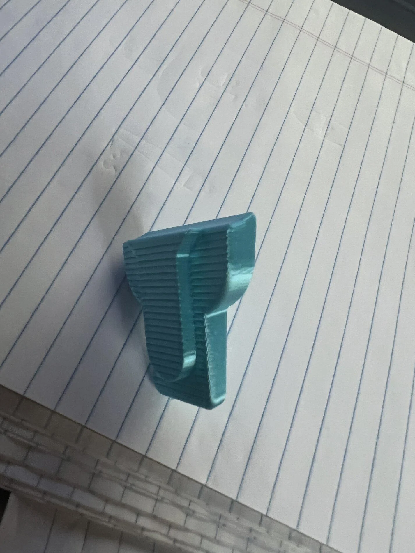

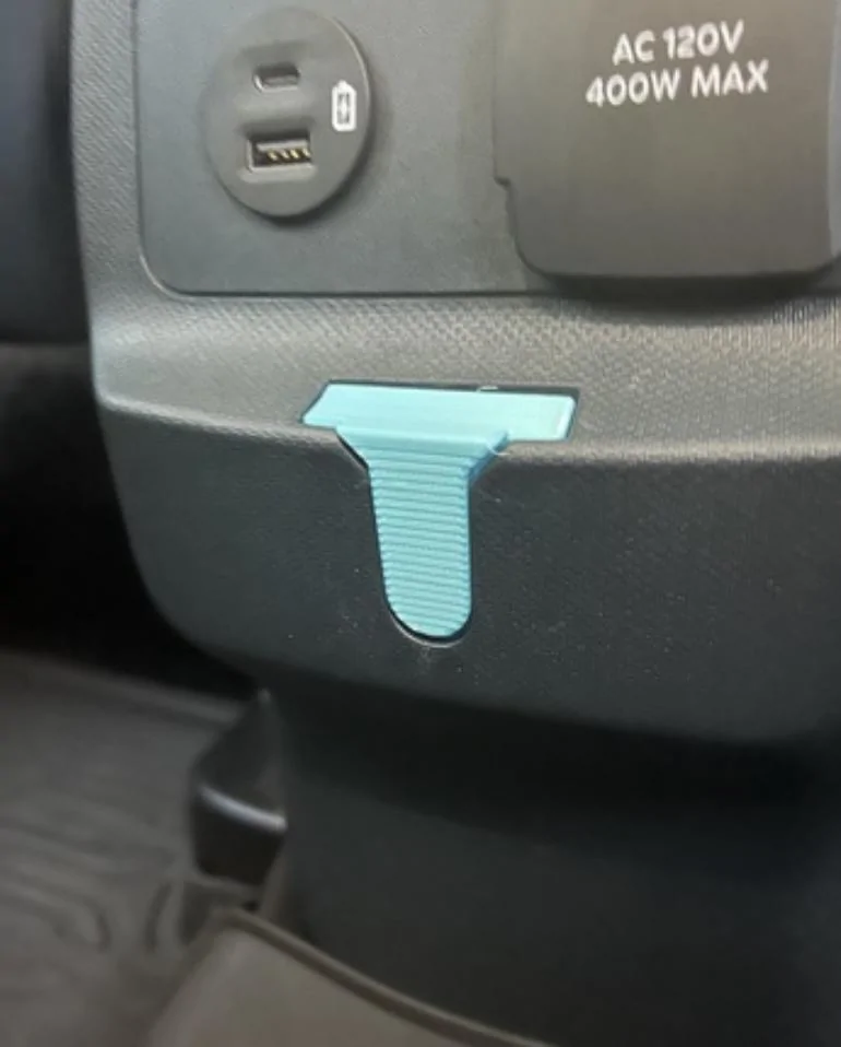

I noticed many of you are requesting the cad file for just the fits slot. I’ve seen some that don’t really work well and are poorly designed. I made one that is 95% to a perfect fit.
It’s fits snuggly into the slot behind the rear console, the other slots under the seats are a tad different surprisingly and you will need to adjust your geometry accordingly.
This is a perfect adapter if you wish to add designs on to.

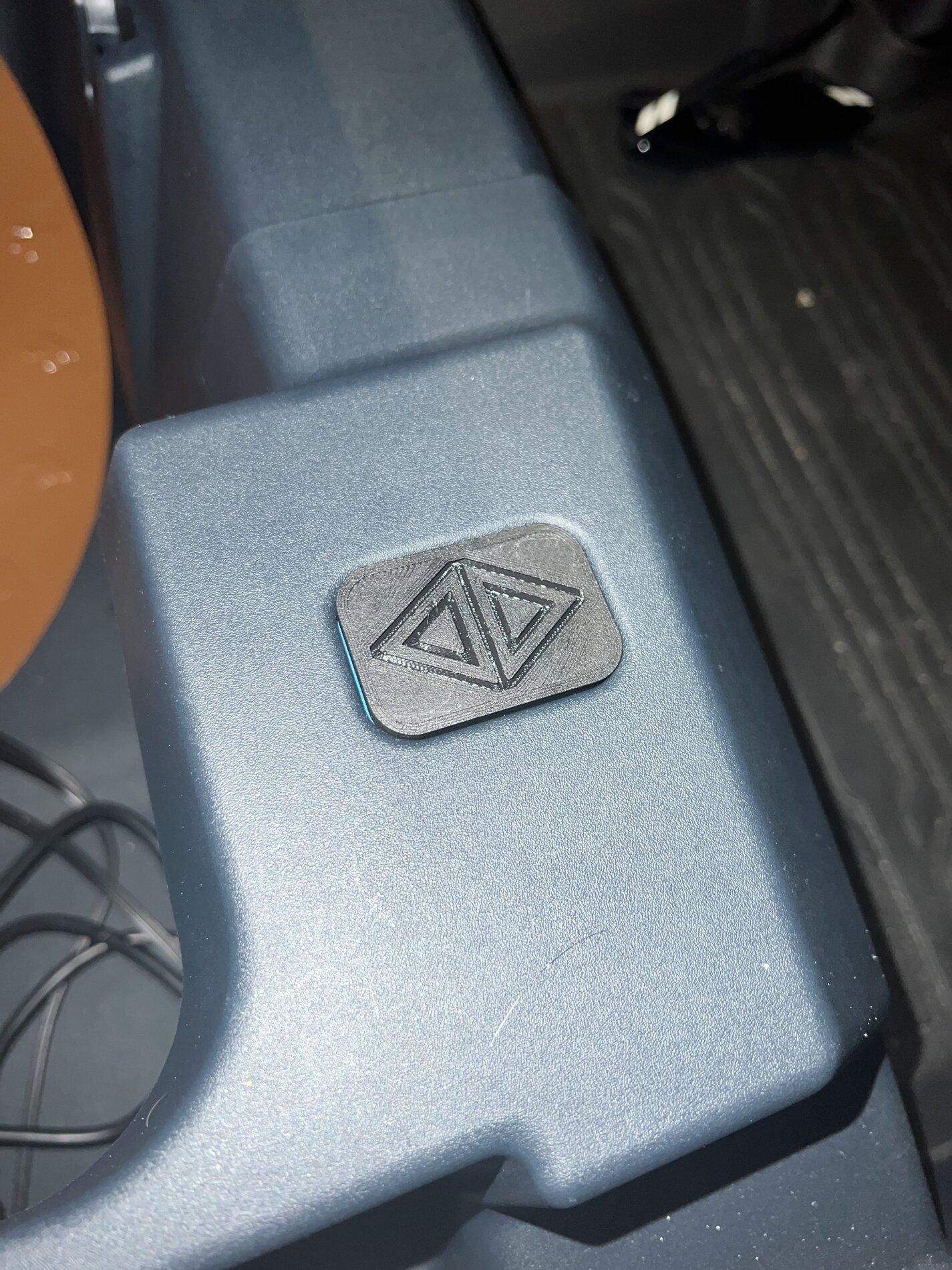

I am making a plug that sits flush with rest of the back of center console.

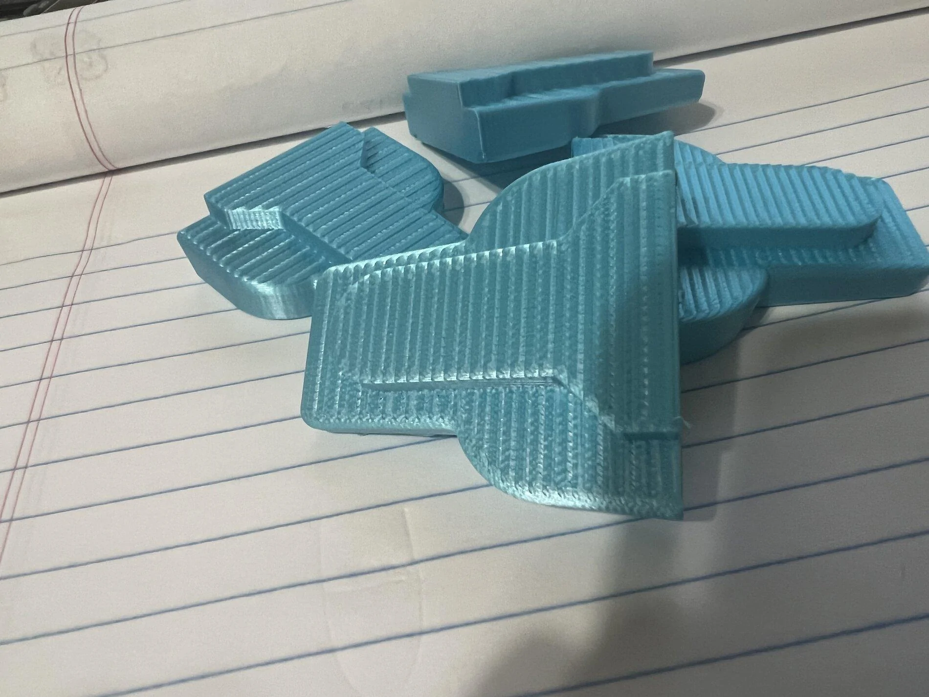

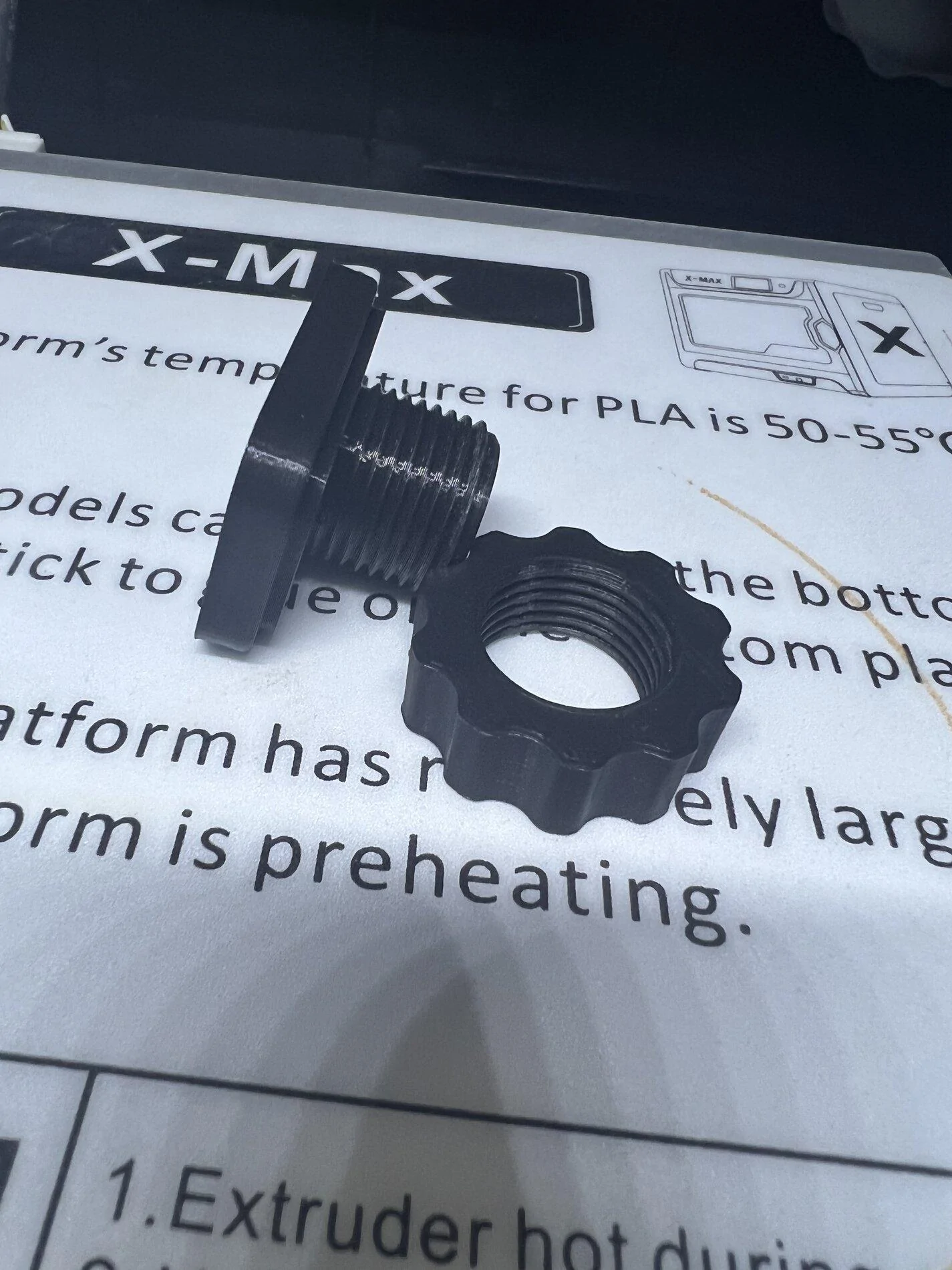

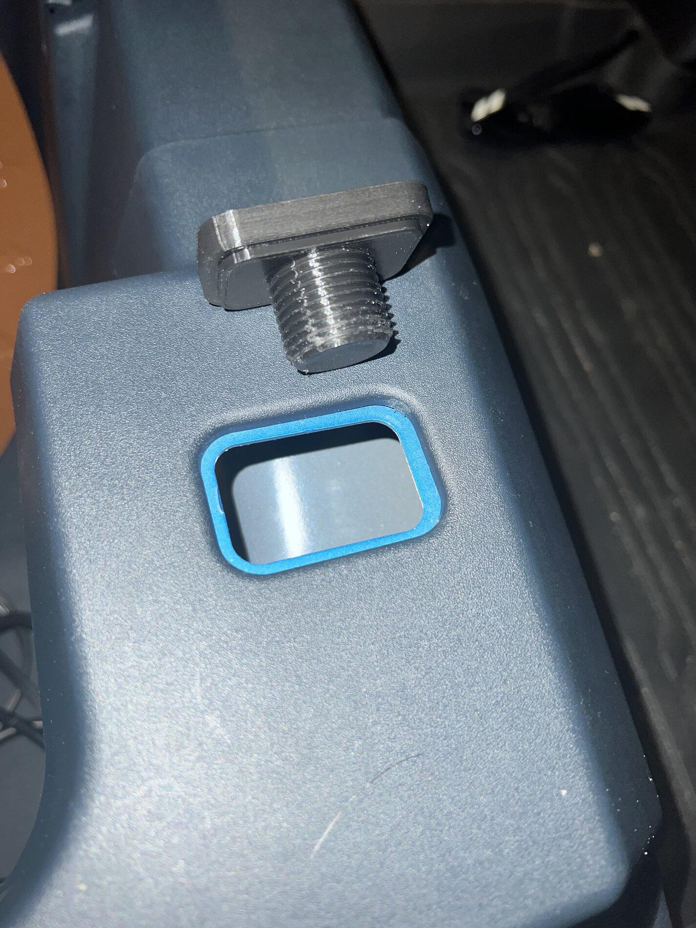

I also made some parts that secure on to the rectangular holes below the seats.
I will post more when I have time to finish them up.
NOTE: Do not use PLA if you plan on keeping parts in the truck as it will deform when it’s hot outside.
Slot for CAD work as pictured above:
Www.thingiverse.com/thing:5112826
Here is the Flush Mount Plug as seen a few posts down
www.thingiverse.com/thing:5114828

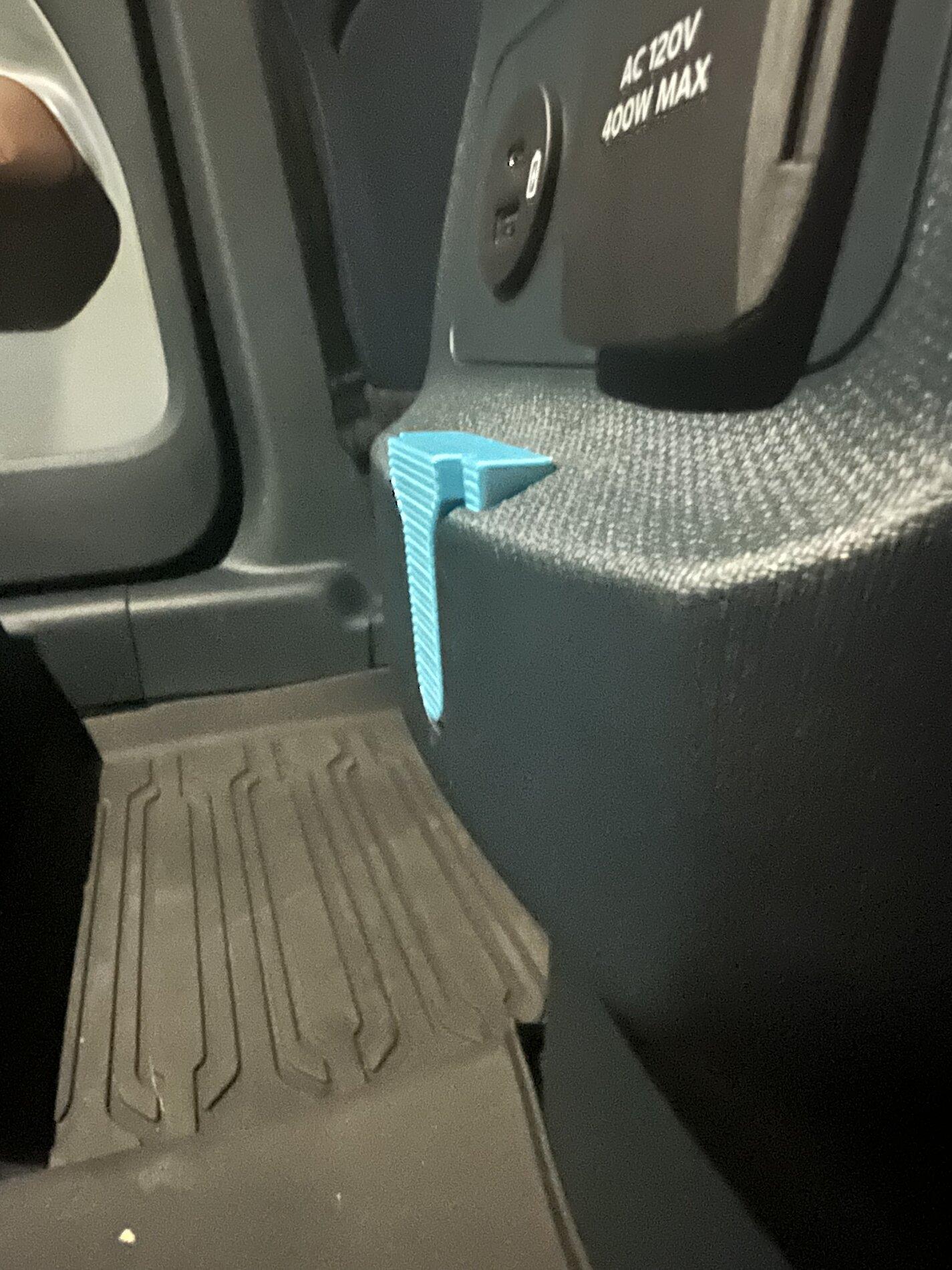

Some more pictures
Thanks. It looks like you can slip this over a plastic grocery bag and use it as a garbage bag. Awesome. It also looks like a perfect starter project to try on my local library's 3D printer (with helpful technician available.)

My intention of this piece was that you can create other parts from with some cad work. If you want a trash bag holder I suggest adding some small hooks or sliding mechanism that clamps onto the bag. It wouldn’t be ideal to just use this piece IMO you gotta get creative. I can design something for you really quick and post it and you can modify it as you see fit.

I kind of like the idea of just using that piece as a plug since the FITS slot looks a bit incomplete when it's empty.
Print it in XLT orange ;)
