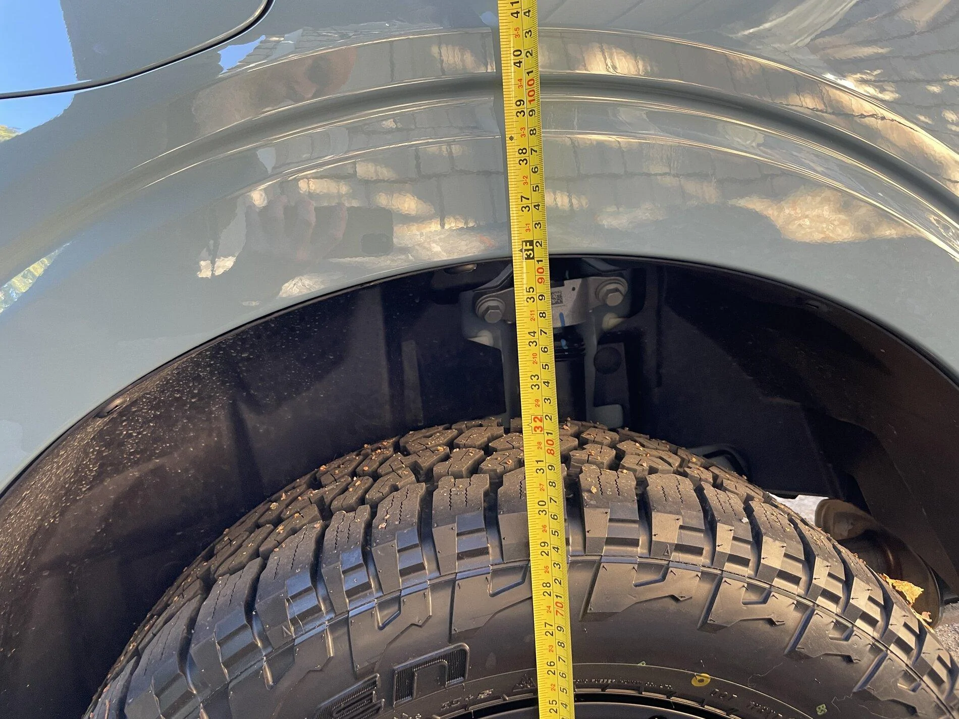

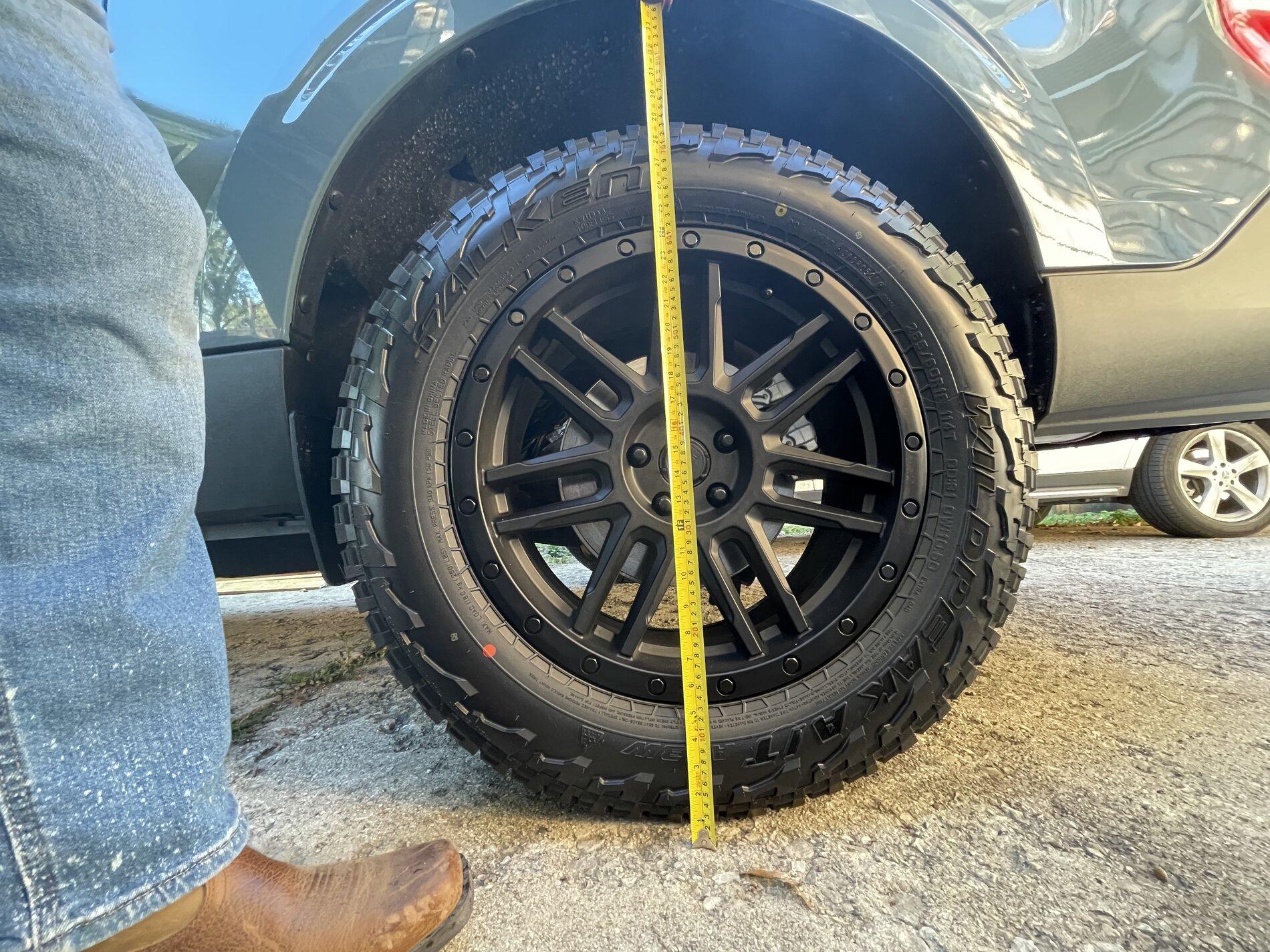

the spare is just the regular full size…doesn’t look like there would be enough room for the larger ones.
It appears to be about 29” I was guessing 31“ shouldn’t have any problem. Did you measure the width?

Would really like to know if there is any rubbing at full lock as well... According to Ford engineers on for the Bronco Sport, 30.5" is the maximum tire diameter that will fit. Of course this is still quite vague as width, offset, and tread style will all play a part in any potential rubbing. From what found on the rims, they should have a 30mm offset which isn't drastically different then stock (roughly 3/8" farther out then stock).
Not correct. Little more then 3/4” for rim only cause those wheels are 18x8. Including tires I’m sure it’s atleast an inch further out then stock.

Offset is measured out from the center of the rim. So 30mm on an 8” rim is the same as 30mm on a 7” rim in terms of tire width centerline. The rim lip will farther out on an 8” for sure but the centerline of the tire width is only about 3/8” farther out then stock offset.

Just picked this one up…still have my Rapid Red Lariat AWD on order but couldn’t resist this one…
Tires are Falken Wildpeak A/T 265/60R18
18" wheels are Black Rhino Arches in Matte Black

Nice setup. What’s the wheel specs.?

Yes offset is measured the same but a change in width will make the wheel fit different. So yes the offset on this wheel isn’t a big change but that combined with the width change puts the edge of the rim 20mm further out then stock or a little more then 3/4”.
