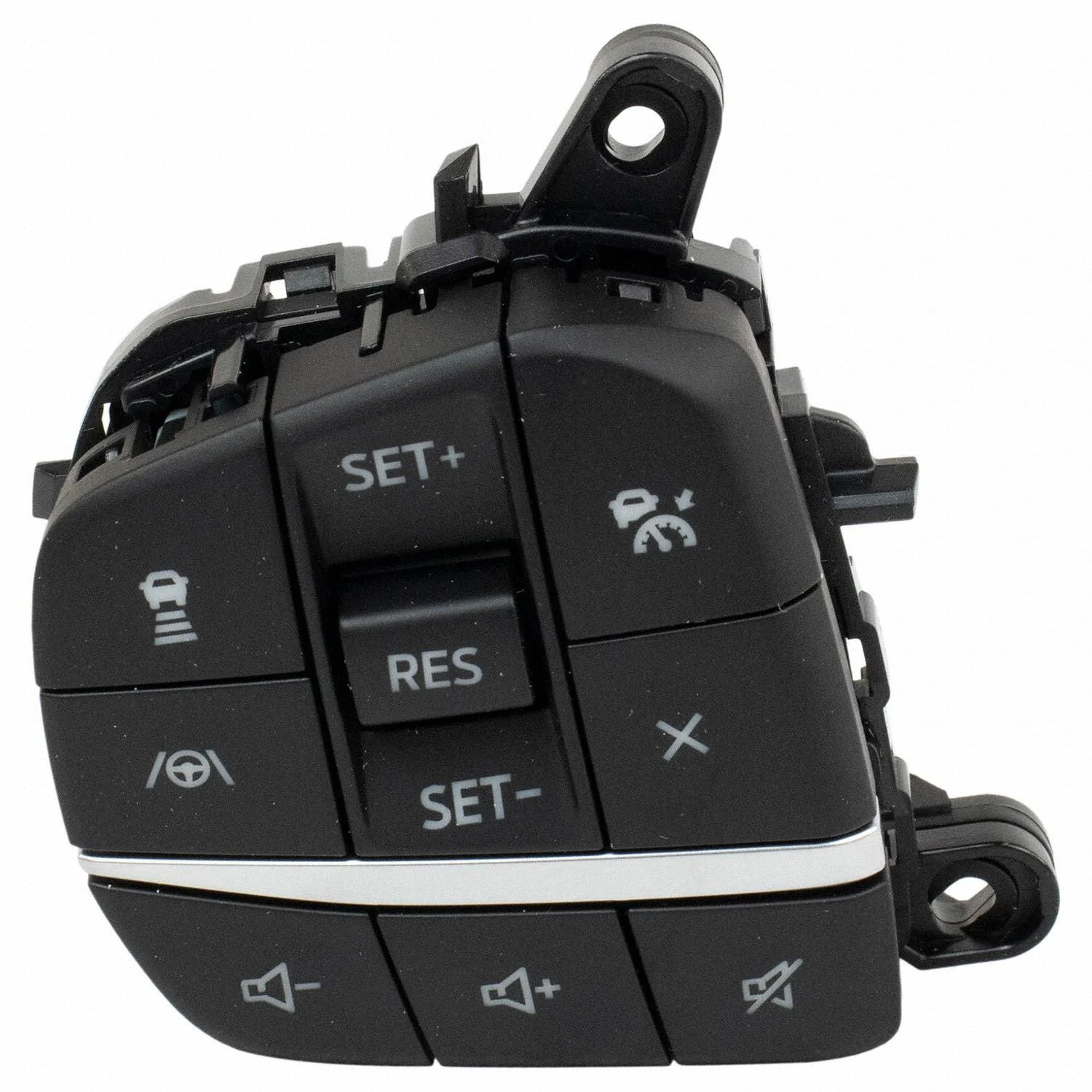

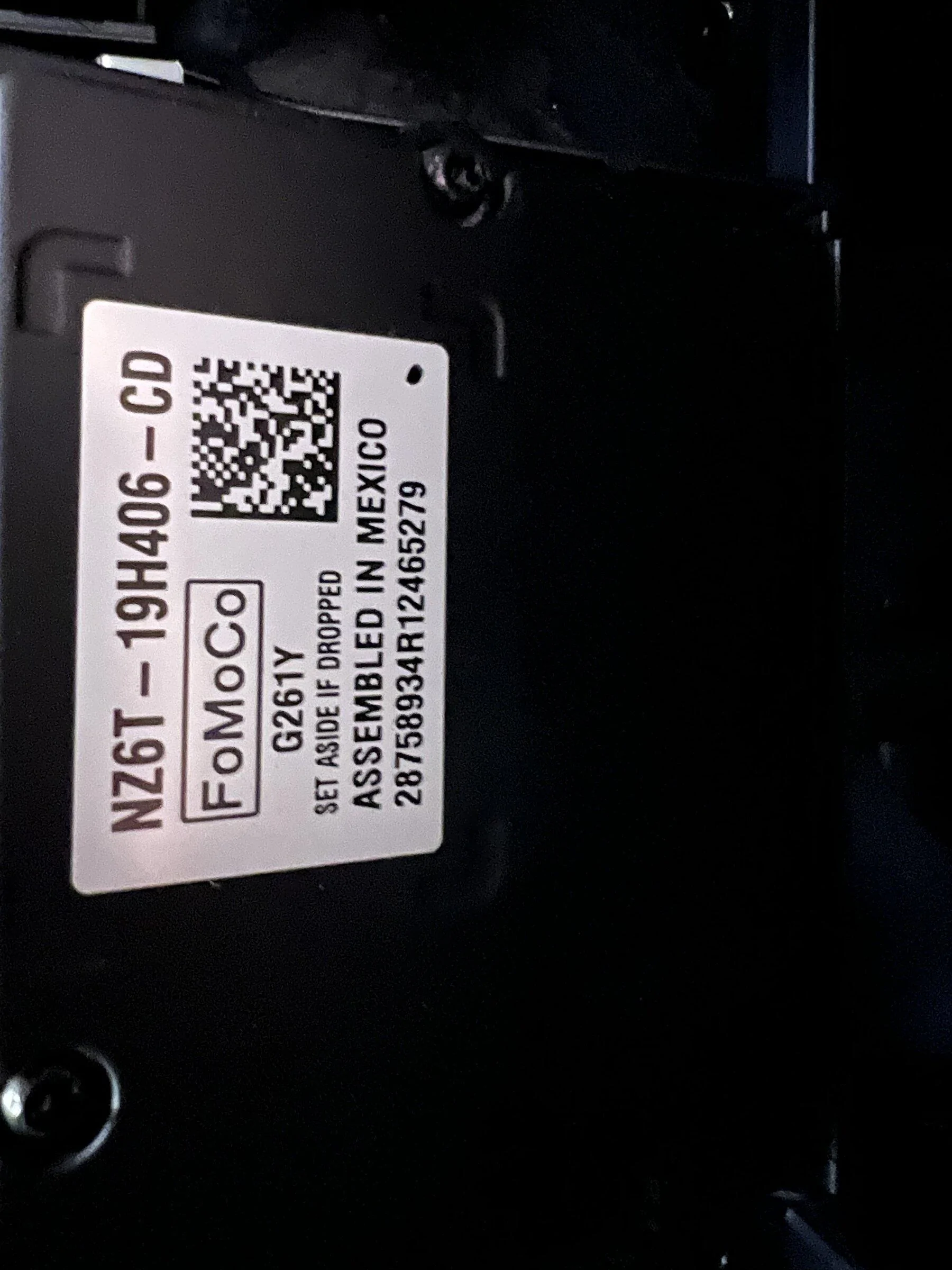

360 also gives a left stalk with the switch to activate the warning system. It might be the same switch used for ACC lane centering.Gotcha, will stick with it. So sounds like we just need someone with a Lariat Lux to pop the trim off their windshield camera and give up some part numbers?
That is only for lane assist.360 also gives a left stalk with the switch to activate the warning system. It might be the same switch used for ACC lane centering.
