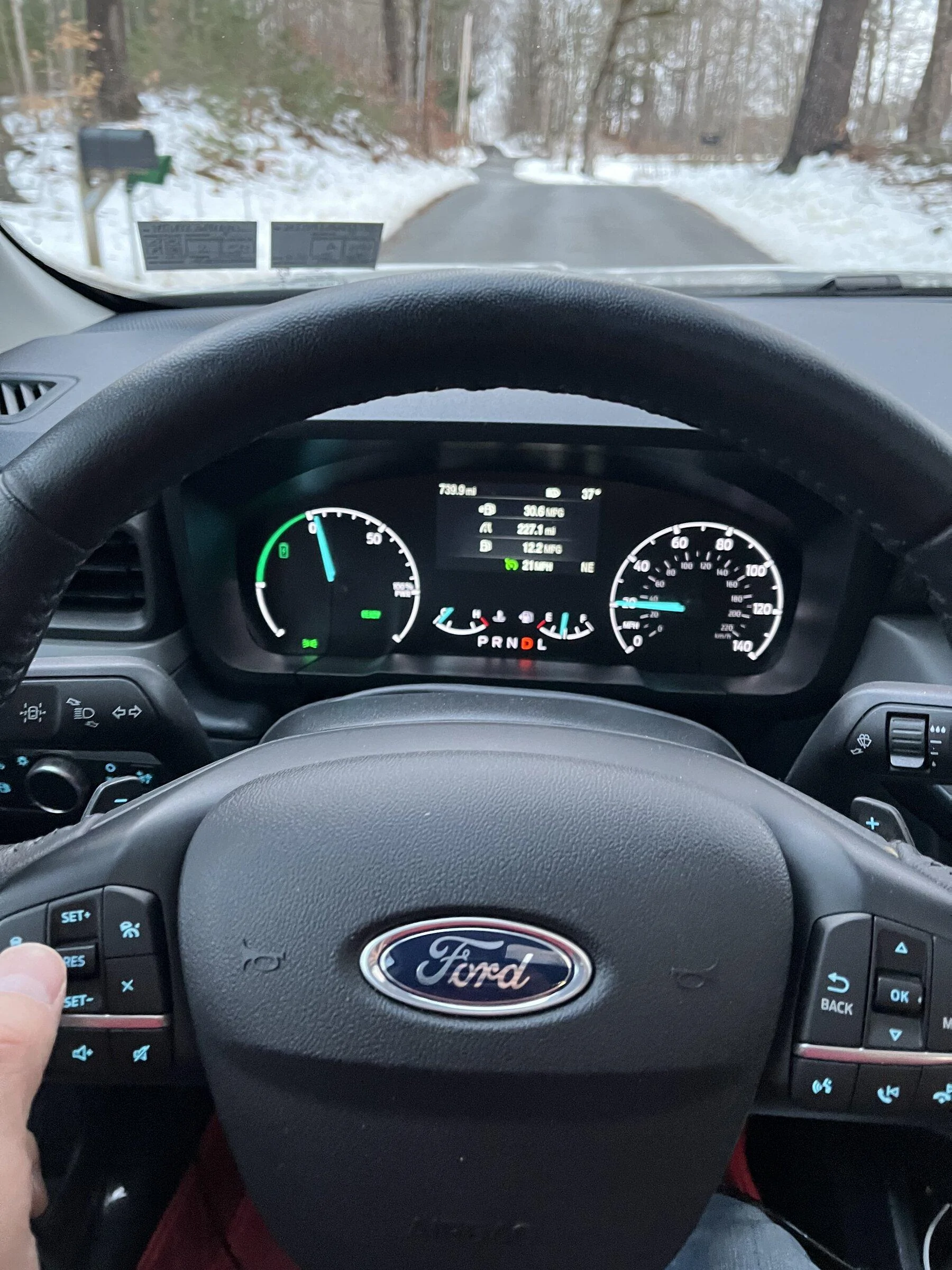

Did you use the same settings in ForeScan as the EB? Also, what did you torque the wheel nut to? I'd hate to have it loosen and have the steering wheel come off.
Check out those paddle shifters! Plan to try to get those operational?
Ahhh, yes. Did not consider it was a Hybrid! Good observation of the instrument cluster.Think hybrids only have one gear?

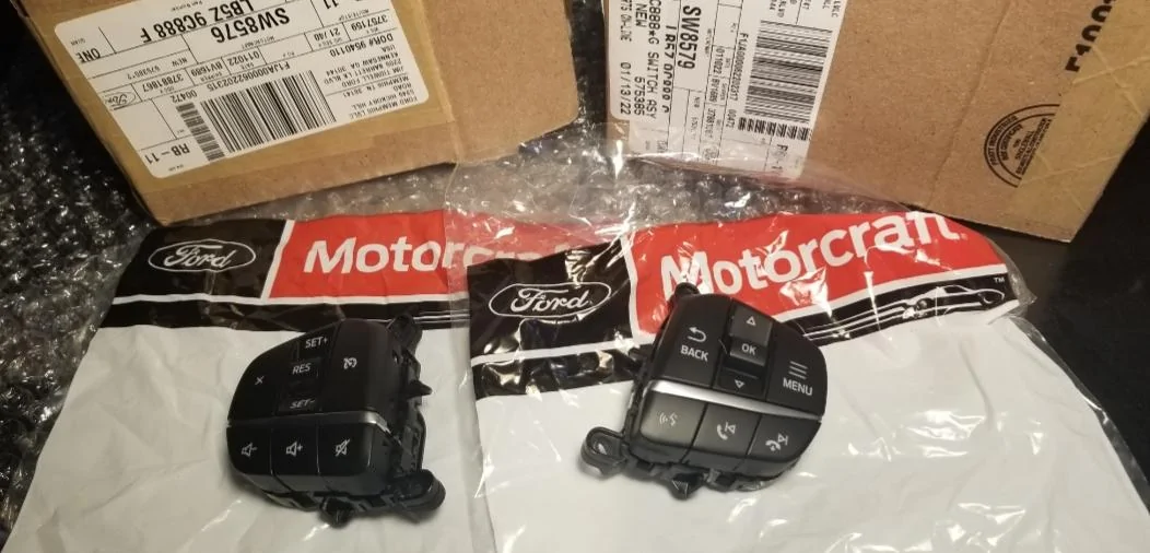

To add to this checking the owners manual starting at page 190 is the fuse box locations. if you are trying replicate the factory wiring you'll need to wire the ACC through the fuse box in the hood fuse box specifically fuse #21 which is rated for 5 amps.Looks like you'll need the following switches for adaptive cruise control besides the radar sensor.
https://parts.ford.com/shop/en/us/electrical/switches/cruise-control-switch-13094681-1
LH Switch
part# SW8585
RH Switch
Part# SW8576
The left hand switch is currently out of stock there but according to the fitment options it is the same switch used on 2020 - 2023 Explorers and Escapes so the junkyard or ebay are viable alternatives. I didn't find the sensor yet on the site but am willing to bet it is the same one used the Explorers and Escapes that use switch SW8585.

This wheel comes with all the ACC switches on it, along with paddles and heater.Looks like you'll need the following switches for adaptive cruise control besides the radar sensor.
LH Switch
part# SW8585
RH Switch
Part# SW8576
Absolutely viable if you find a similarly equiped wheel, that is only if you want keep the stock steering wheel and swap out the switches.This wheel comes with all the ACC switches on it, along with paddles and heater.
Excellent. I didn’t know it wasn’t equipped with CC. What’s next? Air conditioning as an option? Geez. How much did it run you?I have finally got Cruise working on my XL. I'm not positive that you absolutely have to have both of the IPC inputs, however, I have working cruise, so I haven't dug into it too far. If anyone wants to challenge it, feel free to post the results!
2020 Ford Escape steering wheel
SCCM
724-02-01 1258 6820 3050 clock spring
IPC Instrument panel control module
720-01-02 0227 4093
720-02-01 09E4 2D34 1E96
BCM
726-04-05 CB28 8140 8872
