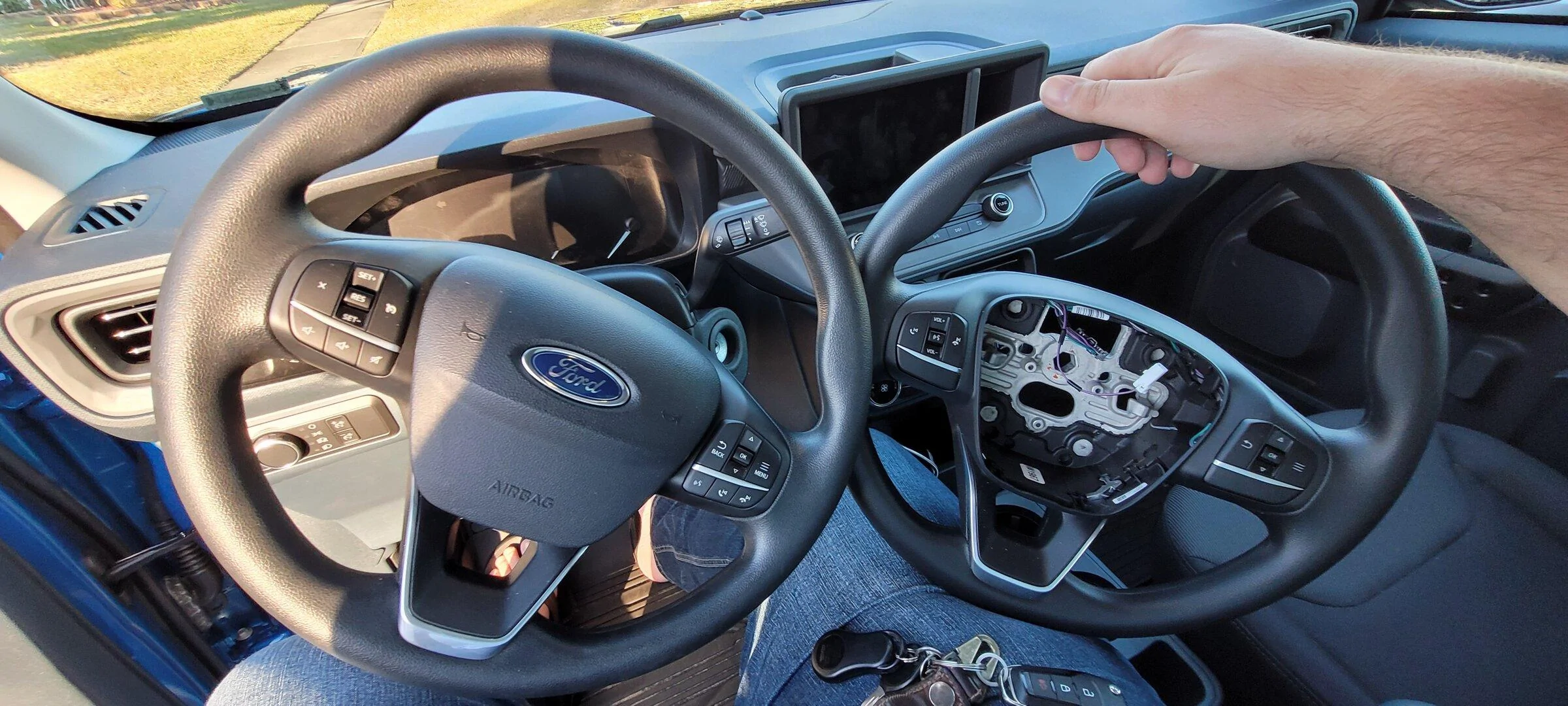

I appreciate you asking this, I forgot to take a photo showing why you need both left and right clusters!
To the left is my Cruise Control wheel, and the right is my original non-Cruise Control wheel. You can see that the clusters on both sides are distinct - if you just replace the left cluster, even if that arrangement would work with the truck's computer (I believe @Tyvemattis tested that it won't) you would lose your phone buttons and forward skip/back skip audio buttons. While you don't need a whole wheel, you will 100% need left and right clusters for your wheel.
