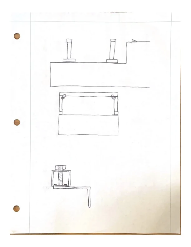

I don't have my Maverick yet, but I have been planning what I want to do for a bed cover and rack system. I want a hard folding or rollup cover, leaning toward folding for security and 100% bed access. I want to be able to transport mountain bikes using a tailgate pad, but with this short bed I can't use a cover that has a large canister in the back as the bikes wouldn't fit. I would also like to have crossbars over the bed to carry a cargo box or long items. Most of the time I would have the rack stored off of the truck and quickly install it when I need it for something specific. Given this criteria, my favorite setup out right now would be the elevate rack system. They have a height adjustable rack that slides into a T-slot on the bed rails. They also sell this T-slot adapter called the Elevate TS Rail that works with certain bed covers. However, to buy the bed cover, rail adapter, and crossbars it would cost about $2000-$2500. I think that designing my own crossbars from strut available at a hardware store would cut a lot of the cost, and is perfect since I plan on rarely using the rack.
The plan:
1. Buy the Elevate TS Rail. Post about it here, and youtube video showing how it fits with the XLT lux bed rail system here.
2. Buy tonneau cover of choice. This rack could be designed tall enough so that a folding cover can be opened fully with this rack above it.
3. Build rack according to partial plans below. I don't have my hybrid yet and will be waiting a while so I can't confidently make the dimensions. This design would be all 1 5/8" unistrut or superstrut available at about $20 for 10ft. Crossmember tying the front and rear uprights together could be added for extra stability. The 90 degree L-brackets and bolts are all available at a hardware store as well. t-slot bolts can be fastened through the feet so that they slide into the rail for quick install and removal. There would be cutting and drilling required, but no welding. What do y'all think? We could put together more detailed plans based on your feedback.
