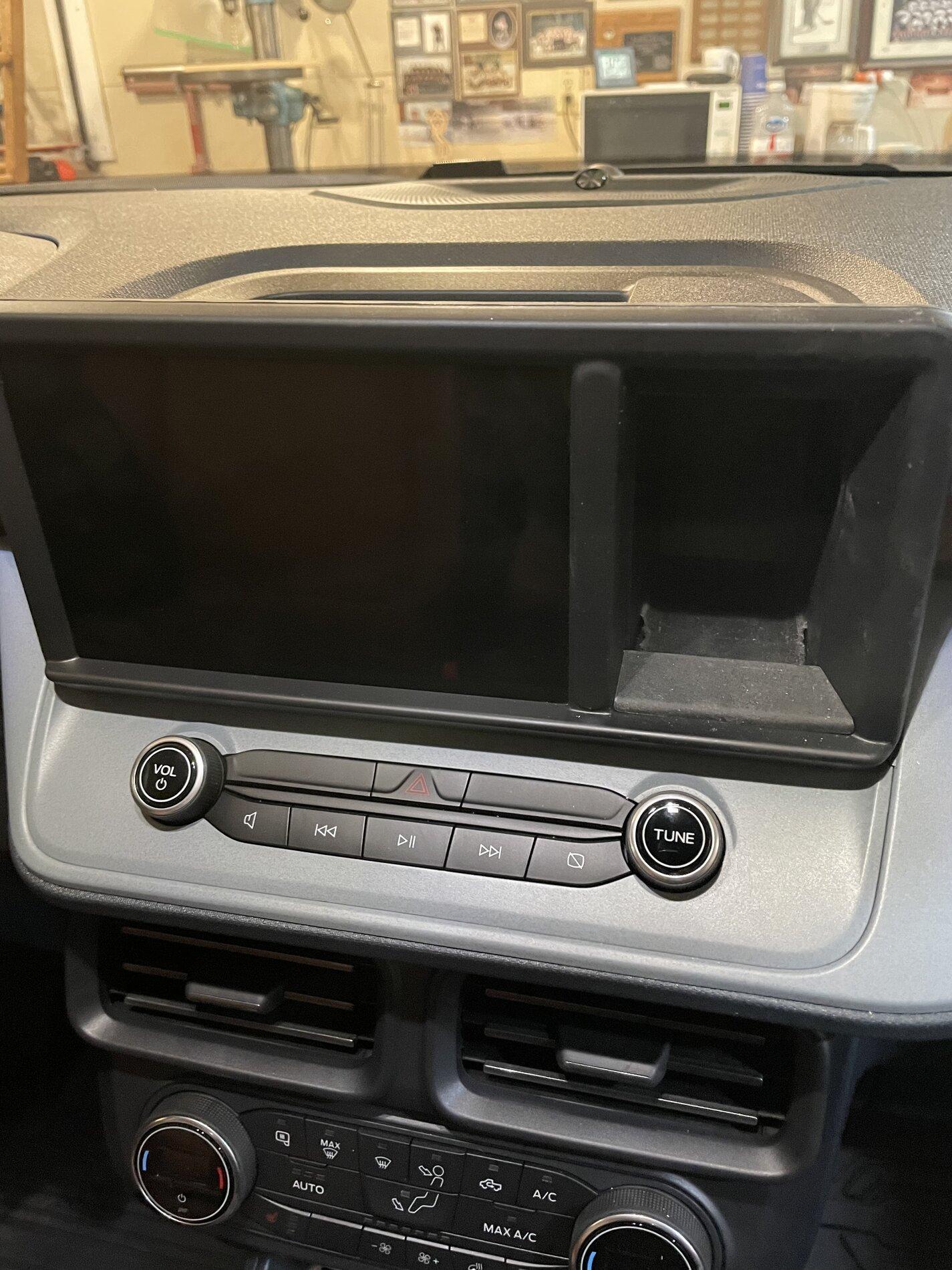

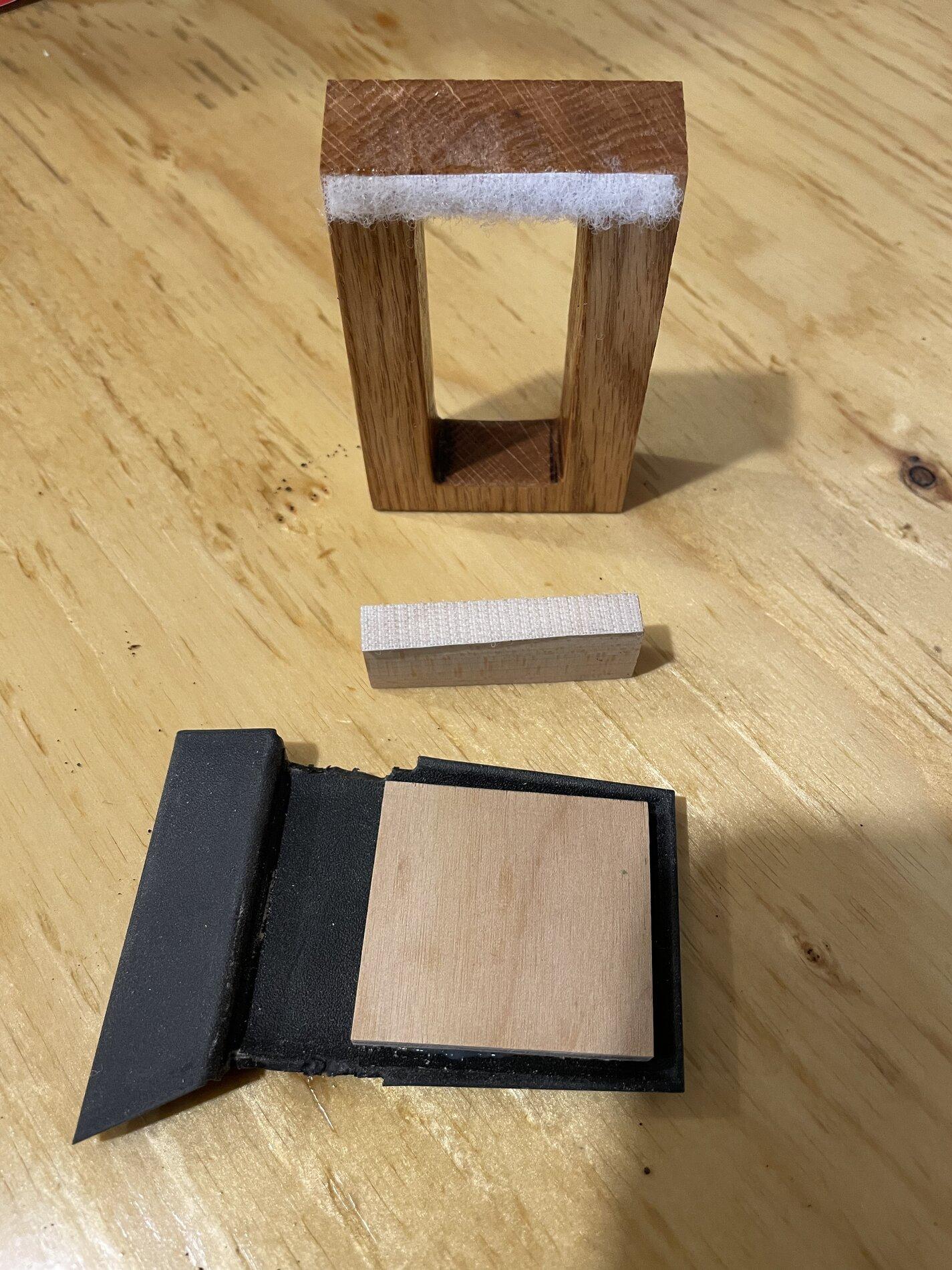

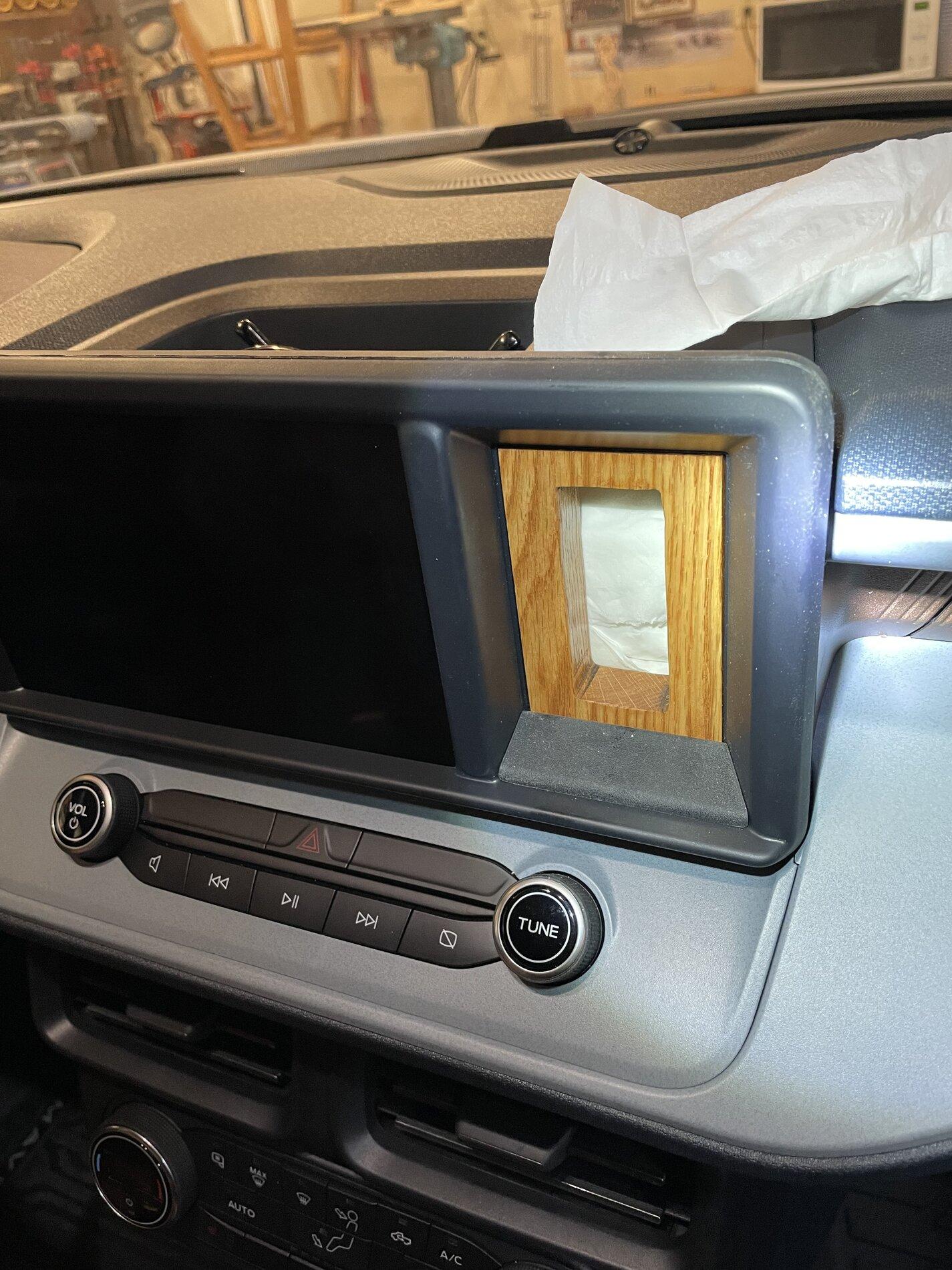

Frame is 3 7/16”x2 3/16”x3/4”. Hole in frame is 1 1/16”x 2 1/8”. It has 1/4” of velcro glued to the back on top. I siliconed a 1/8” thick piece 1 1/16 x 1 7/8” to the removable rubber piece on the bottom of the cubby to hold frame in place on the bottom. I siliconed a piece 2 1/8”x1/4”x 3/4” with velcro on it for the top frame to grab to. This holds a small pack of kleenex. Works great; coming to you from Carstairs, Alberta Canada. Hope it may work for you guys and gals!

Not sure I get where the tissues come out . At the top? or Front? either way, nice job!

I forgot to mention the frame has a 10 degree angle front to back on the top.
