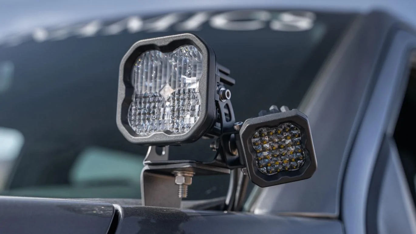

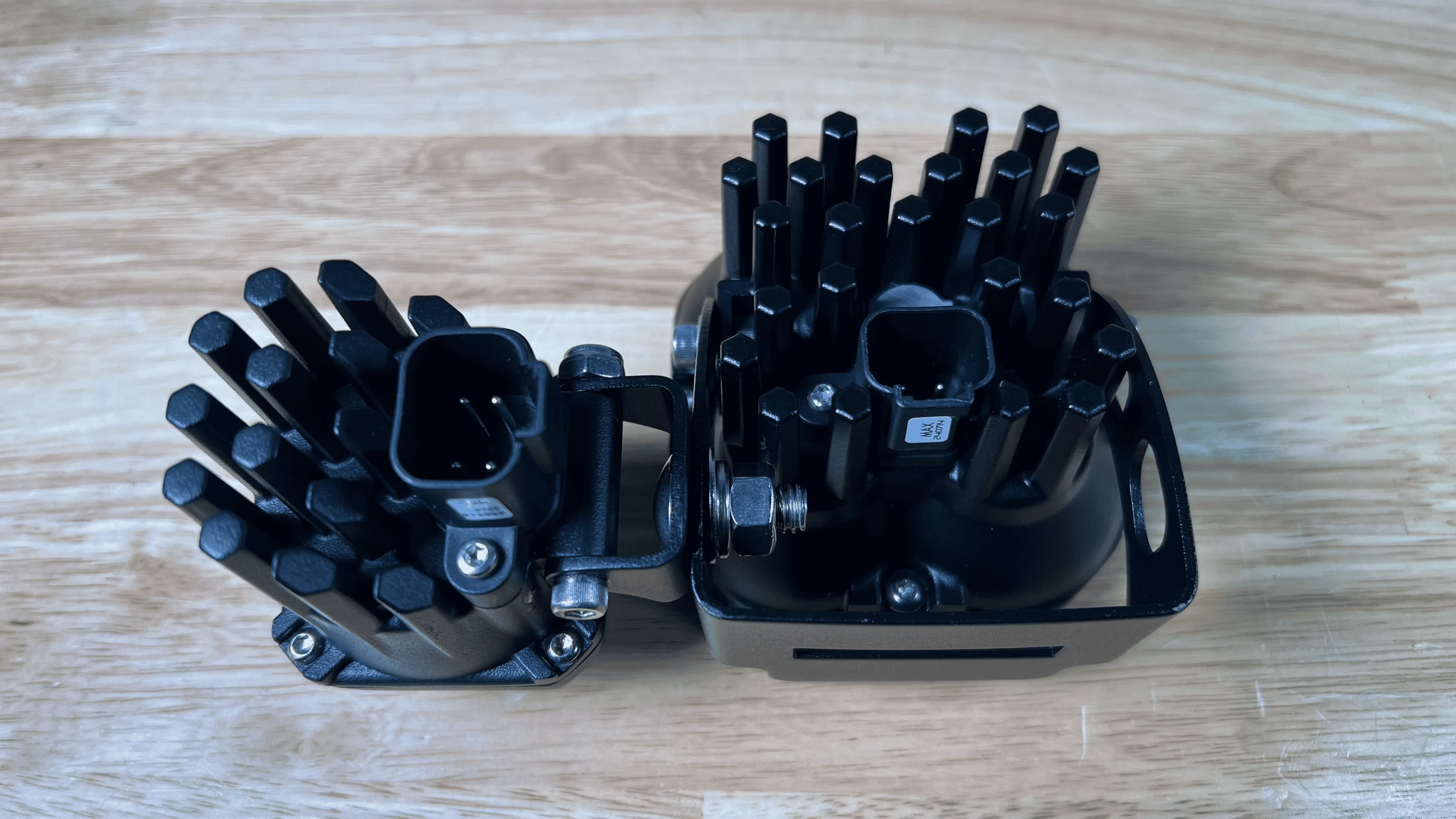

If you haven't seen it, this is one of the most popular ditch light upgrades trending online using our products!
Due to the design of our SS3 universal bracket, you can bolt our SSC1 LED pod directly to the side of the bracket for additional output.

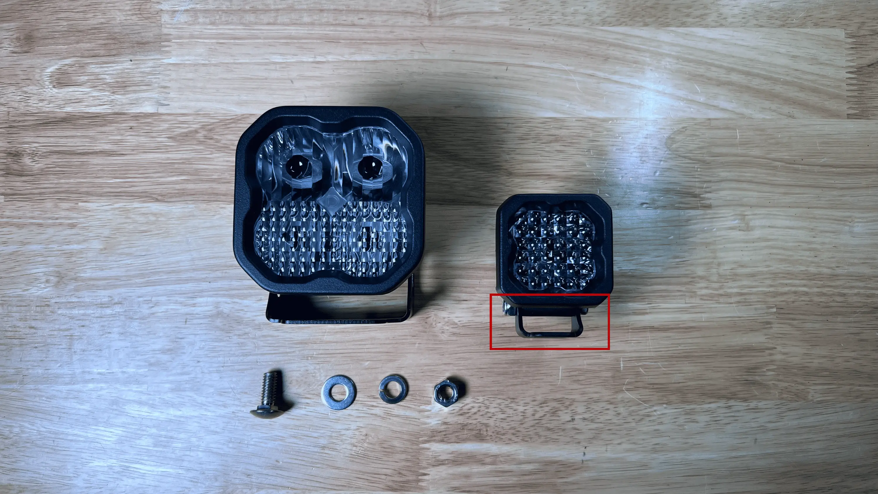

Attach Universal SSC1 U-Bracket to SSC1 LED Pod

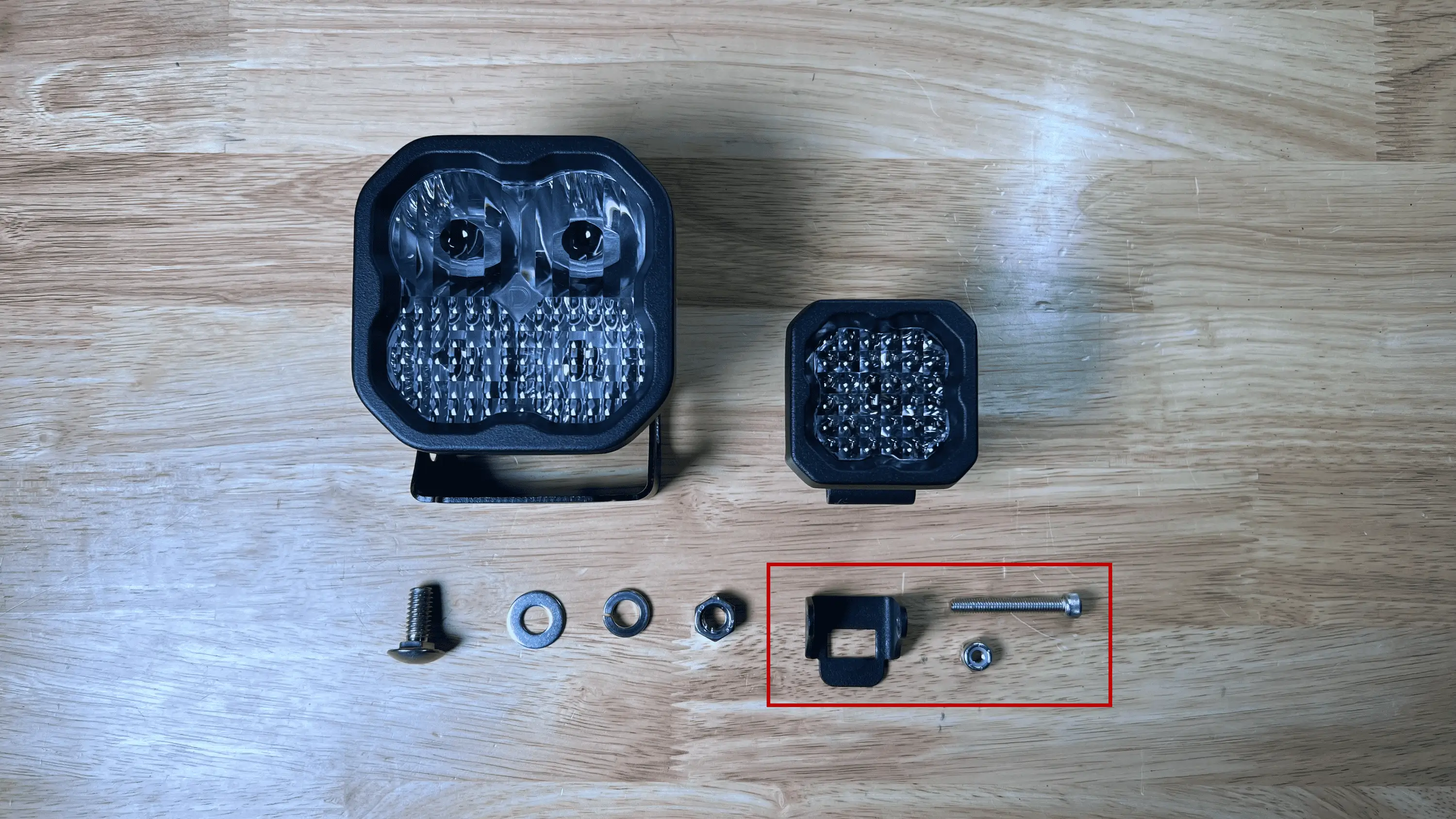

SSC1 LED Pod with U-Bracket Attached

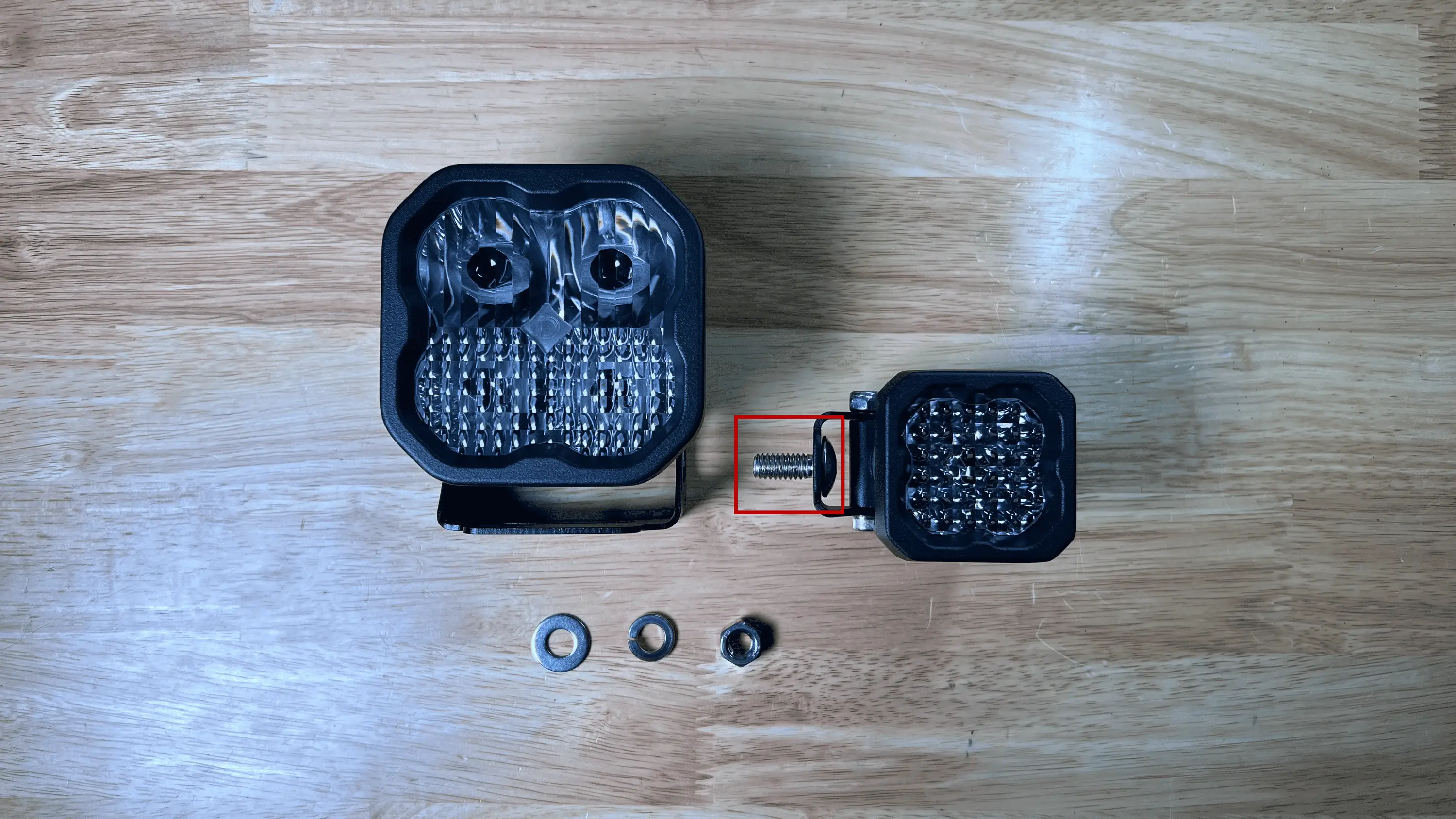

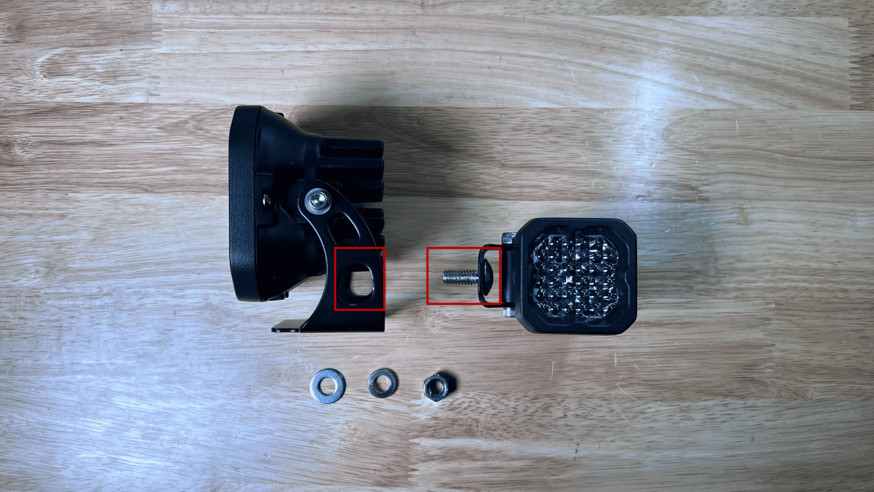

Slide the included carriage bolt through the SSC1 U-Bracket

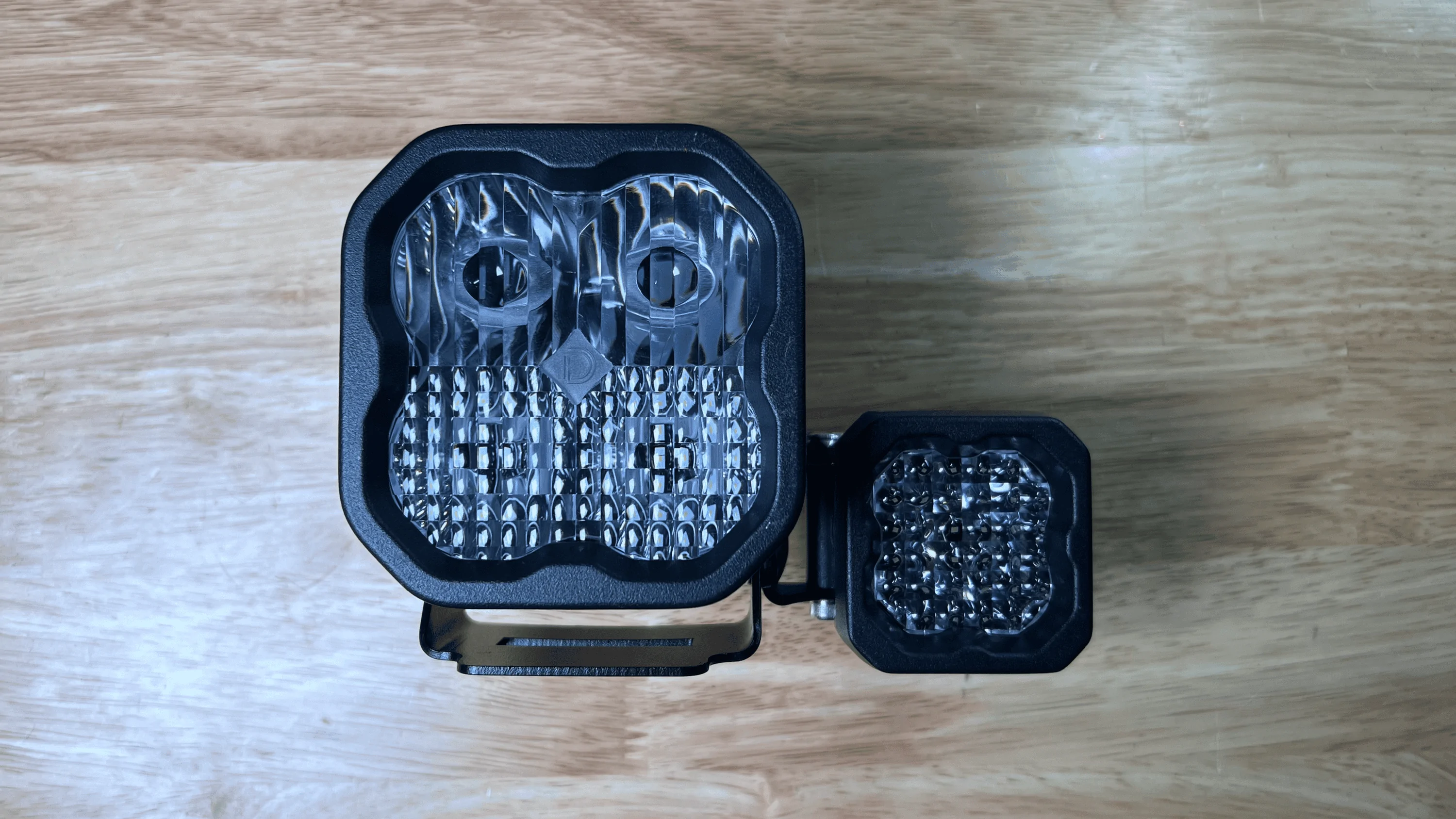

Slide the SCC1 LED Pod with carriage bolt through the side of the SS3 U-Bracket
SSC1 LED Pod with included carriage bolt through the side of our SS3 U-Bracket

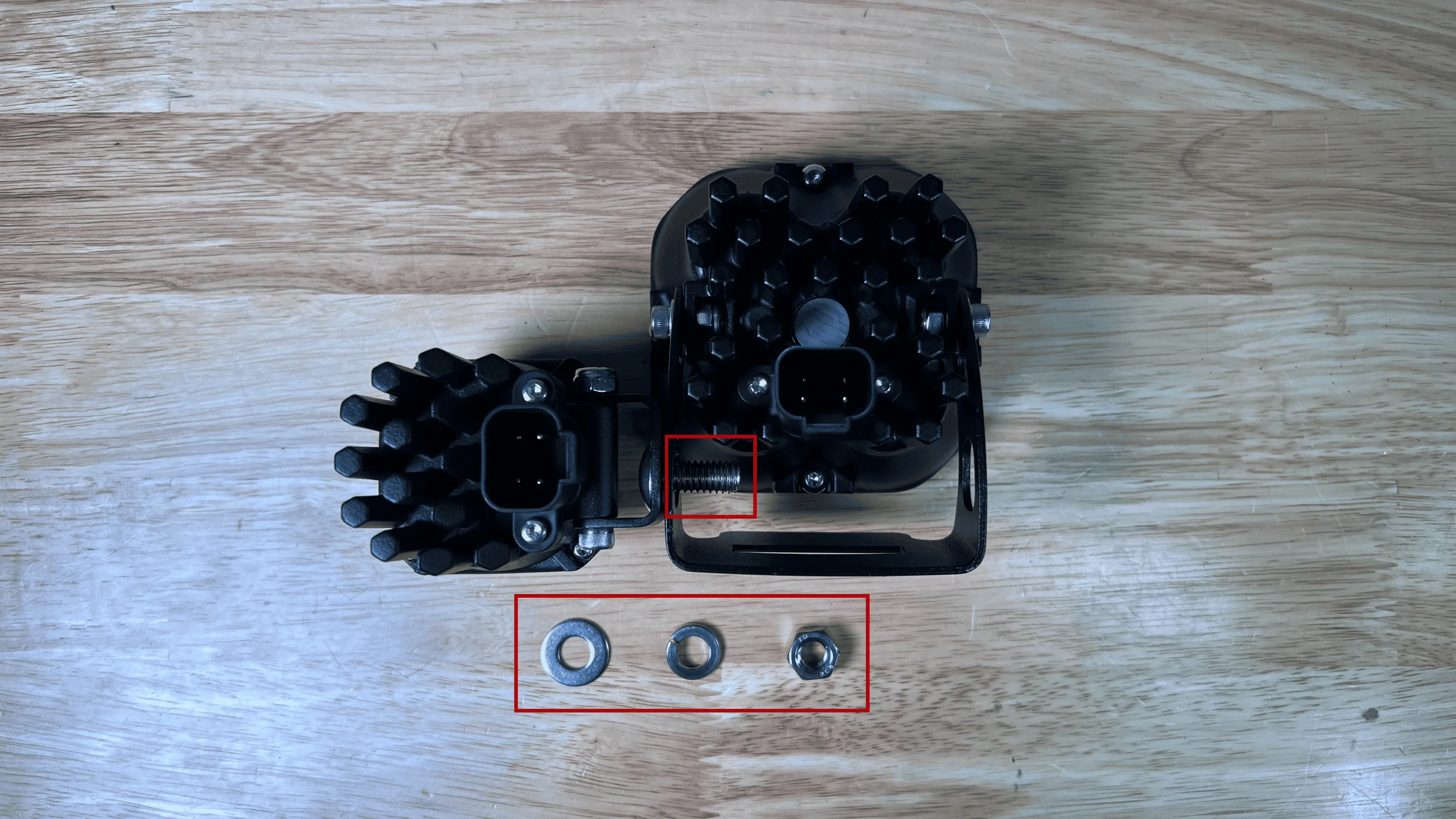

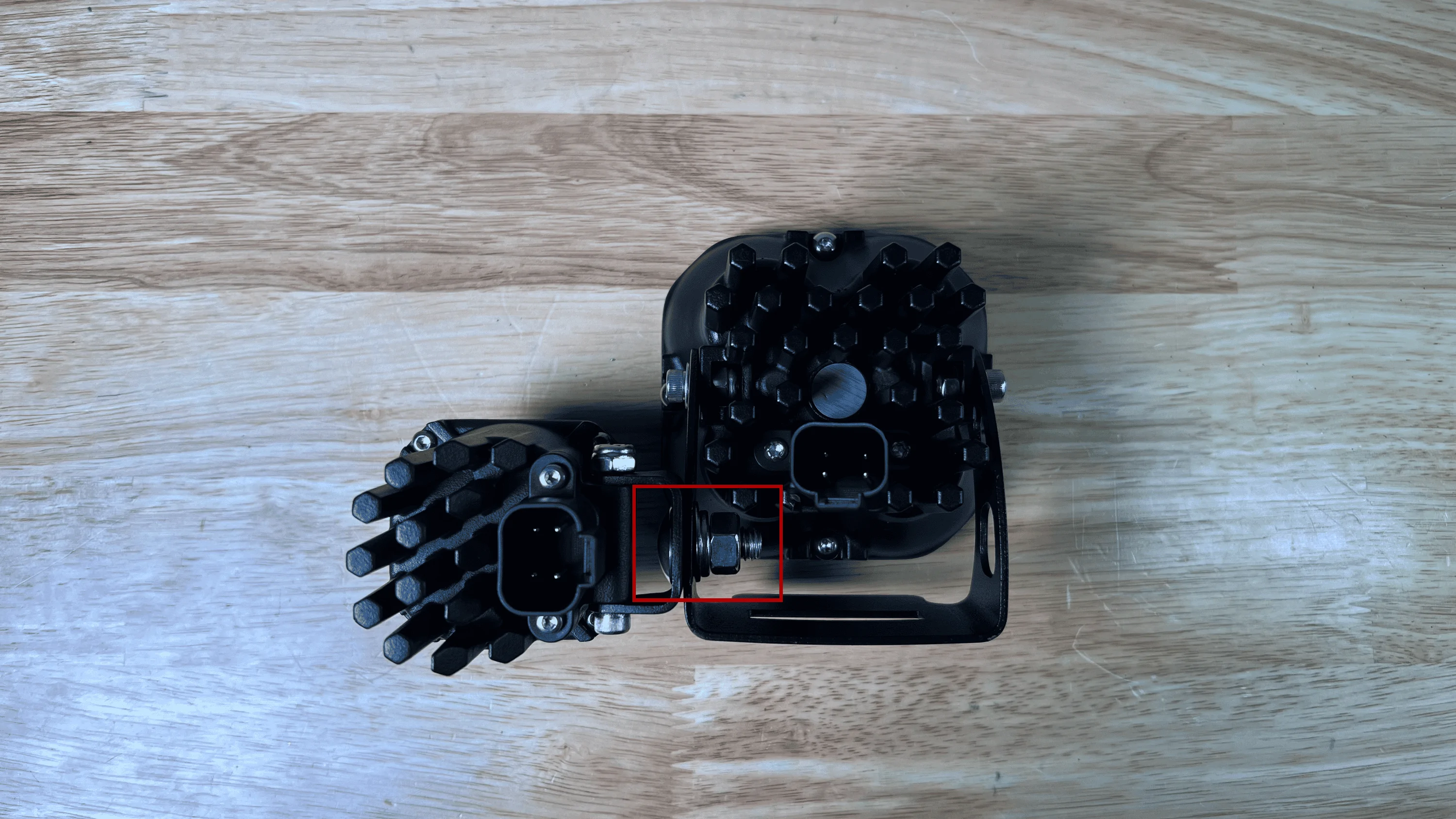

Thread on the included washer, lock washer, and nut to secure the SSC1 LED Pod to the side of our SS3 U-Bracket
SSC1 LED Pod attached to our SS3 LED Pod

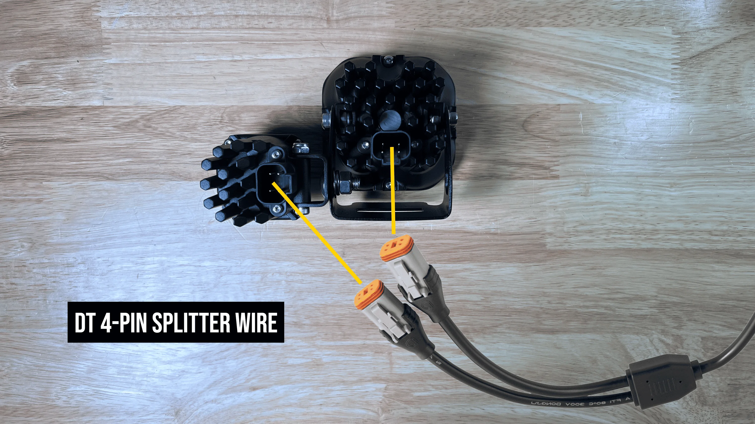

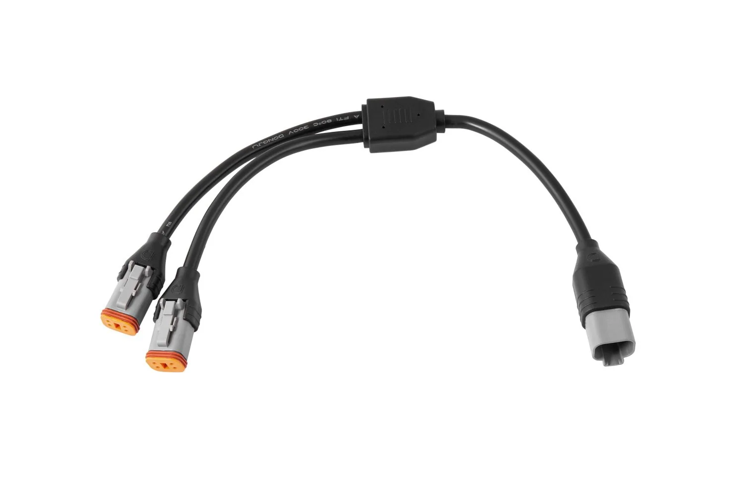

If you plan to have your SS3 and SSC1 LED pods backlight and main beam operate together, you'll need our DT 4-Pin Splitter Wire.
Click HERE to shop our 4-Pin DT Splitter Wire!

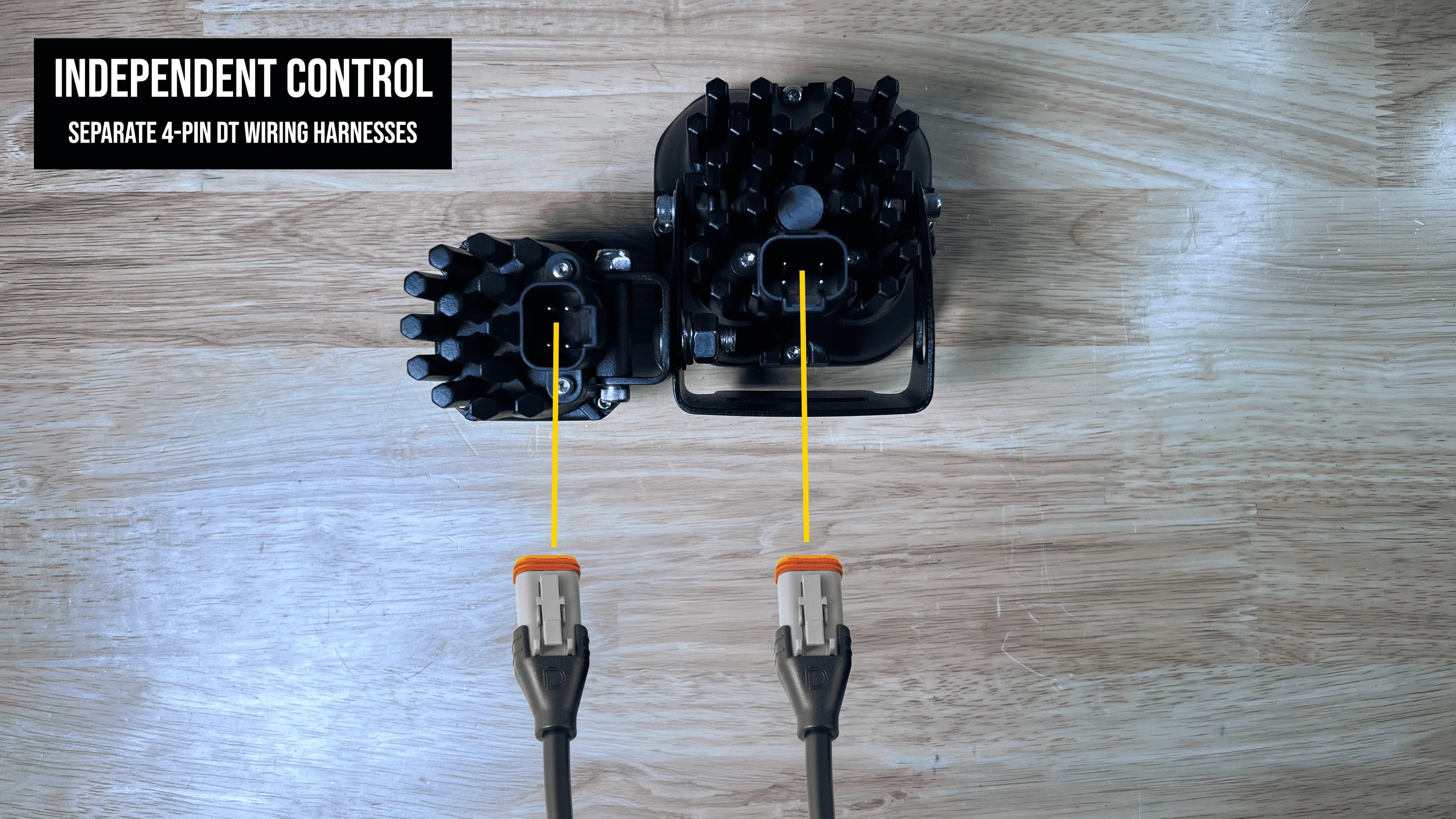

If you prefer to have independent control over your SS3 and SSC1 LED pods, you'll need to wire them using separate 4-Pin Wiring Harnesses.
Click HERE to shop 4-Pin DT Wiring Harnesses!

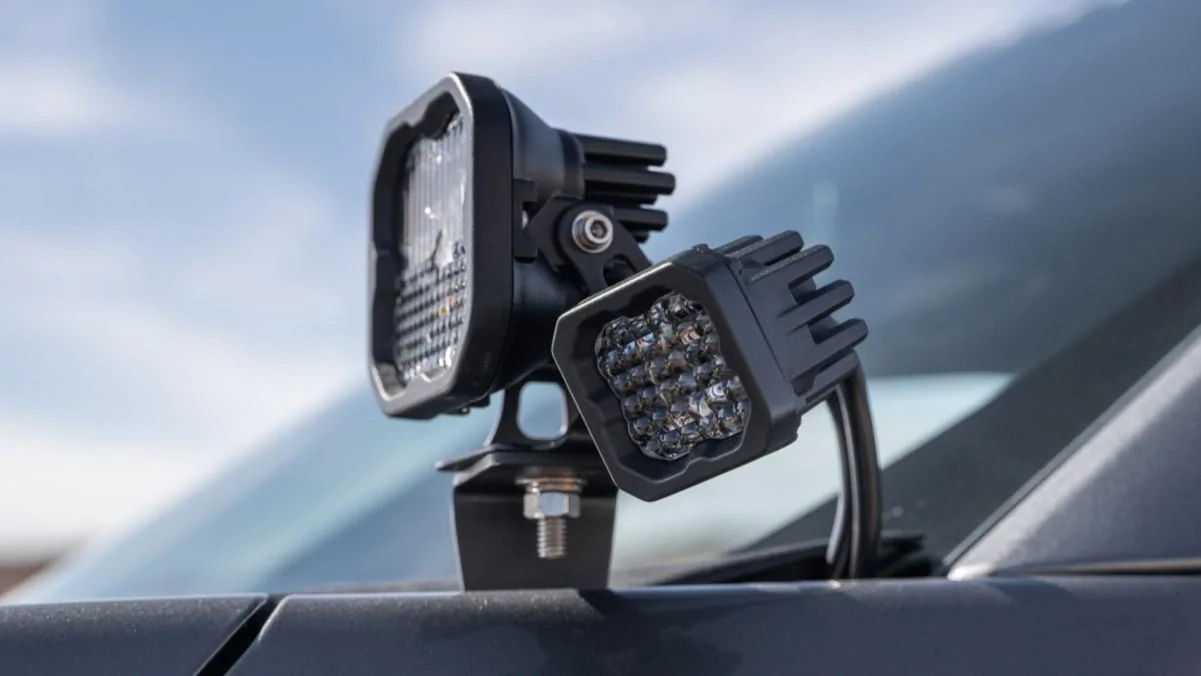

SS3 + SSC1 Ditch Light
