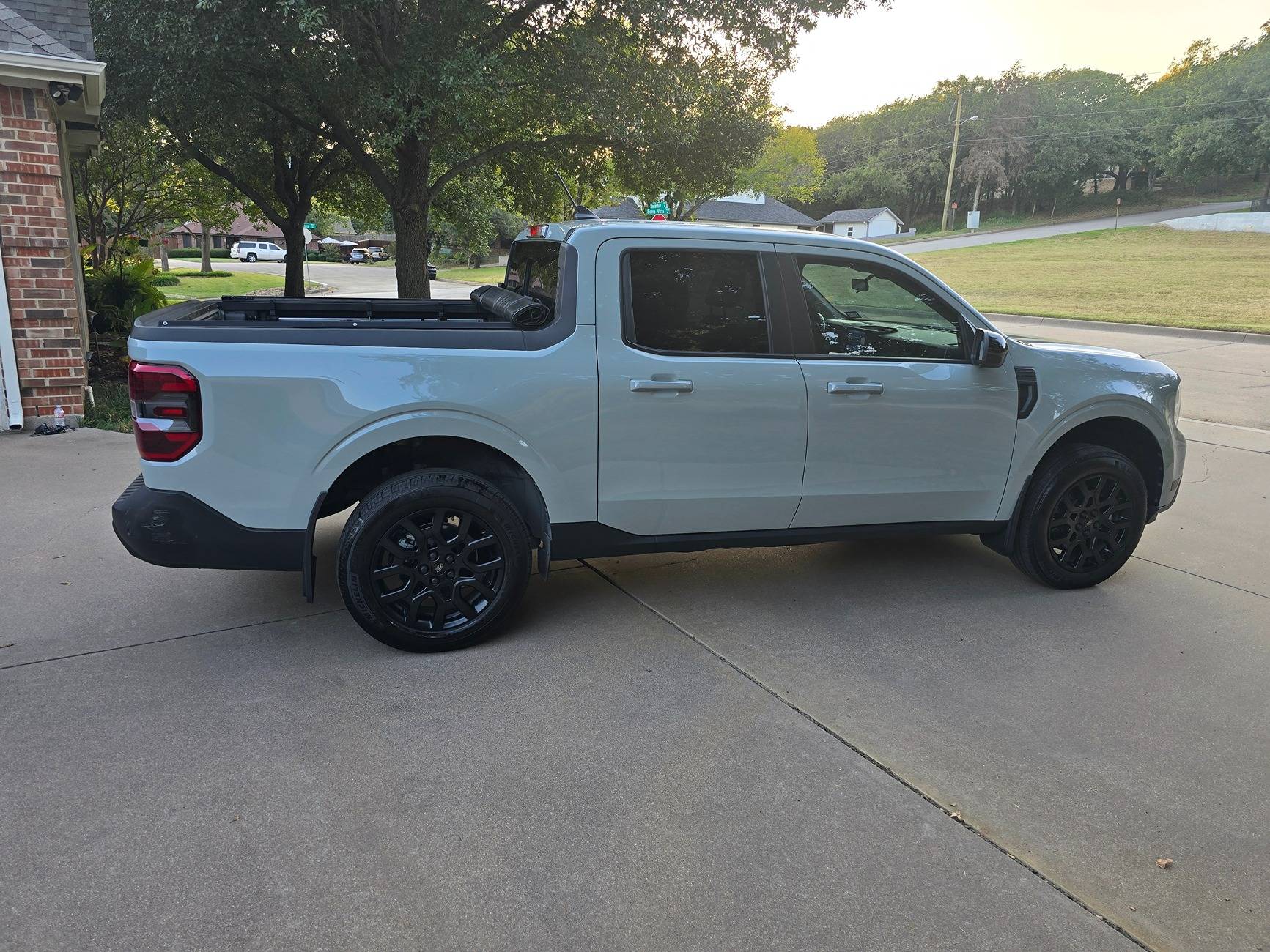

I had a 24 Hybrid Lariat with the 1" Rough Country Level. No issues over 11 months, and it looked level with the rear. I have a 25 now and putting the same kit on it.
Pic of 24 below for reference.
