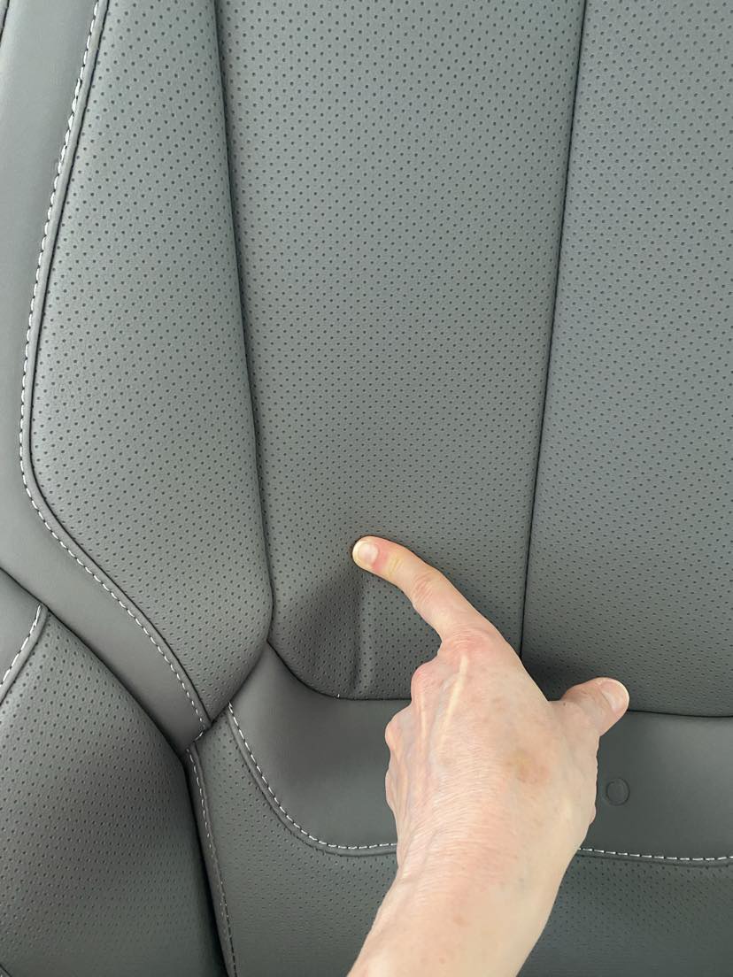

I bought the same Coverado covers as I've seen on a couple of threads. There's an obvious gap between the seat and the cover and it makes noise. If it wrinkles by pressing on it for a few seconds, it's going to get ugly fast. Does anyone else have Coverado covers and if so, can you tell me if yours fit snugly or have this issue too.
Side note: These were my birthday gift to myself and was soooo bummed out.
Ford Maverick Coverado Covers- Is this Normal? coverado

Definitely an air gap. Not sure if this can be fixed. Maybe with time as the seat cover is broken in?

I'm not familiar with Coverado covers but are there any straps at the bottom of the upper cover? In some styles of seat covers there are a couple straps which must be fed between the seat bottom and back, then snugged tight to ensure the cover sits properly.

Go by an upholstery shop and ask advice. May cost a couple bucks and they may fit them tighter. They steam them too sometimes.

Being it's a synthetic material wait until you've parked in the sun a few times and then sat in them. They should mold for lack of a better word

Mine fit perfectly. Make sure the plastic pucks are pushed all the way through the space berween the back and seat cushions, and flip vertically. If the pucks slip to a horizontal position it can cause a gap.

With South Texas' 110 degrees summers, sunshine is no problem! lol My fear was that they were too big. The description says one size fits most and I even tried matching it on Amazon to a small SUV or car, but the package says it's for 'Trucks and Pickups' so I wasn't sure if I'd received the wrong size. Coverado customer support was 0 help cause I purchased through Amazon, not them.

I've requested an exchange and will make sure to do this. Thanks for your help!

Hi - Sorry I’m a little late with this. I bought Coverado covers in black, also from Amazon. It took some doing but I got them to fit well except for that little bit of “puffiness” as you show in your video.
After several months, the d/s has settled in but not the p/s since it’s rarely used. Looking at them though you can’t tell the difference.
I’m very happy with them; they look great and I can feel a little more lumbar support as well.
