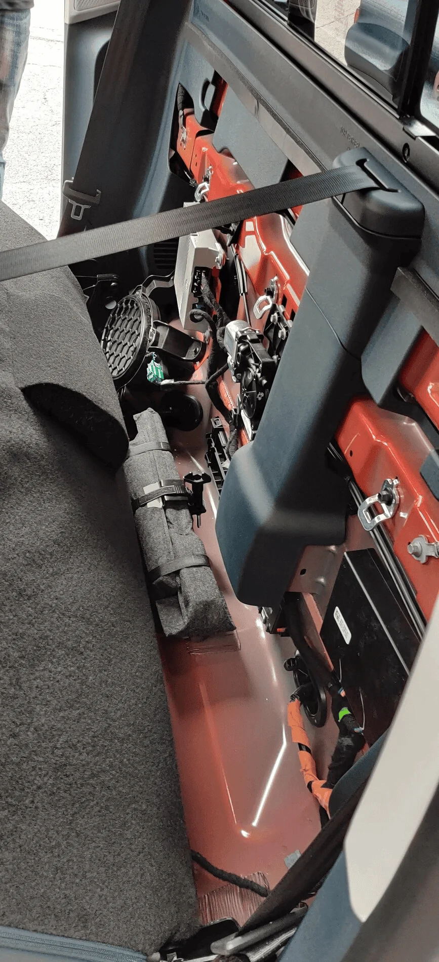

I think you're correct. I was thinking under the seat when in fact it was behind where the put the inverter.
Edit: Added Photo of Woofer.

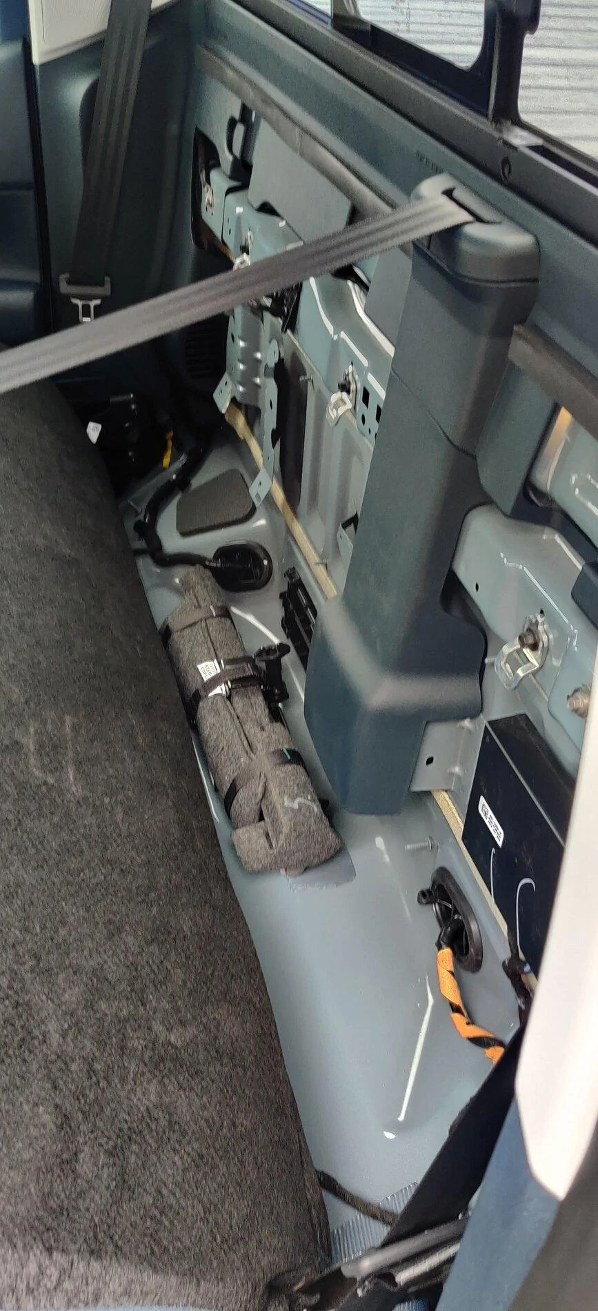

Do we know if those mounts are still there in the xl and XLT? Would be interesting if suppliers could put together a drop-in system.
Edit: find this image in another thread. I can't tell if the sub mounting holes are there, but it looks like the amp bracket is there?

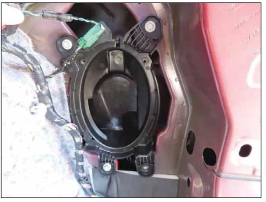

It's kind of obvious that the subwoofer we see is too small to act as a subwoofer, without some sort of resonant cavity. In Escape, the subwoofer is ported into the fender. Many Escape owners know this because they had to tear the thing apart to eliminate a loud BUZZZZZ around 65Hz.
Any idea what the back of this looks like? In Escape, you can see the port mouth at the lower left when the driver is removed.
Maybe that "used to have been the case", but no longer ! They now make very strong, very capable 6 1/2" subs, that can take as much as 500 wts RMS ! And they play, loud, deep, and solid ! However, they need to be used in the correct enclosure, with the proper amount of airspace.... and NOT just some unsealed space surrounded by sheet metal.
I have a single 8" Sundown Audio subwoofer in a custom built (by me) enclosure in my Prius (also, of course, a hybrid) and everyone that hears it, even myself, are blown away that a little 8" sub can sound like it does !
Keep in mind that these "little" 6 1/2" and 8" subs still have very beefy motors. Mine weighs over 25 lbs. The motor is nearly as big in diameter as the cone. Not cheap either. My little 8" was almost $200.
