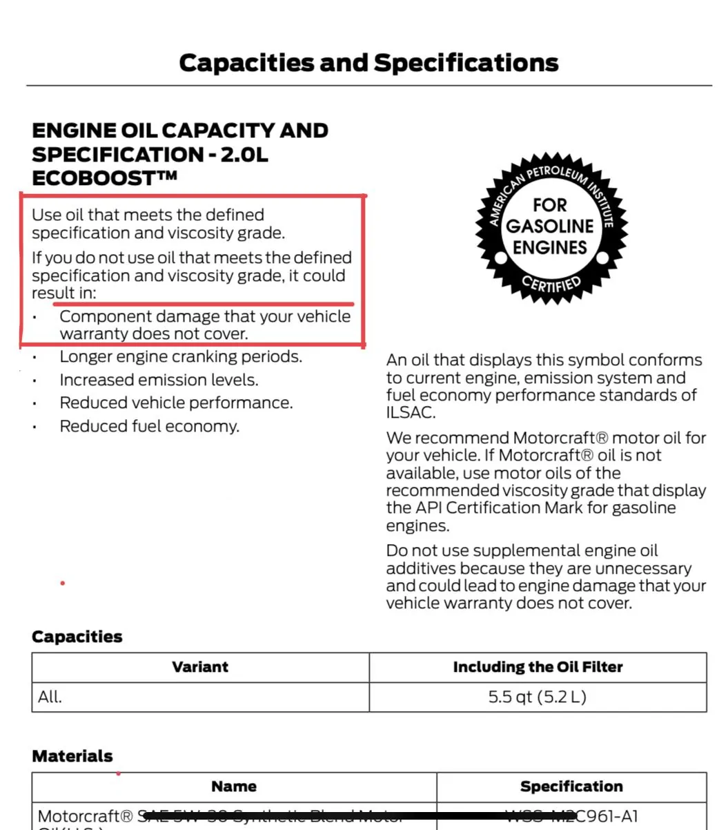

Ecoboost motors specifically have widespread issues with low speed pre-ignition and accelerated timing chain guide wear, that spec specifically addresses both of those problems which is why Ford requires it. I really don't care what other people do but preaching here like that spec doesn't matter seems a little careless to me.
You also either ignore or conveniently leave out the part where the manual specifically says:
"Use oil that meets the defined SPECIFICATION and viscosity grade. If you do not use oil that meets the defined SPECIFICATION and viscosity grade, it could result in: component damage that your vehicle warranty does not cover." Straight from the owners manual.
Why would Ford go to great lengths to create that specification only to make it optional? They didn't......do your research people, read the manual for yourself and don't listen to the "expertise" of random people on the internet
You gotta love the "Do YoUr ReSeArCh!!!" crowd. Allow me to pander to your "research" for a moment and look up Ford spec WSS-M2C963-A1. Oh, what does it say?

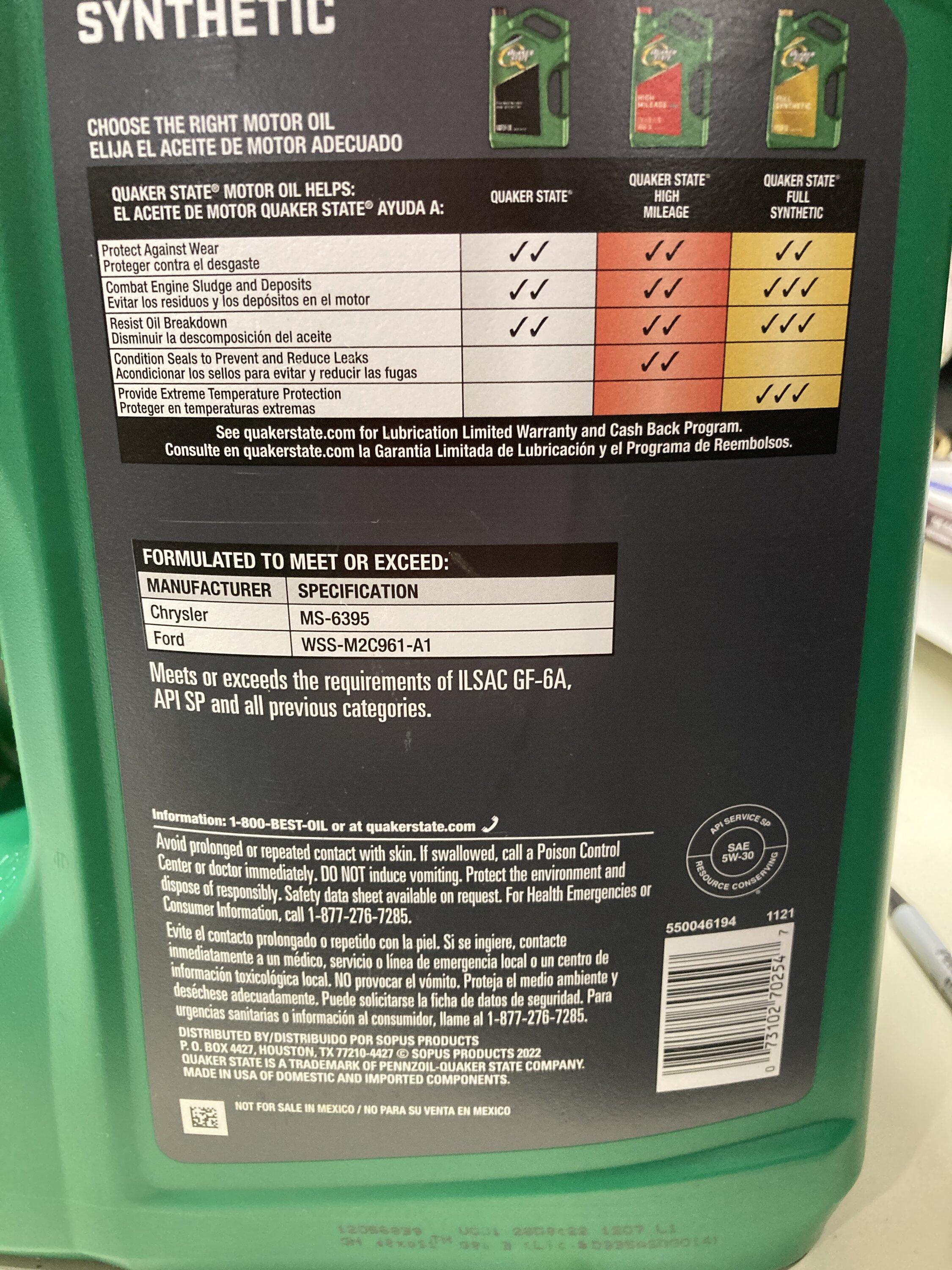

I bought Quaker State 5W30 on sale at Menards for 19.99 after 11% back in a rebate check earlier in 2023. It is stated on the jug that it meets the
Ford spec for the Ecoboost. I too use the Ford Pass App to put in receipts, etc to record my changes.
Ford Maverick Costco / Kirkland full synthetic oil is not certified for use in any Ford 1E669FF7-357A-4BCD-B1B1-B050D5990F70

Thank you for taking the time to put this up. I did all this research before I started using Kirkland oil to confirm it still meets spec. To say using this oil could void your warranty is disinformation.
REALLY? Not disinformation, how about quotation.
Here is a screenshot from the Maverick Owners Manual:
Ford Maverick Costco / Kirkland full synthetic oil is not certified for use in any Ford IMG_1288
