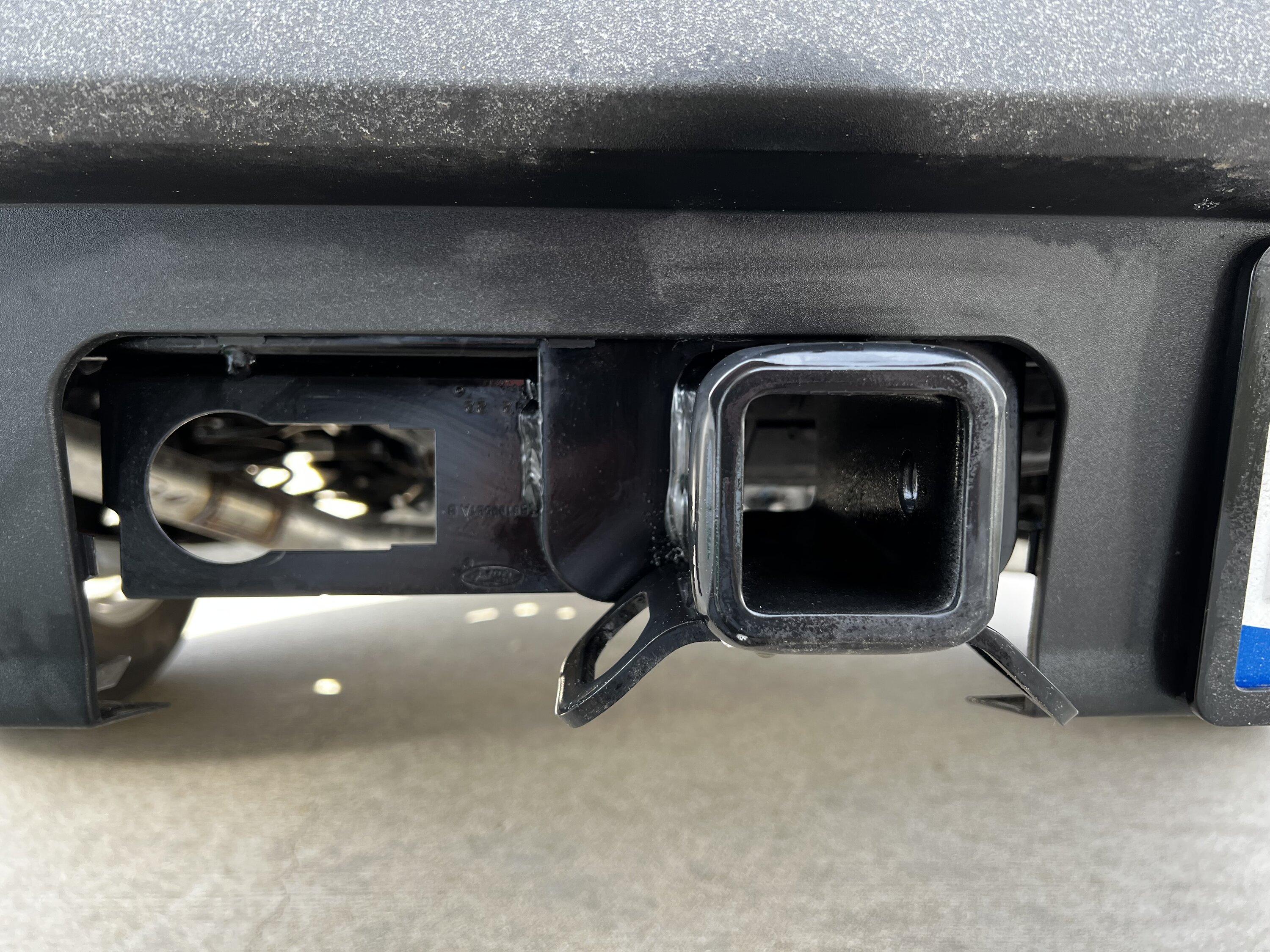

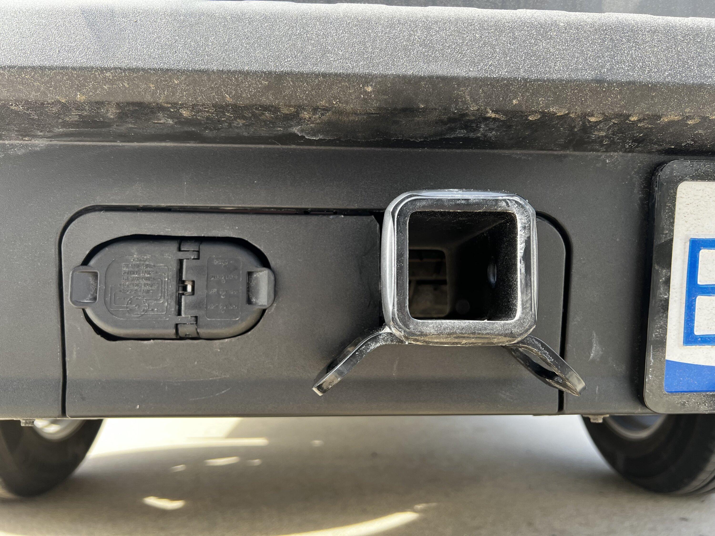

My $.02 is to actually remove the 7 pin connector before you even attempt to install it. Then use a Dremel as previously mentioned and cut out a little bit at a time. I actually went a little too far on the bottom left corner of mine, but it's not very noticeable.
Did you dremel the PIN-portion after you installed the cover? A little at a time until the connector fit back in appropriatley?

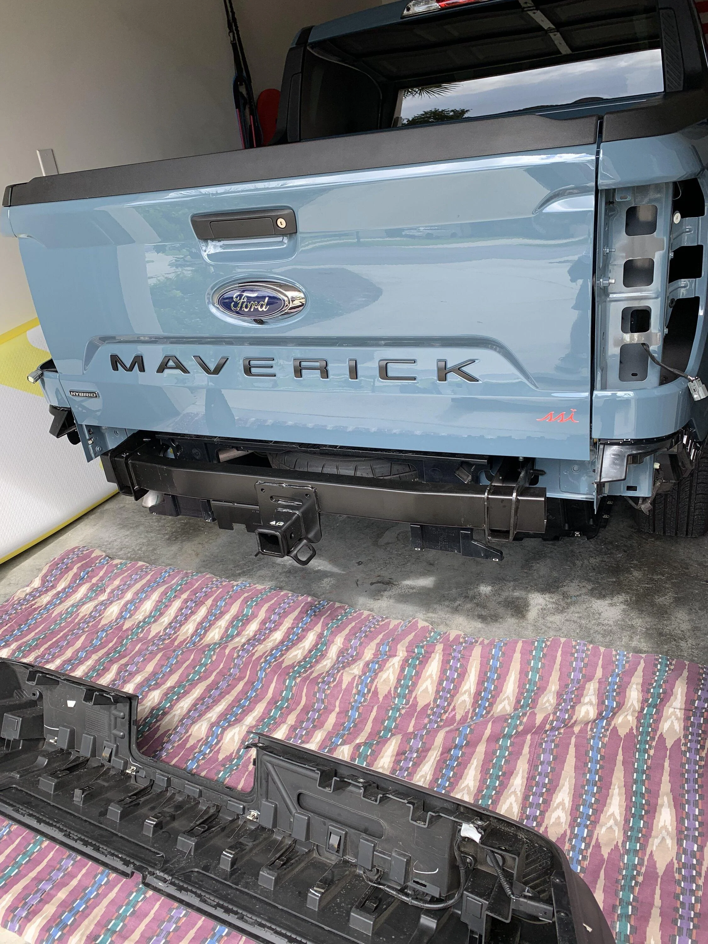

I've decided to try to 3d print the part. I can get the dimensions easily. However, I can't see how it actually attaches. Could someone who has the OEM part share what keeps it in place? Pics of the part not on the vehicle would be ideal.
Don806
Don
Oct 3, 2022
802
649
SE Ohio
2022 Ford Maverick XLT, Also a 2000 F150
there are tabs that kind of snap in along the edges, and then there's a place on the bottom corners that line up with the bumper cover for a nut/bolt, zip tie, etc (I used the push clips I removed during mudflap install) to connect it to the bumper cover. If the piece wasn't such a PIA to put back in, I would remove mine. Someone without a hitch should be able to remove the panel and snap a photo of it for you
