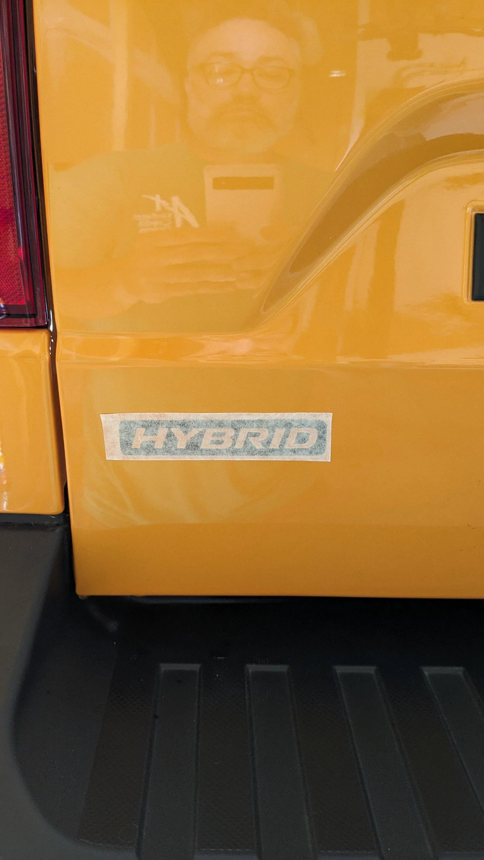

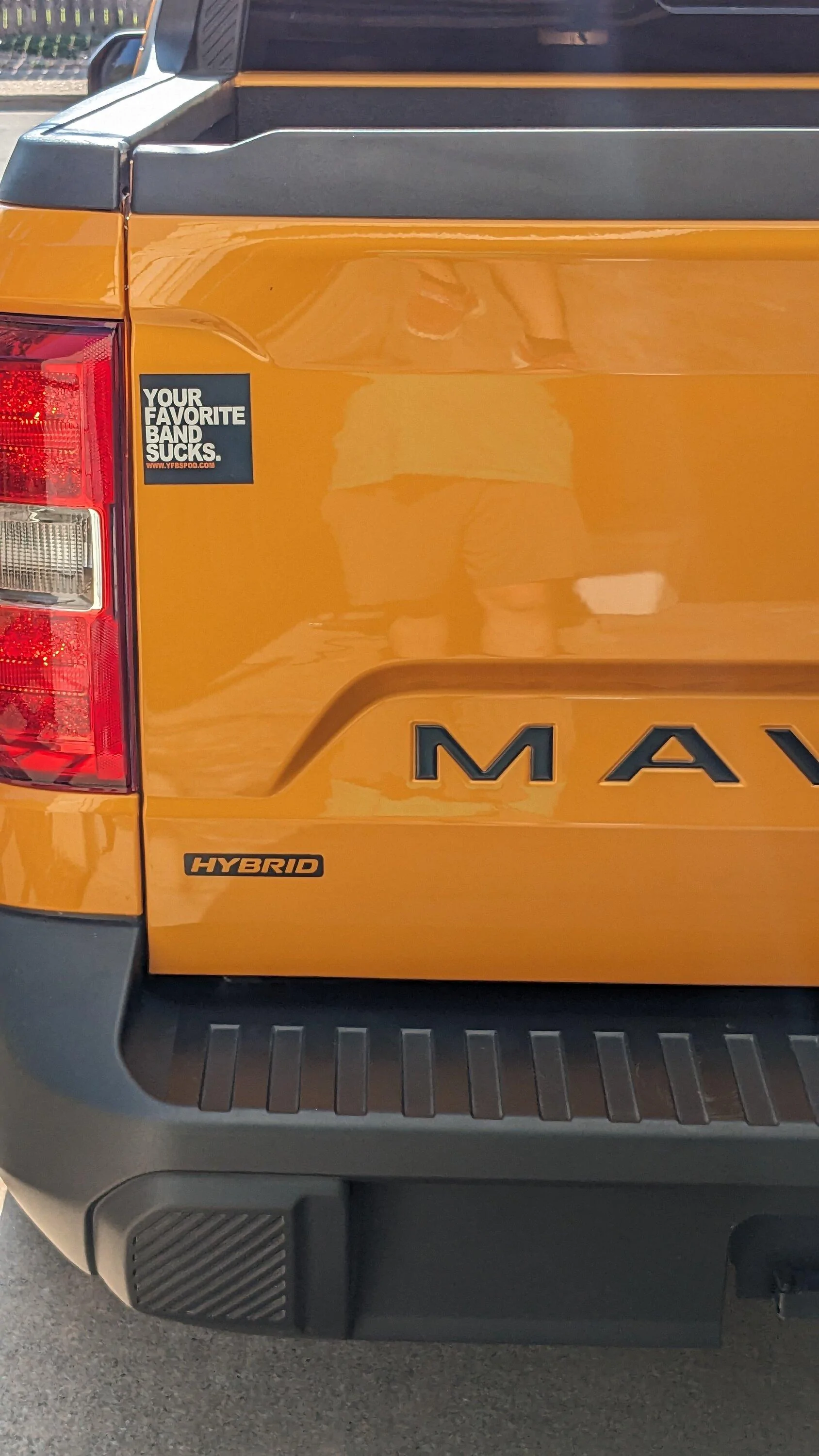

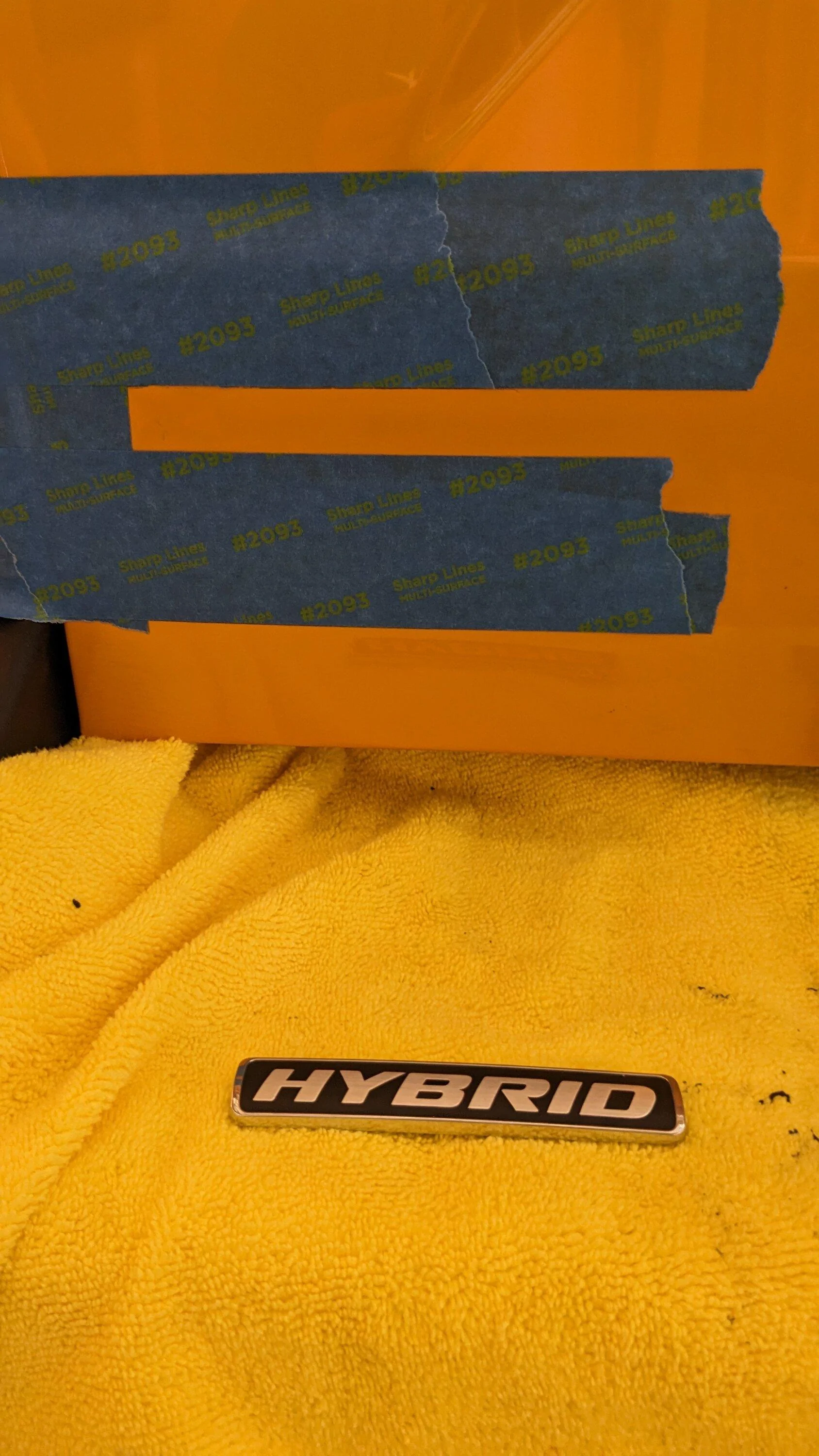

Part 4 of my on going chrome delete project is replacing the OEM chrome and black hybrid badge with a matte black hybrid decal. First, I taped around the badge. Then, I removed the badge with dental floss. Then I used adhesive remover to remove the remaining adhesive. Then I cleaned the area with a degreaser. Finally I applied the decal.
I got the decal from Etsy. https://www.etsy.com/listing/1228635677/hybrid-vinyl-door-decorative-decal. I had to custom order the decal size to match the OEM badge size (4" x 3/4"). The door decal in the listing is too big (8" x 1").
I used Spray Nine degreaser. https://a.co/d/eg7sd1U
I used Mötsenböcker's adhesive remover. https://www.walmart.com/ip/771238547

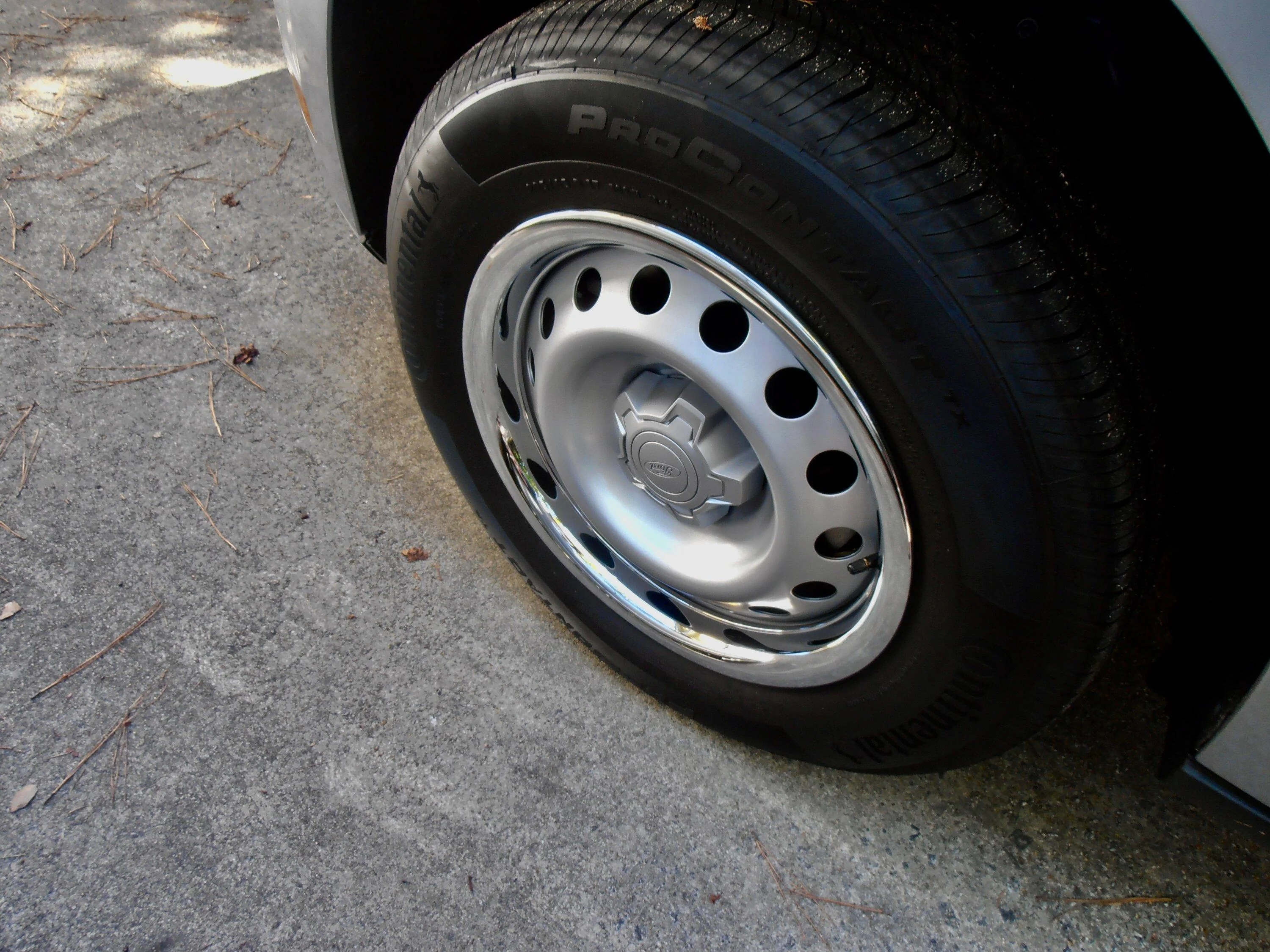

We all have different tastes and I actually like a bit of chrome. Here these chrome wheel rings add a touch of class to my otherwise bland XL steelies.
I recall from my childhood that cars devoid of chrome were always the cheaper models. Times change.

Dental Floss! Thank you! I was wondering how I was going to remove these!
I learned how to remove a vehicle badge/emblem from YouTube. This video was especially helpful: .
