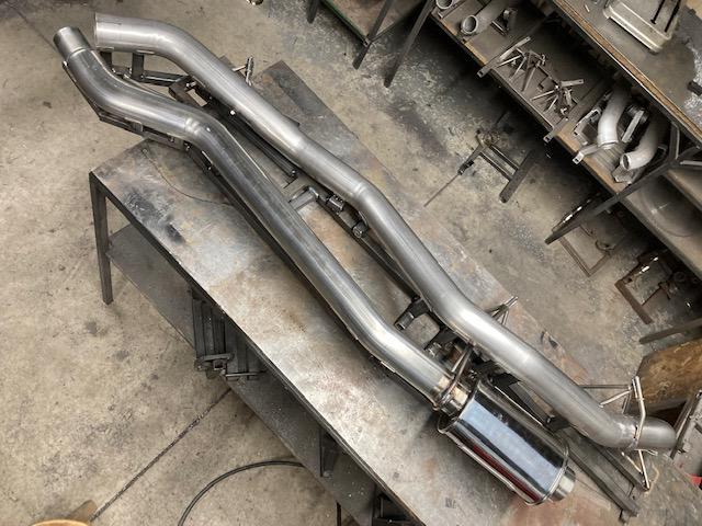

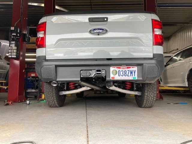

Oh wow as soon as mine comes in I'm buying itHere it is folks! Our production 3" exhaust for the Maverick AWD.
The exhaust is built completely from 304 grade stainless steel, 100% mandrel bent, even the hangers are 304 stainless. This system will outlast the truck.
The system is substantially lighter than stock, uses the factory hangers and has more ground clearance than the smaller diameter factory exhaust.

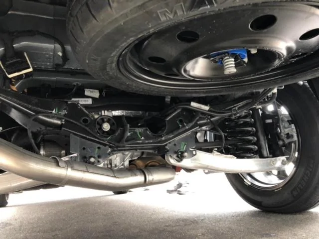

This system will require you cut the factory exhaust behind the secondary catalytic converter and this then slides on and is clamped. Leaving the factory secondary cat in place makes this a NO DRONE exhaust, the tone/sound has been posted already in some of my other threads but it's really perfect if you don't like something overly loud.
The first picture is the factory exhaust on the truck for comparison to our 3", as you can see, we have substantially more ground clearance.

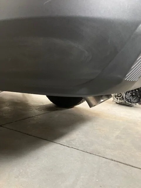

We decided not to copy the factory "tip" and have extended ours just slightly to keep the exhaust from being discharged directly under the truck bed.
Also a picture of the fixture to weld these up to make sure every system leaves here with perfect fitment.

Will the aftermarket downpipe you make bolt to the stock exhaust?UPDATING
I've been asked multiple times and have responded but now realize my answers aren't going to work......
Will we offer a way to delete the secondary cat. The answer is no, not with the catback.
We are working on my truck this morning again and trying to come up with a good way to add an additional resonator in place of the secondary cat, there isn't one. It will require welding on the end users part, at that point you may as well pick whatever you want and just have it welded in.
What we have decided is the next component we make will be the downpipe which will go all the way to our catback and from what I've seen everyone else's too. Everyone is requiring cutting of the stock system to install a new catback. So we are going to just make the downpipe one piece all the way to the 3" catback. The downpipe will come with a highflow cat and the option for an additional resonator.
